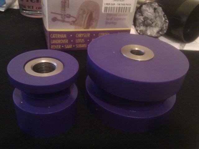

Polybush the dog bone mount. Bushes are sat on my desk to be done tomorrow;

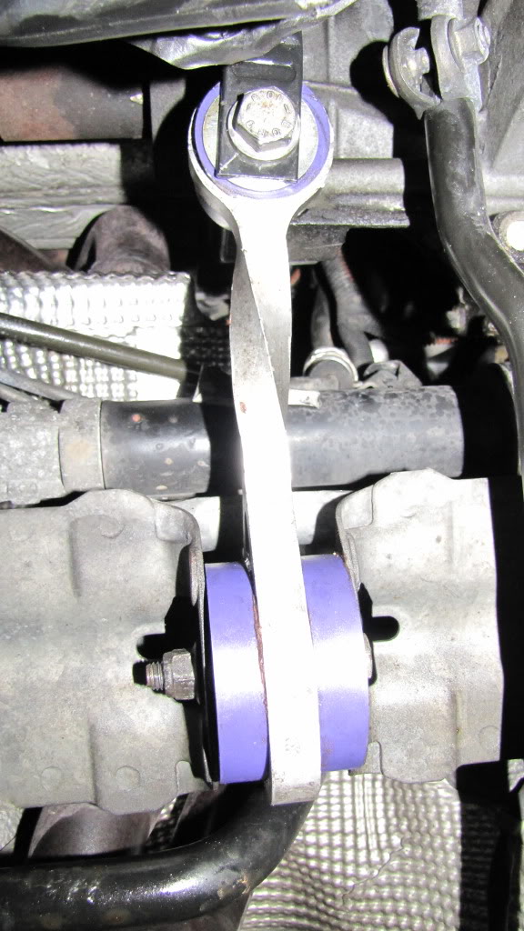

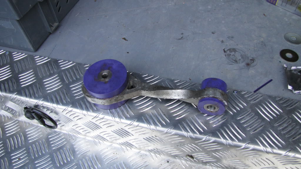

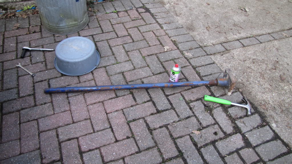

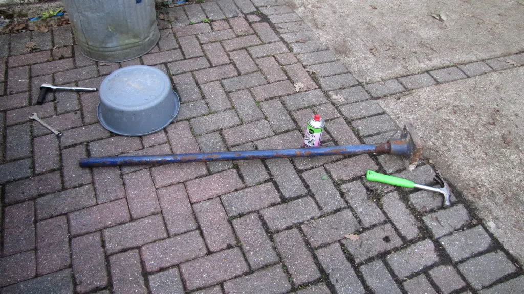

So I tackled the lower gearbox mount this afternoon, it wasn't as easy as I thought it'd be owing to a very stiff bolt (even though it was soaked in Rostex the day before, and before starting the job).
This is what was required to get the bolt in the end, and even then it snapped a cheap ratchet first (no way was I risking my Halfords Advanced one! Solid bar seems to have gone missing)
New bushes in place
Fitted
There isn't much to report in terms of fitting otherwise, it is ridiculously simple.
I'm very pleased with the results though, gear change feels rock solid all the time, even when booting it. Feels more solid when coming on power harshly, too. I've noticed none of the vibration issues that others have reported, so it's definitely a worthwhile "upgrade".
Not that I've noticed, there was perhaps a little more vibration when cold, but this soon went away so it's hard to really judge it.

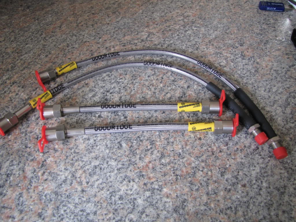

I've also ordered some braided lines, so it's just discs and pads and it's all done :)

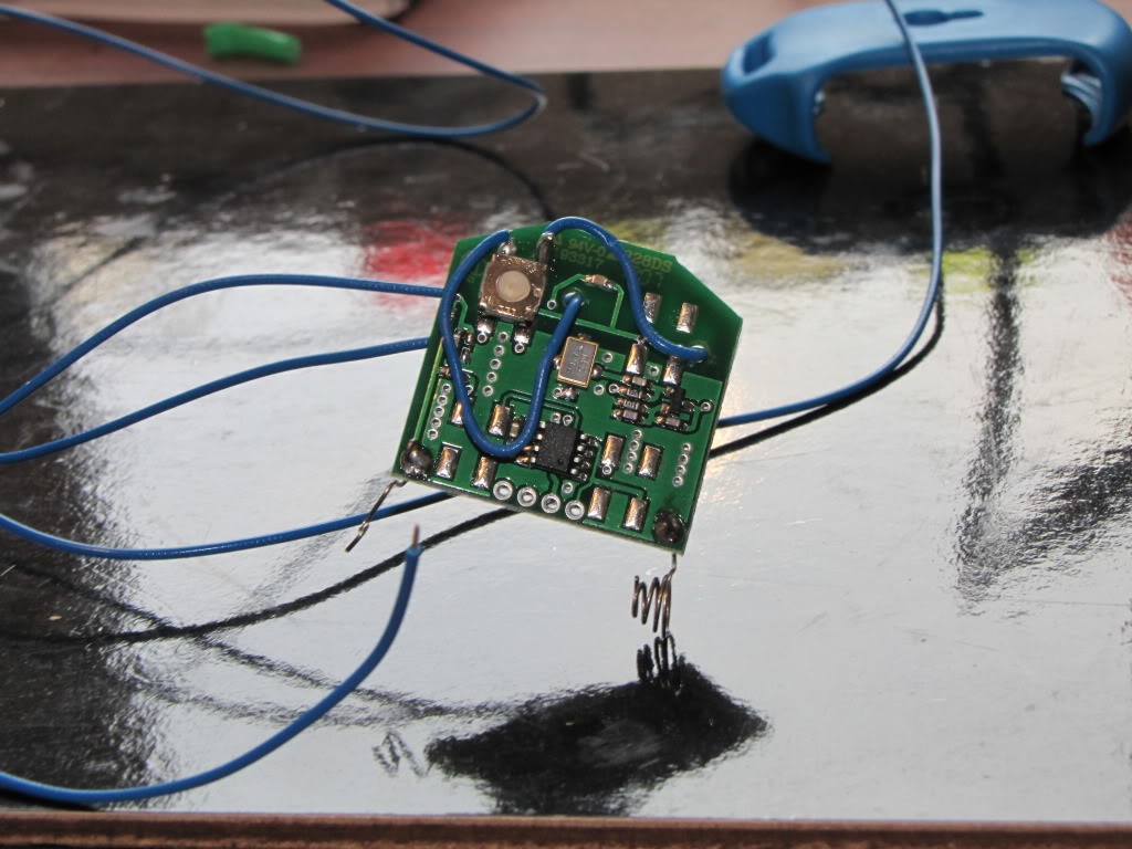

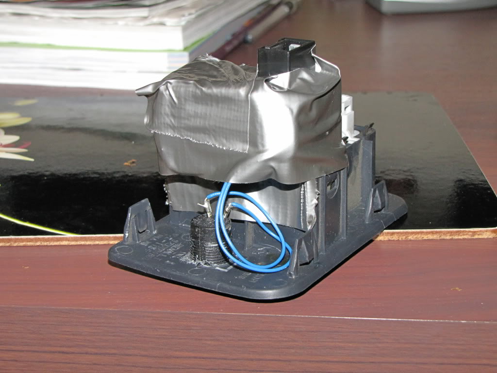

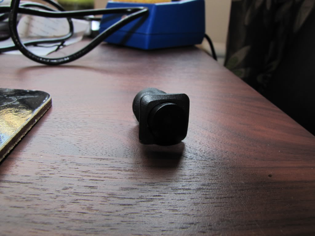

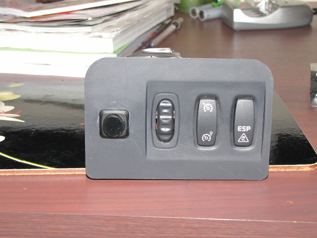

I've finally done something I've been meaning to do for ages, and that is to have a dedicated button for my garage door in my car.
Please excuse the shocking solder, I bought a soldering iron under the impression it came with assorted tips when in fact that's an extra and it comes with a 5mm tip! It's like trying to thread a needle with a hammer.
Yeah, I figured one of these panels would not be expensive or hard to source with the number of cars breaking on here :P (the switches are removable).

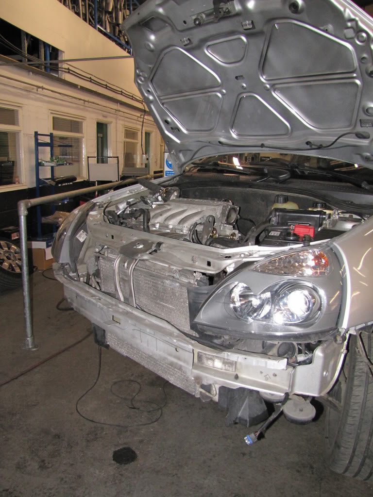

The cambelt, auxbelt, tensioners, oil, filter and de-phaser pulley was done today - pretty uneventful, other than rounding the corroded torx bolt that plugs the crank pin hole - still managed without the pin though and it's all timed up perfectly :)
I'm not sure I understand why people say it is a specialist only job, we managed with just one "specialist" tool in the end - it just required a little education and a lot of common sense. It is a difficult job, but it seems most 172/182 owners would have you believe that no one but a specialist or certain Renault workshops can get it right.
I did speak to a Renault tech about it when I bought the parts and he seemed to think the most common thing was people not checking the dephaser pulley was locked before fitting.

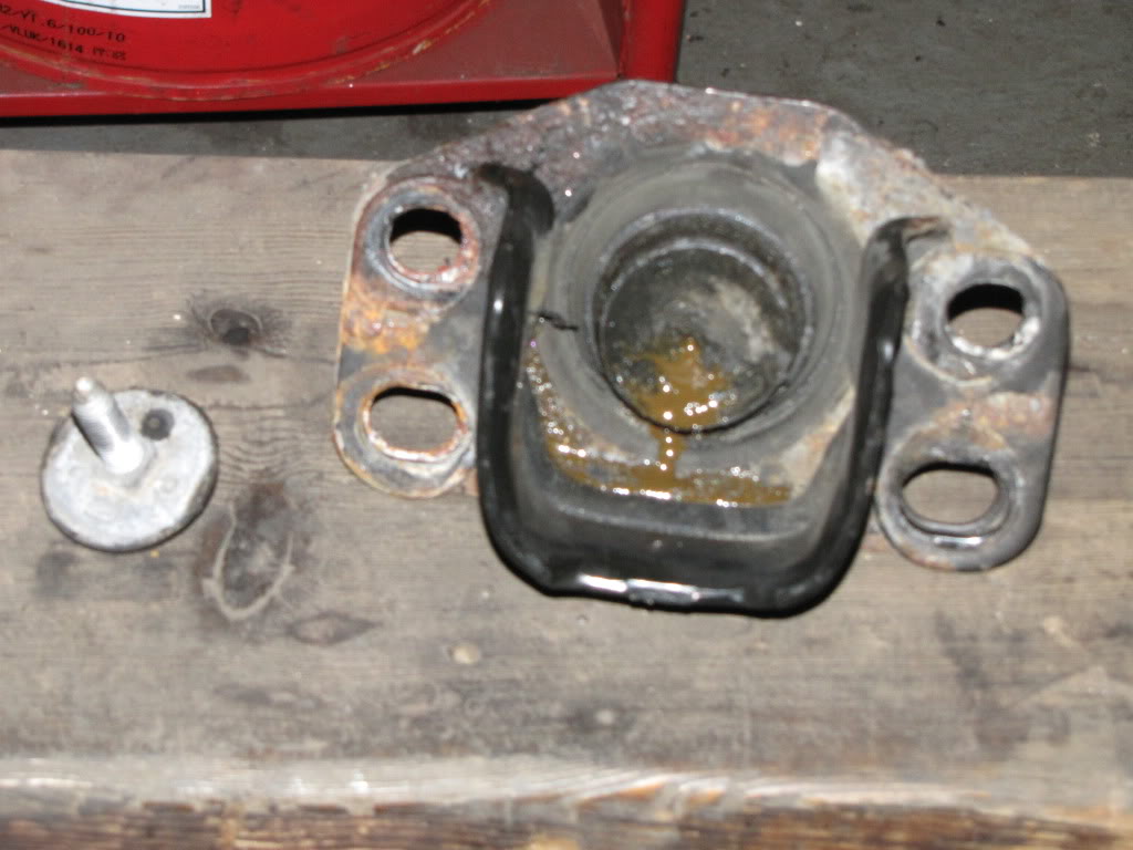

Car in bits - headlight had to come out in the end, too.
That'll be why I've been getting a knocking noise then. I thought as much, but had no idea it was that bad. This is the engine mount. f**k overnight parts from Japan, SES Southampton put the replacement part on the Redjet and I had it within an hour.

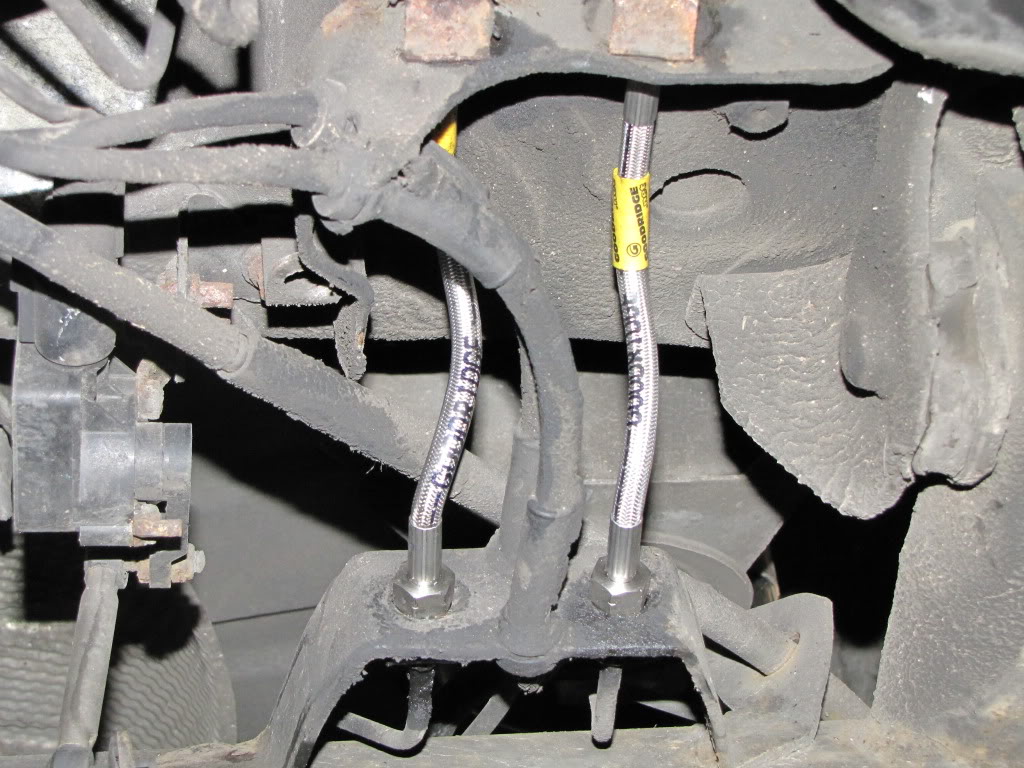

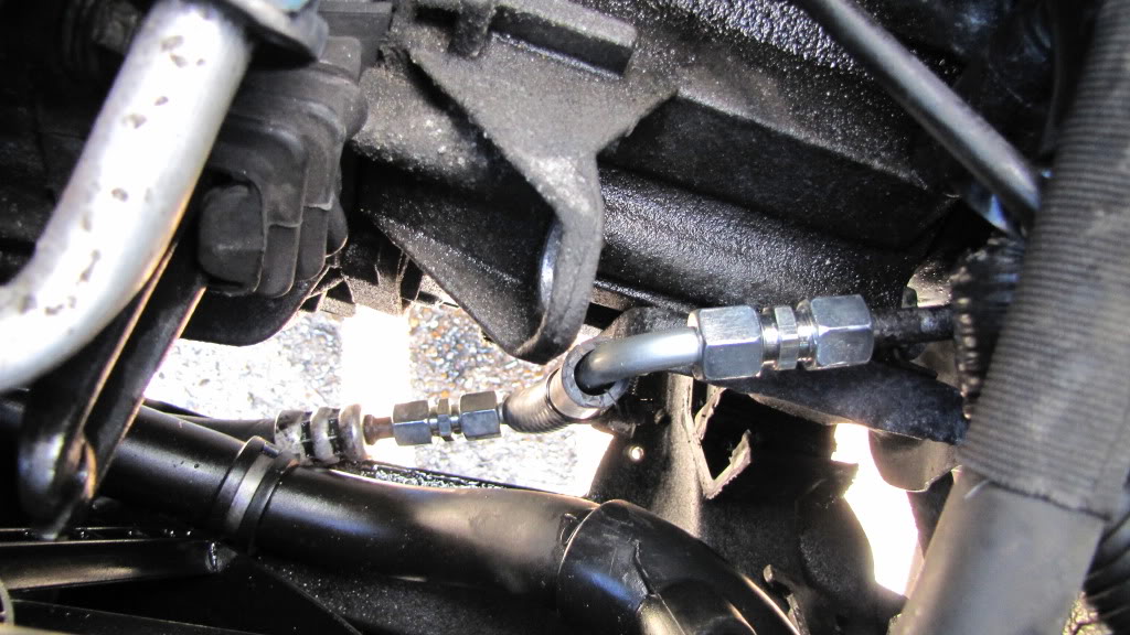

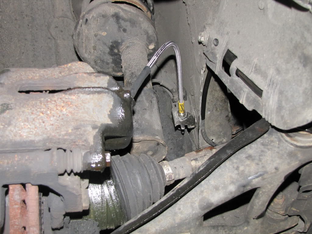

Oh, and braided lines fitted. Whether it is them, the fact I've replaced the fluid or a combination of both, I do not know but the brakes feel miles better even with the EOL discs and pads that are on there - I can't wait to get the new stuff now :)
Yes, I'm aware the CV boot is off, that was sorted too along with finally balancing the wheels :)

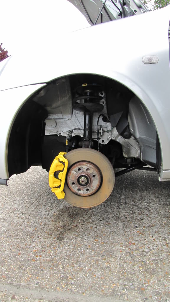

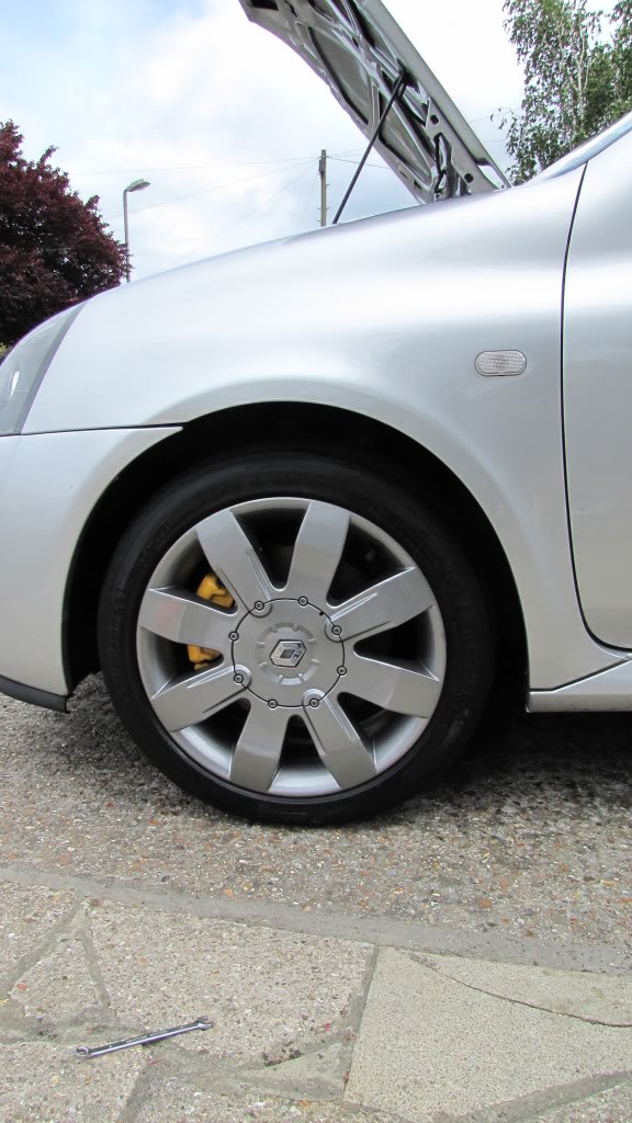

I've spent the day today chavving my car.

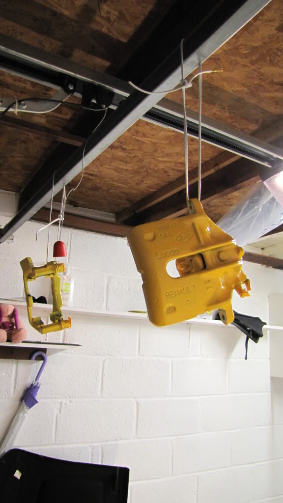

Bright callipers aren't usually my thing, but I absolutely love the silver/yellow thing, and I think it tidies things up well.

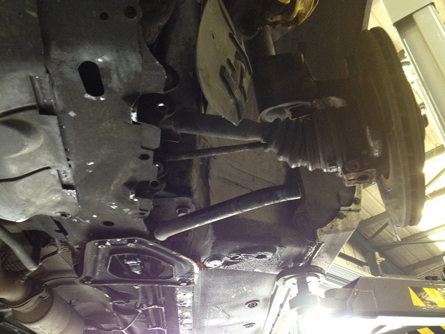

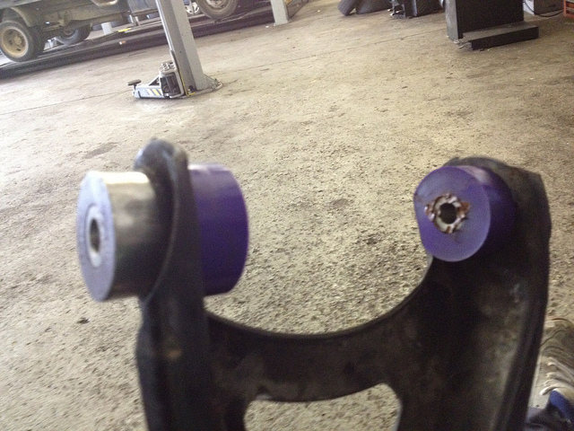

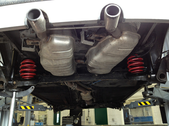

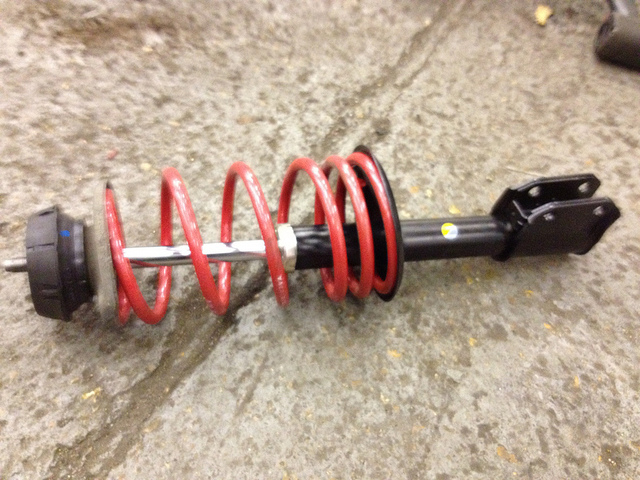

New Cup Shocks, sportline springs, top mounts, ARB polybushes, wishbone polybushes, track rods and ball joints all done. That is now every bush that can be polybushed done now, too.
Some boring pictures:
IMG_0158 by mikehiow, on Flickr
IMG_0159 by mikehiow, on Flickr
IMG_0160 by mikehiow, on Flickr
http://www.flickr.com/photos/22354094@N02/6553664657/in/photostream/
[url=http://www.flickr.com/photos/22354094@N02/6553664657/]IMG_0161
(I did notice the missing bump stop and put it in there after this pic :P )

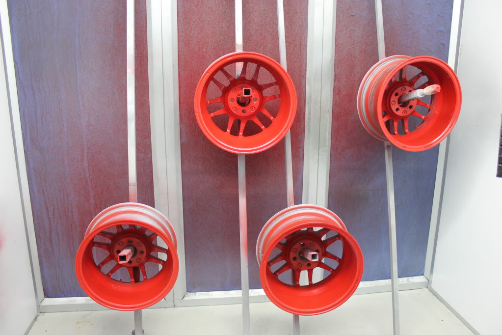

Been out for more goodies this morning - Honda Formula Red paint for the OZ F1s, so I can get down to the unit over the Christmas period to get them blasted and painted - a brilliant opportunity to test out the new media blaster, spray guns and spray booth :)

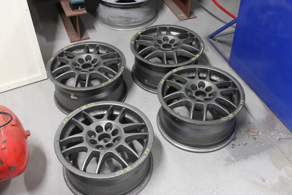

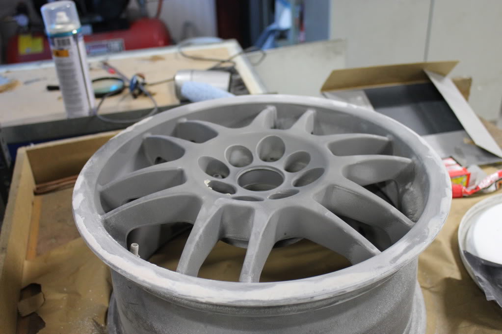

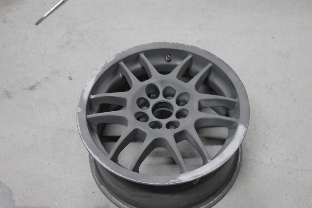

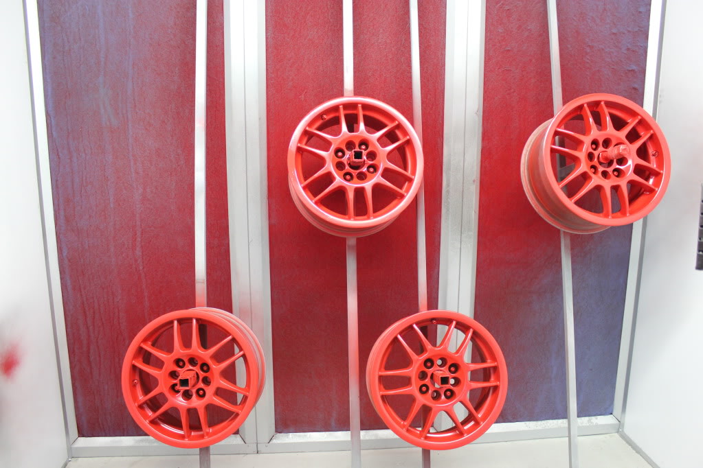

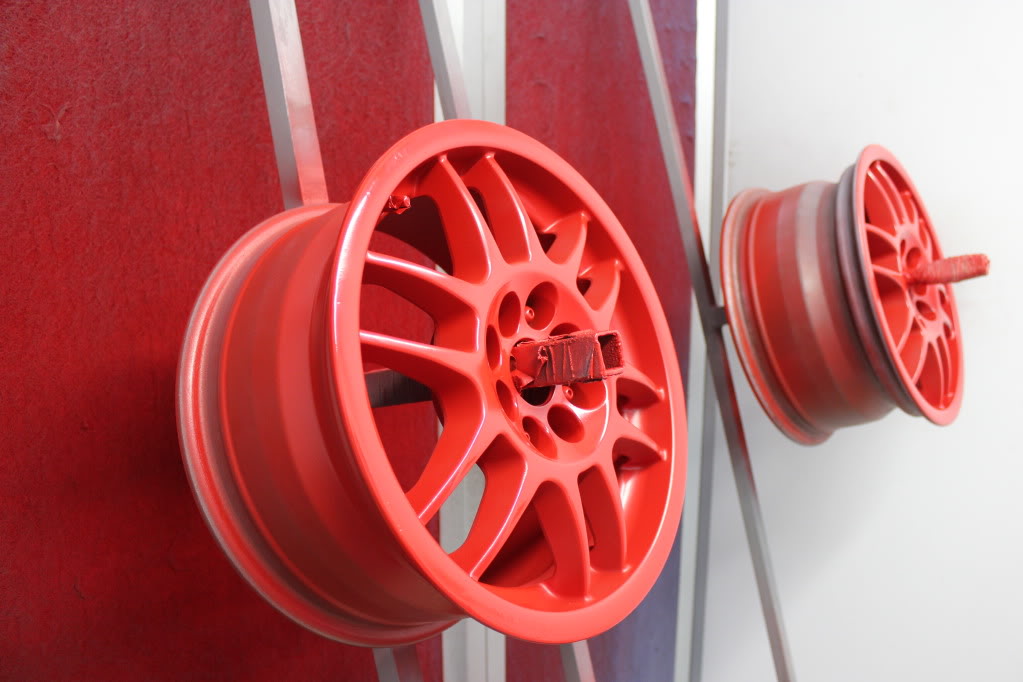

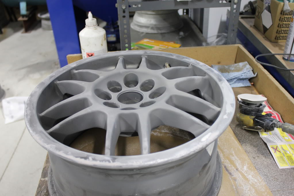

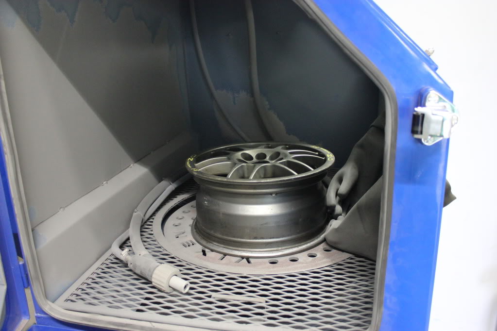

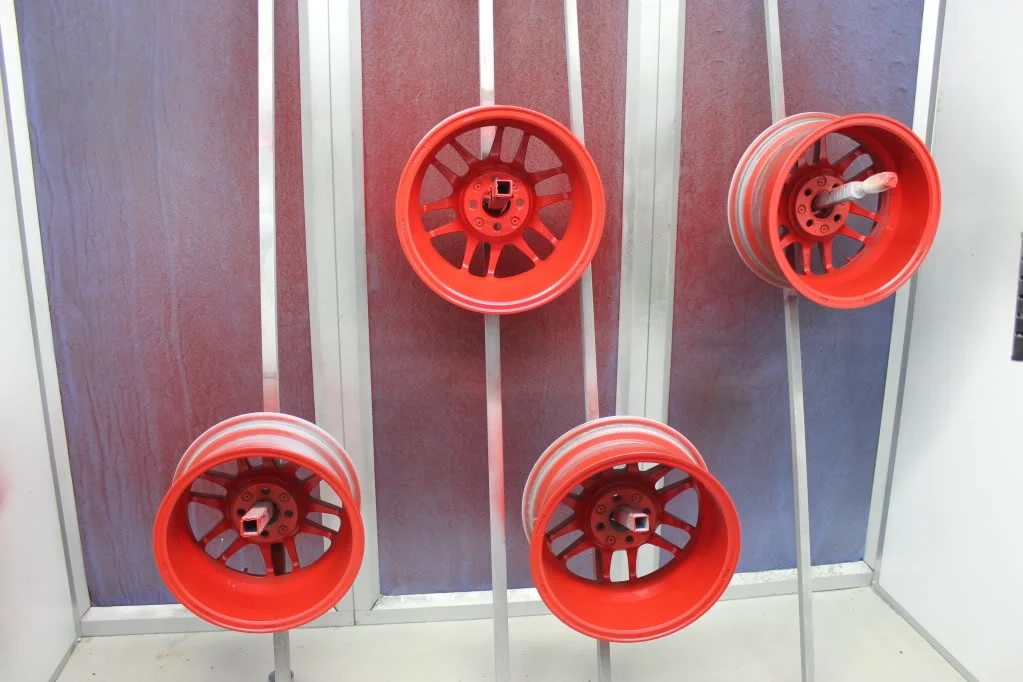

So I decided to give my new wheels a lick of paint - a perfect chance to test the new facilities.
This was a huge learning curve for me, but I got there in the end. I spent a lot of time trying different methods and techniques, figuring out what worked best for me.
The job is by no means flawless, but they look pretty good, and they are not mistakes I'll make again.
Just need to get down there tomorrow to give them a few coats of lacquer and they are ready to roll.
Blasted wheel - the aim here wasn't to strip them completely as the blaster was playing up and these were taking ages.
I'll grab a picture of the finished article once they've been lacquered tomorrow.
