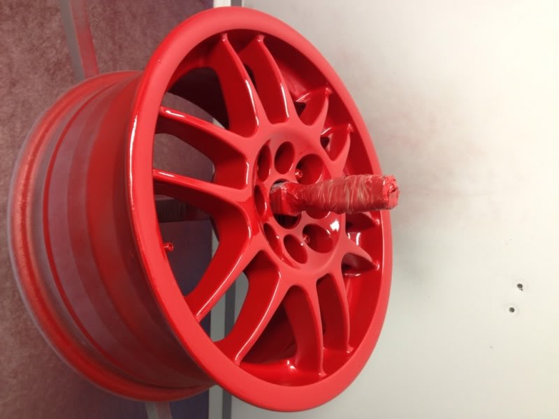

It'll be a few weeks before I do, too - as where I don't need these wheels until February, I'm going to give the lacquer plenty of time to harden before refitting the tyres.
  182 Trophy

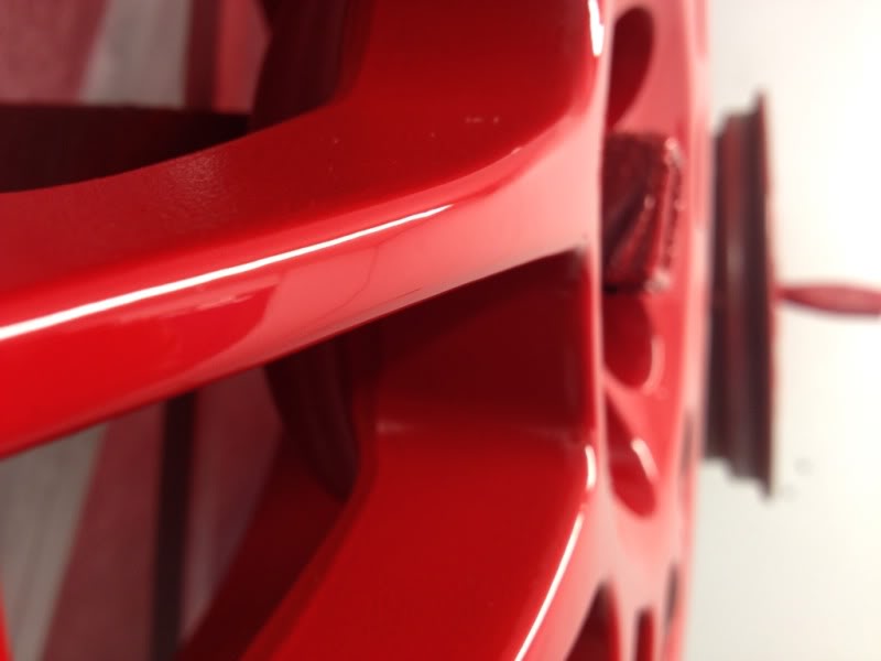

Now with lacquer - I'm quite impressed with the finish.
At some point I'd like to flat them back, give them a good polish and coated in C5.

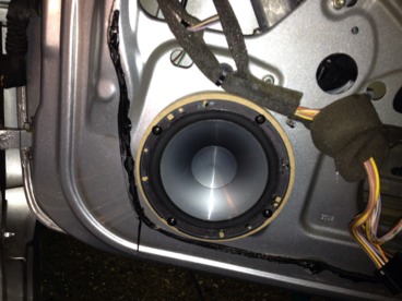

Slightly less visionary update than the last few, but with an amp sat in my garage and finding some component speakers cheap, I thought it'd be rude not to.

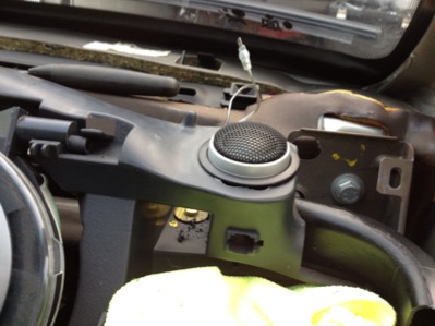

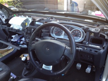

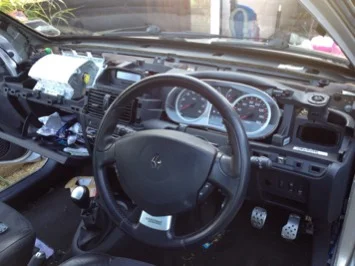

Dash off to access existing tweeters
Existing hole opened up to accept new tweeter

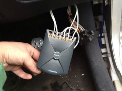

Speaker loom spliced to get a connection into the door, new cables fitted between amp and crossover and tweeter.

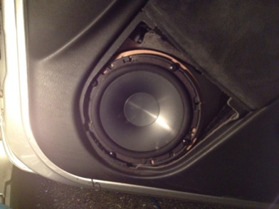

Standard speakers are 13cm - 17cm speakers fitted with the aid of an MDF baffle.

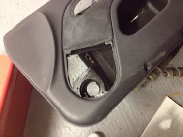

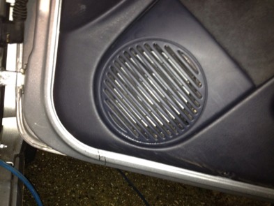

Door card needs modifying though - old speaker mounting cut out
And fitted
Job done :)

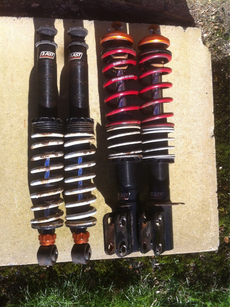

Some goodies fitted this week:

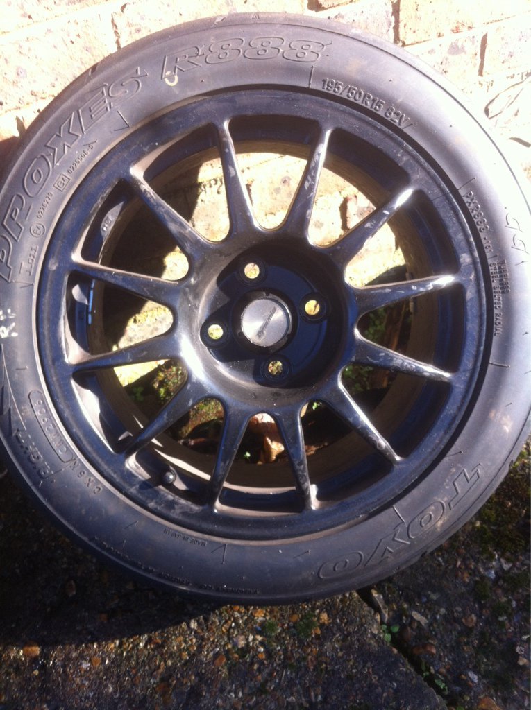

AST Sportline 1s and a set of TD 1s with R888s.
Aligned up and it's pretty hard - I can't wait to test them at brands on Friday, though! I'm glad I don't use this car on the road anymore.

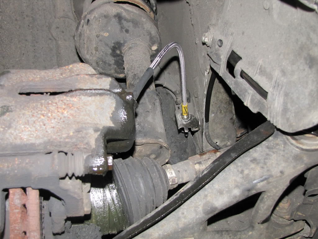

I found sliders and piston seized on the NS caliper whilst doing it, so took the opportunity to give that a quick service.

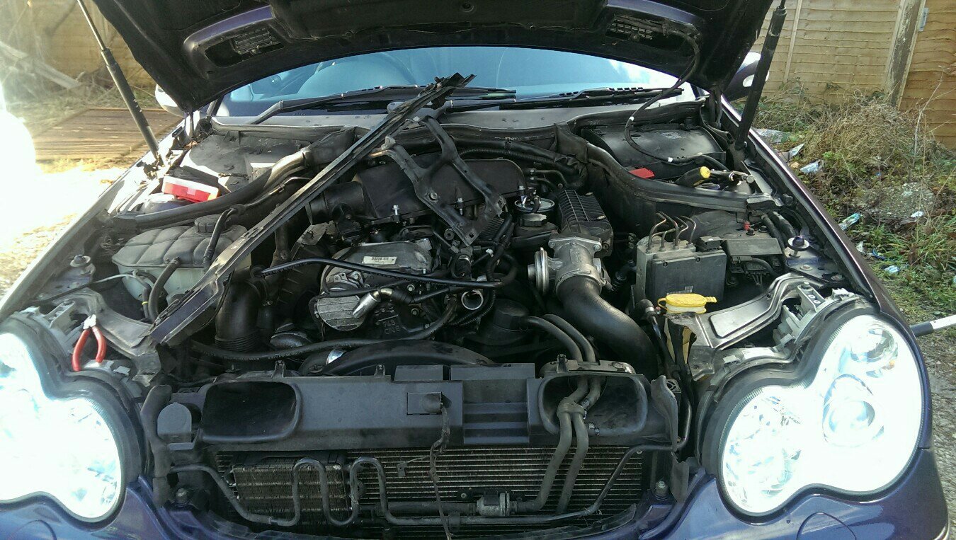

Half way through all this, I ended up with a dead water pump on the c-class - that was an interesting job! So much for longitudinally mounted engines being easier to work on!

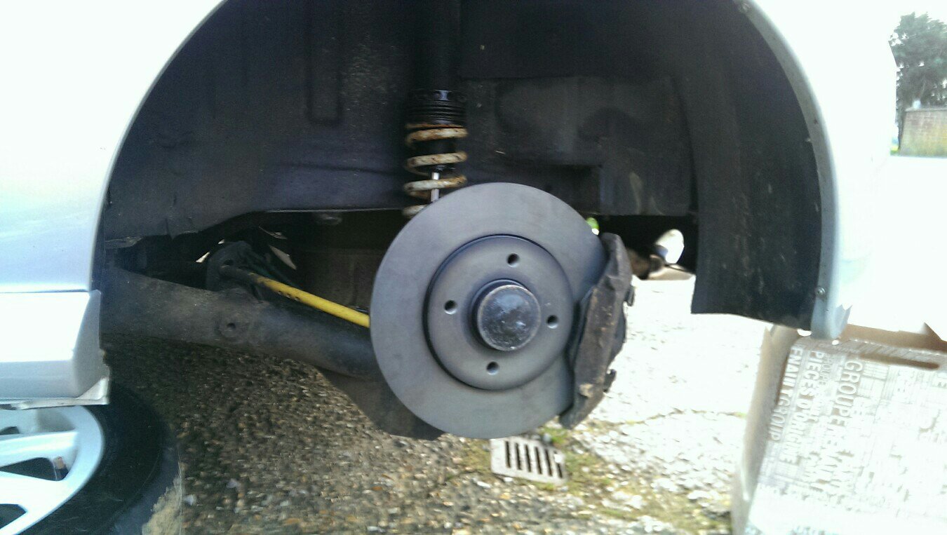

New rear discs and pads
Also got the front spacers on - looks tidy, but the fronts rub.
