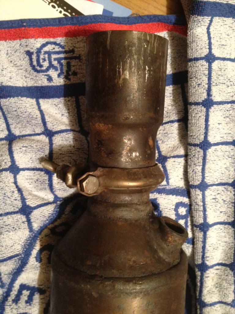

Never mind, just unwrapped the cat to find it has an extra piece fitted.
For anyones future reference it looks like this:
That just bolted on with the clamp,then sleeved over the miltek?
So if you ever want to go back to standard exhaust just unbolt the clamp and reclamp to oEM exhaust.
(just for reference lol)
Does the miltek decat clamp in the same place, or just got a sleeve welded on the end out of interest?
Yes, thats what I understand.
Not seen under the car, but I presume the decat is also a sleeve that goes over the cat back.
Can anyone tell me where I can get one of these adaptors?
My 182 is due for its MOT before the end of the month and I have a cat but no way of joining it to my Milltek.
Any help would be appreciated!
Apparently, the code for the Milltek adapter is F5037, hard to find a second hand one. best bet, give Milltek a ring.
