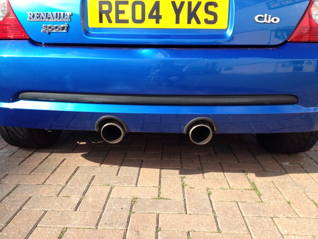

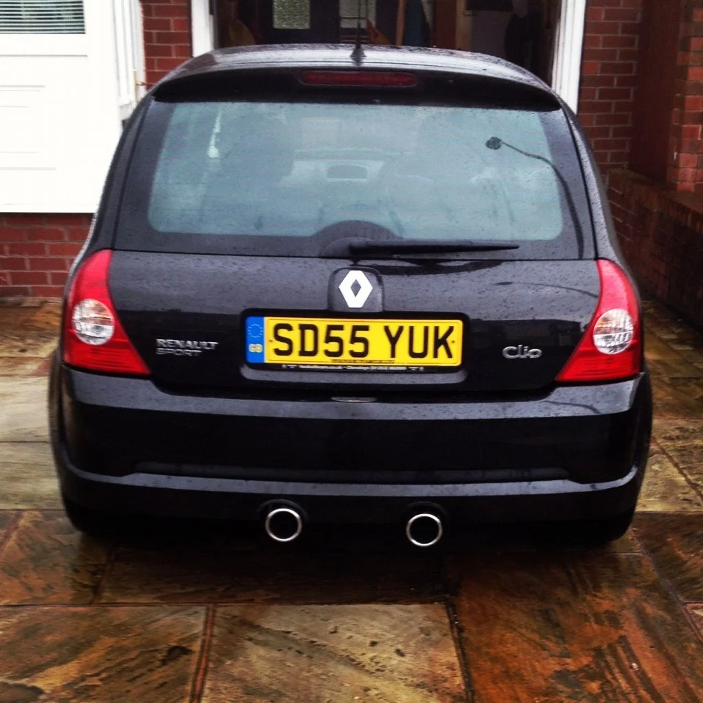

Hi guys, I've recently fitted a Milltek system to the clio and to be honest I'm abit anal about how it sits in the bumper cut outs, at current I'm not to happy with how it is sat and was wondering if a couple of you could put some pics up of your 182's with Milltek Cat Backs.

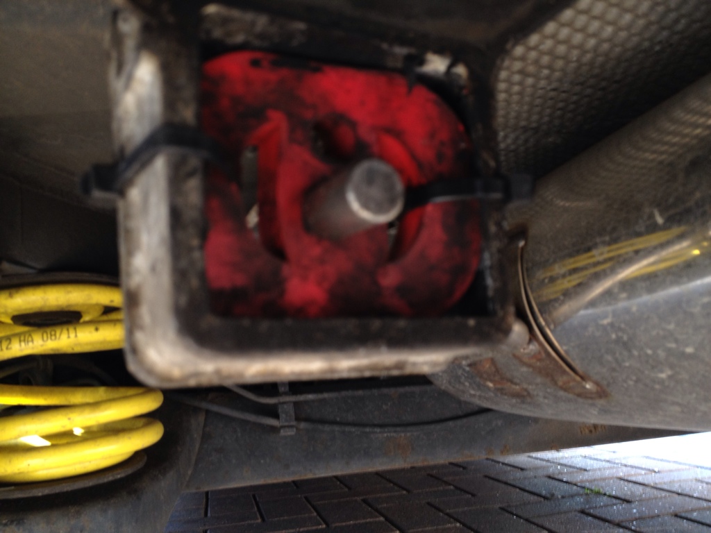

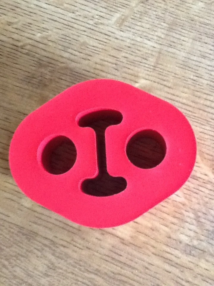

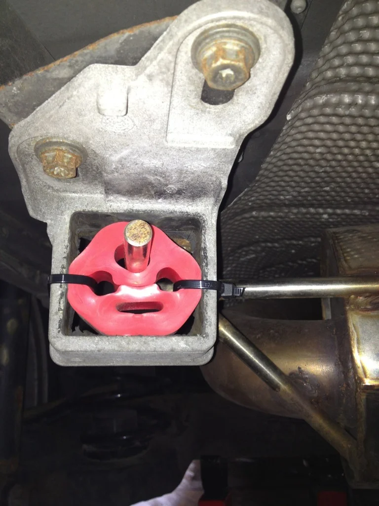

If I was you go buy some powerflex bushes exh009 and fit them in the rear brackets, cut out the old rubber before hand obv, cable tie either end, and drill a hole in the middle and it'll sit perfect :) I'll get s pic tomorrow for u. And no movement either so less chance of cracking ;)

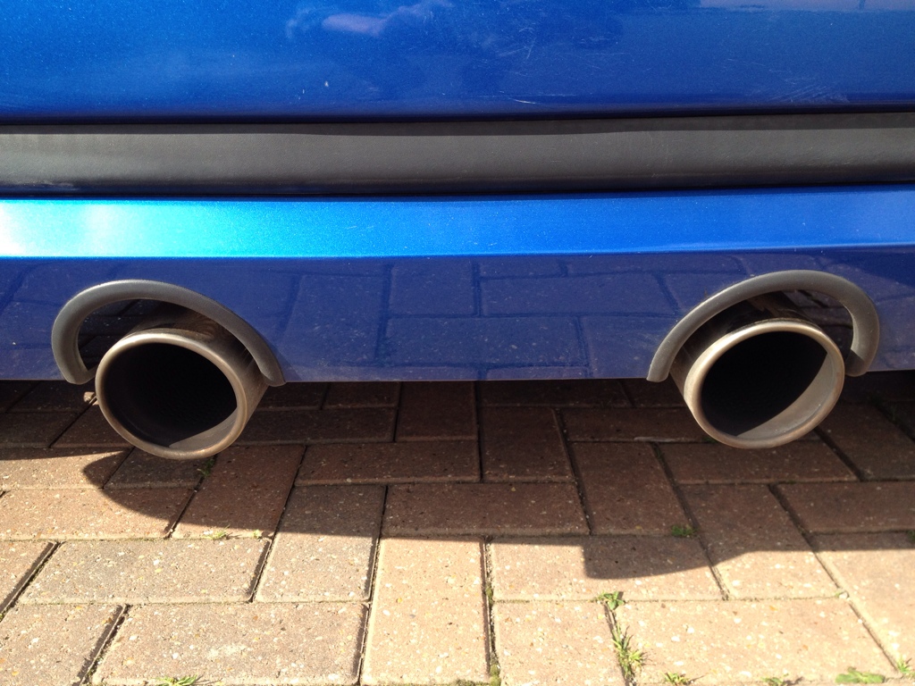

You don't get any vibration what so ever mate, best thing you can do in my opinion to be honest, throw me a PM tomorrow to remind me lol I sits about 6-7mm off the cut outs, just enough so u can see the miltek print if u standing at the back ;)
Nice one! Needed help with this to. Can you post a pic of yours fitted so I can see exactly how it's done (the actual bushes) cheers
Not the best pics and it's filthy but....
For me I think it sits perfect, just low enough to see the miltek print which I like and is solid so no banging on the bumper or rear axle.
