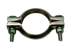

Check the cat - cat back clamp as well, mine was rusted like a b**ch and I replaced it with a stronger clamp and resealed it. Really easy to do and stopped my blowing exhaust. Yay!
Bit of a common issue with the Millteks. Mine saytoff to the right and vibrated the bumper surround. Right side was fine but left side was low. Cable tied it for now until I pop to K-tec for the re-map.
I could do with a new cat-back clamp as my original is rusted and bent out of shape somewhat. Any idea where I can get one of those? (Assuming K-tec don't have any).
Edit: Cheers for the link SS, guessing I can get it direct from NWP as I'm not really a fan of e-bay!
