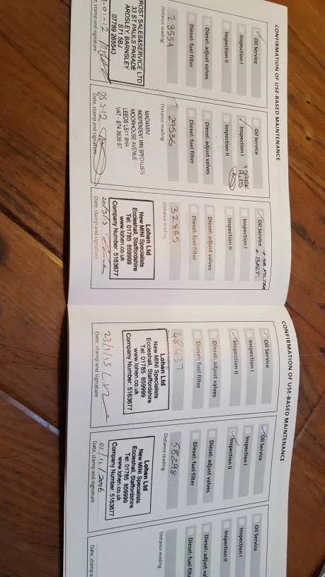

picked the Mini Cooper s up last night, and what a cracking little car it is, it's only done 64k, has full service history, from main dealers/lohen/mad4minis, receipts for all the work carried out adding upto thousands ( upto 2k some, eye watering for me ) imo it's an immaculate car for 12 years old, interiors practically as new, back seats look,like they've never been sat it, bodyworks superb blah blah blah...............................................sorry got carried away, thought I was doing a for sale add then.

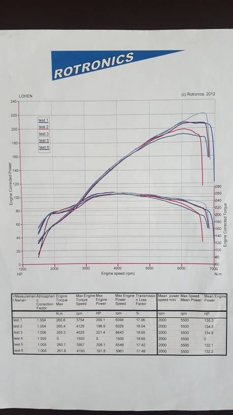

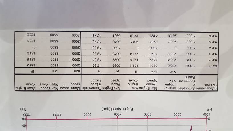

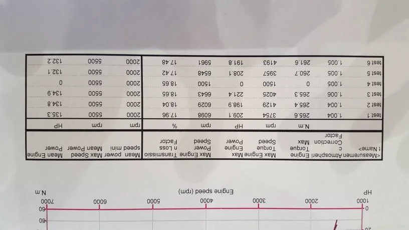

So the important bits, 221.4 bhp ( the .4 makes all the difference )

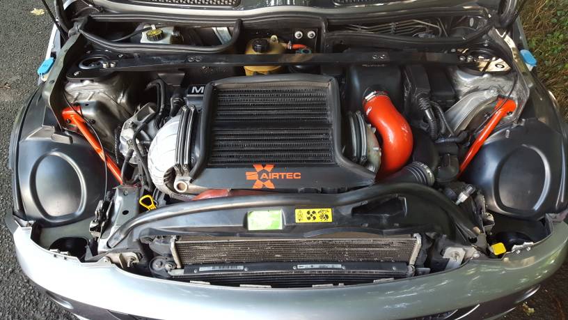

Engine
MSD coilpack
NGK iridium spark plugs
JCW air box / ITG filter
Full Miltek exhaust
Airtec top mount intercooler
15% reduced pulley
Red Silicon hose kit

2. Without a cam, you wont have 221bhp, more like 200.

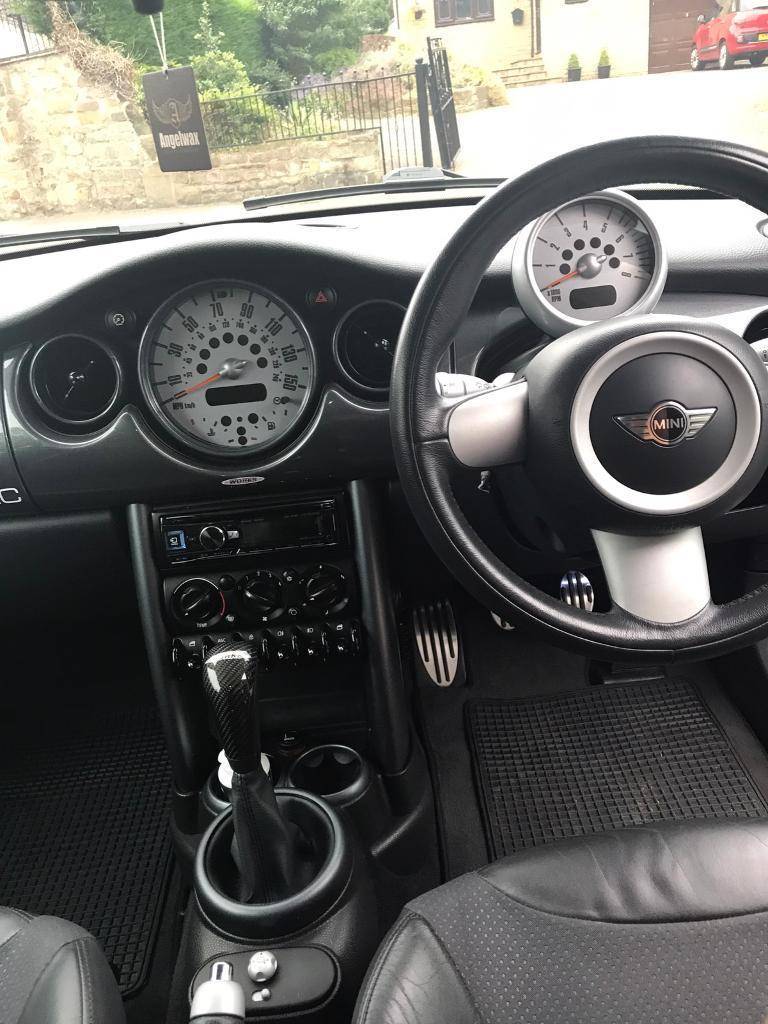

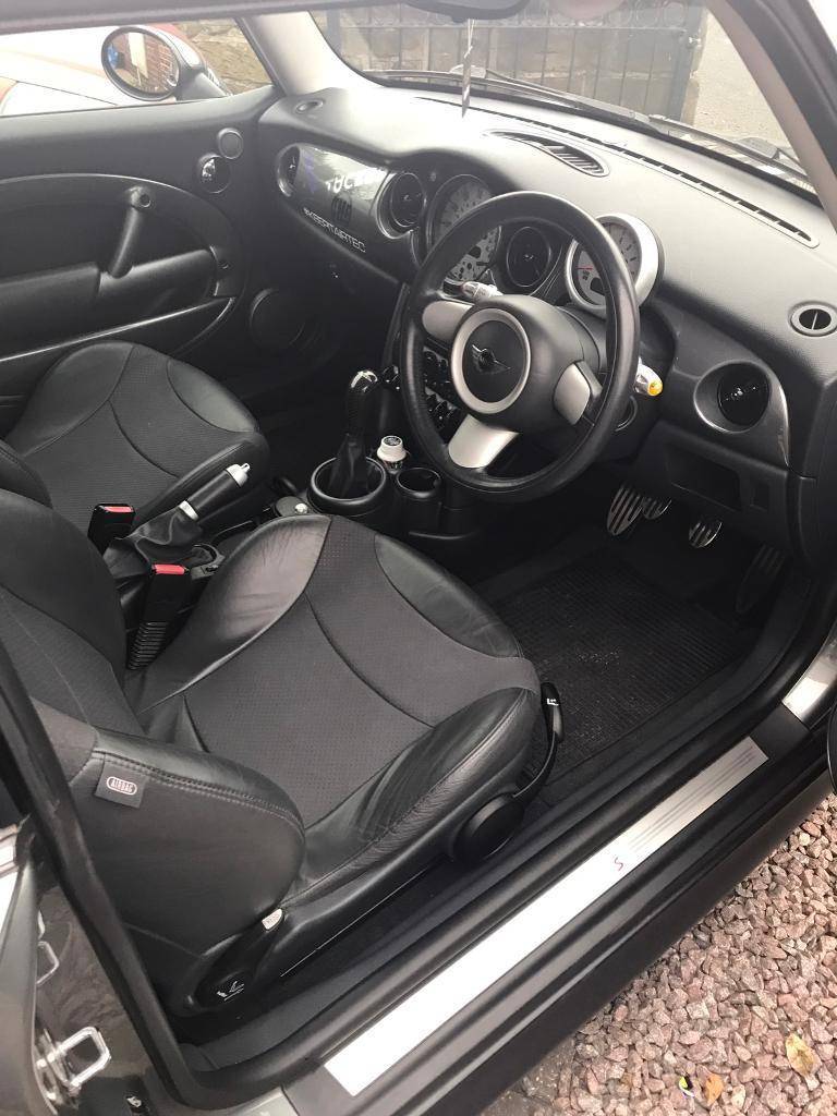

Pics from the advert

you have a digital speedo in the rev counter also :) glad your happy bud
Yeah I clocked when I was nearly home after buying it lol, oh and now the mrs and kids have been in it, it now tells me what the outside temperature is, how do I change it back?
3. Meister R's are epic for the money that they cost
ill look into the scangauge, takes a bit of getting used to having the speedo in the centre of the dash.

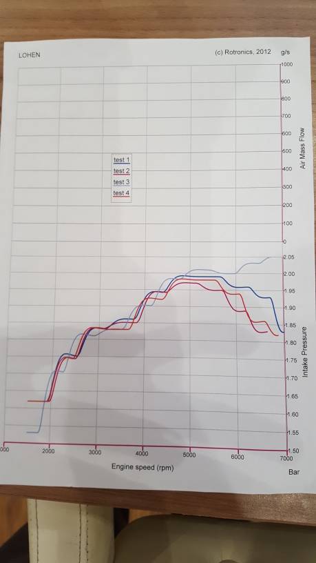

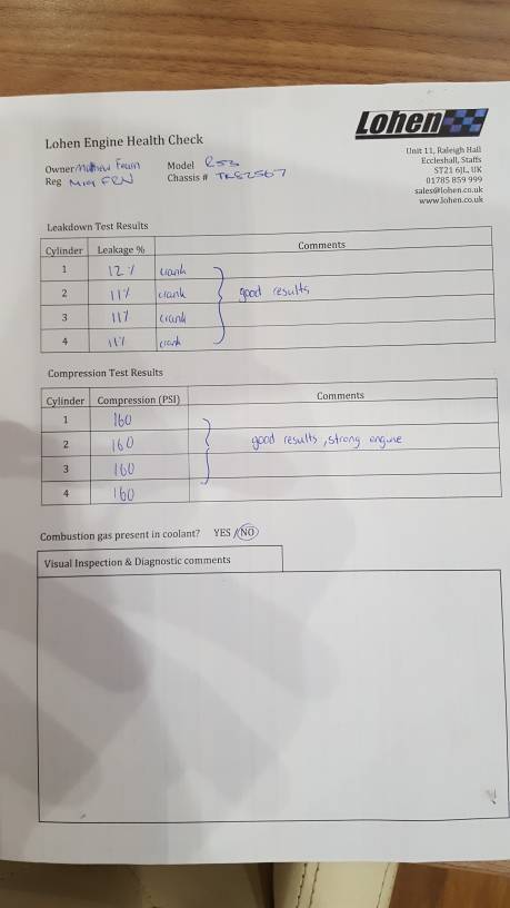

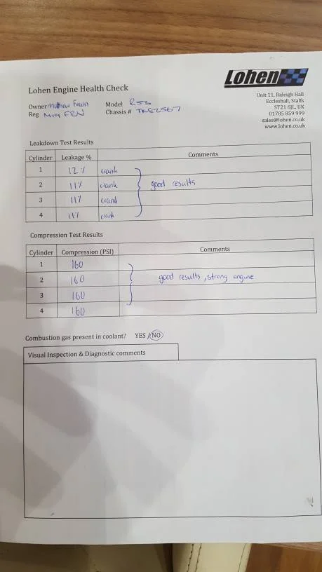

With regards to the power output, I have a print out from lohen, I'll attach it in a sec, I also managed to find an old owner on minitorque, with a thread after taking it to lohen for some work and a power run, again ill attach that, you'll see on the link there seems to be a boost leak which explains the inconsistent power runs, I also have a receipt for the car going back to lohen to fix the boost leak after, see what you make of it, I'll be honest I'm not mechanical in anyway, so I can only go off what I read/get told :up:
I've seen various power outputs with similar mods ranging from 200 bhp to 225 ish on minitorque, maybe it's just a "good one"?

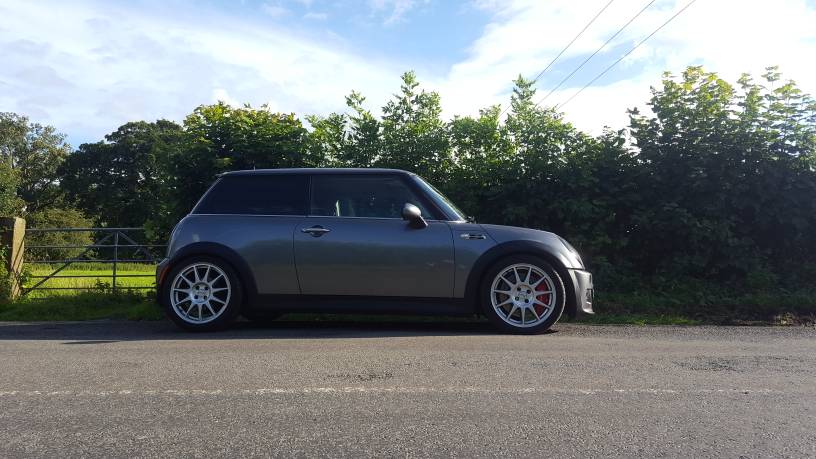

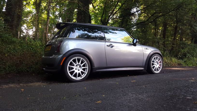

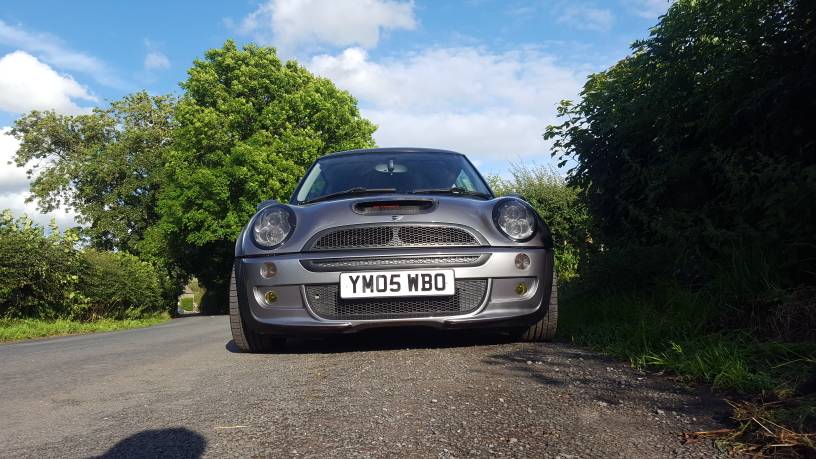

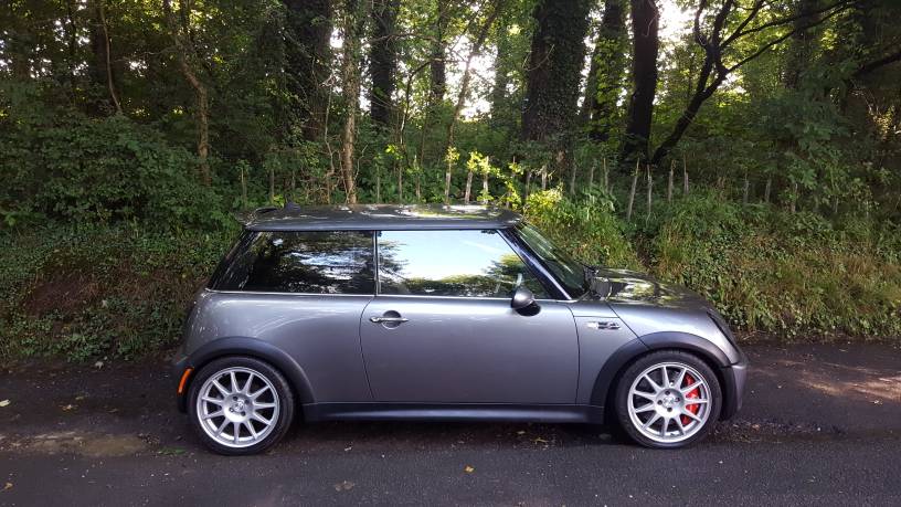

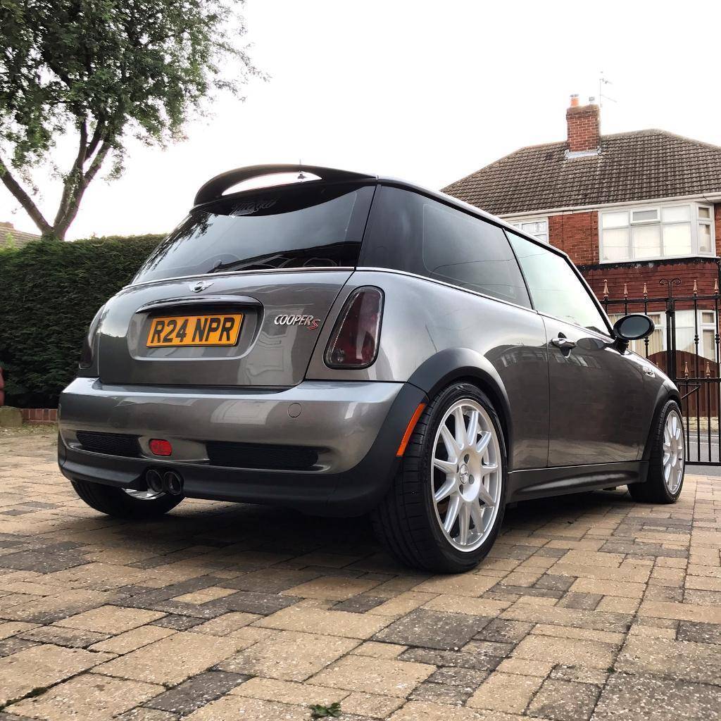

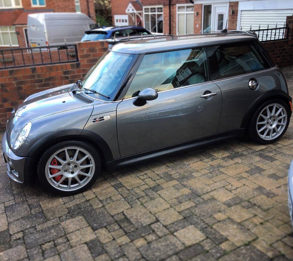

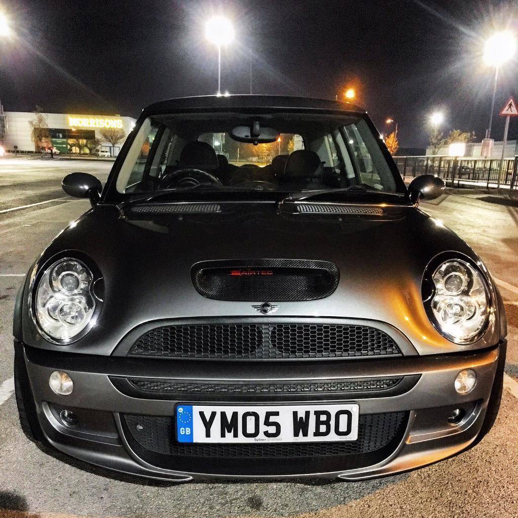

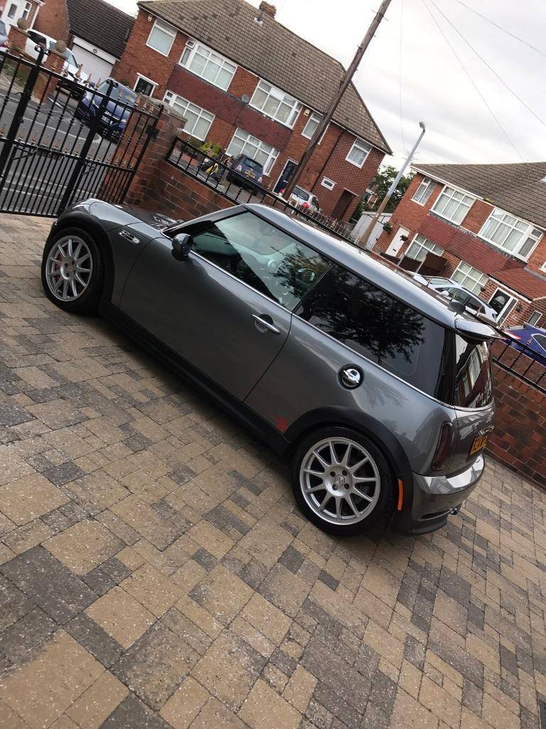

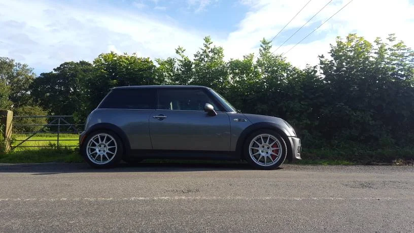

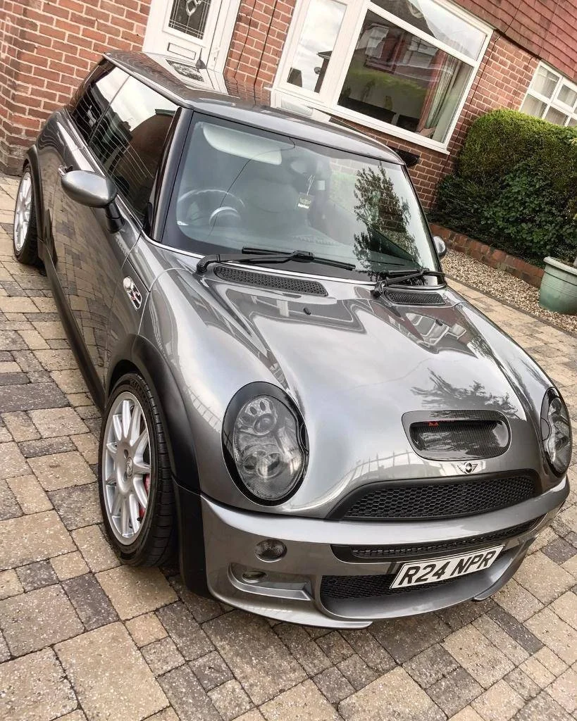

Finally the pics have landed! I drove a standard mcs years ago, think I had my Clio 16v at the time, I was not impressed tbh, I'm so glad I went for this over a Clio, I've had Clio's most of my driving life, but I've missed the great feel they give recently, this thing more than makes up for it, took it to the shops last night for some milk ( as you do ) down an A road through a few round abouts, absolutely love it, its like being in a go kart ha ha!
Would recommend a modded one 100%
  535d / t5 caravelle

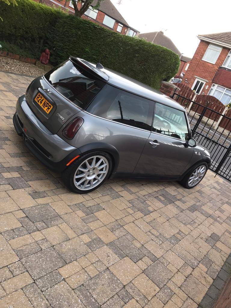

Looks great! I still love mine 4 years on.
That's a GP rear bumper trim btw, with US side markers :up: Expensive bit of plastic.
The driving experience has more than exceeded my expectations, love it!
Cheers for the info, I was doing some routing about on the forums last night, and noticed a previous owner had pm'd someone about some gp bits, didn't know if they where on it or not lol.
I'll adjust spec [emoji41]
  535d / t5 caravelle

That's really nice other than the dark rear lights!
How much do these go for??
Cheers, I need to look into what other options I have for rear lights, that can be tonights job, price wise anywhere on 3 to 5.5k from what be seen, this was up for £5250 I knocked a decent lump off.

the button on top of the stalk gies threw the trip computer @bill
Sent from my SM-G935F using Tapatalk
Winner! Kids are banned from going in it lol.

Looks great, personally i r4eally like how the car sits on those wheels, and overall i think it looks great in that colour too!
My family (mum in particular) has had Minis for as long as I've been alive, and if you want to relocate the speedo with OEM parts, look for a dual guage cluster off of a car with Sat nav, if i remember correctly the swap is nearly plug and play (although we have only ever bought minis with the sat navc, so i dont have first hand knowledge as to whether this is correct or not).
  535d / t5 caravelle
Cheers, just had a google at what you said and it looks like your right, it is pretty much a plug and play job, it doesn't bother me enough to change, think it's just I'm not used to it, cheers for the heads up:up:

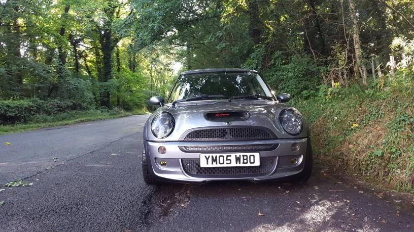

Lights.
whats the crack with the tail lights, do they do any decent factory ones that are worth swapping over to? Any in red? Any suggestions that suit dark silver best?
My current ones have that fly eye tint s**t on, I'm guessing standard would look better to start with? Although I'd like something different tbh.
Fronts are same actually, they also have fly eye tint on, they look alright though, Any usual upgrades for the headlights? I like the dark tinted style.
