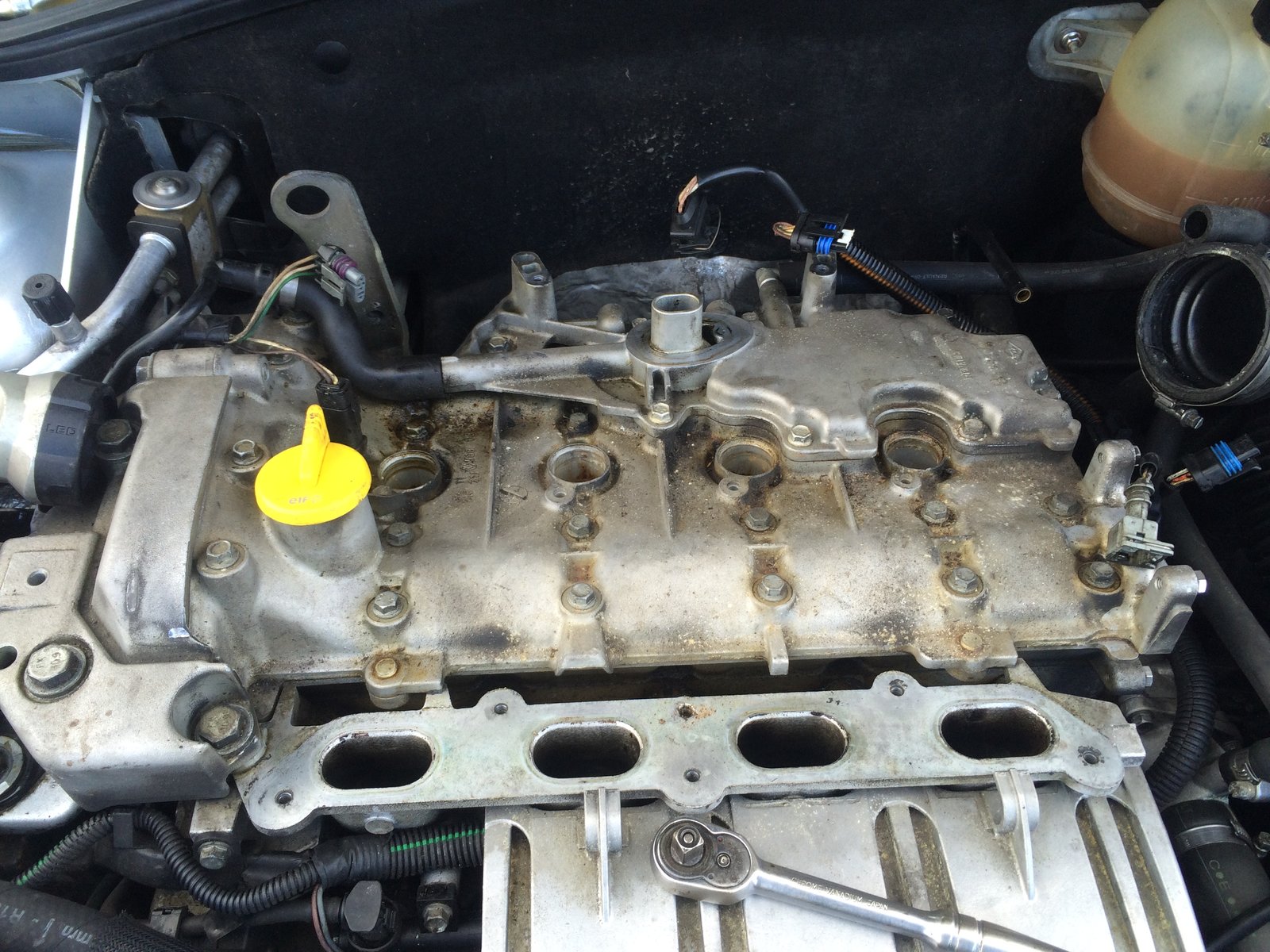

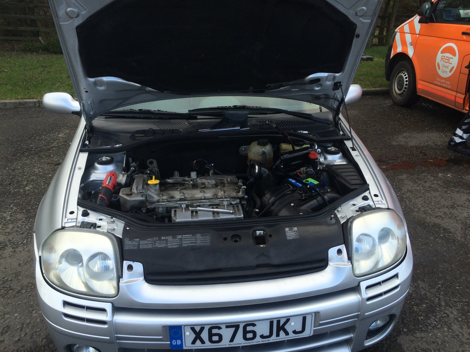

I think I have done the same trick. Tried to carefully clean the grime off my engine. Went to use the car a couple of days later and misfired. Just assumed it would dry off, driven 300 miles to Scotland and still doing it. It's intermittent, but mainly misfiring. Will it sort itself out as I am working away from home with no tools??
It did nt sort itself!! Got worse. Had to call out the RAC from M73 services south of Glasgow. The guy was good, checked for fault codes and none showing. Took the inlet manifold and found water in the spark plug well nearest to battery. Used compressed air to clean them out and then took all plugs out, they had rusty coloured water marks implying they had all been wet. Put it back together and it was fine. Nice fast journey back home. The lesson being never bother cleaning the engine bay! Not much snow on the A66, did nt get to test my winter tyres.

I made the exact same mistake with ours. Gentle hose down with gunk. Didn't even clean it very well. Was misfiring all the time. Took out three injectors, and the spark plugs had rusty threads as mentioned, with wet HT leads down the spark plug holes.
