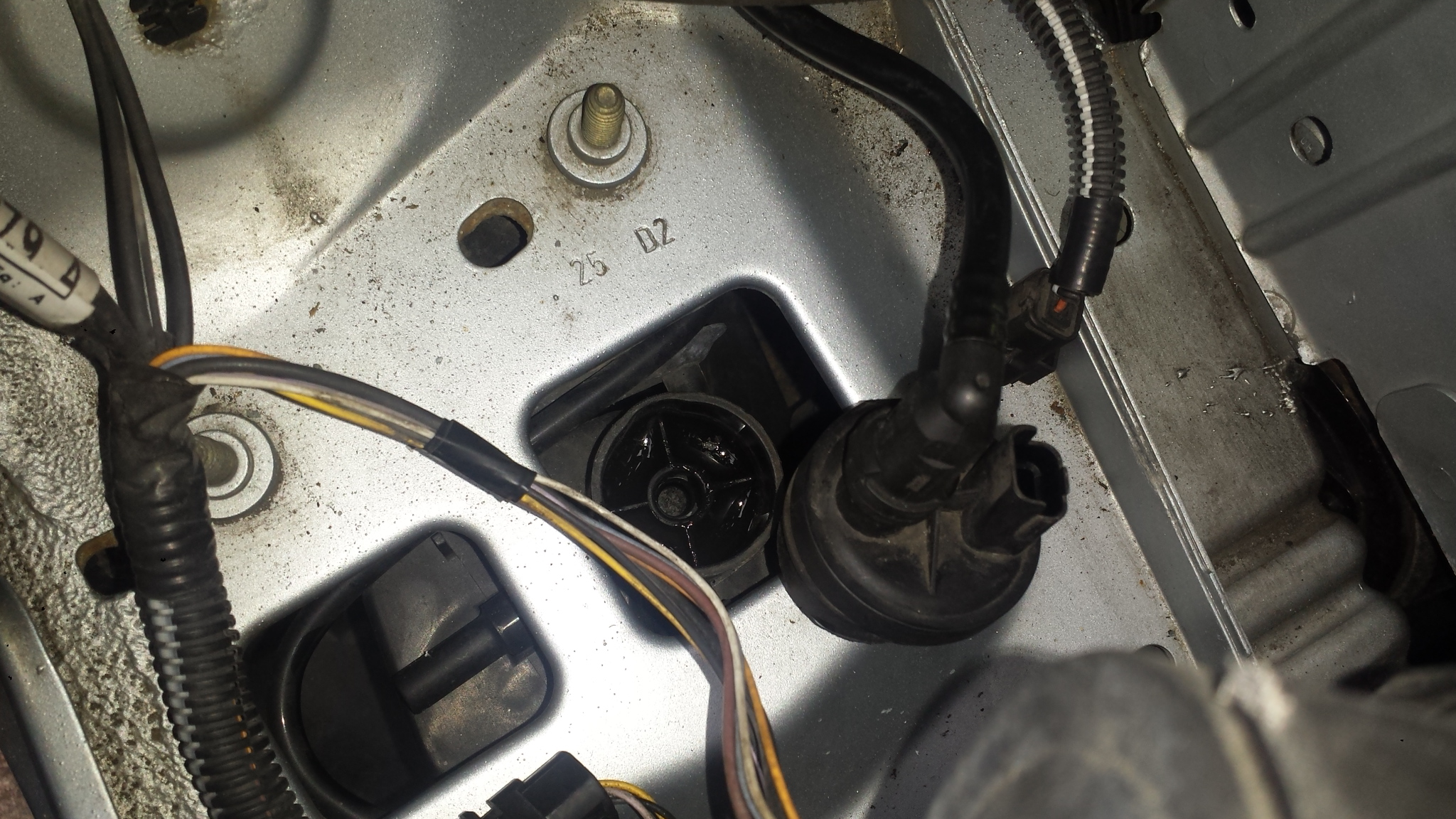

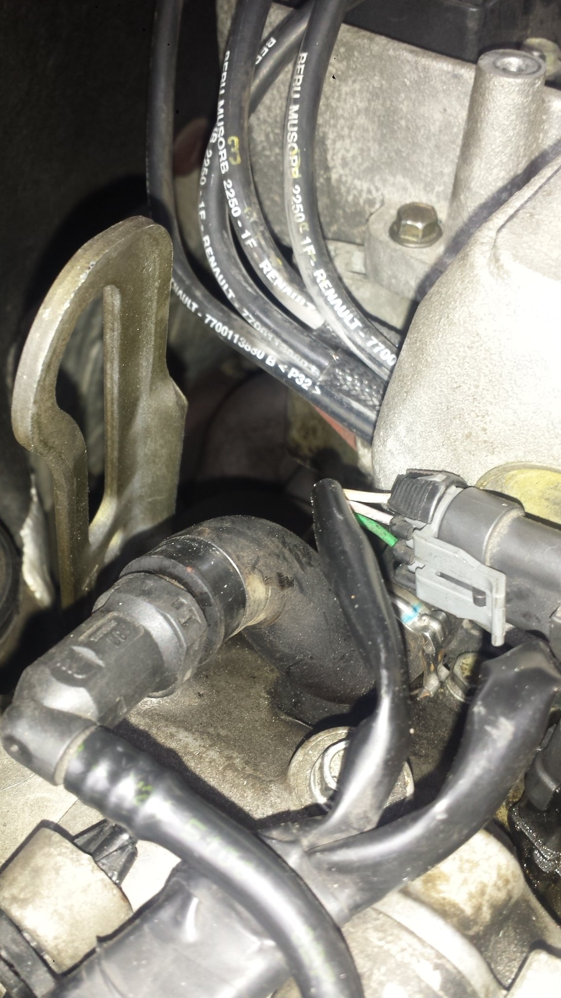

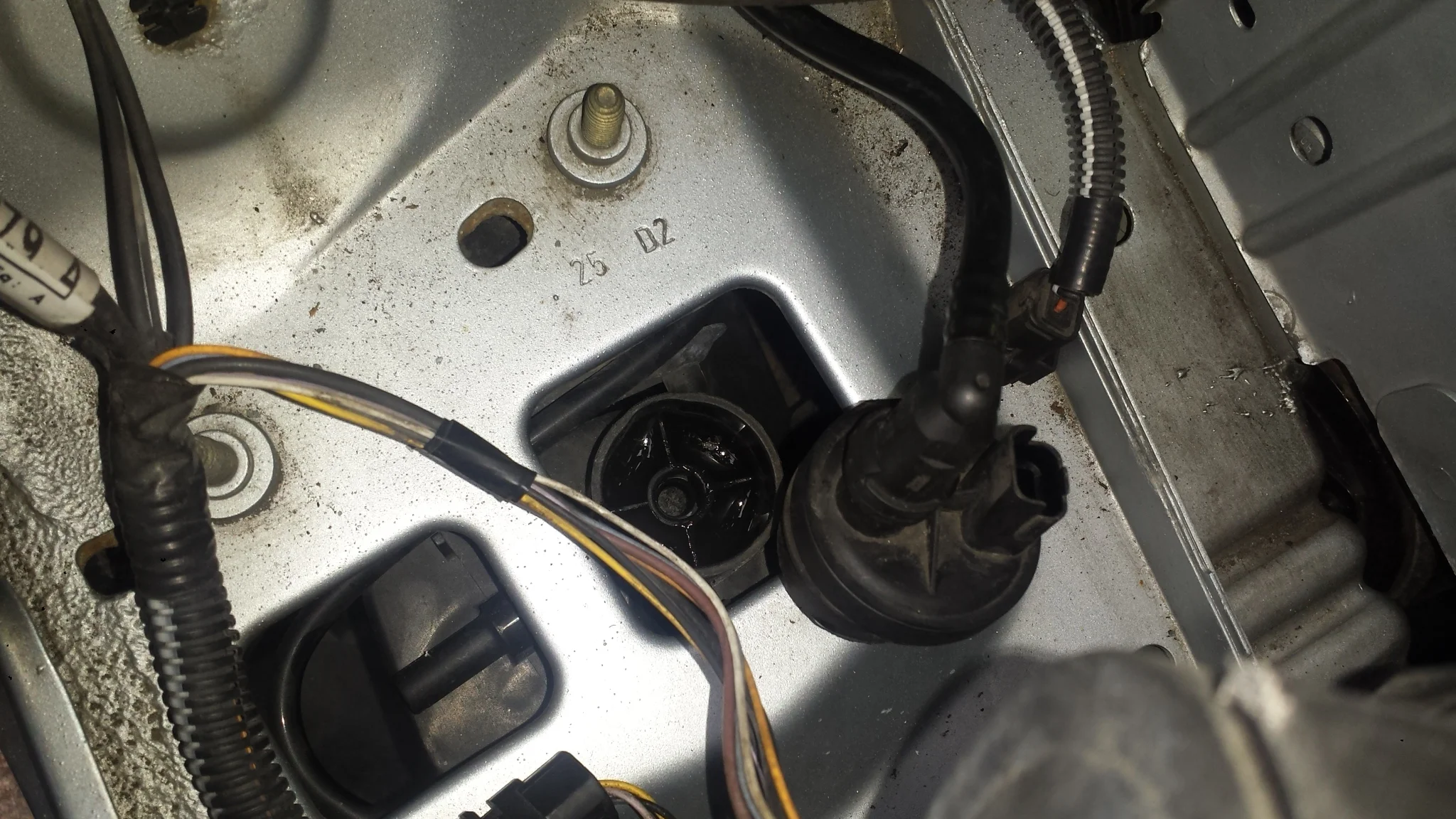

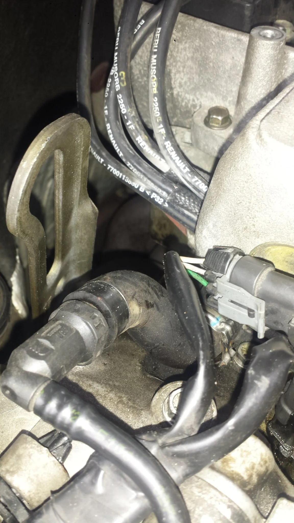

Can anybody identify what this is and what it does ? Because this one doesnt appear to do a great deal.

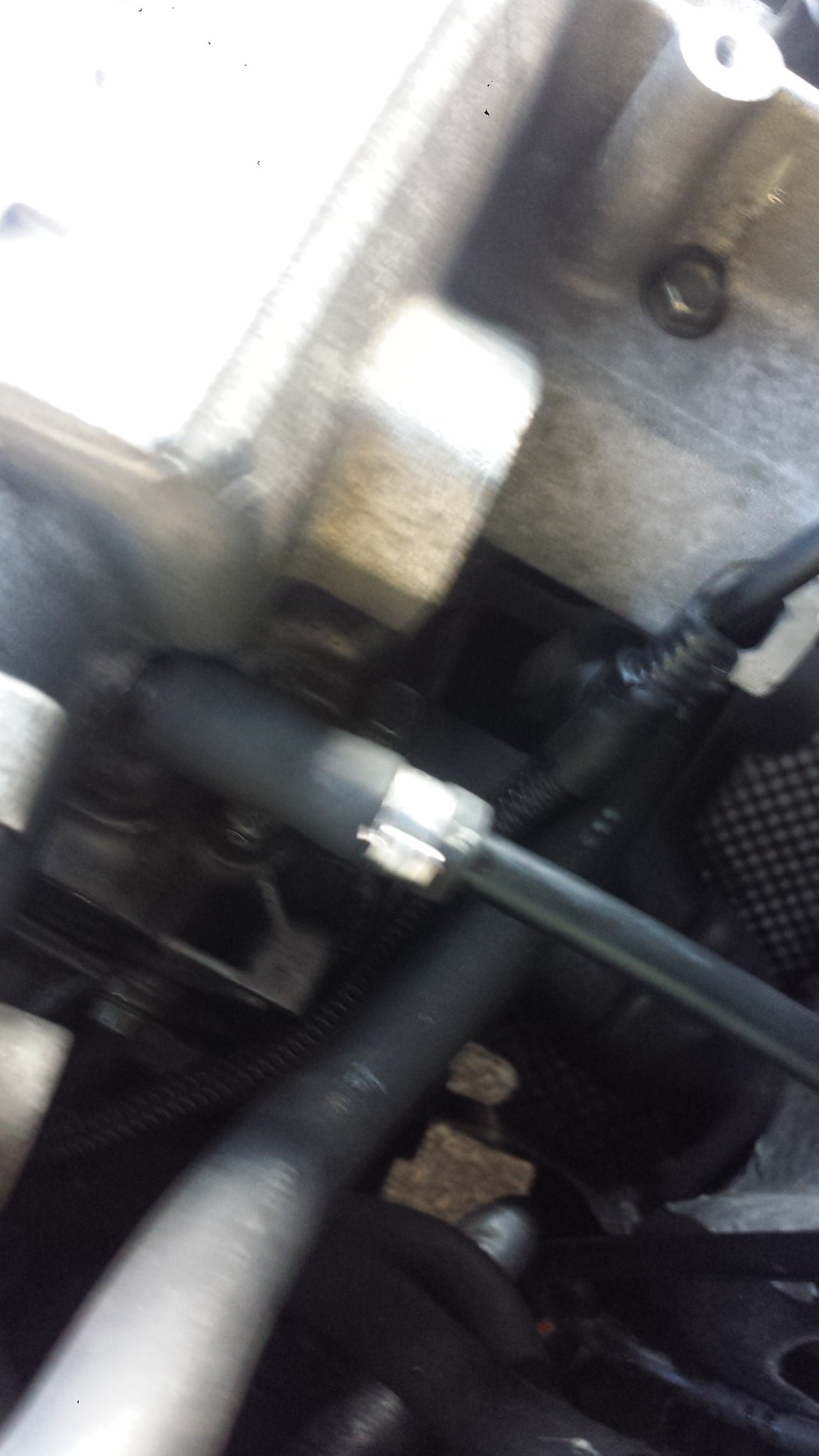

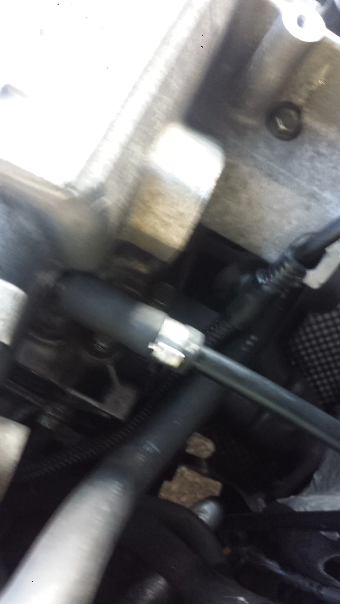

Im thinking this pipe may have something to do with my issue. If you let tghe car get up to temperaryre, ( roughly half way on the gauge ) and pull off this pipe and put it back on, the car runs sweet. No misfire, no bad idle - nothing. Not the bed picture admitedly, but it sits on the back of the throttle body and the pipe disappears somewhere behind the sound deadening on the bulk head.
