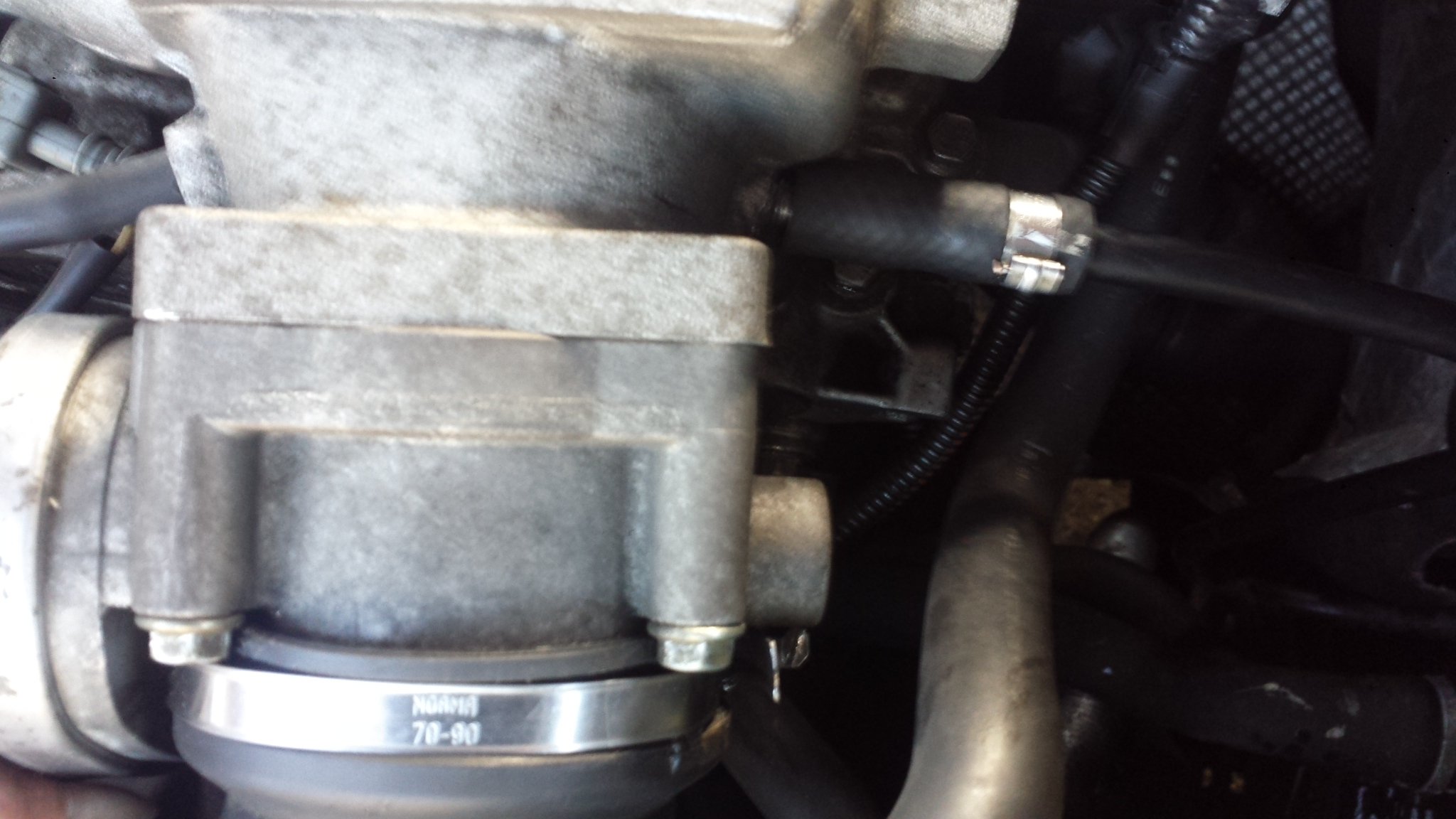

Sorry, i should have said. Thats sorted now... cheers. But i think we are getting close to the source of the problem here is a better picture, on the back of the inlet manifold next to tge tb.

Interesting! Thanks :smile:
Returning to the the forum rather than PM ing,the pipe at the cambelt end of the inlet manifold is for the carbon canistor.
The rear pipe(looking at the engine from the front with the bonnet open) at the throttle body end is for the brake servo.
The front thin rubber one that runs under the battery carrier connects to something referred to as an accoustic valve(although this is probably a coincidental effect lost in translation),located at the end of the wire reinforced induction fibre hose under the left hand side(sitting in the car) of the front bumper.
The accoustic valve`s primary function is to duct warmer air from the engine bay on start up,warming up period.
Fit an induction kit,cap the vacuum take off ,and bin the AV.
Any air leaks in the 2 remaining vacuum systems(canister/servo) will reak havoc with the fuelling
That pipe is the vacuum line to the brake servo. That will not cause a misfire i'm afraid... start with a reliable diagnostic and check the live data parameters. Until you do this you're pissing in the wind I am afraid.
Thanks for the replies. Surely if the car has a vacuum leak, in this case on the brake servo line. It will cause the car to run rich thus potentially fouling plugs the and will in turn cause a misfire ? 1 thing is for the, this pipe is affecting the running of this car in some way . I will try and get hold of a diagnostic machine to read the live data parameters.
