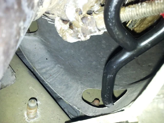

Any one tell me if there should be some sort of mount attached to the threaded bolt here in pic?
Exhaust seems to bounce quite a bit in this middle section.
Ta.
Looks more like one of the threads to hold the heat shield on.
Cheers danward.
Does it, hmm it seems like it needs some sort of mount around there as it is very unstable and shifts about too much in my view.
Anyone know if i could add one? maybe use the bolt as a start point??
Only mounts are the 2 rear, the plate mount between the back and middle box and then the one on the centre section.
Cheers Carlv, any ideas what it looks like? i am sure i'm missing one or something as it currently looks like this ( ignore the split! weld on order!!)

It is just after the middle box. A rod comes off and then sits in a rubber hanger. If you look under the car on the drivers side looking at the middle box it is at the back.

The bolt in question is unused.

This worked for me, but you may want to measure first. Cut the metal part down so only two holes are left, after the first hole, put a 90 bend in it & then attach to the unused bolt with a locknut. I can't remember the size, but if you are going to Halfords for that part pick up a pack of assorted lock nuts & there will be one that fits in the pack

Thanks again mate, looks like a M8/10 to me.
