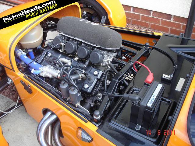

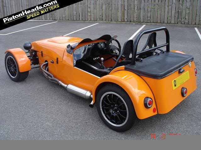

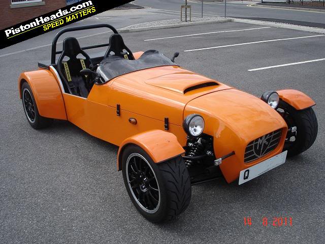

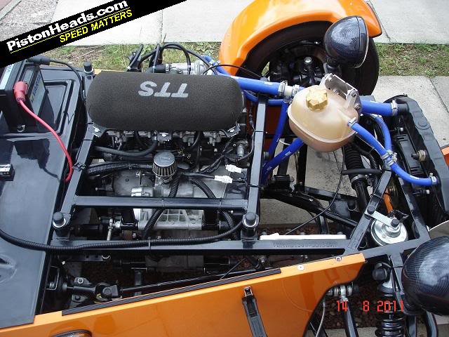

Spec off the advert:
2002 R1 5JJ Engine (running on carbs - rolling road tuned by Bogg Brothers)
TTS Performance air filter
MK 4-2-1 stainless steel exhaust system
CNC cut aluminium sump baffle fitted
R1 fuel pump with MK aluminium baffled fuel tank
Venair high temperature silicone water hoses
Powder coated chassis, wishbones and suspension arms
3:62 diff (also have a 3.91 spare)
Disk brakes front, drums rear
Protech fully adjustable front and rear suspension
Fully adjustable front top wishbones (made by wozsher from Locostbuilders)
7x15" Team Dynamics pro race 1.2 limited edition alloys (gloss black with polished rim)
Toyo Proxes R888's 195/50/15's all-round
MK Fibreglass Dashboard
R1 bike clocks with Speedo healer
Aluminium savage switches, Durite fuel gauge
Fibreglass Aeroscreen
OMP Superquadro steering wheel, OMP Alloy gearknob
MK GRP seats (drivers seat with adjustable seat runner)
MK Fibreglass Boot tray (lots of useable space) with custom made leather boot cover
Sabelt Harnesses
Aluminium footplate in passenger side

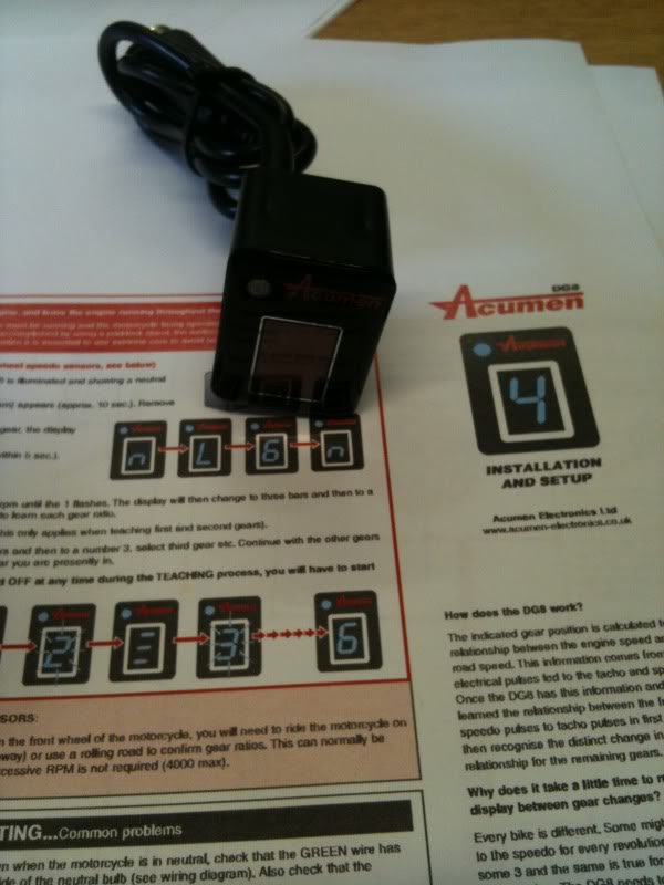

Next job is to fit this:
So I can actually tell when gear I'm in and stop me going for 7th and hitting neutral a lot.

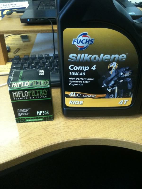

Next jobs will be, new brake fluid and an engine/gearbox oil change.

10W 40 in a busa engine? is that what they take?
(im am italian biker)
I always use 15W 50 in mine.
And the last Hi-flo oil filter I bought didnt seat right and seeped. OE on Suzuki is better.
10w40 is recommended in the Yamaha R1 hand book.
