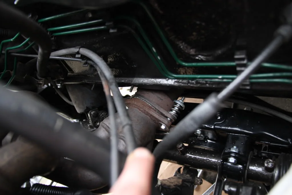

Got a major rattling problem, the flange on the manifold and the downpipe are pretty much touching the subframe.

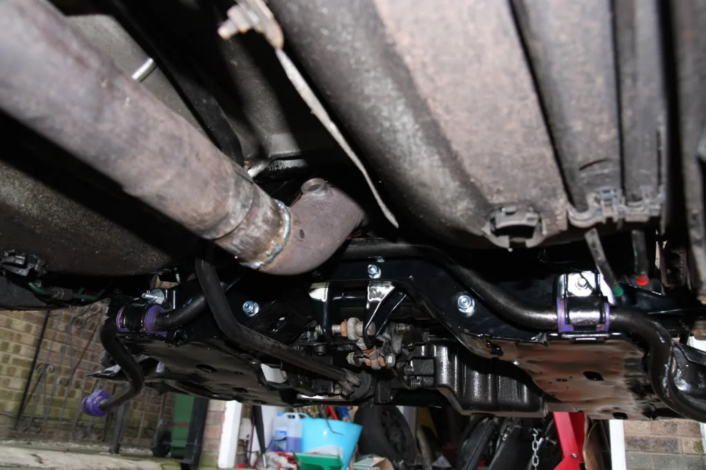

Plenty of room between the flange and subrame on mine, then clears nicely though the gap...Whats your downpipe been made from?

I had a good look whilst it was in the air and the top side is fine. its the bottom end when it goes over the subframe. The guy at powerflow says because of the angle of the flange, a new pipe will still hitting.

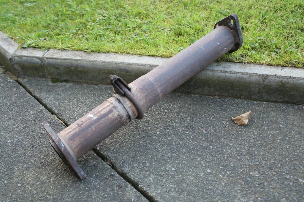

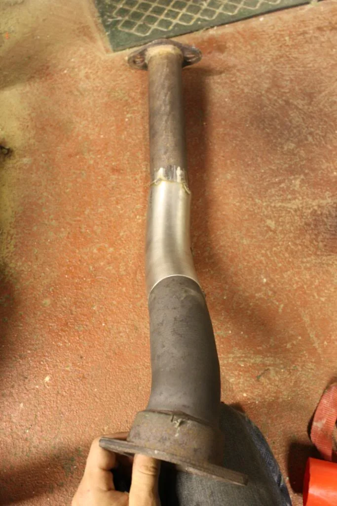

Its the same size as the proper 172 downpipe, as thats what its made from...

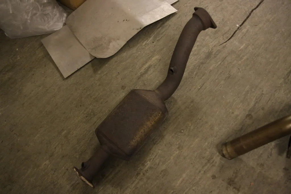

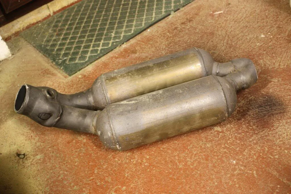

Take one 172 single box cat...

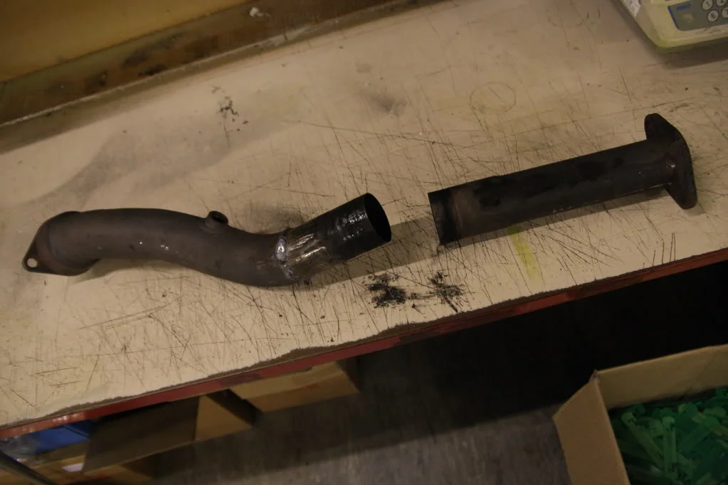

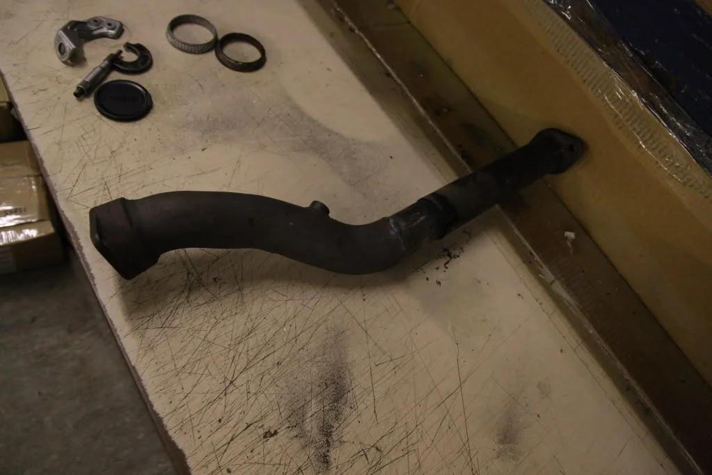

Cut the downpipe part off...

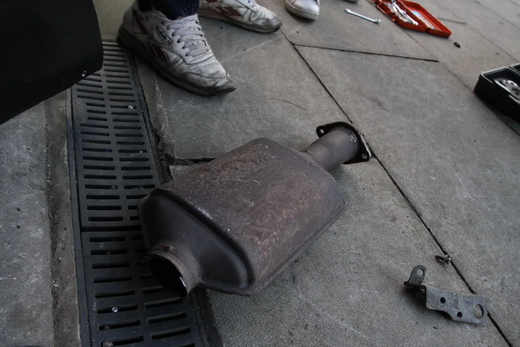

Take one Mk1 decat (only pipe I had to hand at the time), which is the same bore...

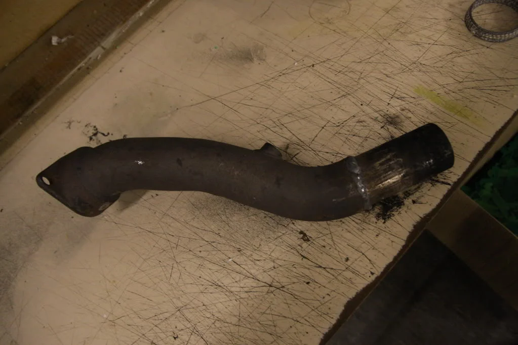

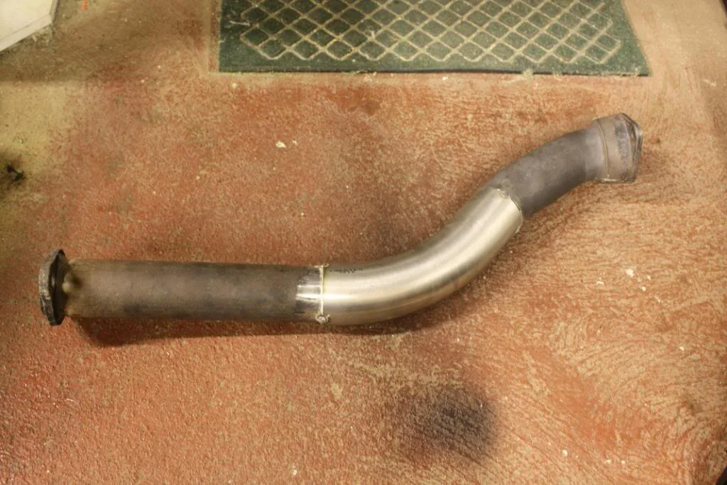

Cut one flange off and weld to downpipe...
Fit to car, adjust to correct length for Mk1 exhaust, then weld solid...

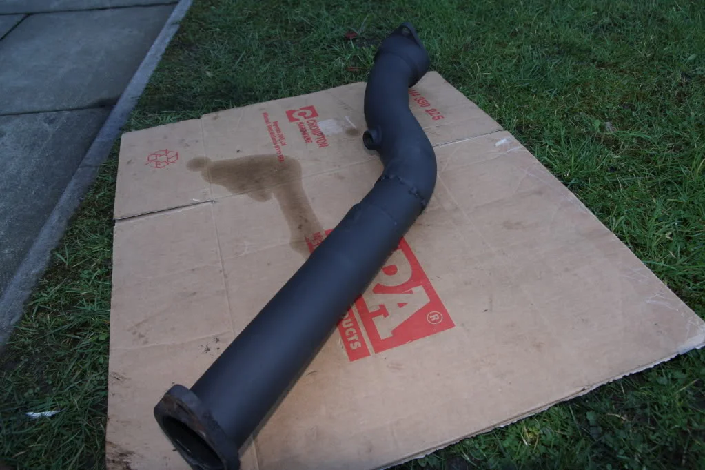

One finished downpipe that fits the gap perfectly and clears in both directions...

At the minute, it kind of looks like f0xy's but has two wholes for both lambda sensor's. Think i'll just try and build one and bolt it on myself.
