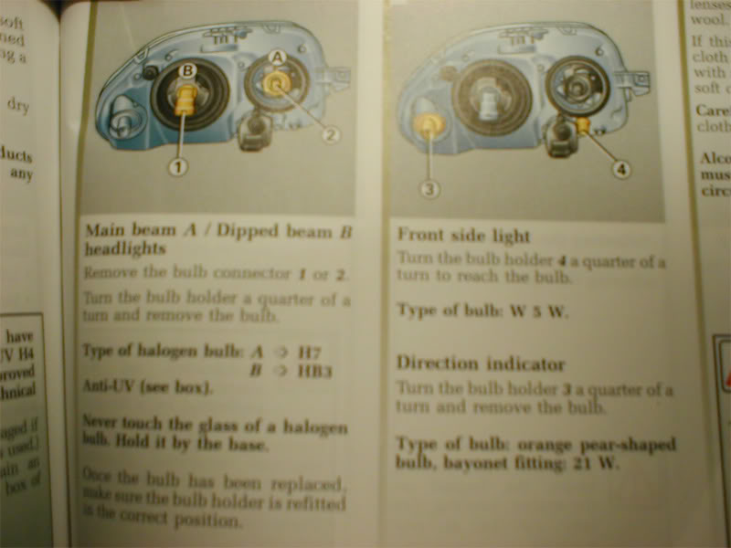

Right I need to change the lights on my Mk1 172 as a) they a dreadfull, light up nothing, b) one of my side lights have gone. Trying to work out which bulbs I need but its giving me a headache. Car is in the garage being repaired so can't look. So from the below pic (sorry for using you pic Day) can someone tell me which ones I need. If you work from the outside to inside, is it Indicators, Dipped, Sidelights and Mainbeam?? Is the sidelight and maim beam diff. I get confused between all the terminology, ie dipped, mainbeam, full beam, low beam, high beam etc.

I assume the dipped and main are seperate as they come from diff parts of the light assembly. Im actually after the bulb name, ie H7, H1 etc. I need the name of the dipped beam one, anyone help. Goging to get SilverVisions while Im at it too.

I thought the sports lights were pretty good tbh, I'm happy with mine but have uprated the bulbs to xenon gas filled ones and they are even better!! Tom wheres your car owners manual?? tut tut!

Lol...What a pillock. I can't believe I never looked in the Manual. Obviously haven't got tthe manual now as the car ain't here. But thanks you Mitch :).
Yeah sports bulbs are Ok, but not sheading nowhere near as much light as they should.

dipped/low beam are HB3, Full/High beam are H7's
Silvervisions are prob the brightest, some say PIAA but i've yet to compare the two lol

Oh and I think the fogs are H1 iirc, are you still coming on sunday?
