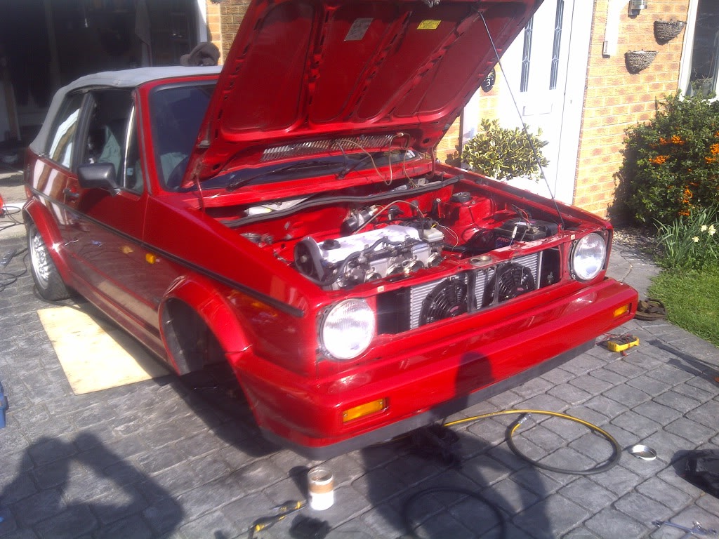

The car started out as a 1.8 carb clipper model. We have fitted a 2.0 abf engine from a mk3 gti with twin 45 carbs. Its running the edu from a mk2 kr 1.8 16v which is taking care of the ignition side of things along with the mk 2 distributor set up.
Well today it ran 207bhp peak power but that has been reduced to 188bhp after the Carbs have been altered some more to give it better driveability an a smoother torque curve. I will add some more pictures an information later of the build an finished product. C &C welcome.
Yeah i'm gonna post up some of the build an the finished product. As for the Carbs the main reason was that the manifold is readily available an its tried an testrd really an the manifolds for the bike Carbs usually contain rubber joiners to join the Carbs to the manifold which looks abit naff an in our opinion doesn't look like it'll do much for the flow ;)

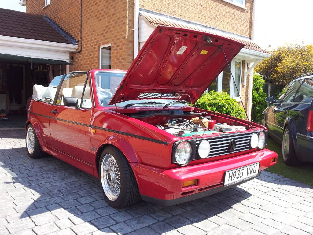

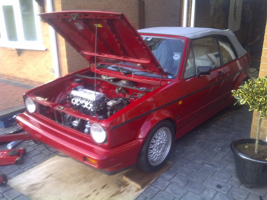

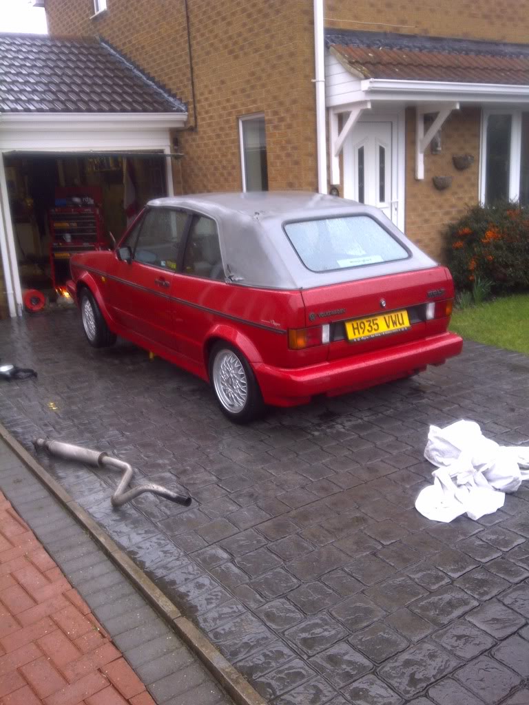

Few more pics of the completed car, a few more things to put on it like an early mark 1 grill an chrome trim an replace the the black trim down the side with the chrome on too
The wheels are proffessor split rims (genuine splits)

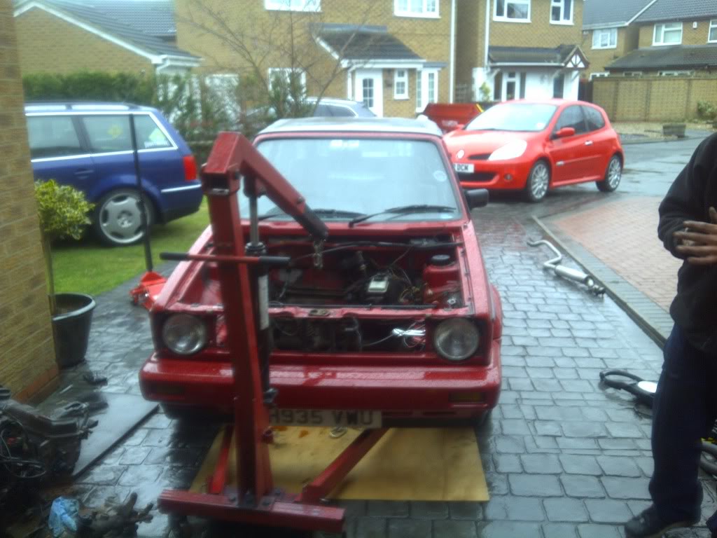

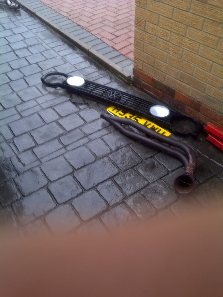

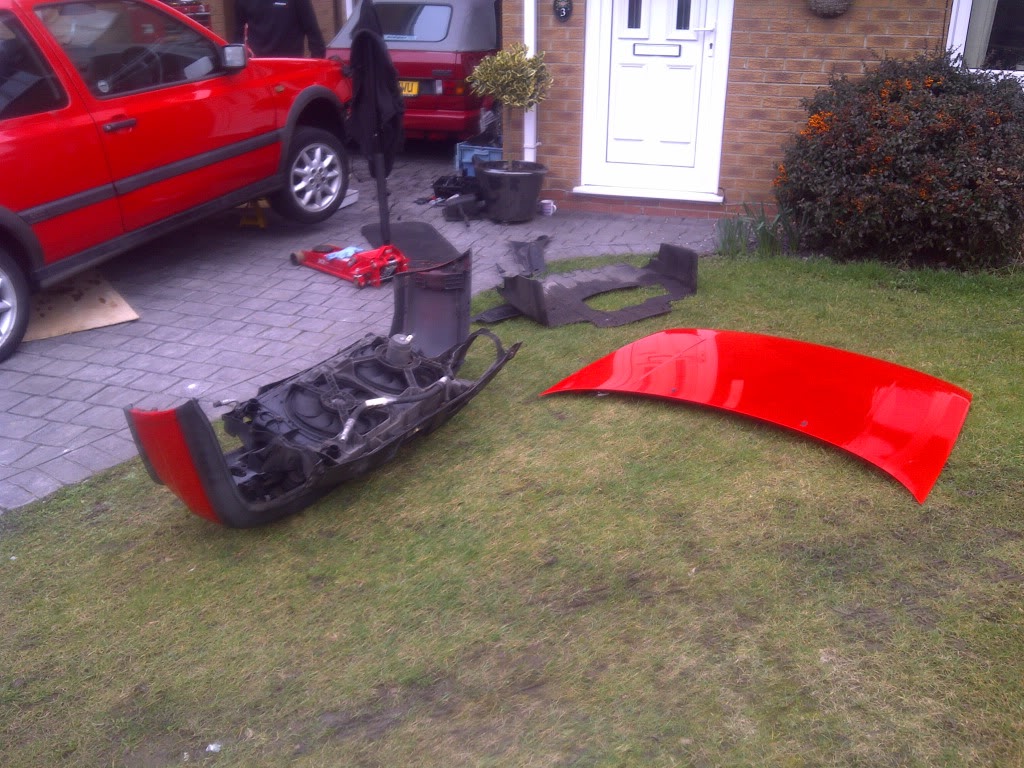

Day 1 (stripping the mark1)

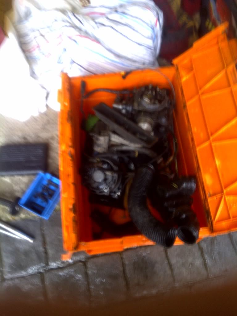

boxes of bits everywhere

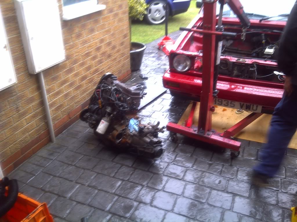

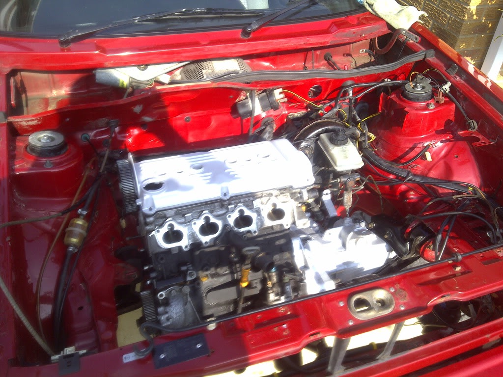

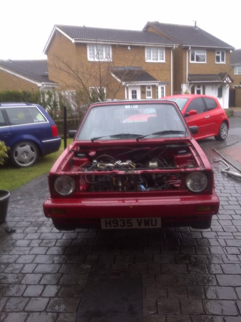

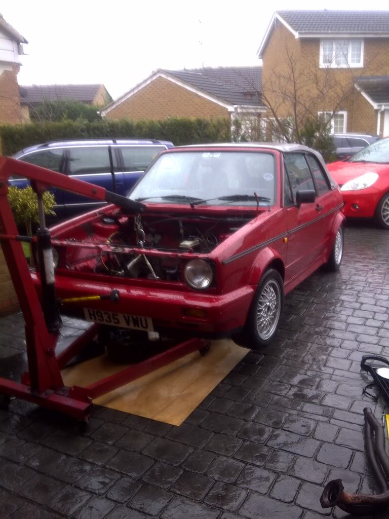

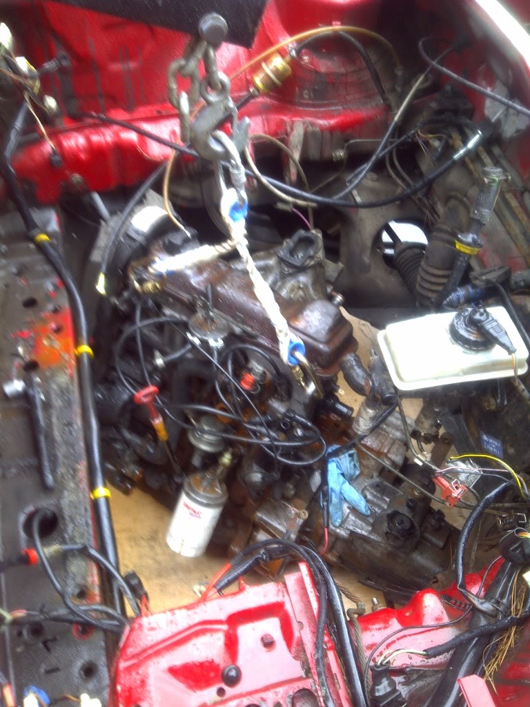

engine out

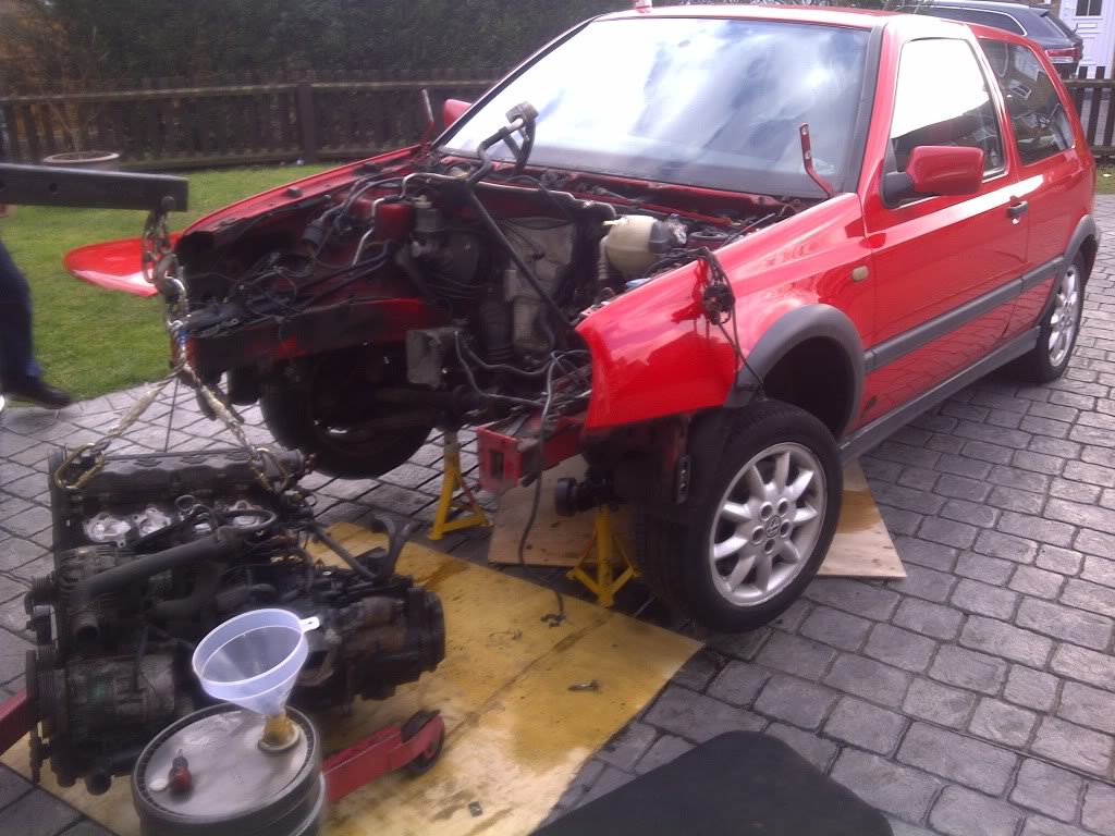

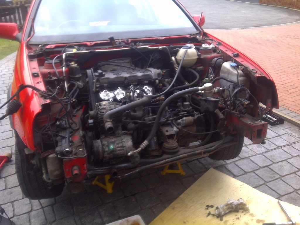

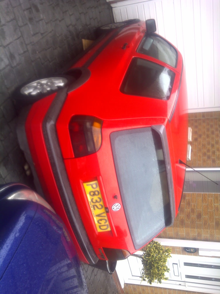

Day 2 stripping the mk3 donor, brought for 300 quid with 12months mot
We made a bit of a mess but it was all done an packed away before his missus got home (she doesn't agree with it lol)
Before removing the engine we checked it over madesure it was running sweet i.e compression, oil pressure, running temps an pressure tested an gas tested the coolant system. Once it was out we fitted a new clutch, cambelt and a few other seals an then just a good service.

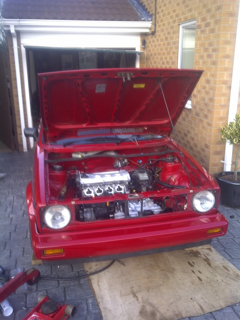

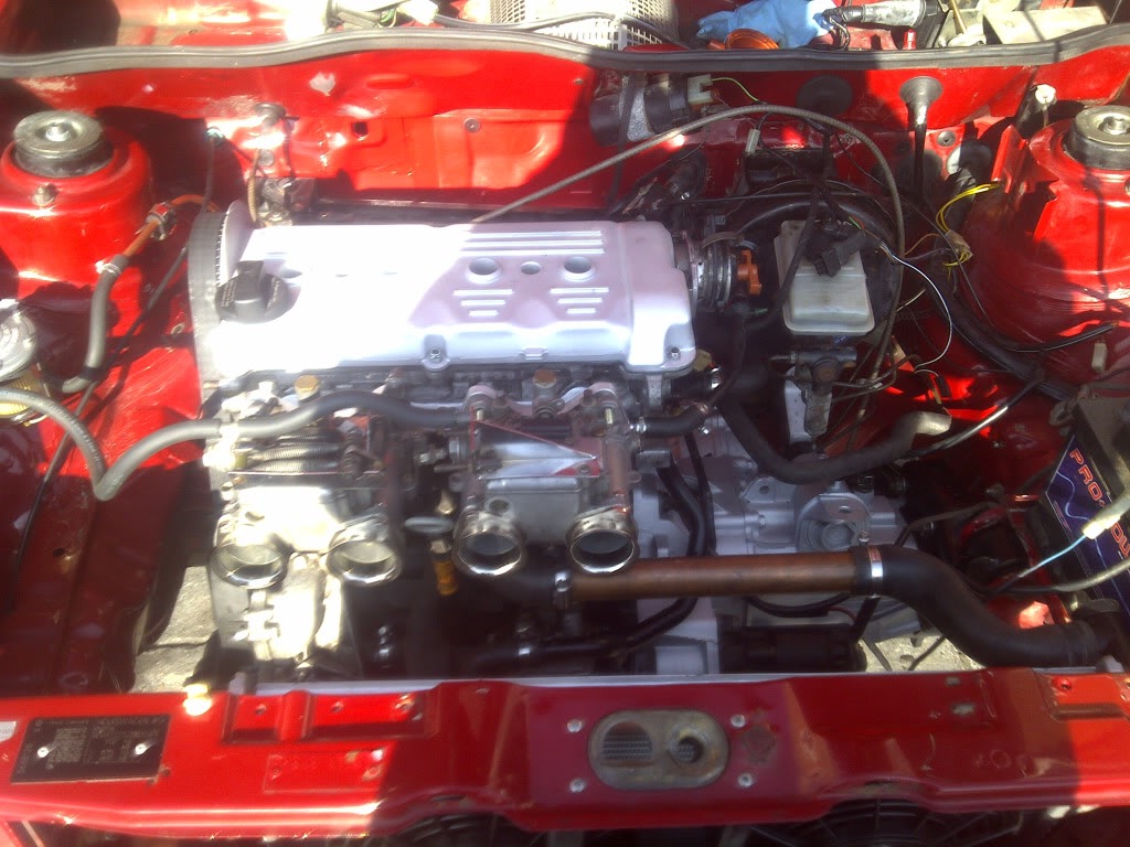

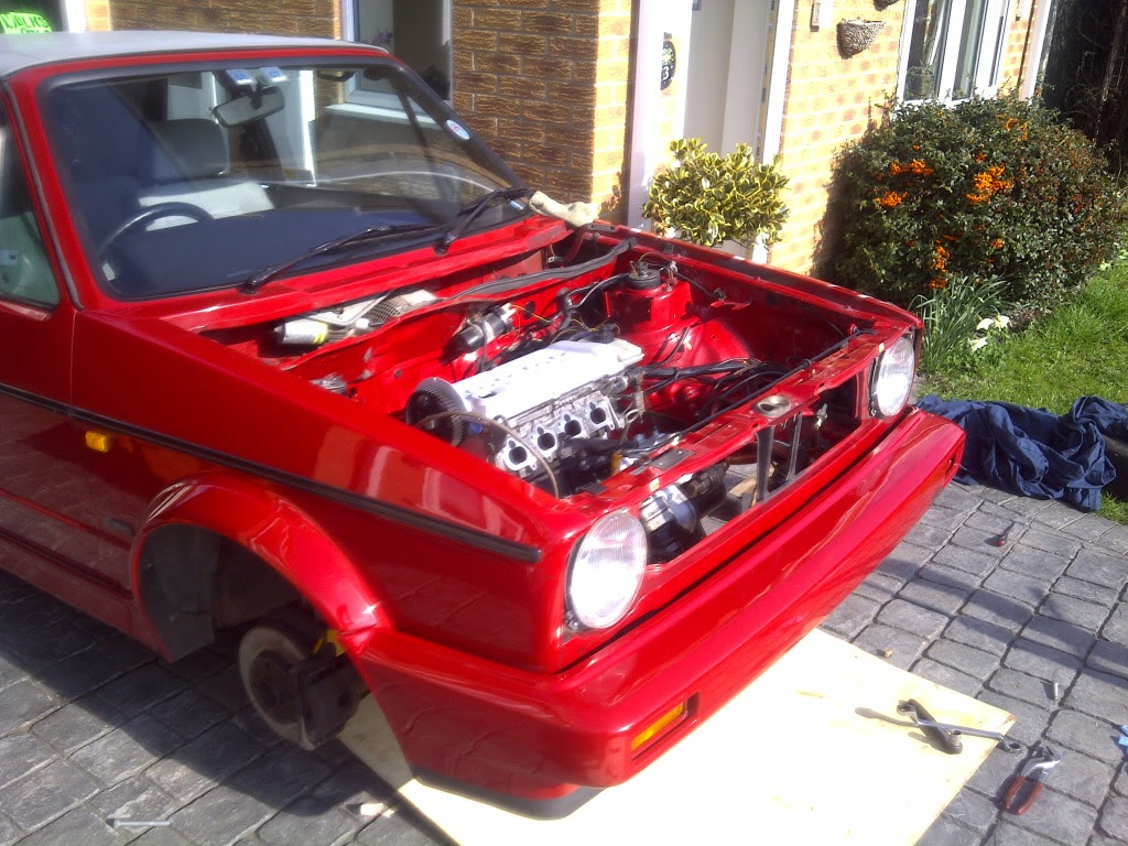

Engine in place

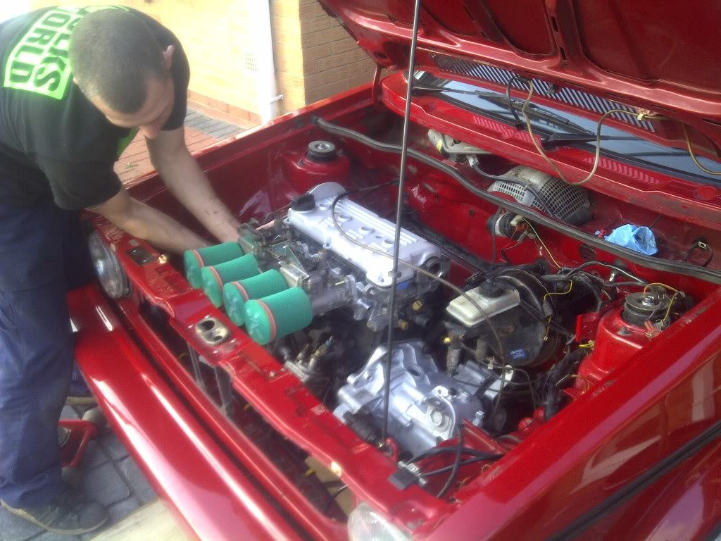

trial fitting the carbs

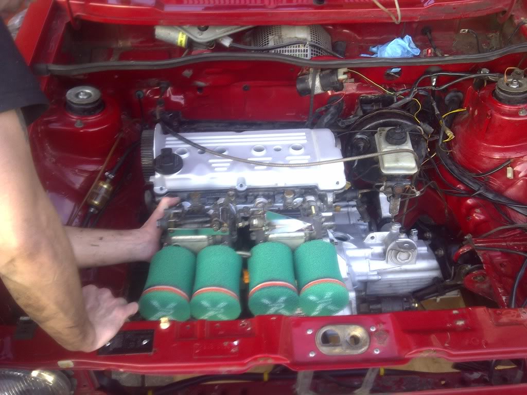

One without the filters
Thats all for now, hopefully a few more videos but even after we roughly set the carbs up ourselves using colortune an balancing them an getting the timing spot on the thing was savage at 207bhp but now they've been tweaked on the rollers it should be mint, haven't been able to put it through its paces due to todays weather ;)

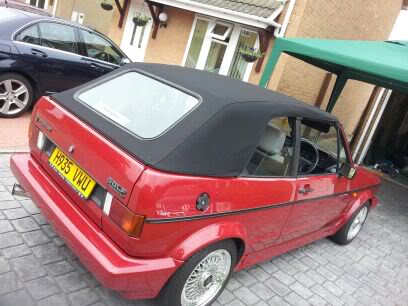

New black hood (mohair) fitted
