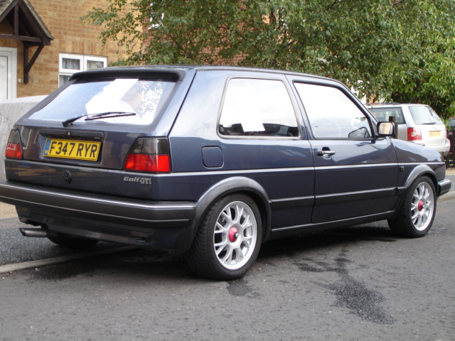

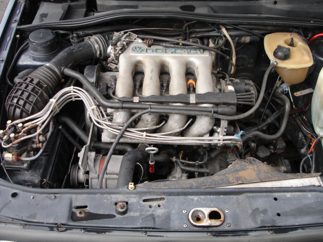

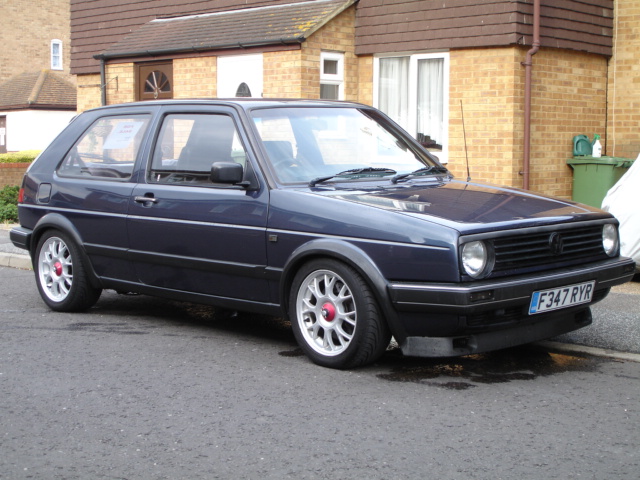

I had a MK2 GTI 8v, bought a 2.0l 16V 9a engine and gearbox out of a Corrado that had been hit in the rear. I had to convert the Corrado gearbox from hydraulic to cable clutch which was easy enough.
I then had to buy the fuel pump, metering head unit and inlet from the MK2 golf GTI 16V. The 9A engine is a short stroke where as the 2.0l 16v out of the MK3 Golf is a tall block.
VR6 engines are to heavy and not that much power, if i ever was to to buy another MK2 golf i would go 20v turbo.

Pretty much spot! Did you stick with 9a cam? Or go for the KR? I would go with a KR cams. I keep looking at 20vT mk2s there is a nice pearl gray one I have seen for sale!
Mr R.
  A special one.
I did have one of the 1.8 16v cams fitted but i dont remember which one, i only had one because i got told that the other was the same???
