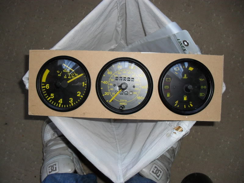

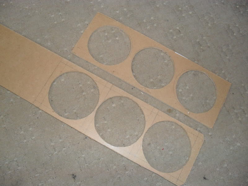

start of the new dash pod design :D

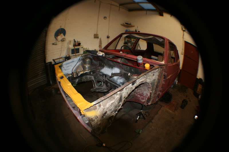

acid etched the slam panel and filler primered to make it nice n smooth , needs a little work still tho

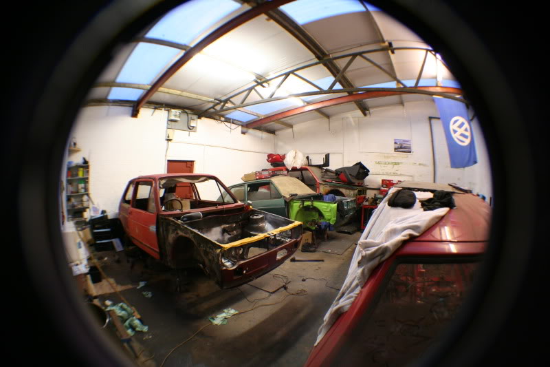

the workshop

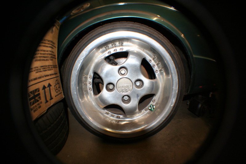

and a random wheel pic lol

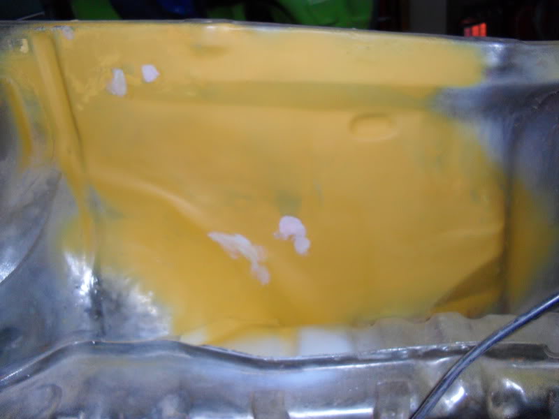

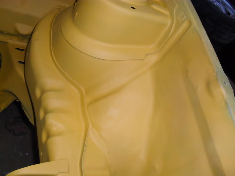

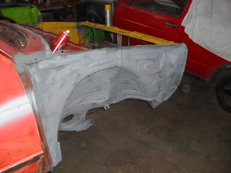

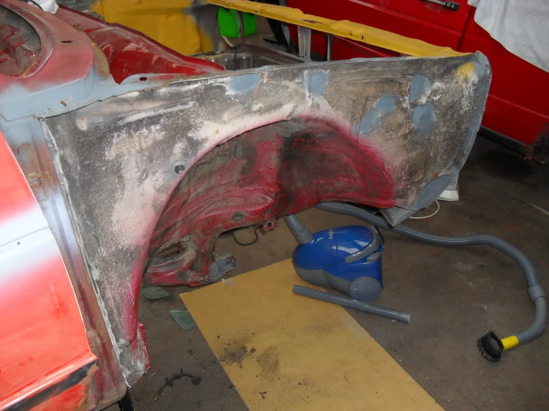

cleaned up and primered inner wings :)
have left the original underseal on, just cleaned them all up, removed any crap and treated any bare metal with zinc to stop any corrosion

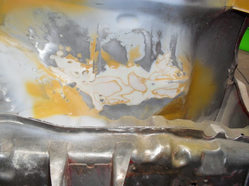

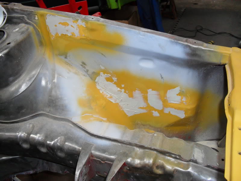

after a couple of layers of work
and more
Also where the battry tray had been id made a right mess, first time id ever used an angle grinder what can i say so needed bogging and smoothing :D
happy with that, bit more to do tho

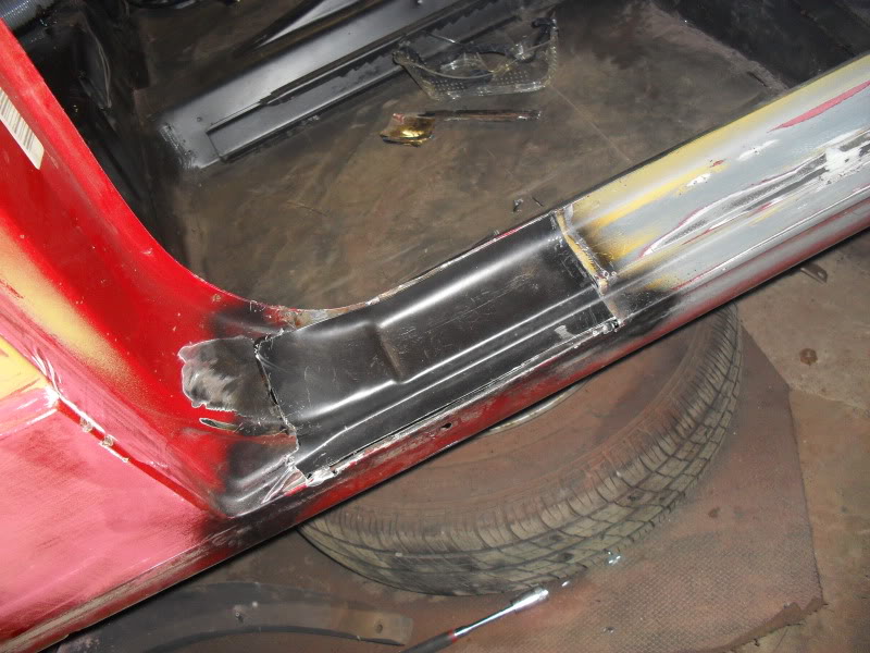

Sill repair pannel all ready to be welded in :D
again another thing im chuffed with its been a right pain

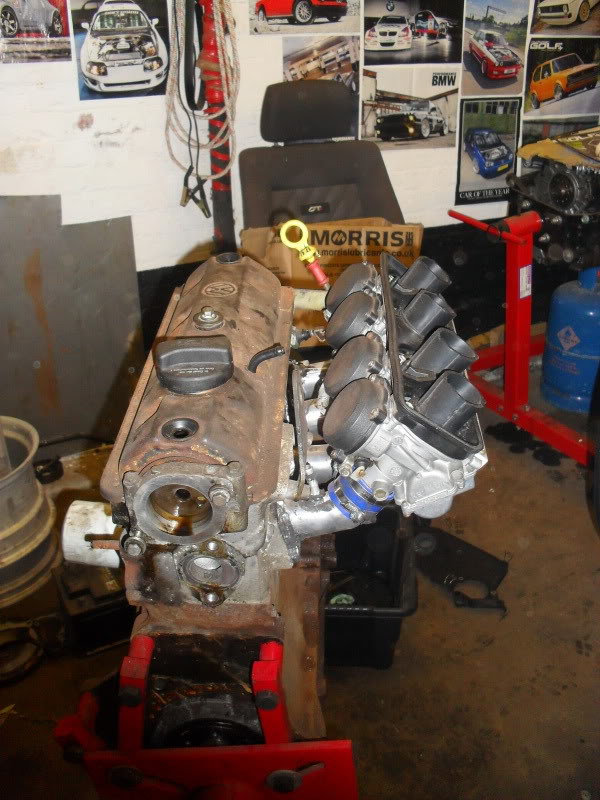

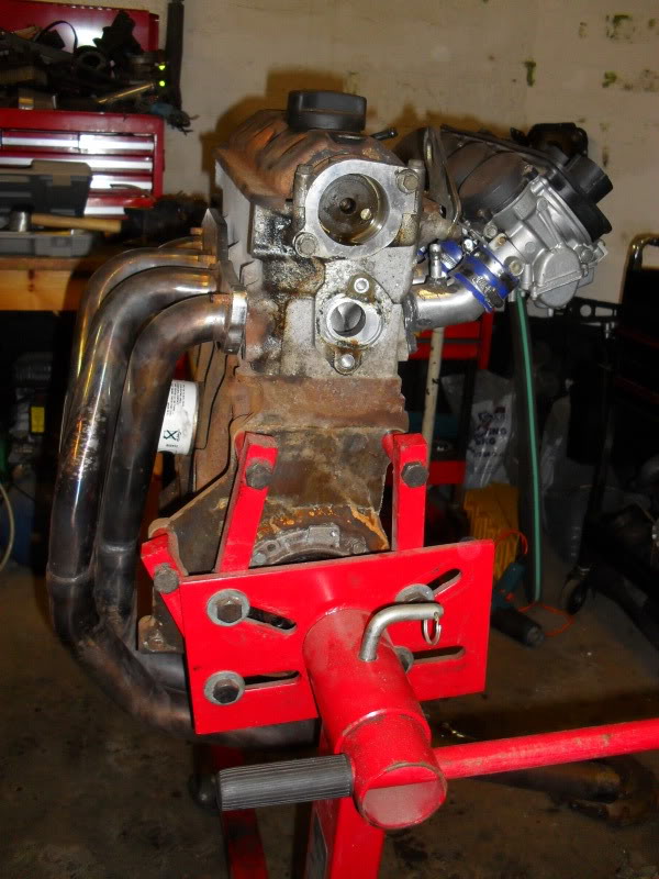

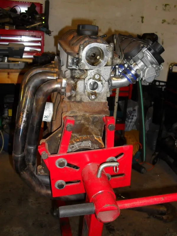

engine on stand
trial fitting carbs and manifold... got a bit giddy at this point lol

on the carbs,
exhaust manifold isnt, dont think they do an exhaust manifold

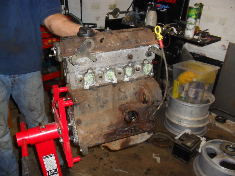

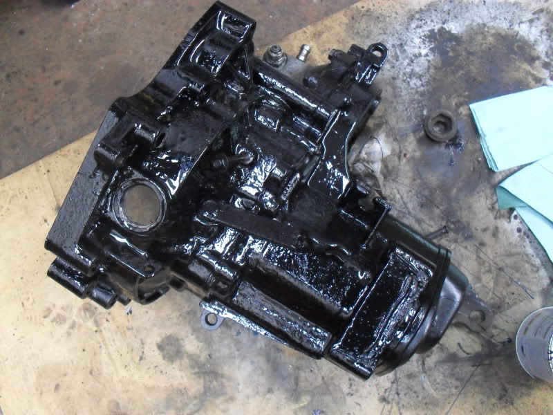

engine n ger box all striped and painted... gearbox went a bit funny tho, not sure why

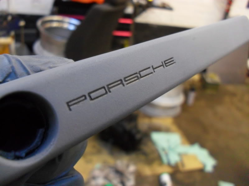

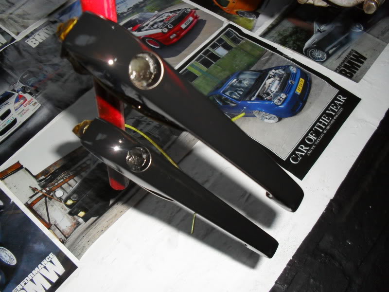

Porsche handles primered and being painted

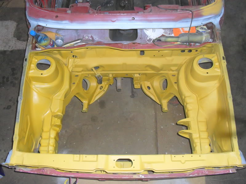

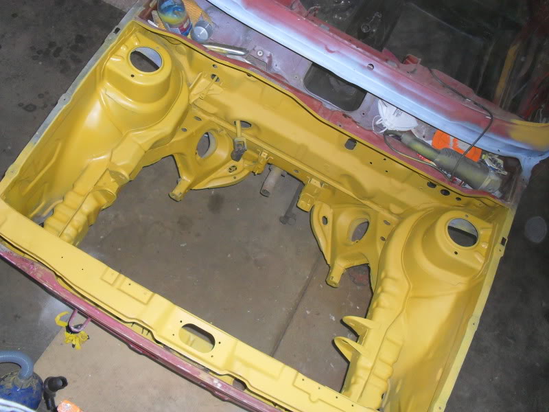

and the bay primered!!
