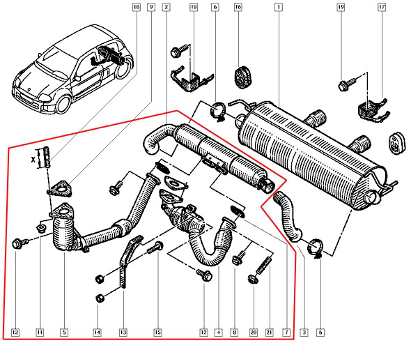

I think they are different-
The joins @ the top of the pipes that go to the manifold have a different stud/gasket pattern IIRC-
Steve
  Clio v6
Stuff inside red line after the back box is different between mk1 and mk 2
http://cgi.ebay.co.uk/ws/eBayISAPI.dll?ViewItem&item=120479468047
