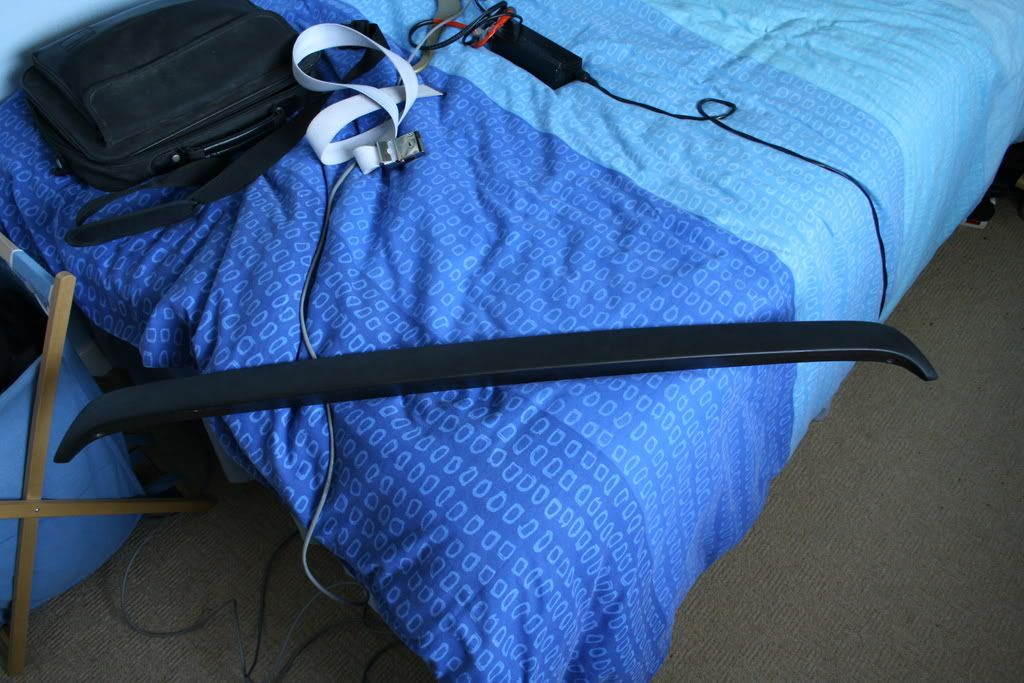

Mk1 Spoiler???
It looks like a valver spoiler to me, it'll have two screws (one at each end) I'm not sure on the clips though - you may be better off bonding it on (assuming you never want to remove it)

k no more nails dosnt work for me just tried it, unless u had some sort of technique for doing it?
  Punto/Clio GTT
goto a local spares shop or ebay and ask for Sikaflex. you'll need a mastic gun too and a roll of masking tape (to secure it in place)
put a blob on each end about the size of a jammy dodger, push it down onto the tailgate, line it up, then run strips of masking tape from your window onto the roof to hold it while it sets. leave it a good few hours (preferbly overnight)
