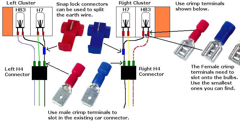

I took it upon myself to change my standard Mk2 Ph1 headlights to the nicer looking sports model ones. Ive not tried fitting anything yet because thats pointless until i have everything i need.
The problem i have currently is how do i modify the headlight feed from being a single H4 connector and changing this to being a dual feed to a H7 and H3 connectors. Im no expert but i can grasp what needs to be done, just not sure how to achieve this. Short of heading to a scrappys and ripping the existing wiring loom out of a sports model is there another way of changing whats currently there?

Theres a guide on here mate - http://www.cliosport.net/forum//showthread.php?t=240464 might need to pay for membership but its worth it

Oh i already am a paid subscriber. I just didnt think this was a common thing to modify so never crossed my mind checking :p
  Nissan 350z
I just read the guide and wow, that really is VERY useful and exactly what i need. Thanks loads for the heads up!
