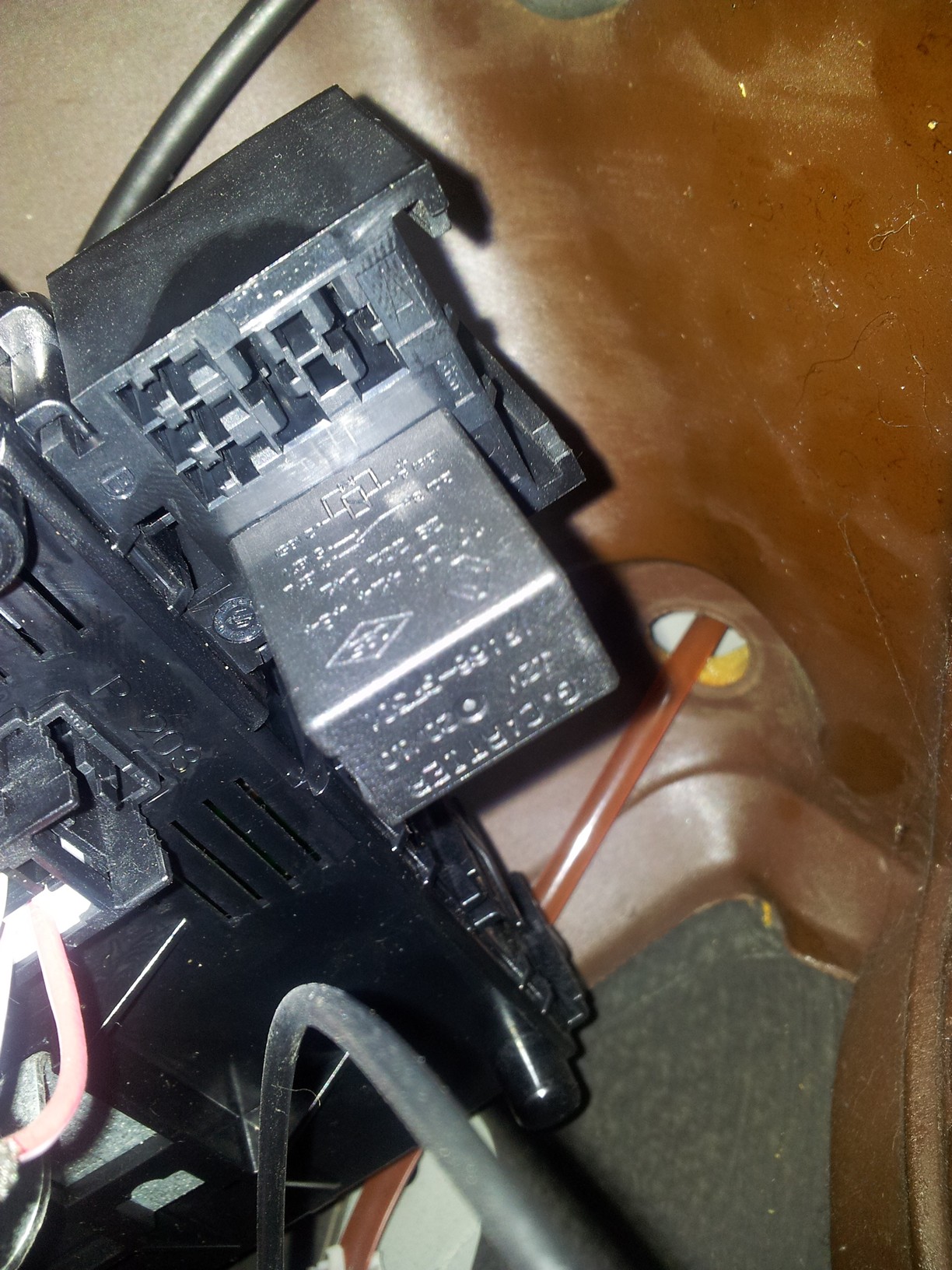

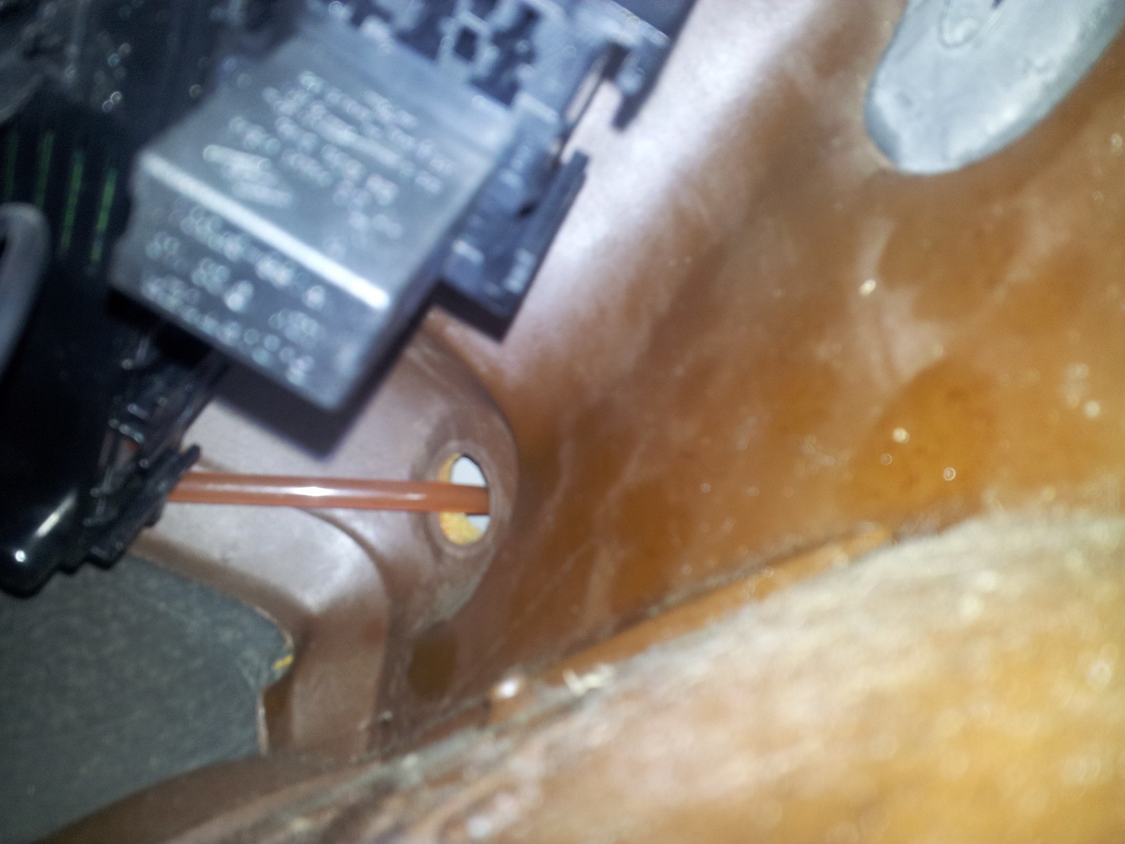

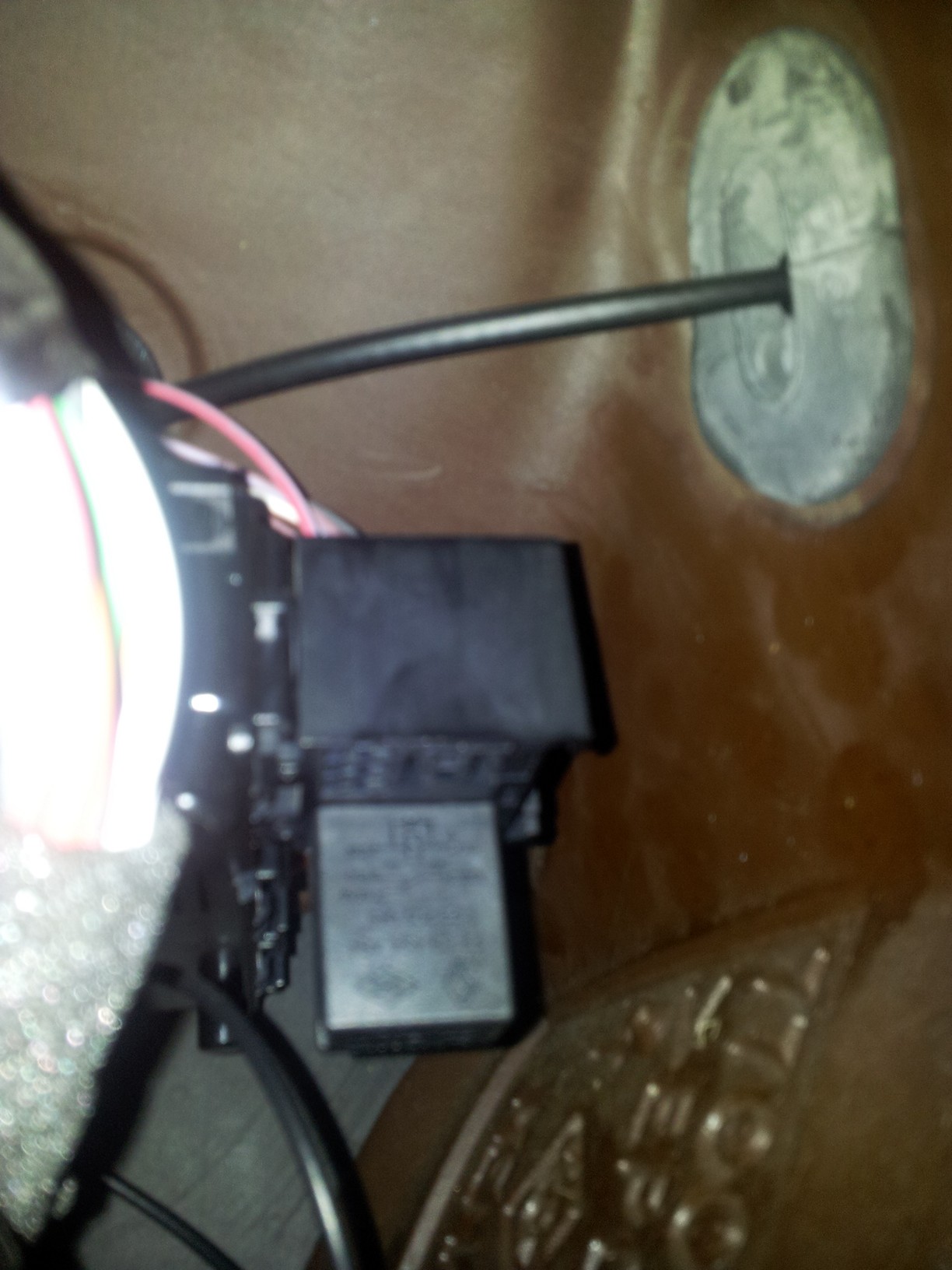

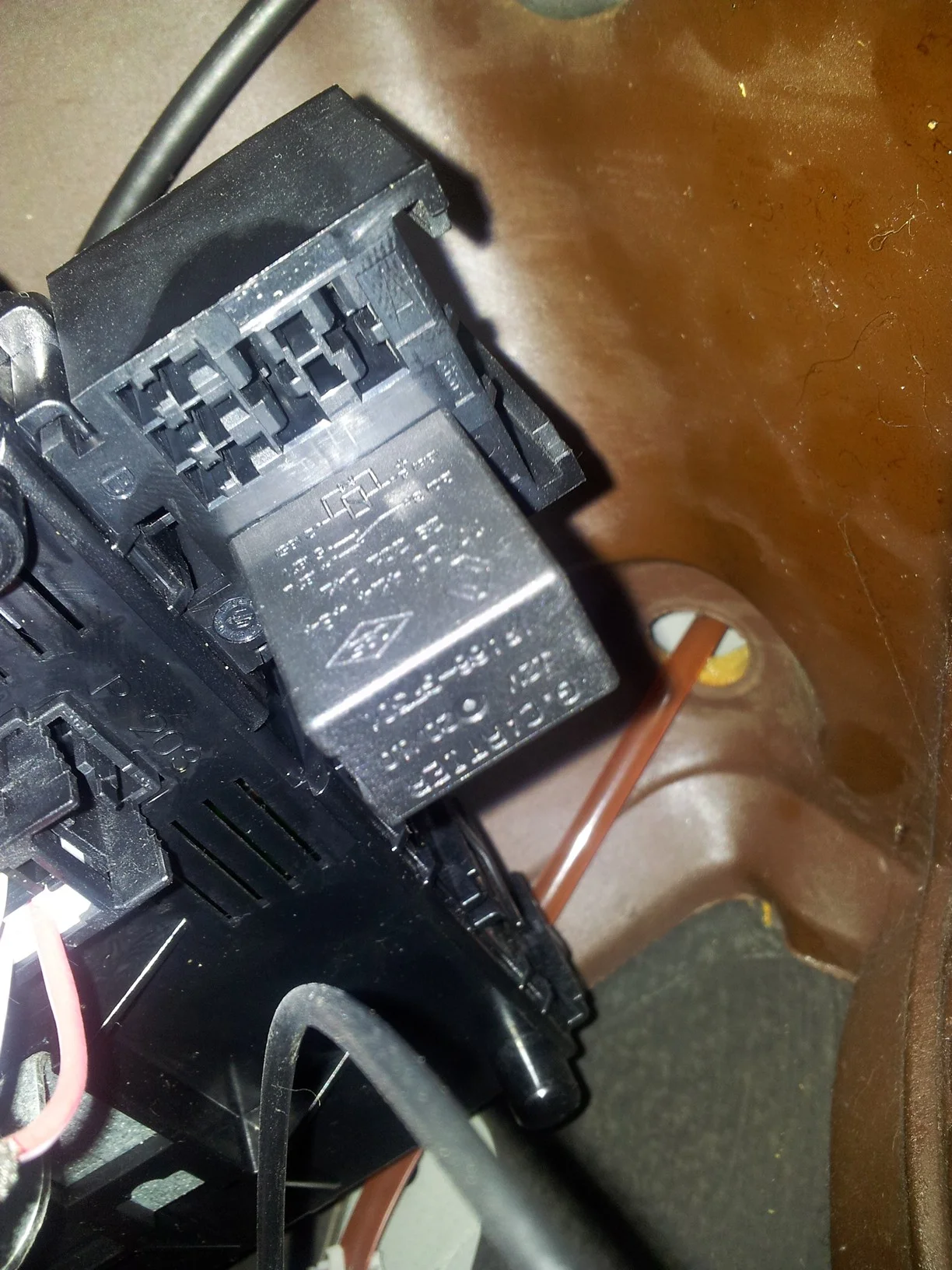

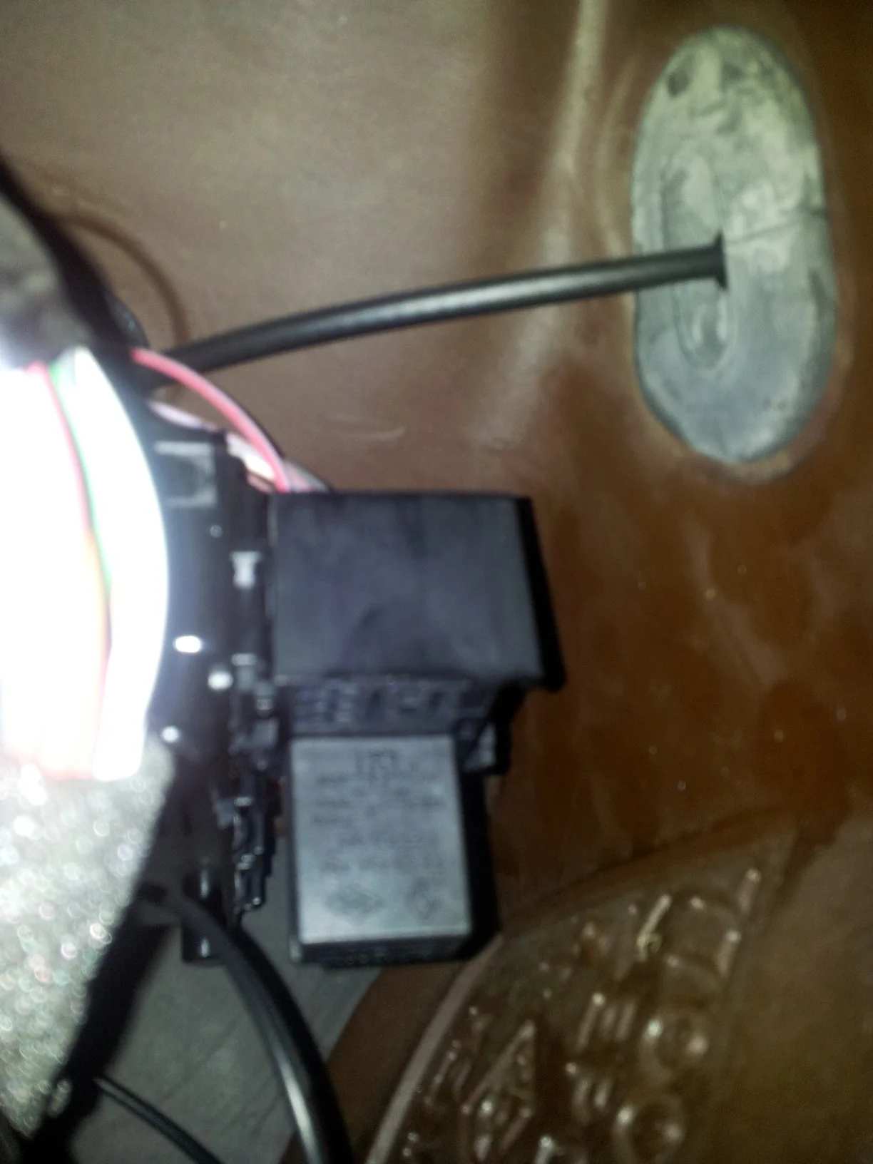

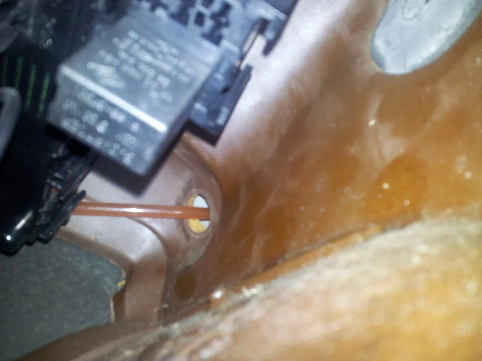

where are the relays for this located, and Which relay operates the fogs, ive found the guide on here, but still not sure.
The relays are under the dash in the passenger footwell.
I was just considering whether the fogs had been fitted but never connected, but you have the stalk so that kinda rules it out.
Ok, ive located the relay position, and there is only 1, is this normal?
There is 2 ports, but only one is wired up?
Thanks for the help so far!
i have taken some photo's of the relay location bit underneath the fuse box if it is any help to people?
Should there be more than this?
once again, thank you for the help!
