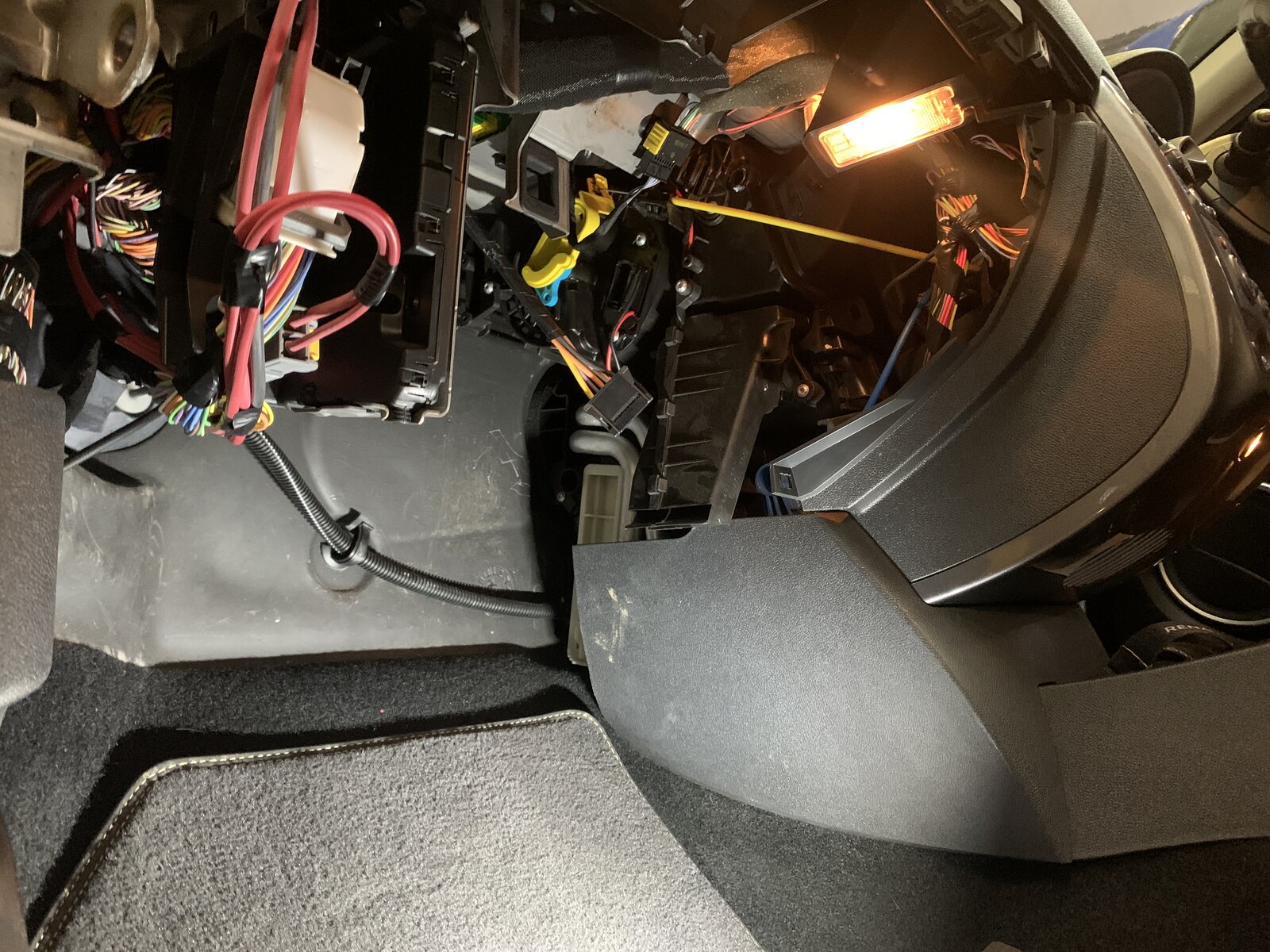

Take out the glovebox not the dash. Had to do this on my sisters 07 MK3. She was driving round with no blowers for about 2 months before saying anything the spaz! ?

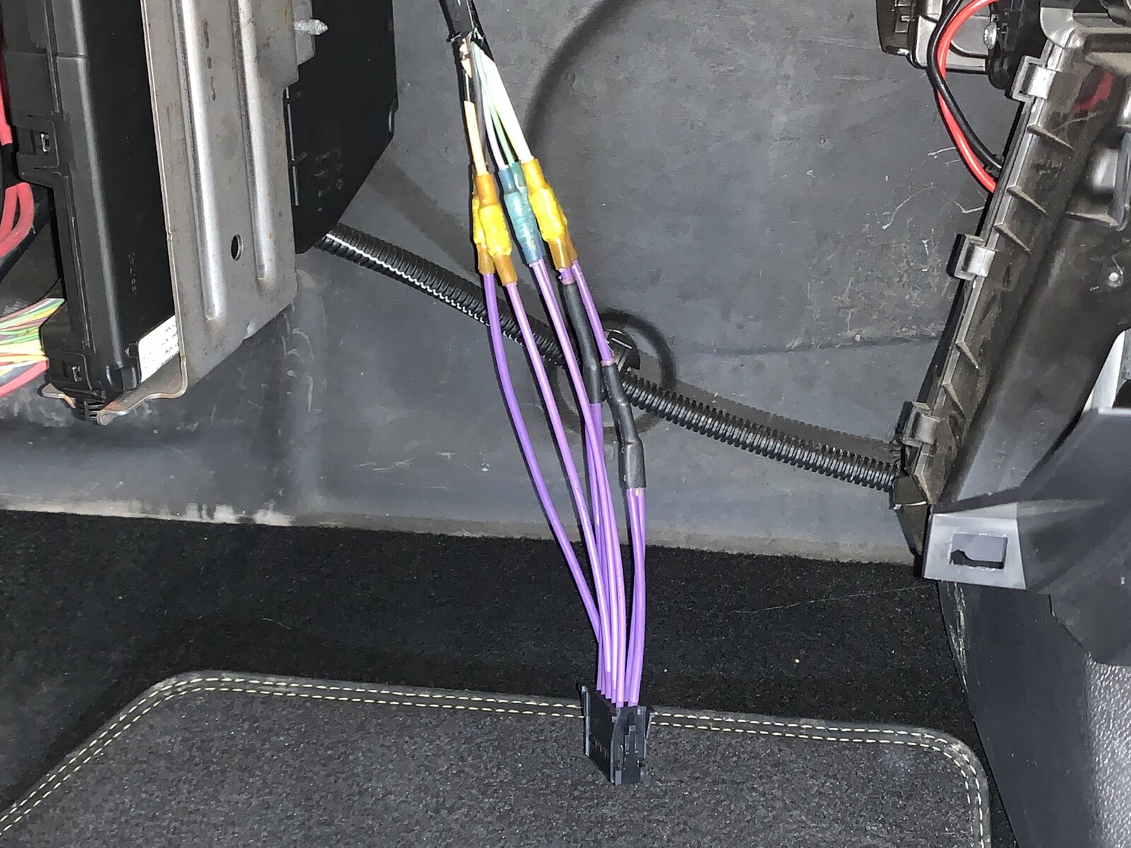

I thought I'd update this, it turned into a bit of a saga! I bought the harness, gave it to him and he replaced it. It worked fine, but packed up again around Christmas time, so he barely used the car.

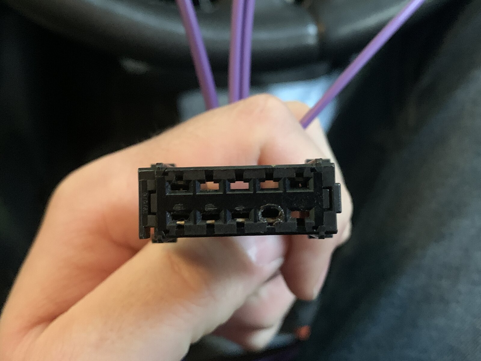

He got round to it and found out that one of the plug holes had burnt out. The bit it plugs into (the board with the resistor on it) was burnt too.
I bought a replacement harness from the same seller as last time, it was slightly different. The wires were a lot thinner and bendy, on the first one I bought they were thicker and stiffer (didn't bend at all) I took that round to him and he decided the second harness didn't look as good so he didn't want to use it.
I bought a replacement resistor bit from a different seller as no seller seemed to sell both parts.
I bought another harness from a different seller, this one has different colour and different thickness wires and looked a lot better. That one didn't plug in properly:mad: Not into the replacement resistor part, or the original one from the car.

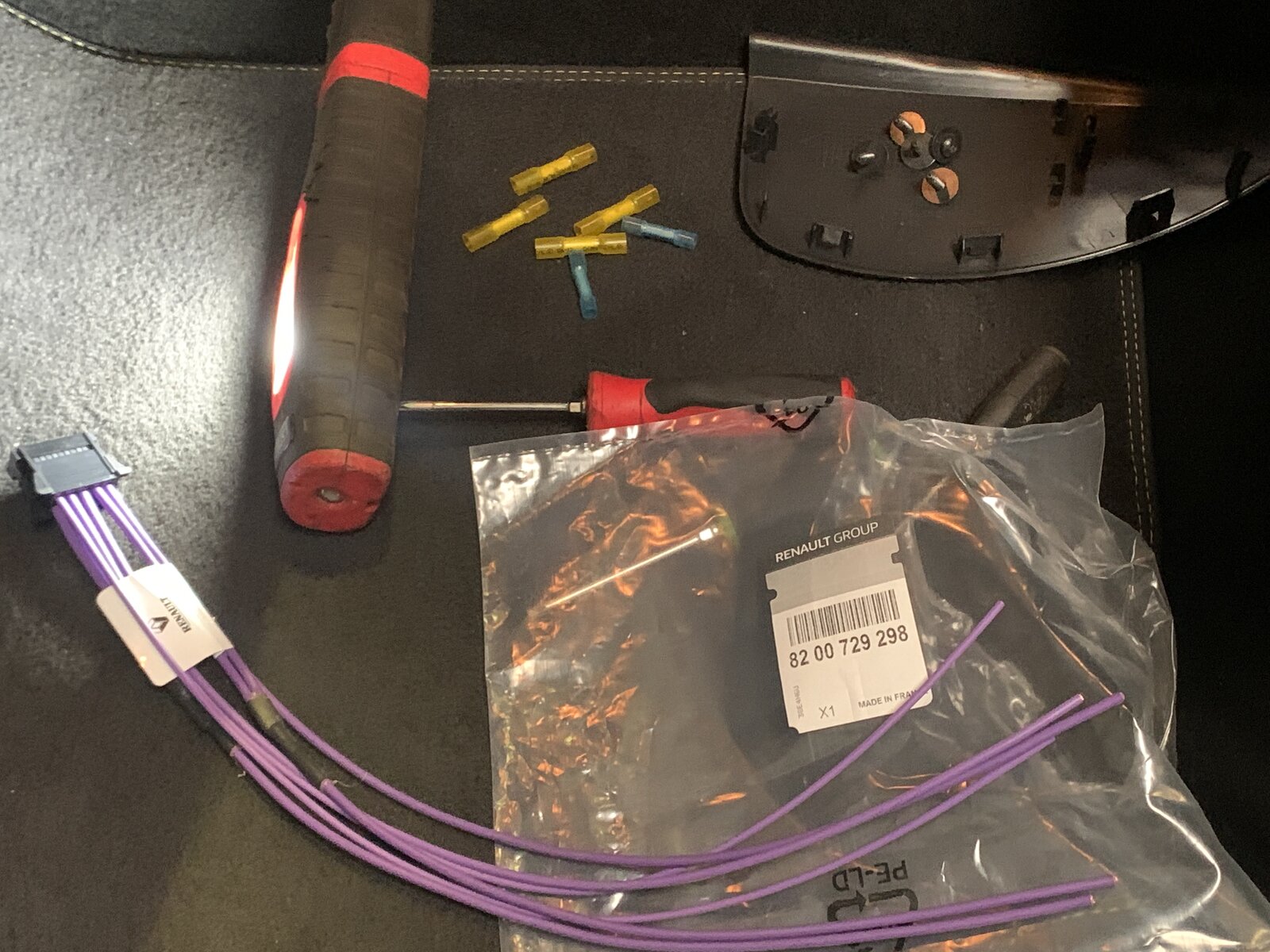

After getting annoyed with it all, he bit the bullet and bought both bits from Renault. Price wise they were £114 :cry: but he wanted to be certain that they would work properly and that it would fit together. They do and it's working fine. Happy days!!
New genuine item bought as it has the correct thickness of wires and they are now doubled also to handle the heat / current as renault seen there was an issue with these. A cheap ebay item was looked at but after being told by my specialist that the OE item had been changed for the reason of them blowing I went with the OE item.
Take a look at the thickness of the wires and they fact some have two wires coming off them
