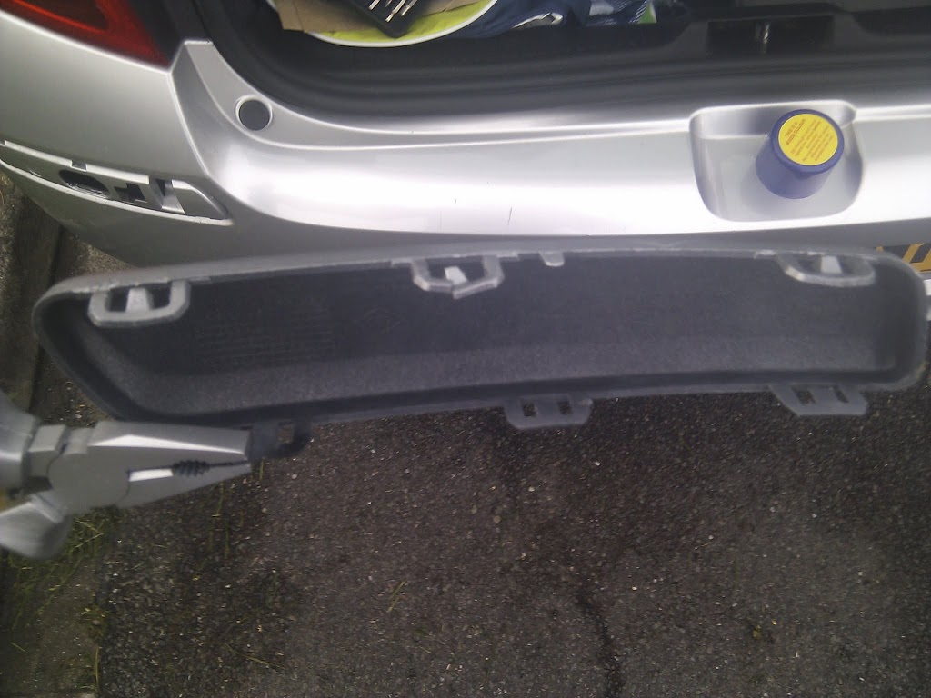

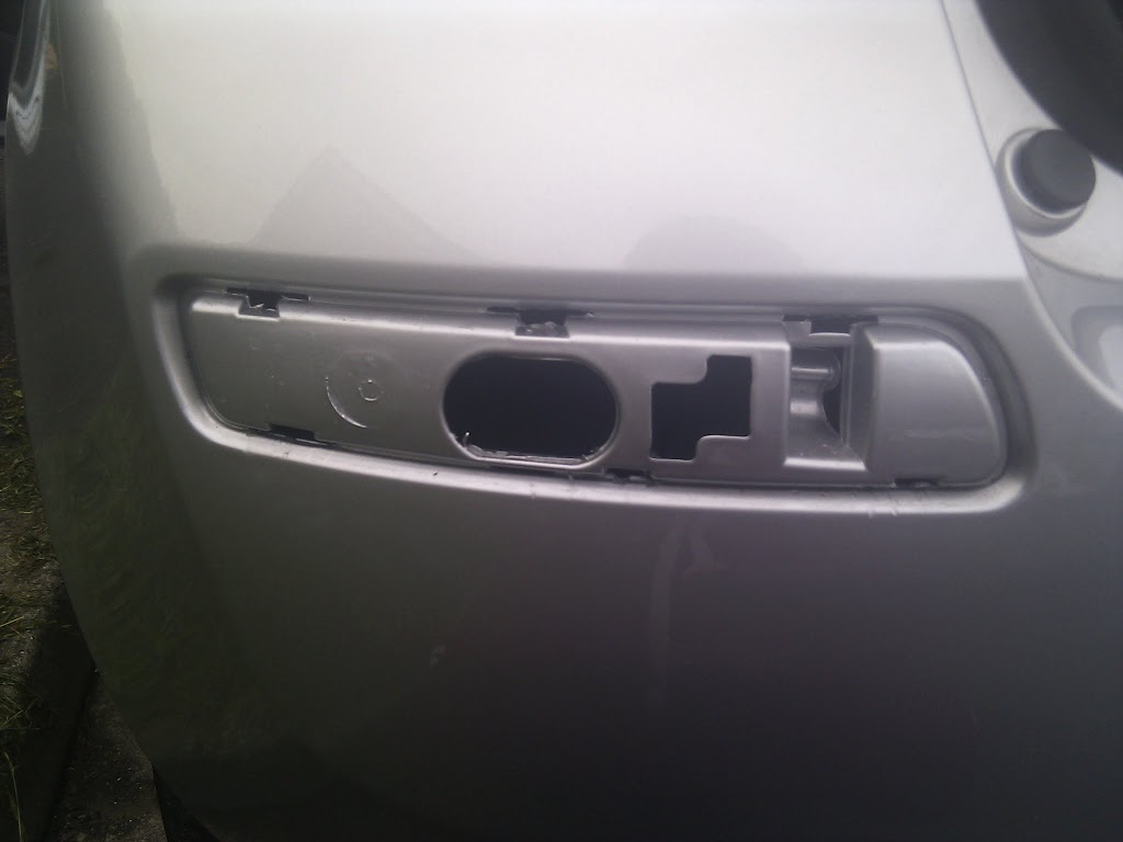

There are 6 clips around the bump strip. Use a small long flathead. I've just colour coded mine. I'll try and get some pics up.

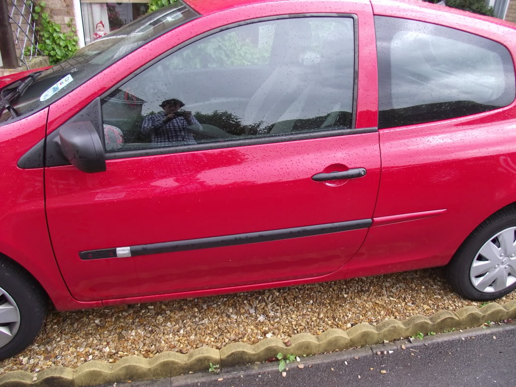

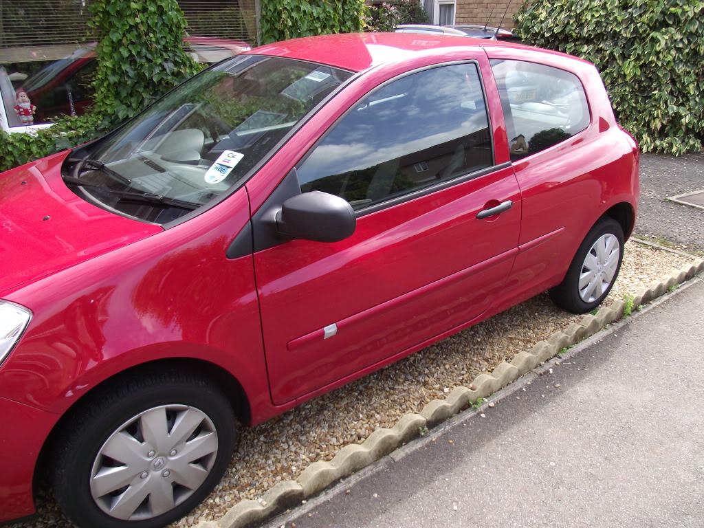

Put tape around the flathead though so not to scratch your paint work :) here mines;
Then all done
