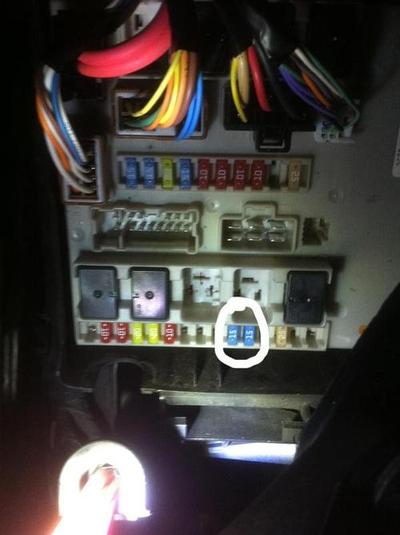

Which picture did you see? as I may have not posted a picture of my car. I checked all the fuses (I think now), not tried a drain test, but the battery is actually new! Test couldn't hurt though, how do you do one?
  Megane dci 130
In the other post about the fuse box. I would just remove that upc/fuse box and check it over for any water damage. If all that seems ok, do a drain test.
This basically tests wether the car is pulling a small current all the time, draining your battery.
  '06 Clio III 1.2 16V
The picture below is a picture of my fusebox, the other picture I posted isn't mine. I'll look up a guide for taking it out and have a gander, I'll also look into a drain test. Thanks! I'll let you know what the result is.
