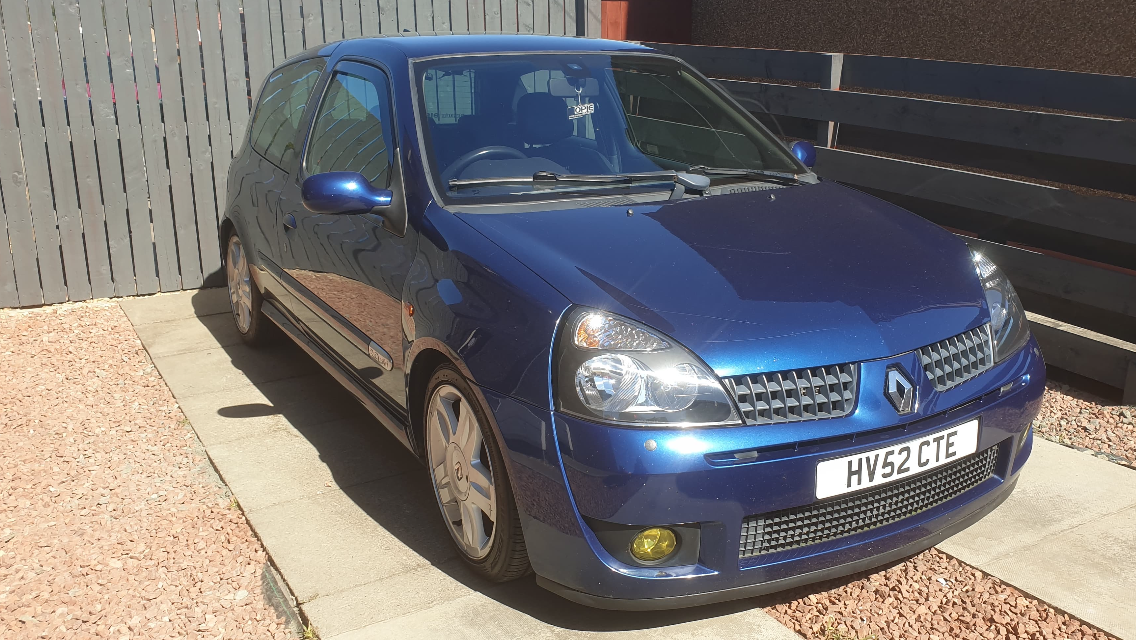

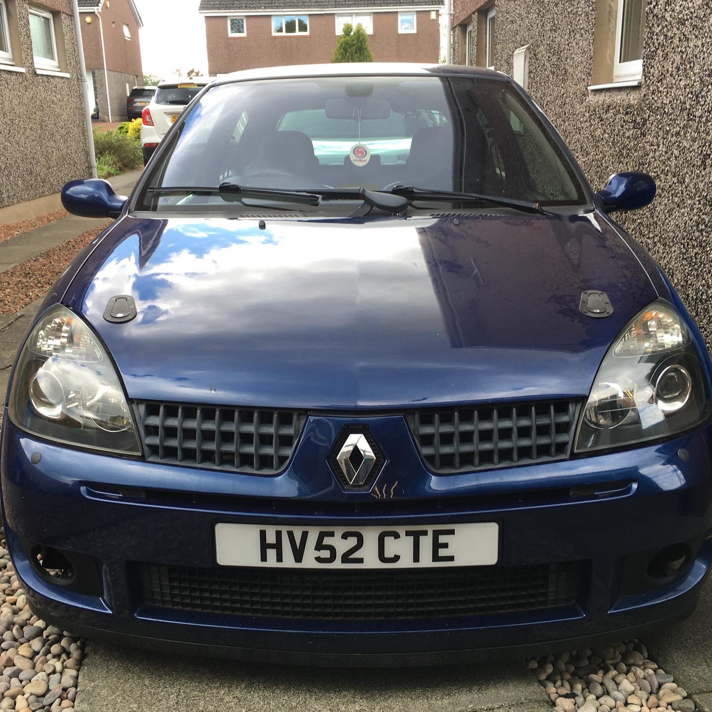

Arriving later today or tomorrow but all paid for. Not actually seen it in person so could be interesting 😂
It was inevitable that I'd end up in another 1*2. Should've kept the hundreds of spares I had!
Plans are a bit of welding, 15s, different suspension, different exhaust.
I didn't know you could get a 182 in Monaco, I thought it was only 172?
Has it had a 182 rear conversion?
Also, it needs spacers soooooo bad.

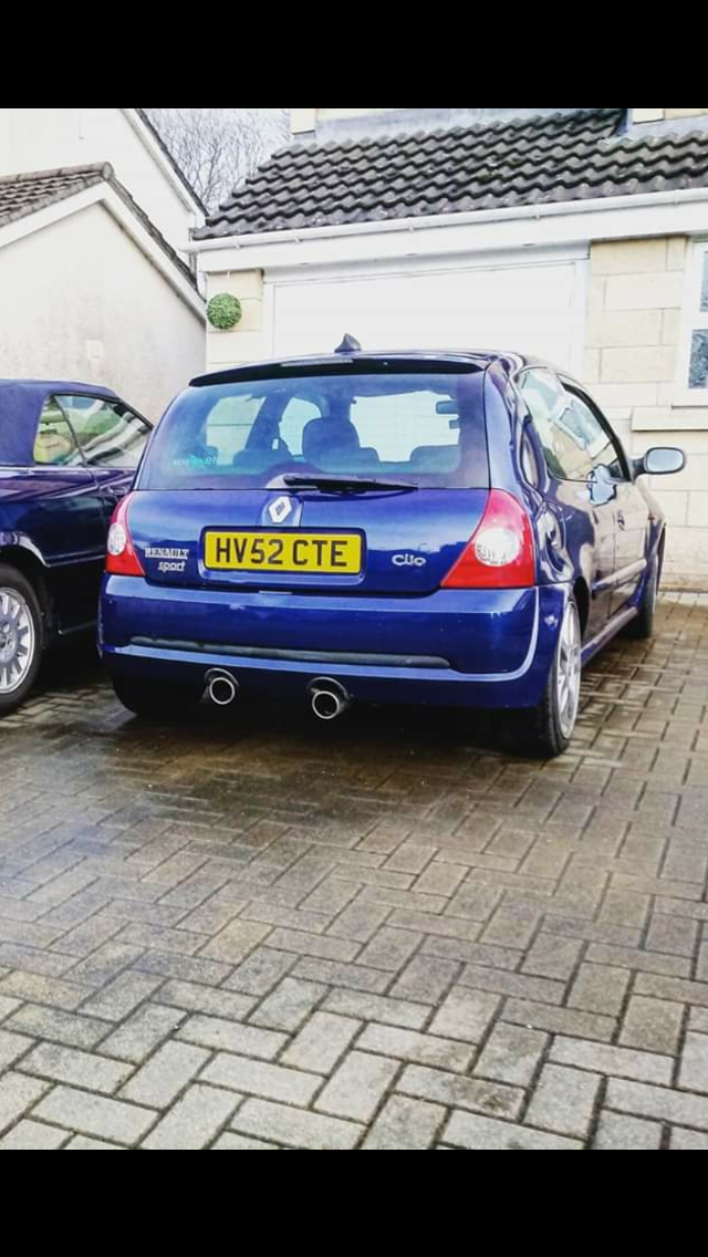

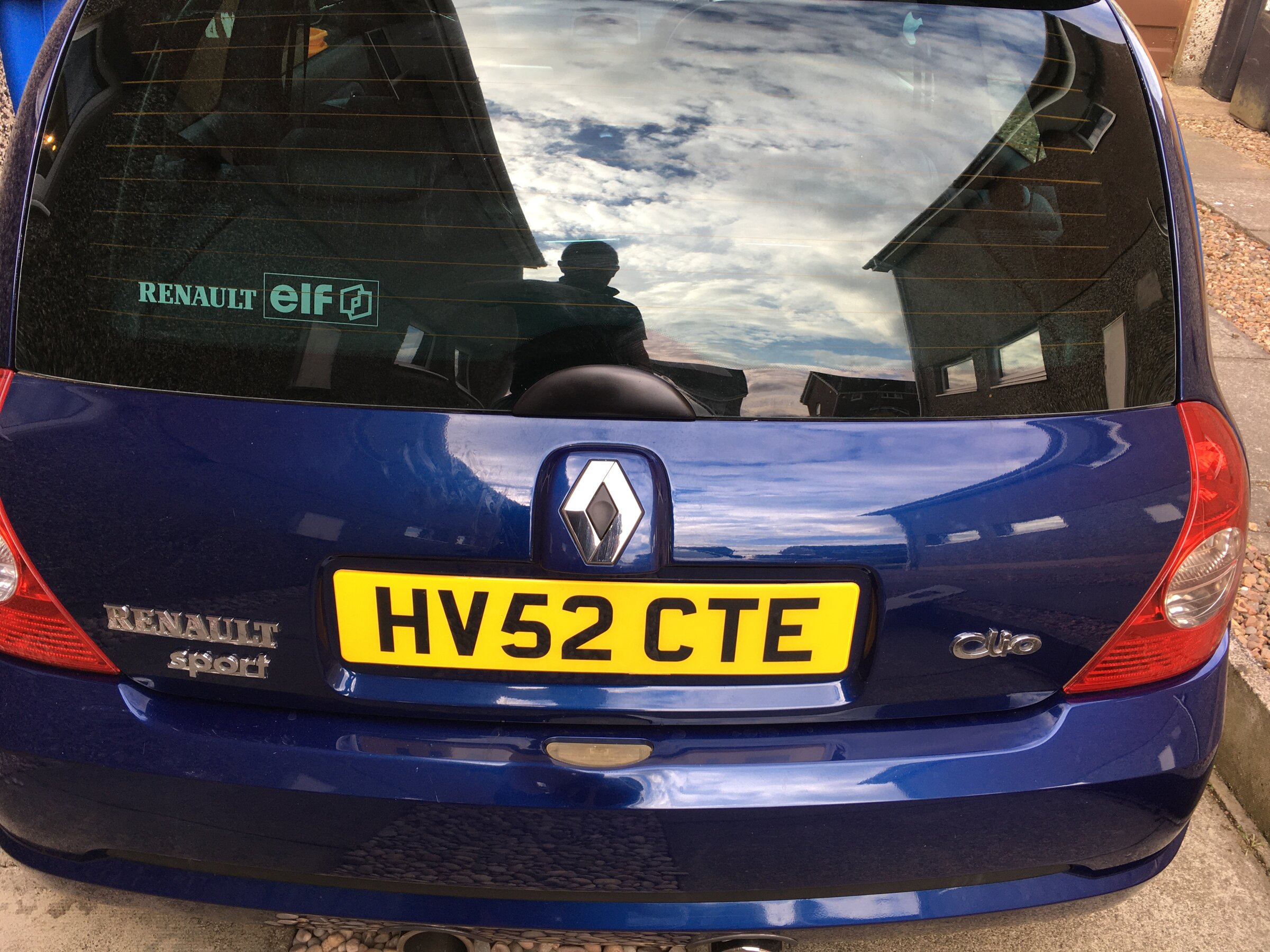

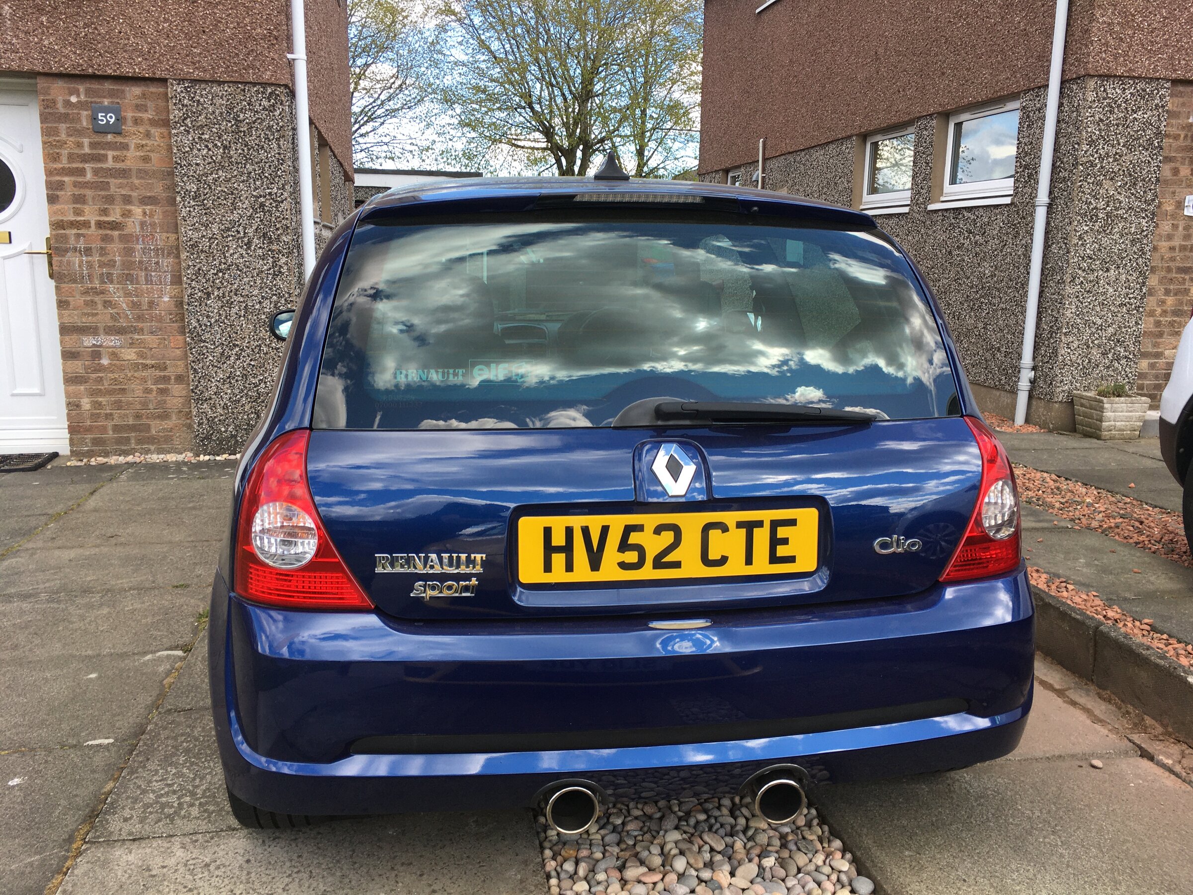

It's a 52 plate so a 172 with 182 exhaust conversion
It's one of those ktec 182 look a like exhausts. So still has the spare wheel well.
The 16s will be going so not bothered about spacers tbh

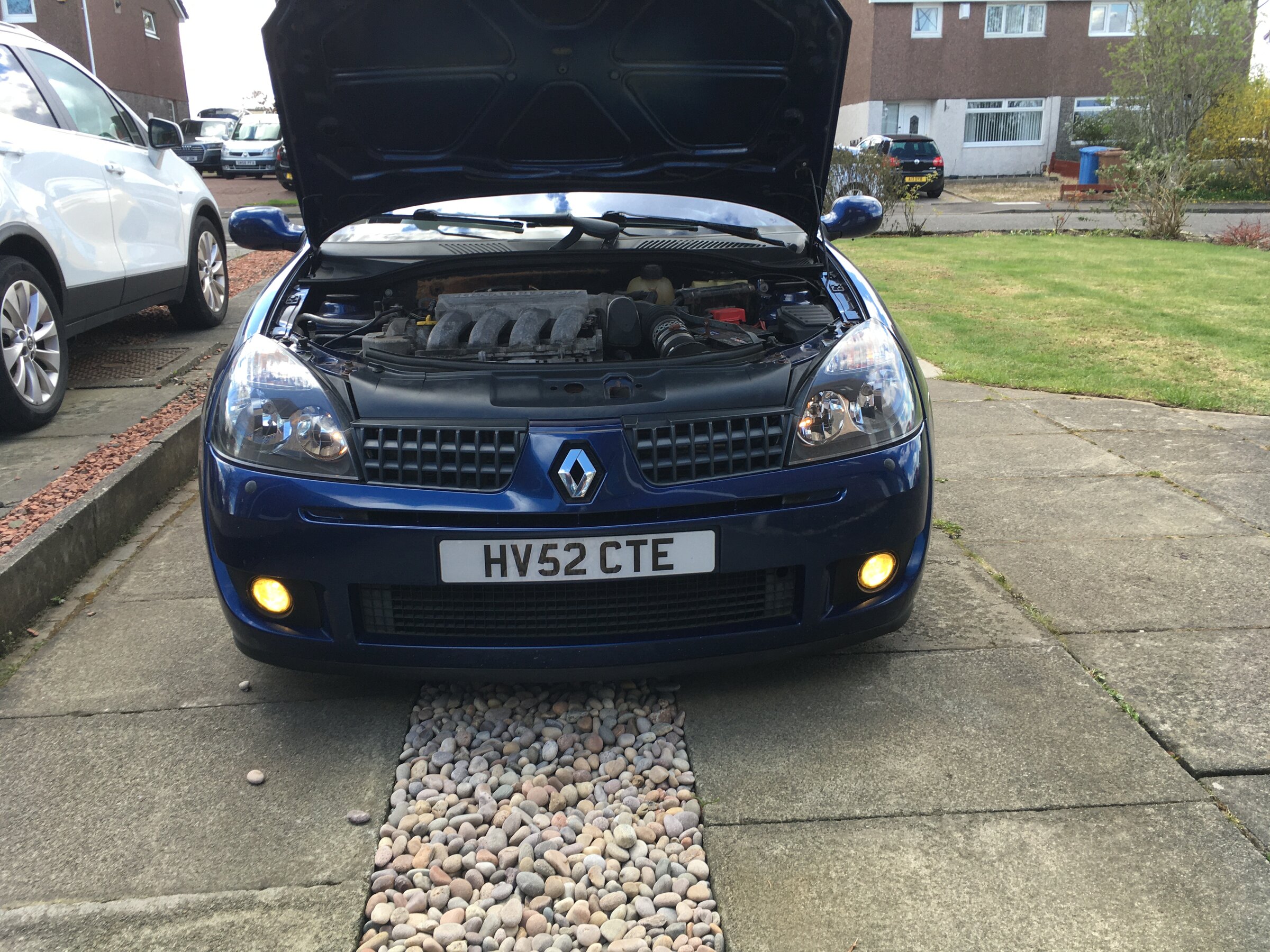

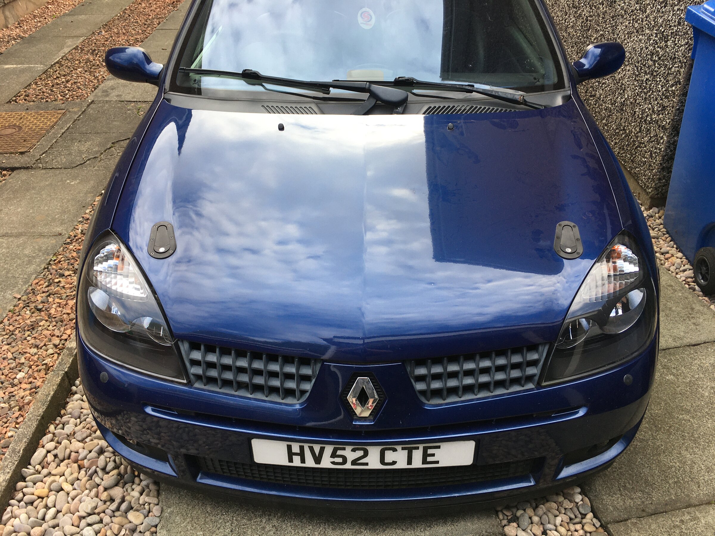

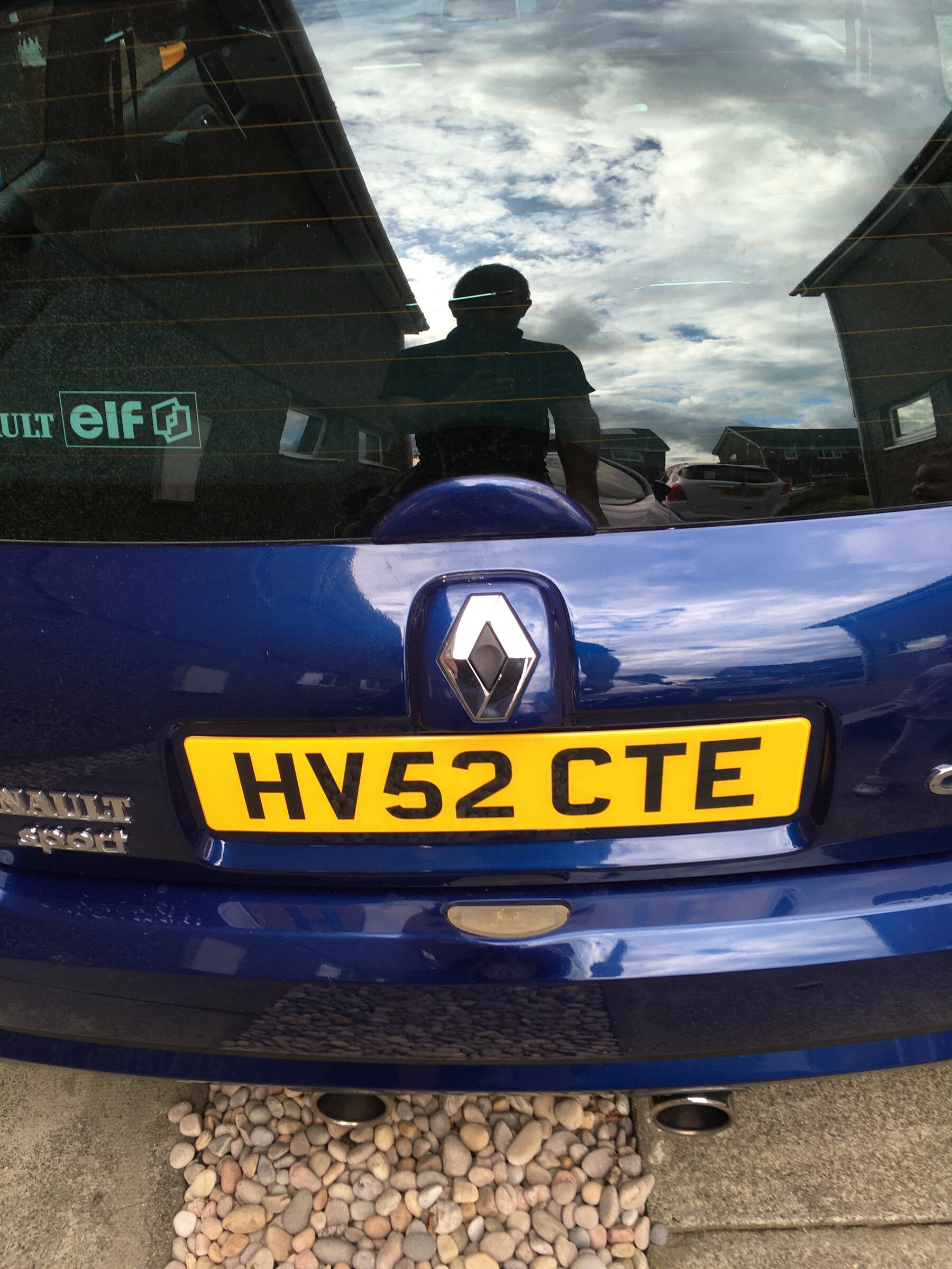

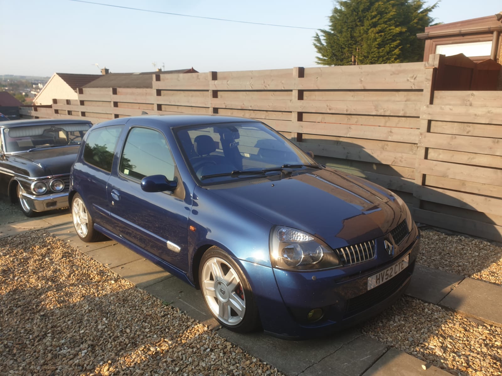

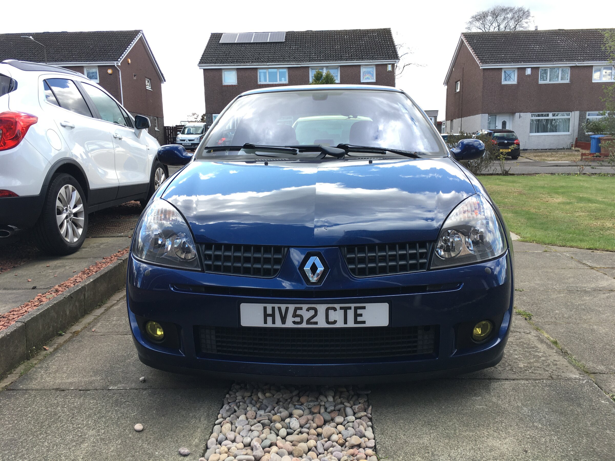

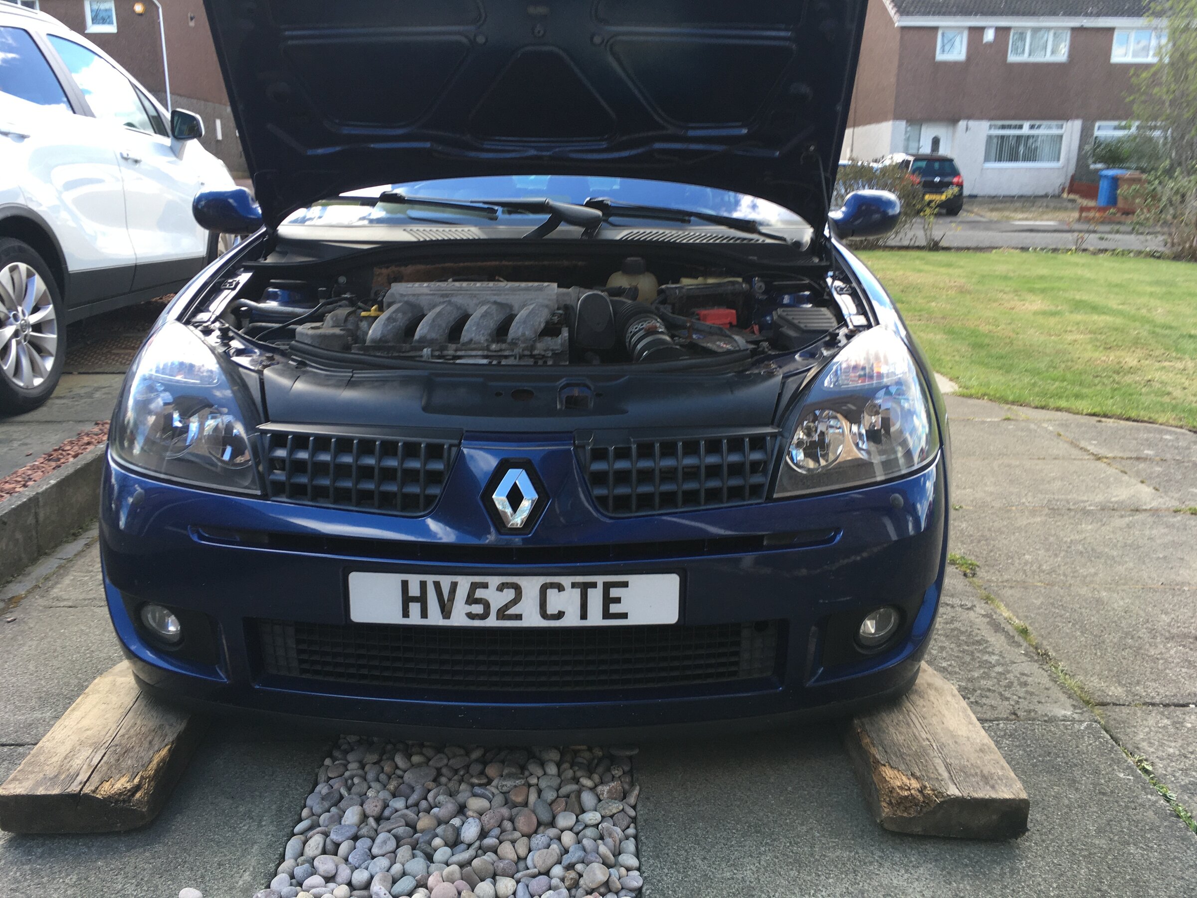

It's arrived

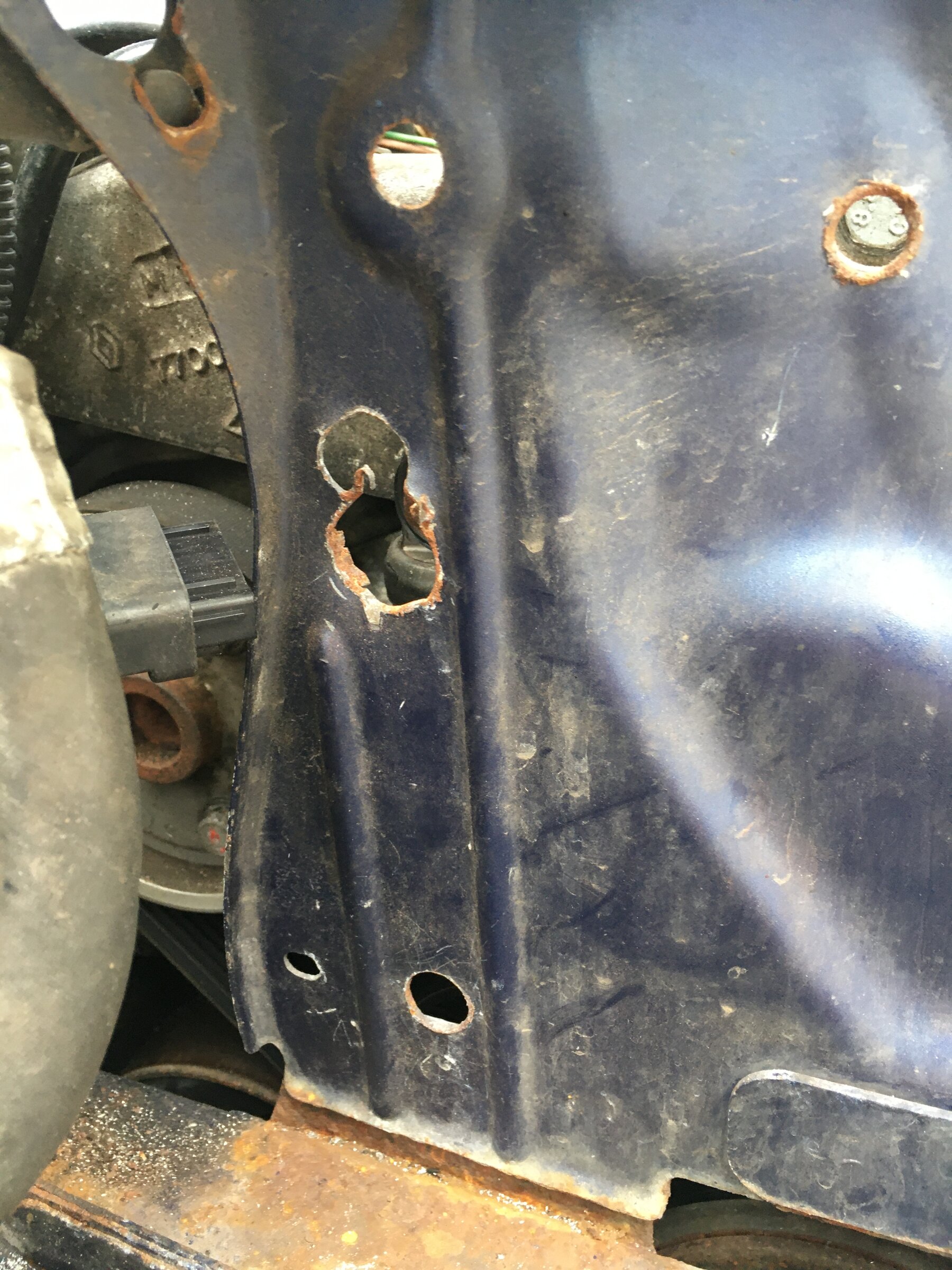

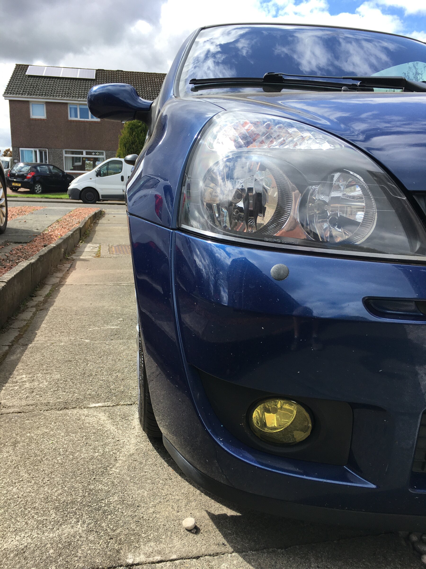

If you ignore the large hole in the underside it's pretty damn good. So I've started ruining it already. Fogs, arch liners and stereo will be advertised soon.
Wheels and exhaust once I have replacements.
It's recently had new track rod ends, balljoints, front tyres, aux belt change and oil change. As in 86 miles ago.

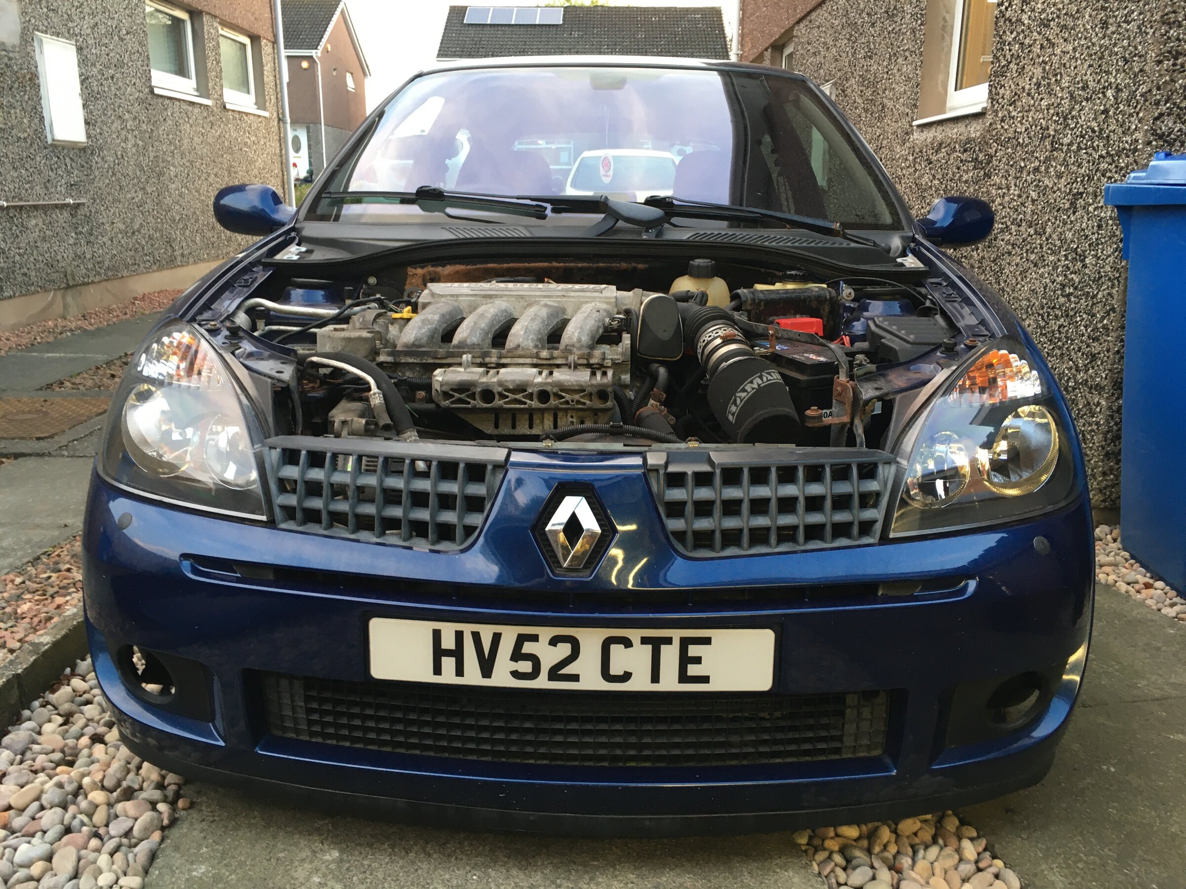

Pottered away at this when I've had the chance to, no great changes, just stuff in the right direction for me.

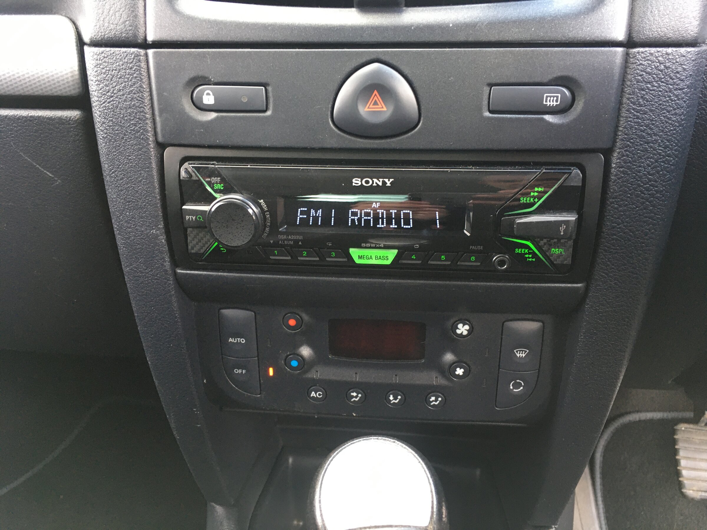

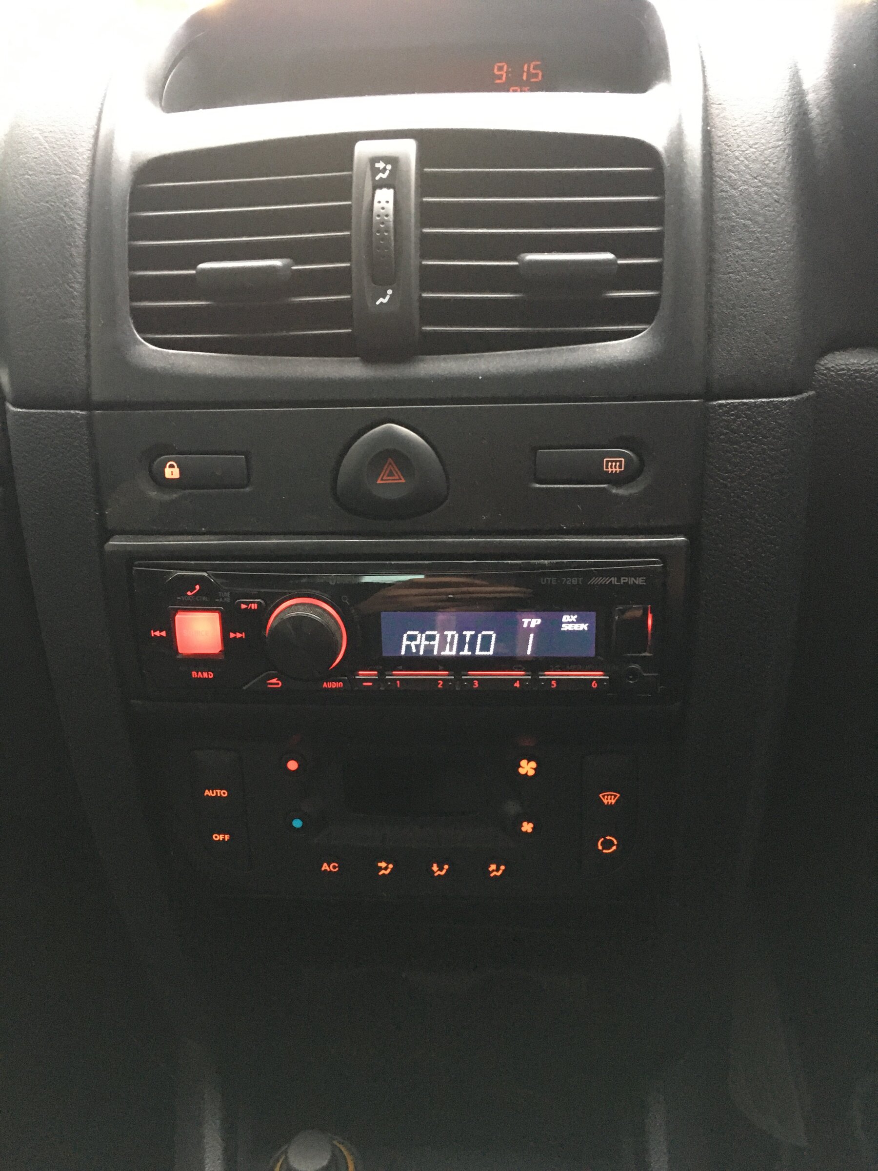

Started with changing the stereo from this (now for sale) Sony
To my trusty Alpine with hands free

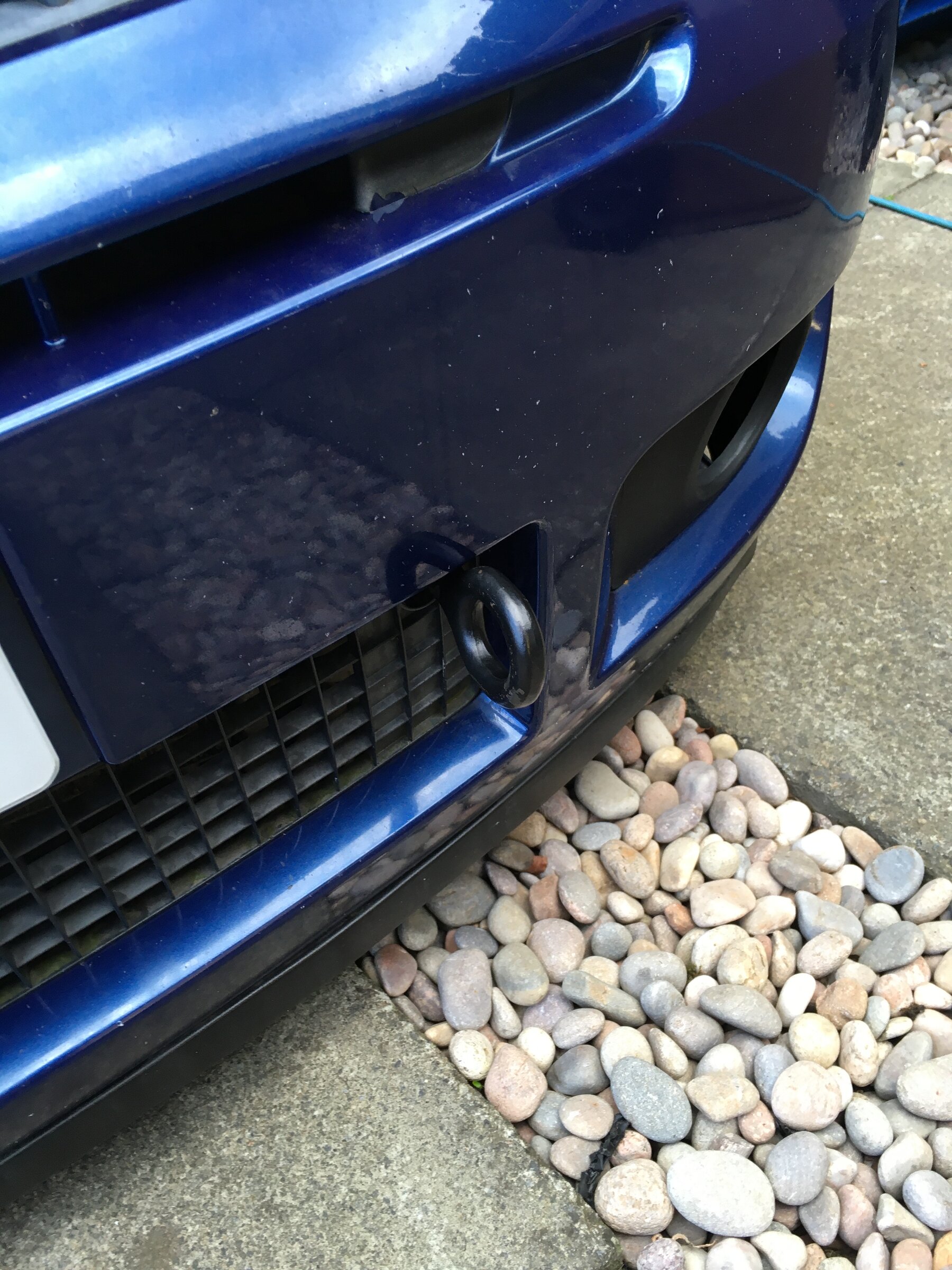

Thought I'd check and see how the towing eye thread is, fine it turns out

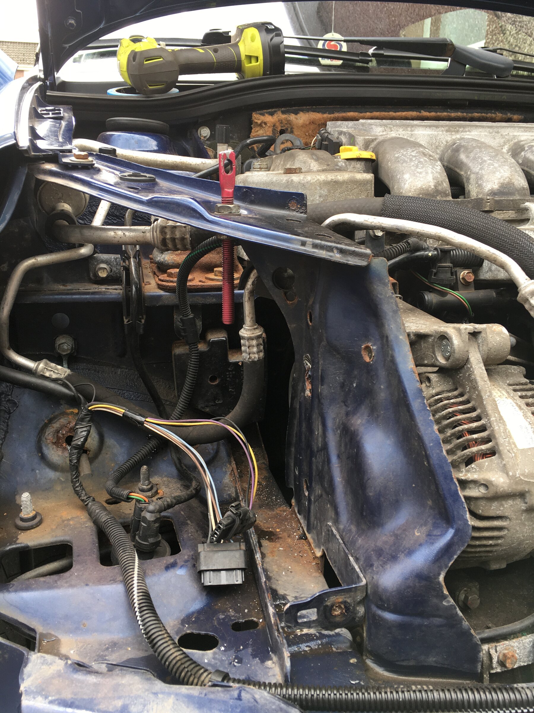

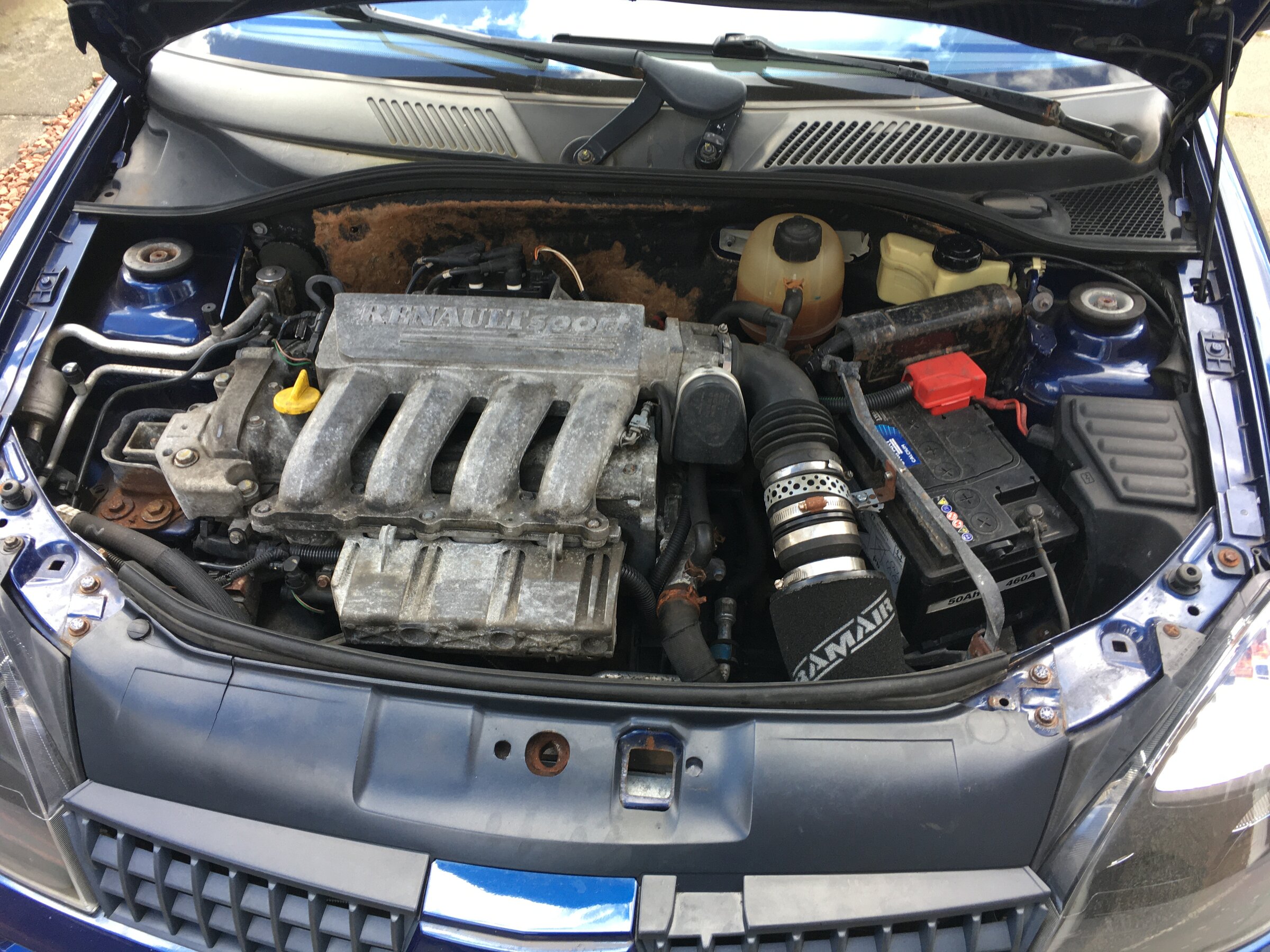

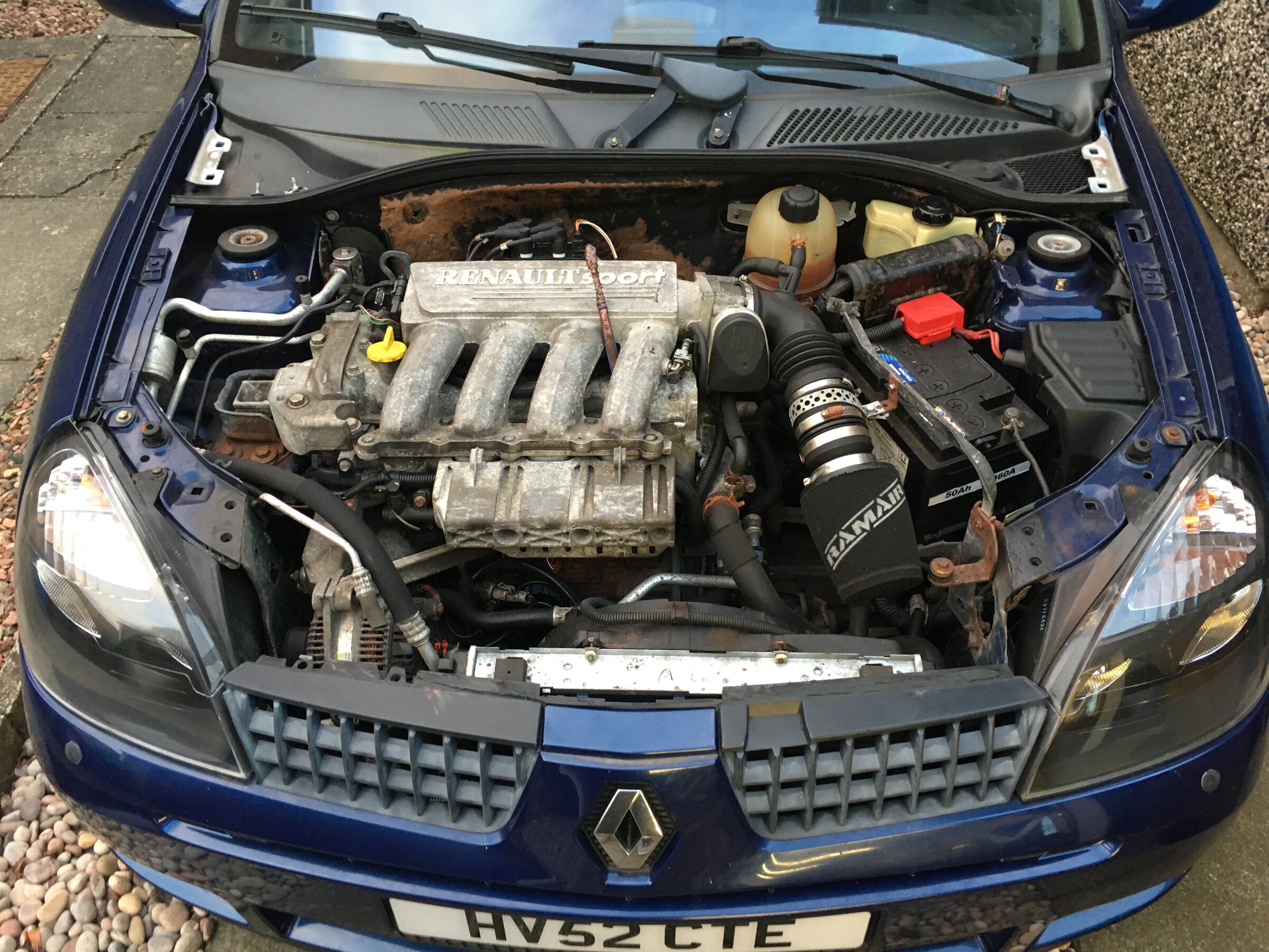

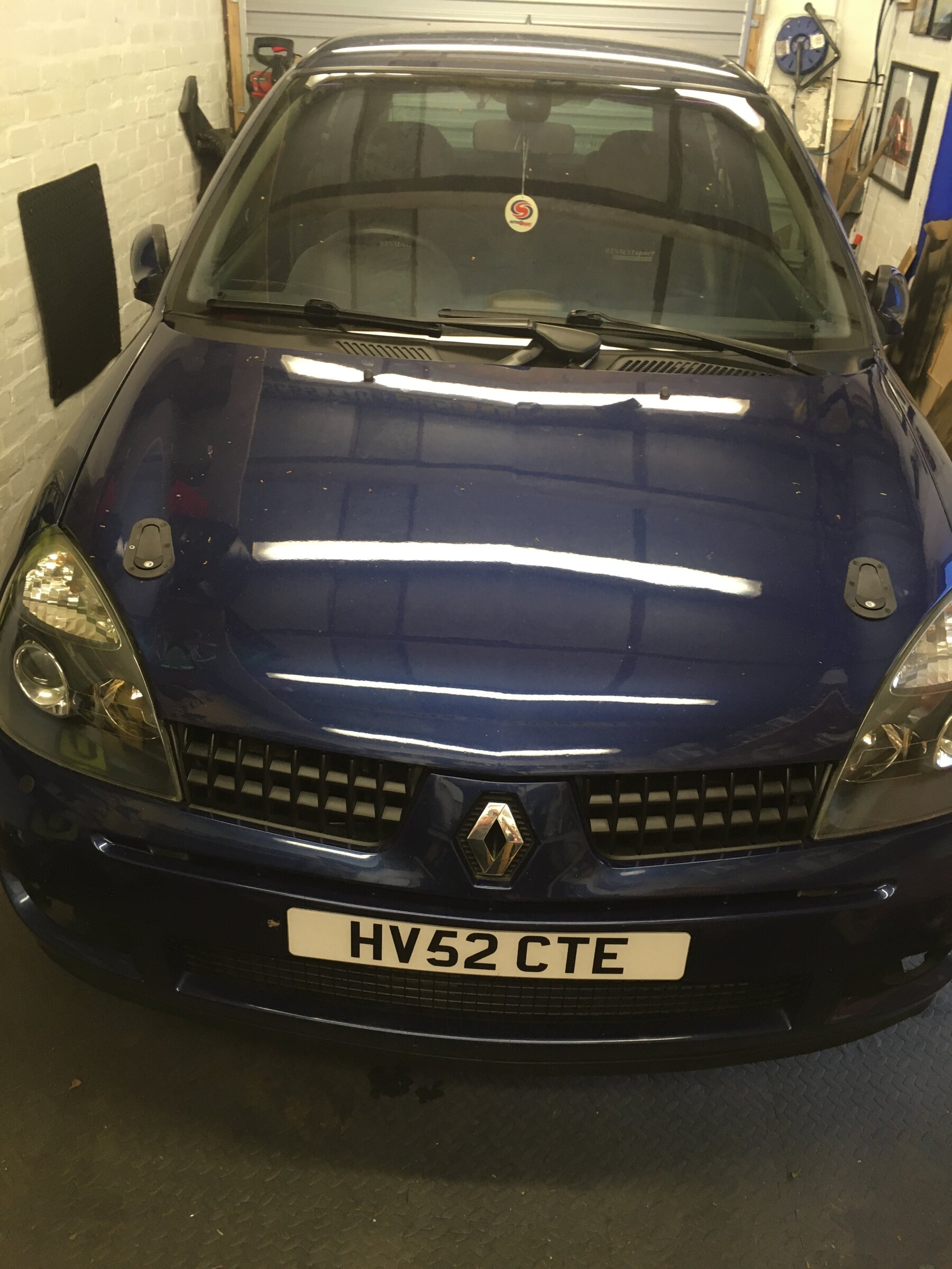

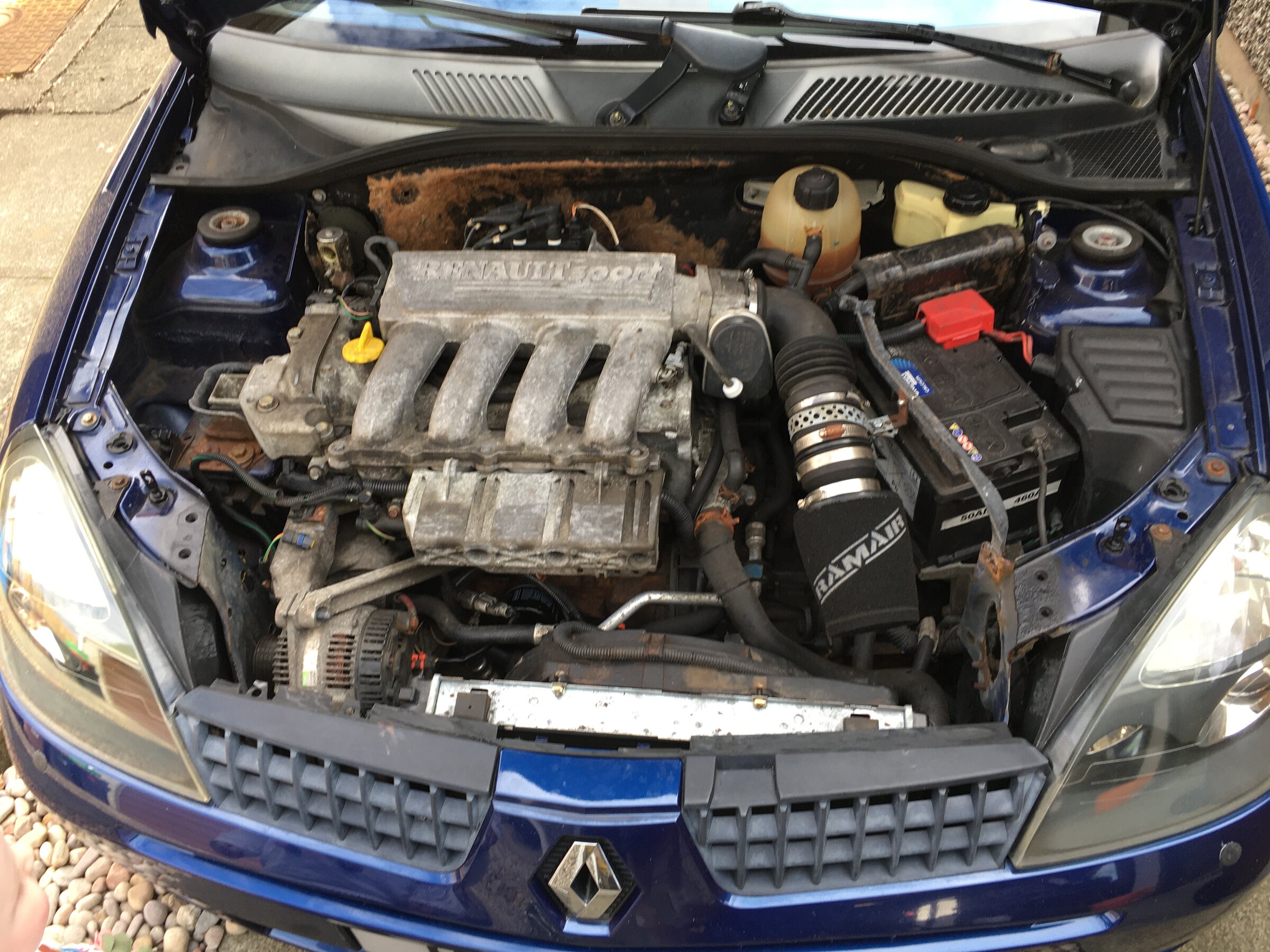

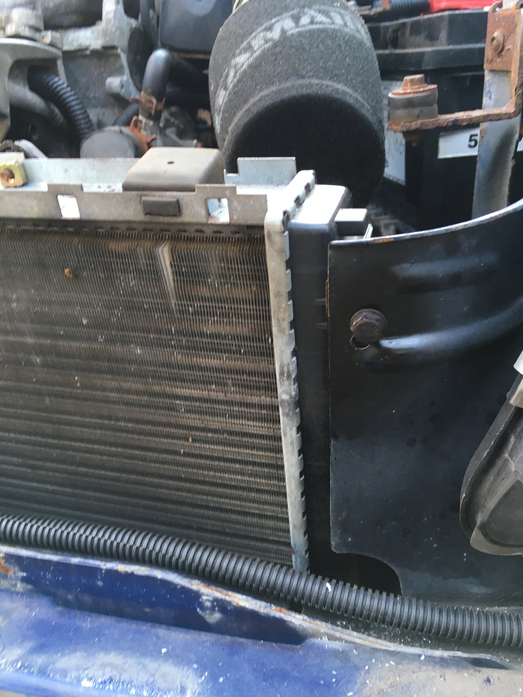

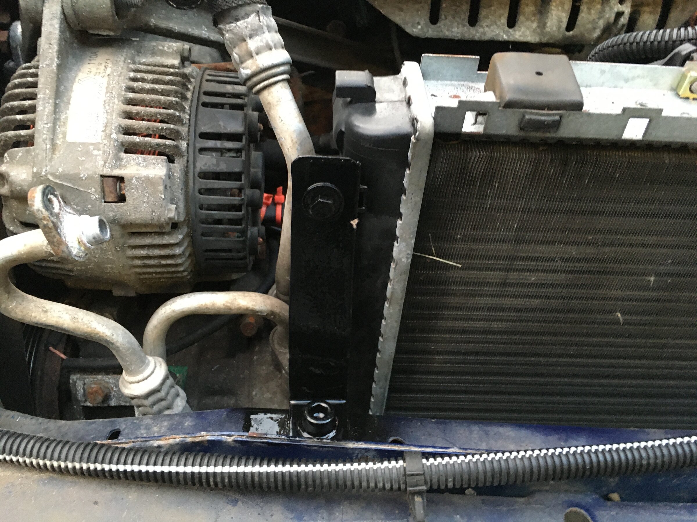

And did a deal on a bonnet with aerocatches so thought I'd get ahead of the game and get it ready for that since I'm not using it anyway. Started off with securing the top of the (brand new) rad once I'd removed the very broken aircon rad

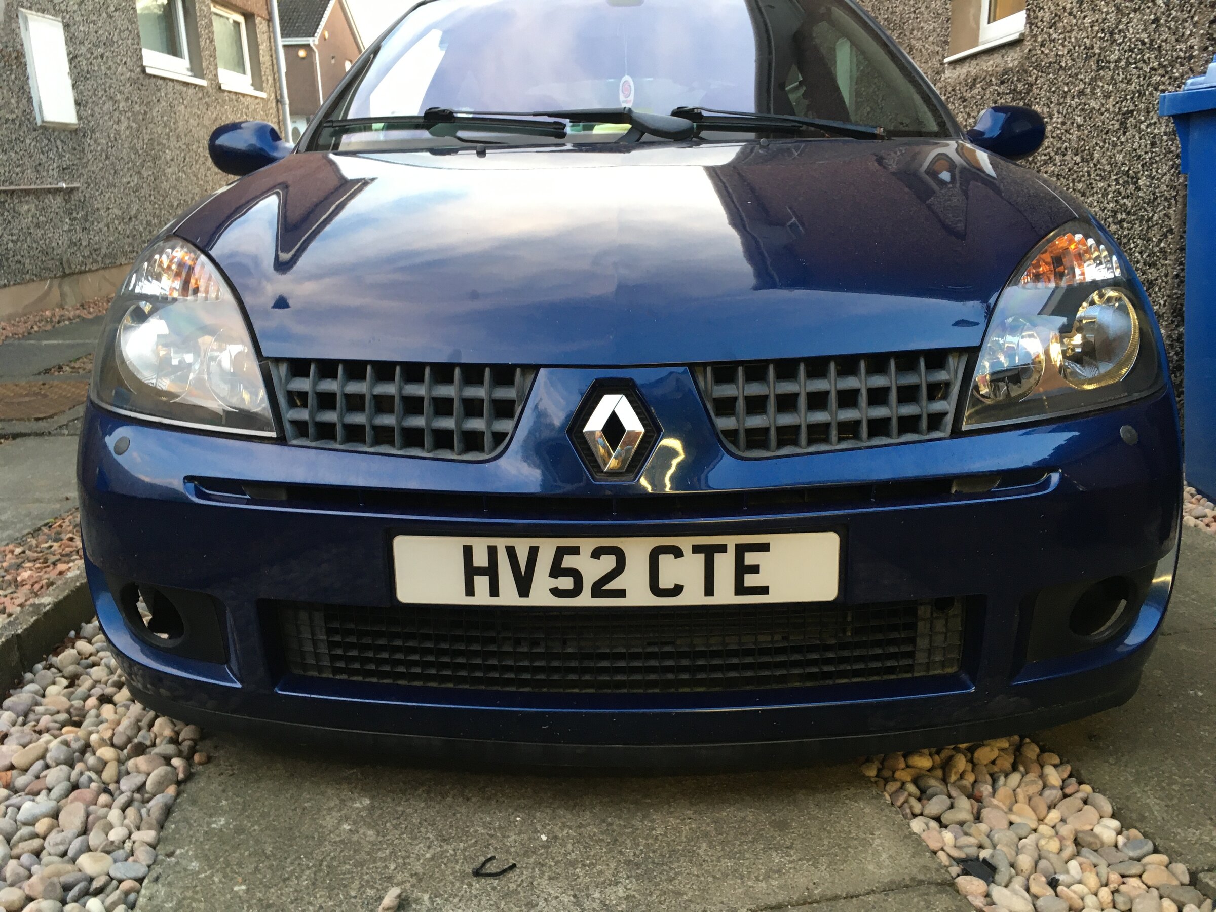

Really pleased with the cut on the grill too
Can't tell from the outside at all
Got another few pieces coming this week too which I'm very pleased about.

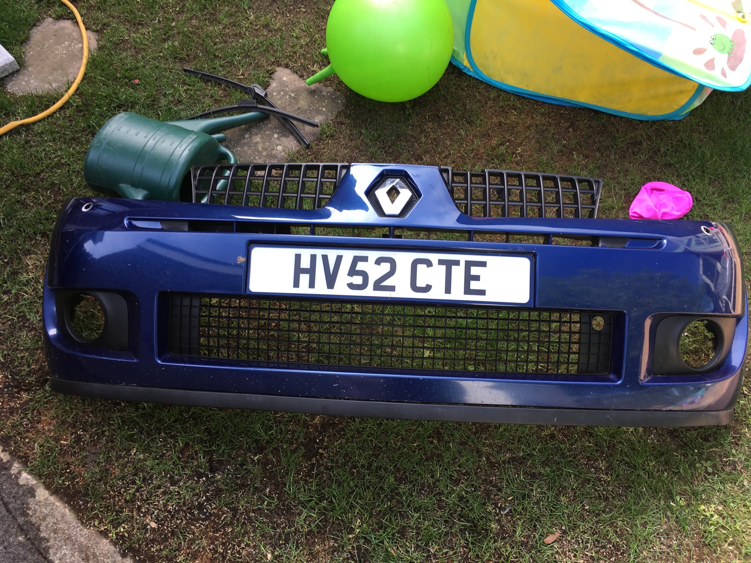

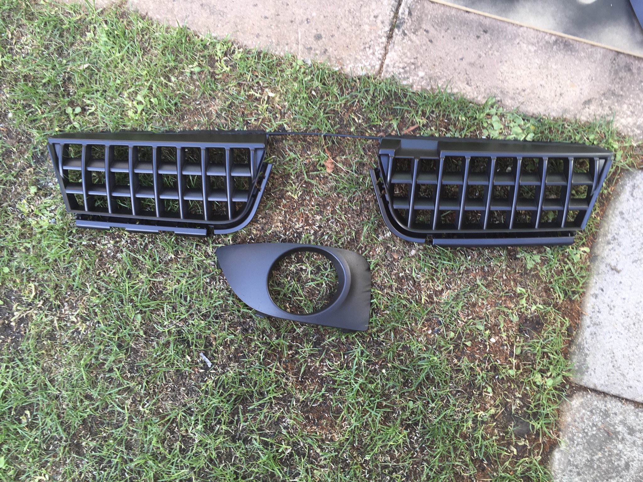

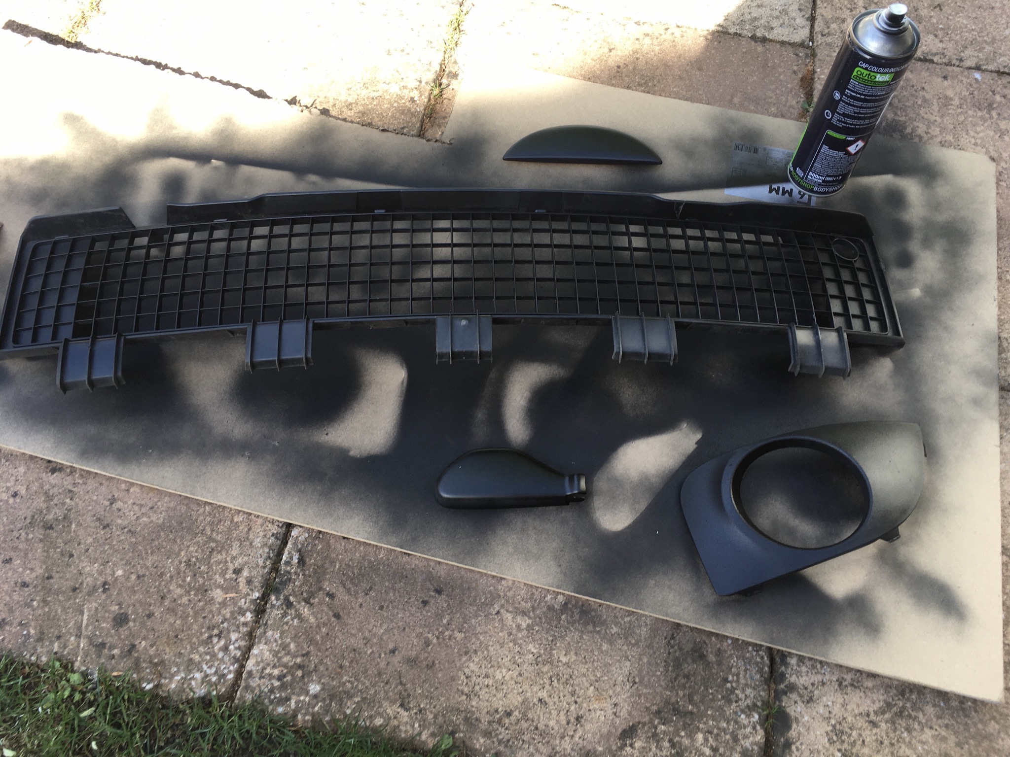

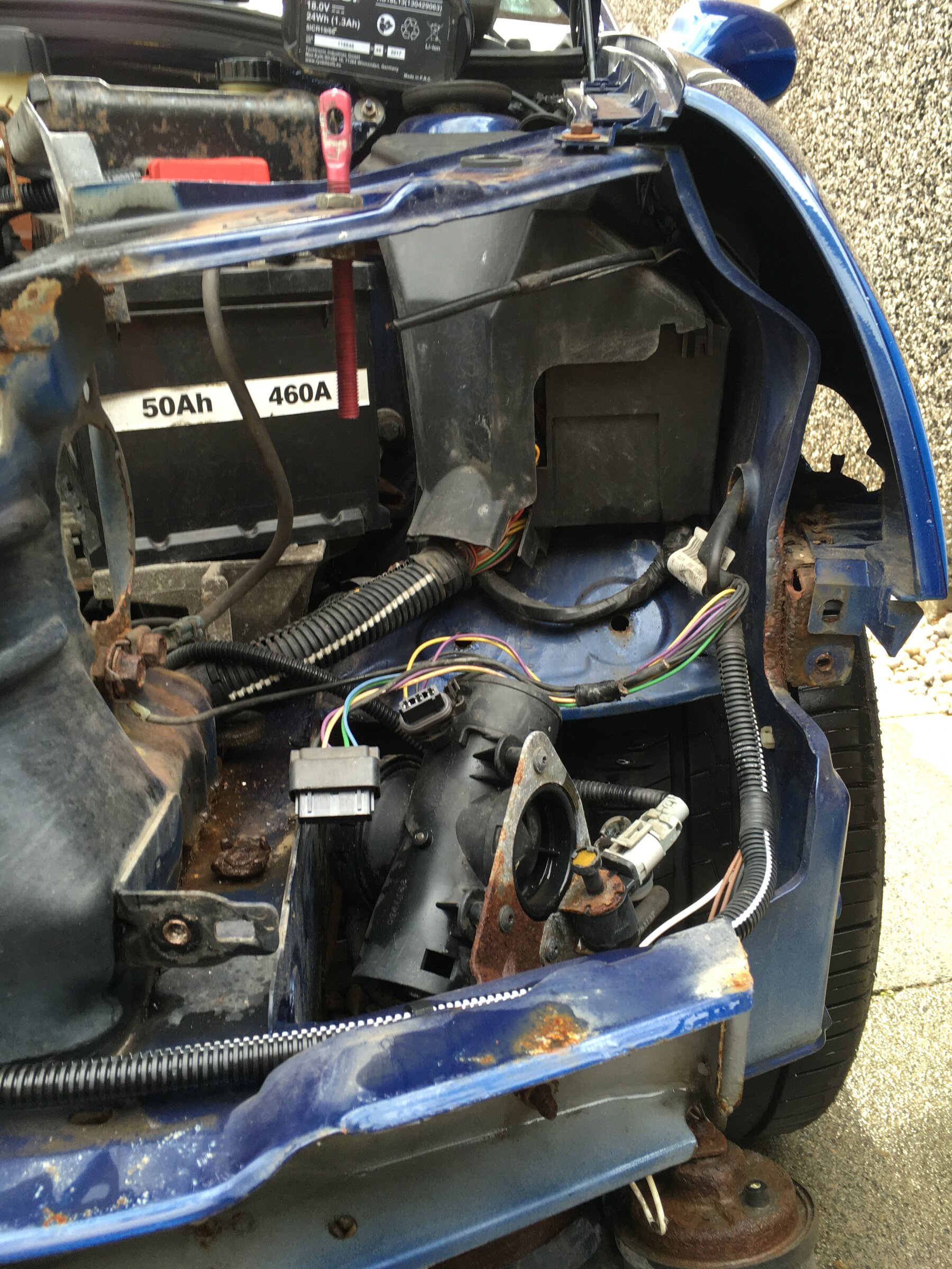

Cos I've added bonnet catches I don't need the slam panel anymore. So then when you remove that you're left with a grill flapping about.
So instead I cut it off

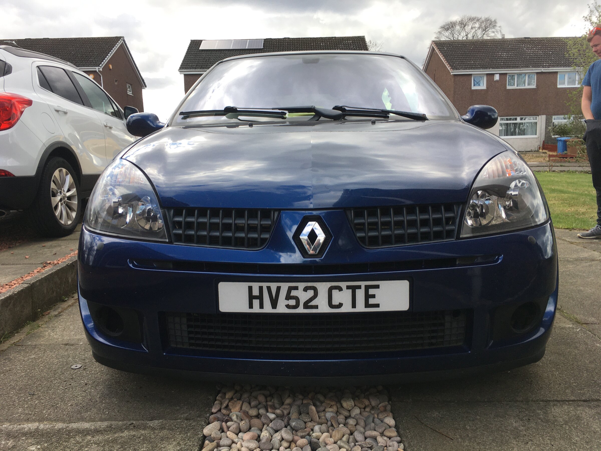

Bit more done today. Was with the kids though so totally forgot to get some afters.

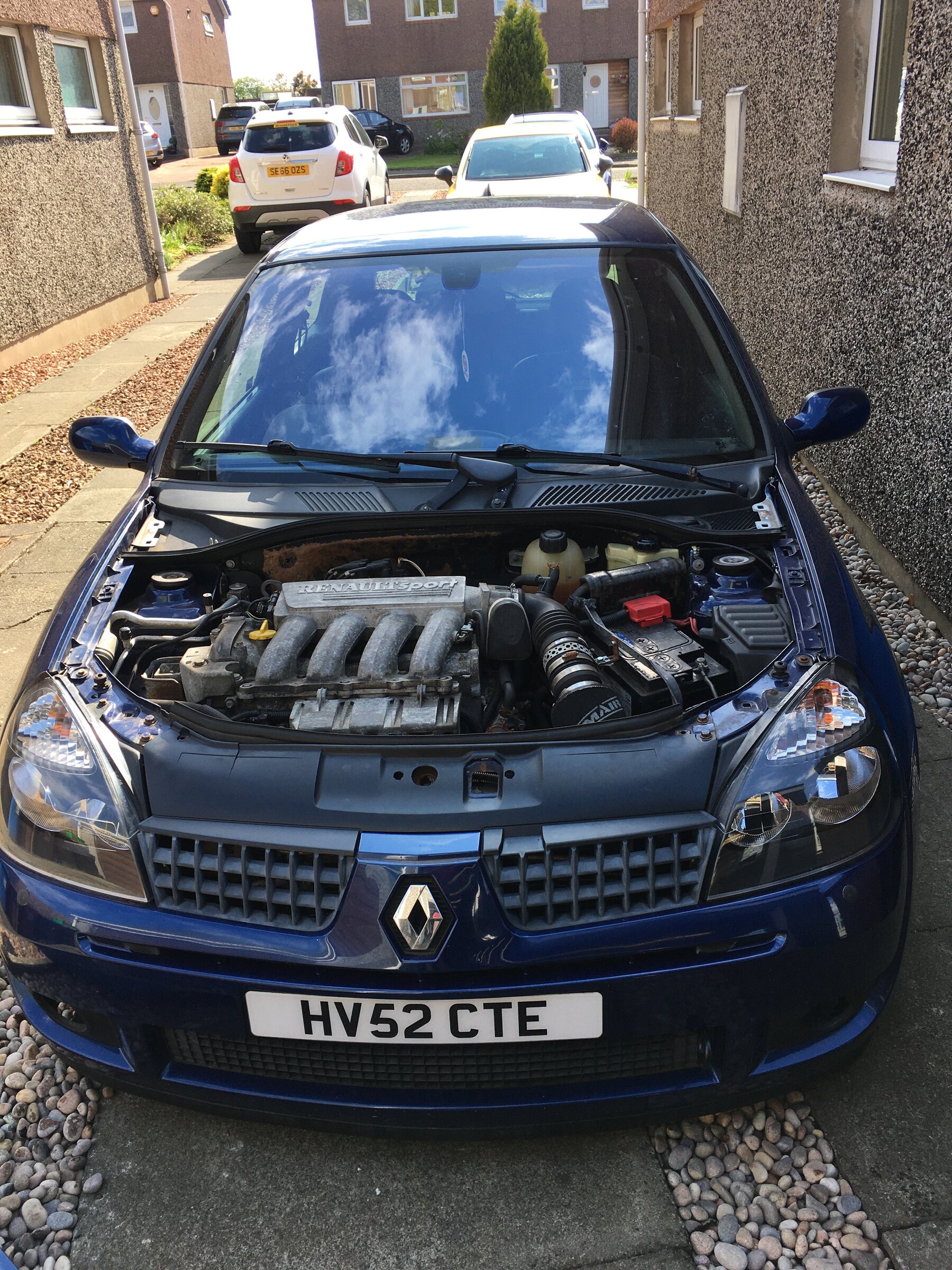

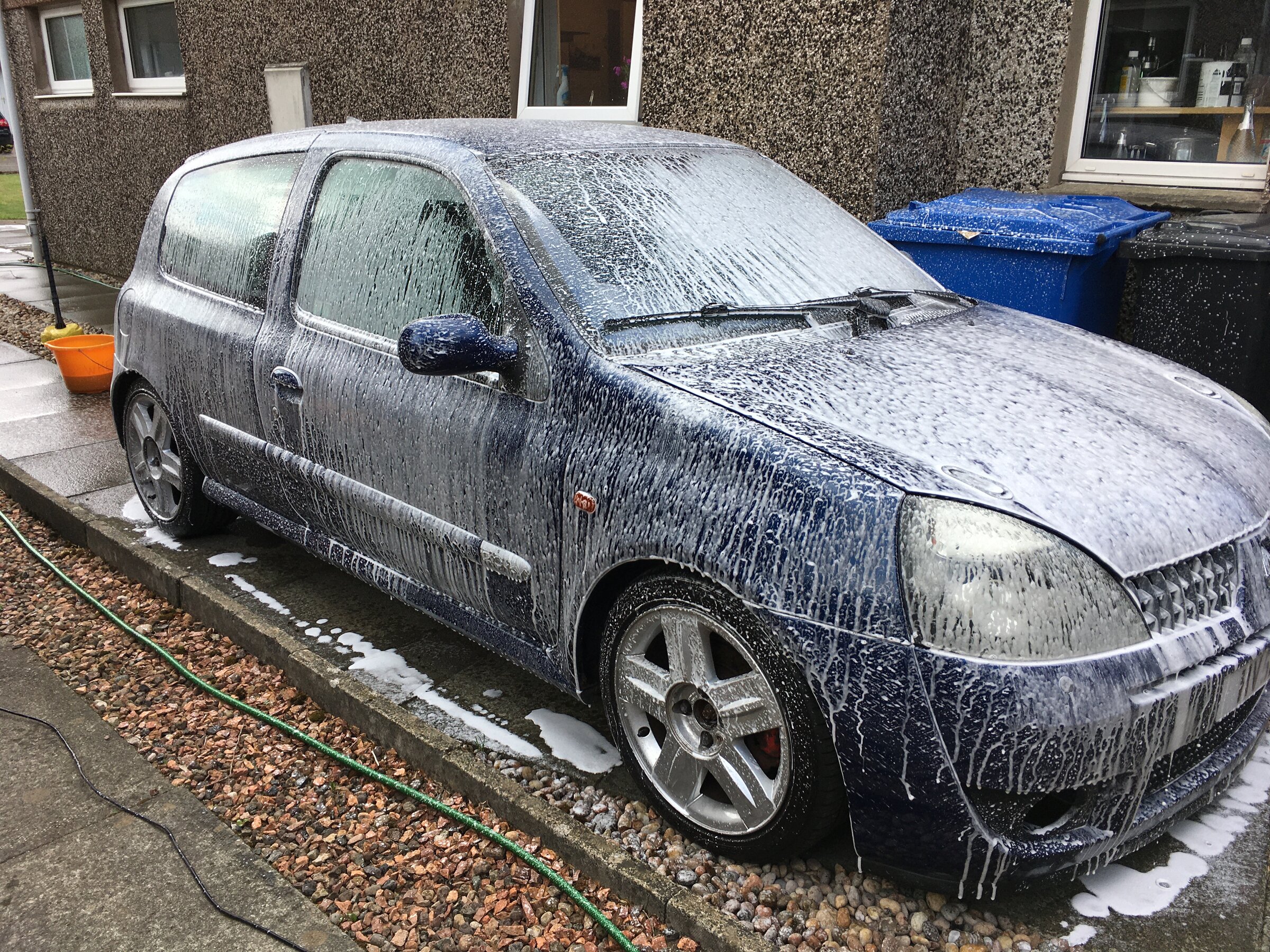

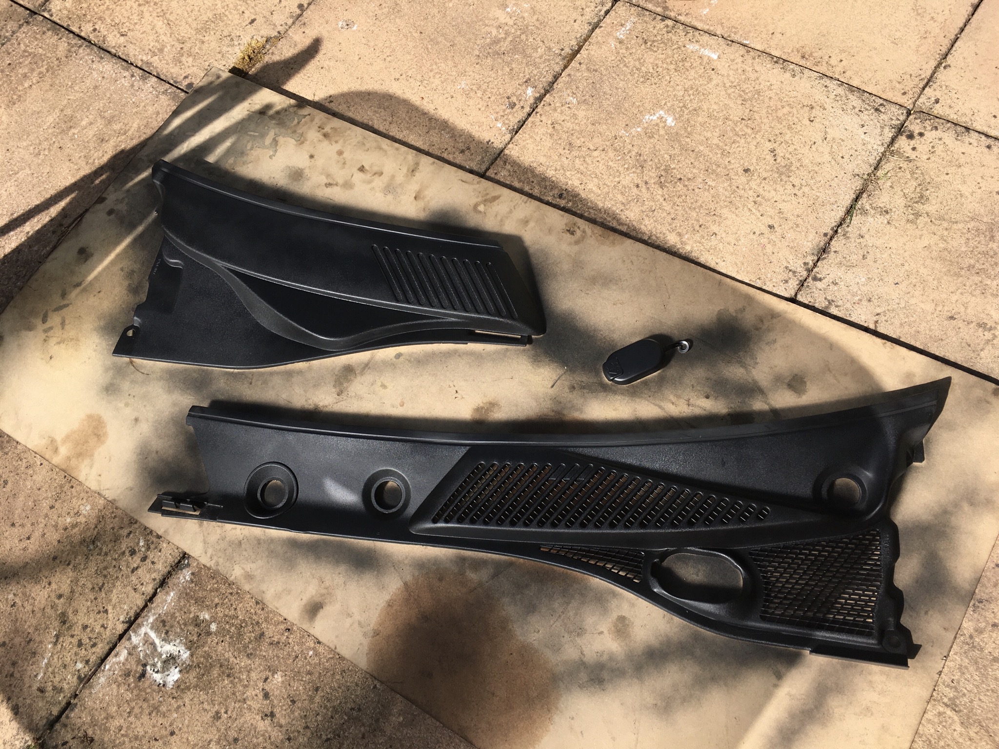

Trimmed the aerocatch pins, removed the acoustic valve, aircon pipes, carbon canister pipe work and rear wiper. And kinda washed it.
Also noticed that the aux belt has been done by Renault at some point
Looking a bit tidier under the bonnet at least

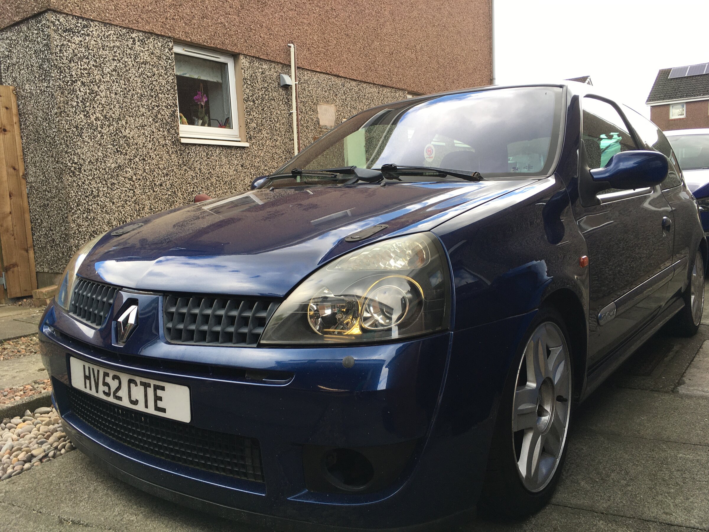

Wiper blank was Monaco it turns out
but I can't say I was a fan of highlighting that the wipers removed so now it's satin black

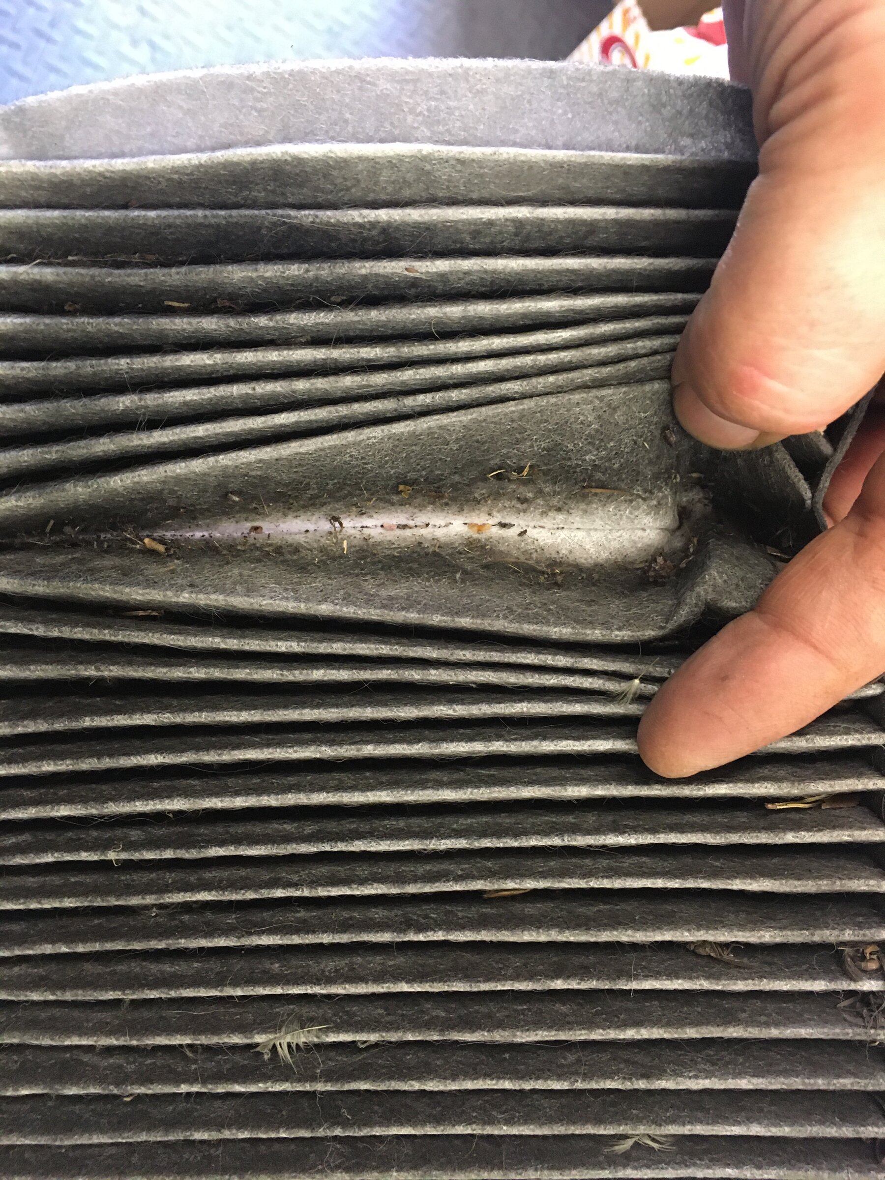

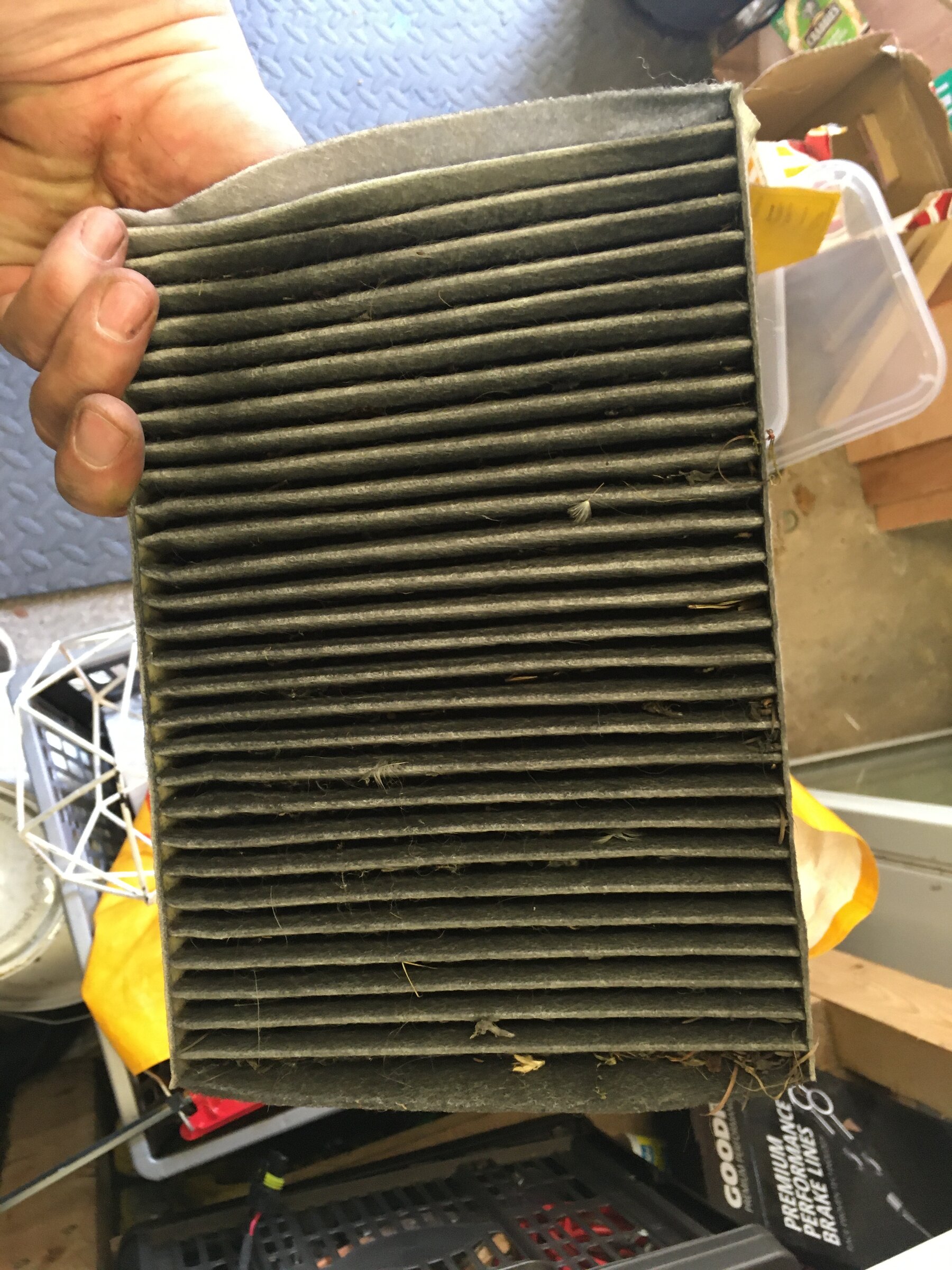

I really don’t understand why people don’t change pollen filters!
lol at that filter! whens it getting stripped and a cage fitted??
