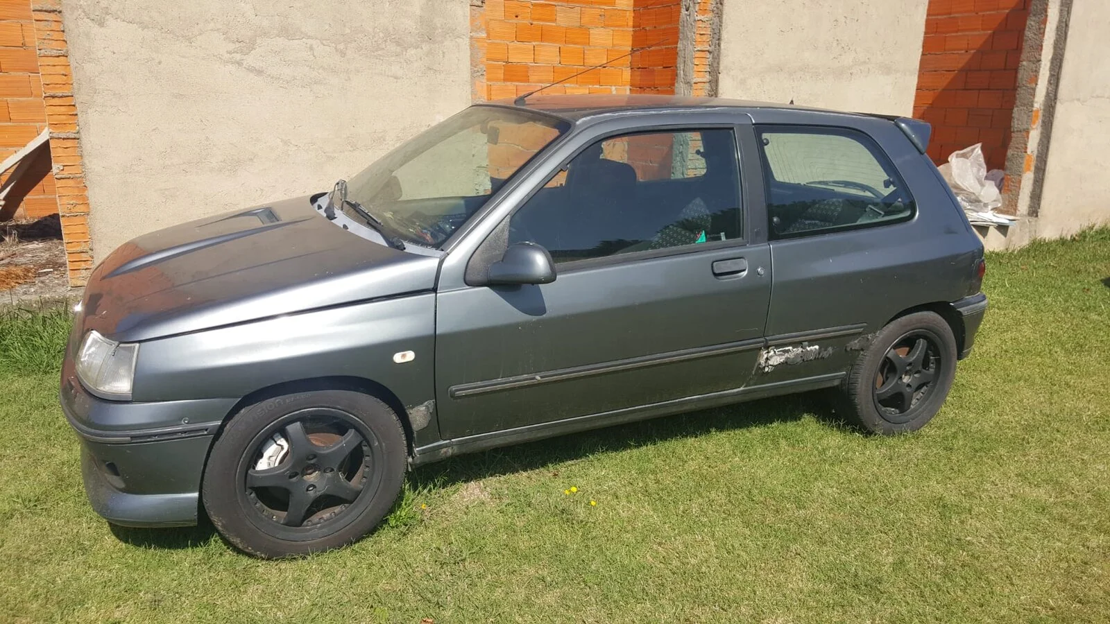

I recently bought a 1991 Renault Clio 16s
The car needs a "bit" of love, my initial goal is to bring it back to the original shape, exterior I already have a few parts and since I live in Canada and the car is in my original country, Portugal, and I'm only gonna be driving him next summer I want to start with the engine, I don't want to do a showroom car, but I don't want to do a track car as well...

Hopefully it is not too rusty - check behind the rear panel cards, so you can see the inside of the sills.
I'm not sure about the different air filters, but the camshafts are basically the only mod that will make any real difference (unless you turbocharge it).
I liked the standard engine - 137bhp is not a large amount, and the torque is much lower than the 2.0 Williams F7R, but less power means more time with your foot on the accelerator, and it is fun to rev! ;)
I would therefore suggest leaving the engine standard. Give it a complete service (cambelt etc.) and use decent 5W40 oil (NOT 'magnatec' - it hates it) and it should be just fine!
You could instead swap the Williams suspension parts onto the car - the original suspension will be tired now, so replacing with new OEM parts (if you can find them...) including bushes, should make it excellent fun to drive :)
  91 Renault Clio 16s
White16valver, the car doesn't have rust, only some fiber glass leftovers from aftermarket exterior parts, for now I want to keep it as close as I can to the original, in the future I would like to give it my touch, but nothing crazy, some basics mods, but thanks for the honest opinion and feedback, I'm gonna start looking for the williams suspension! 👍
