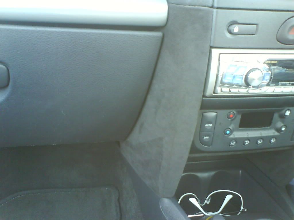

After doing my A pillars and having plenty of alcantara left, I decided to do some of the dash bits:
How do you do that?
Just get the alacantara and some spary adhesive and glue it on?
i really fancy doing it, car looks poo with cheap plastic.

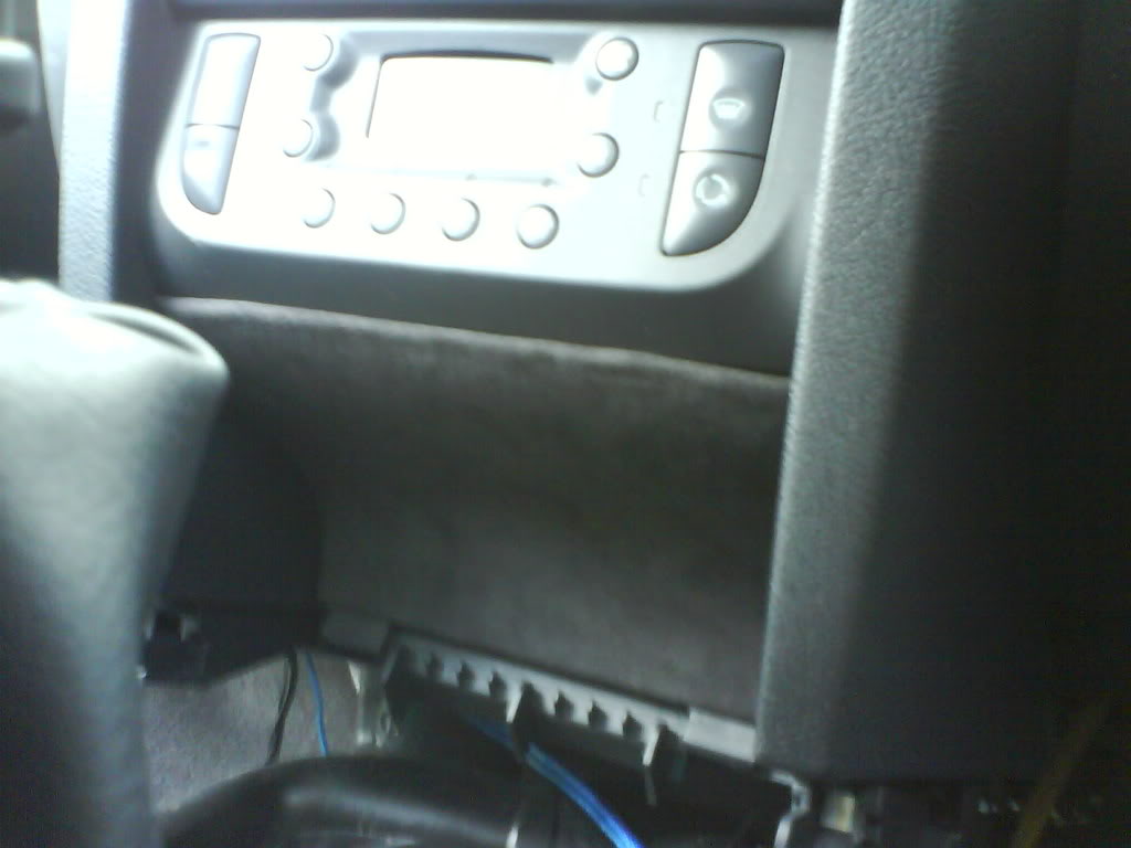

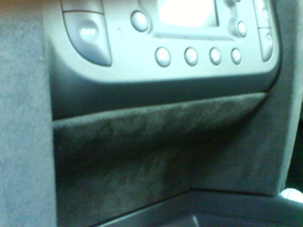

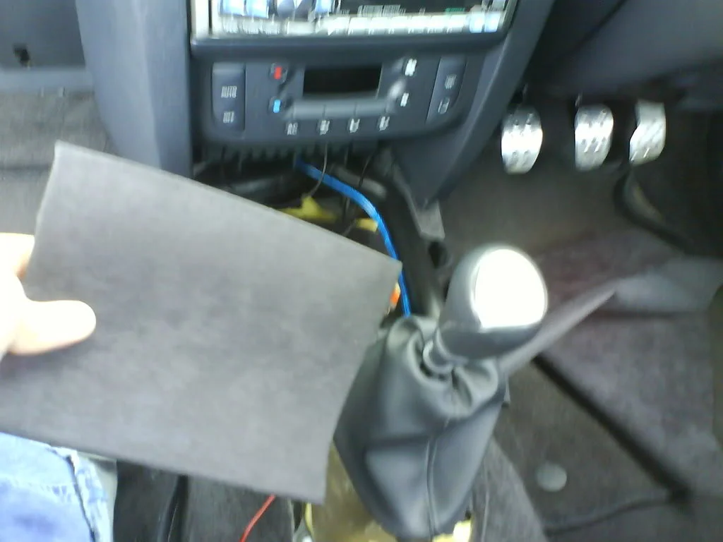

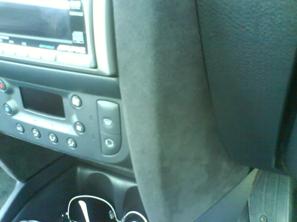

I took the pieces off the dash, it does break them slightly because they are plastic welded to the part behind them, but they go back on fine with a bit of glue! Used some evostik contact adhesive and applied some charcoal alcantara I got from ebay ages ago (before I even bought the car!) The pictures are a bit sh*t really, but I'm sure you guys get the idea and you can take a look at the next meet or whatever.
I believe a firm called Martrim can supply charcoal alcantara, they send out samples too so you can check how well it matches your interior.
