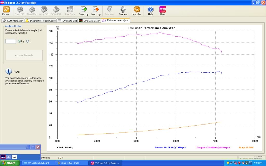

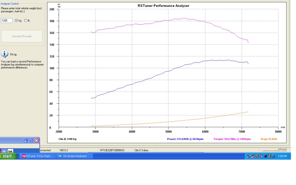

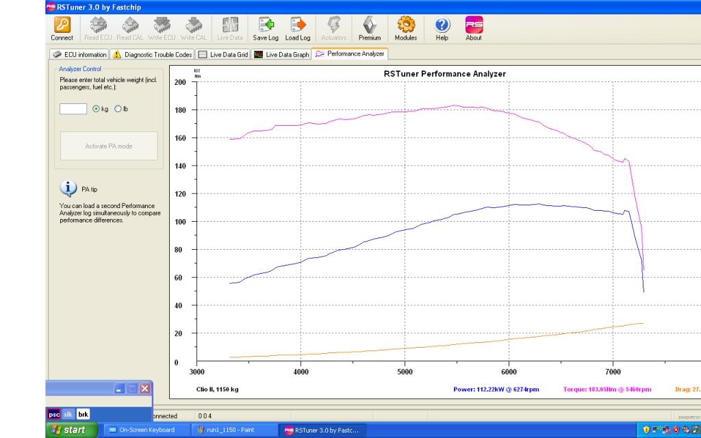

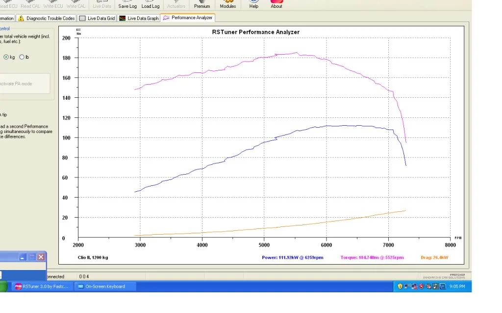

Ok ran a few more runs this eve as it was a nice calm eve no wind and such, went down the bypass in worle did a few runs at 1200kg and a few at 1150kg as im aware that if im saying its a heavier weight than it is i'll get results that say its better than they really are.
So based on the 1150kg runs it looks like im running around 150bhp at the wheels which should mean around 178bhp at the fly?
