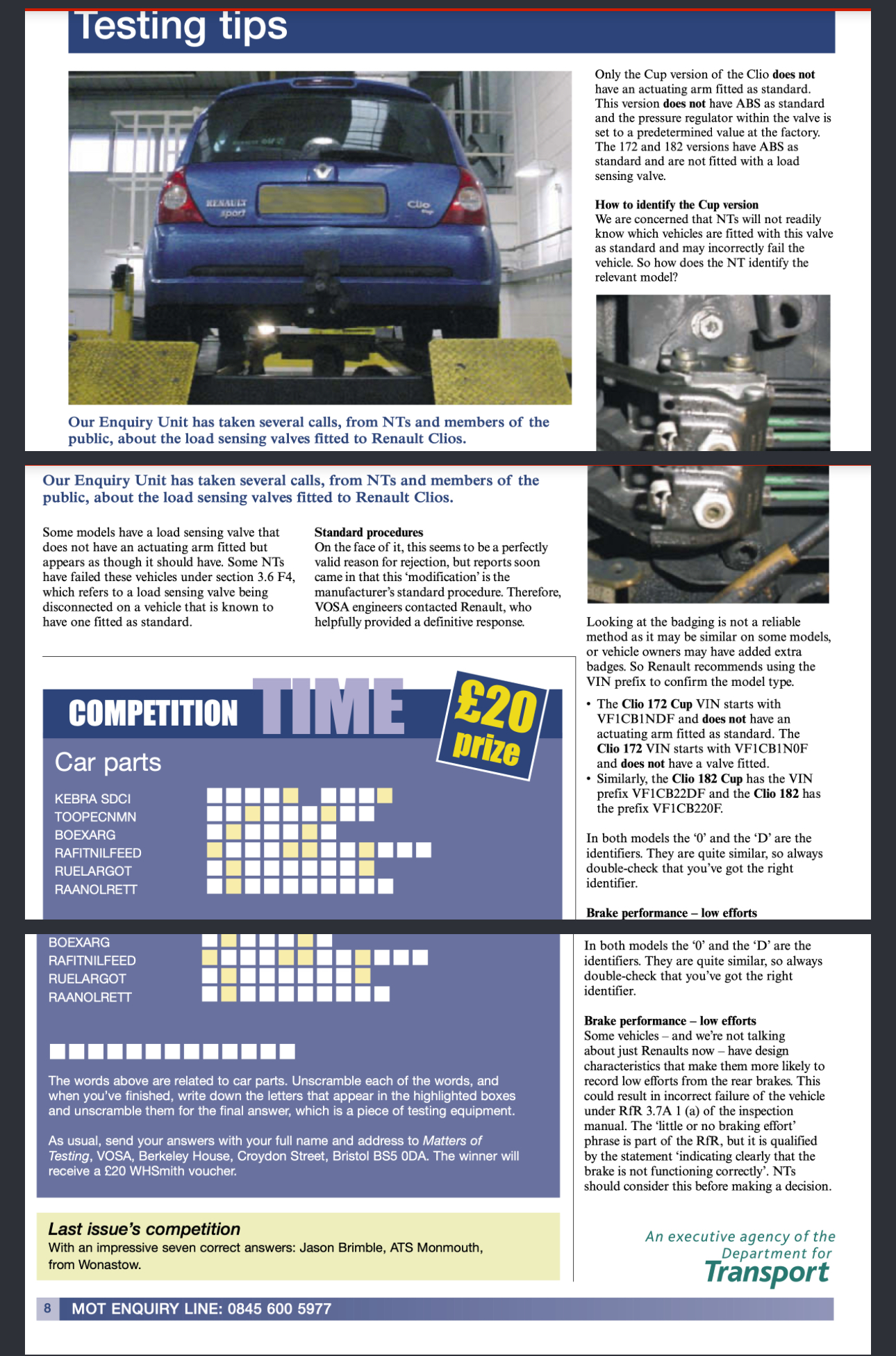

Matt Cup
  Leon Cupra
Unless I’ve got the complete wrong end of the stick I don’t understand why it was classed as an advisory? There was a dvsa bulletin specifically for 172 cup brake efficiency.
