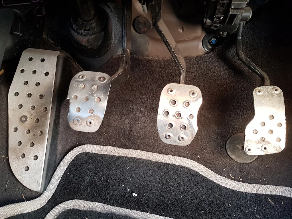

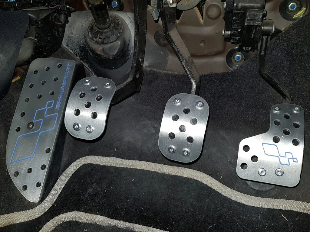

My 182 failed its MOT today due to "Brake pedal anti-slip provision missing". But looking back at my original pedals it doesn't look like they had any rubber on them.
Is the fact that the holes on the original pedals are raised up slightly enough to cover this?
The new ones were fitted back in 2018 so have been through 2 MOTs with no advisories. :unsure:
Original:
New:

If pedal is in decent condition Refer him to this:
A brake pedal without a rubber usually has grooves or raised sections to provide grip in wet conditions and should be rejected if it’s worn smooth. However, some vehicles may have been manufactured with a brake pedal which did not incorporate grooves or the fitting of an anti-slip material and these should not be rejected

Yeah that shouldn't have failed on the pedals.

Legend! Thank you, I'll print that out and take it with me. Which panel do you mean?

Tweaking the rear light connectors did the trick. And I printed out the brake pedal rule. Apparently it caused quite the discussion between the two MOT testers, which made me smile when the garage owner told me. :LOL:
He also mentioned that the holes on the original brake pedal in my picture have a slight raised part, which would offer more grip. Which I can totally agree with. But the new pedals still have grip, they're just slightly different.

interesting, 172/182 pedals have been one of my most popular items and this is the first case of a car failing an MOT on my pedals.
