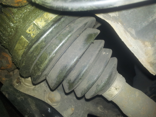

Not happy. Front Nearside CV joint gaiter insecure to the extent it no longer prevents ingress of dirt.
Costly job lads then? Halfrauds quoted me £150!! Said it's fixed on with a tie wrap! No idea why - never hsd work done on it but that price seems excessive to me.
Any ideas? Could I possibly do it myself?
Ta.
Leo
Adamm.
Don't take your car to halfrauds and let them work on it, ever lol.
As for the gaiter as above really, take the wheel off and you should see the mess and where it's come from. I used a jubilee clip when it happened to me but if you can get a proper clip then do that.

I imagine the gaiter itself is ok as they only mentioned it was insecure both on the paperwork and in person.
Jubilee or boot clip then will be ok? 70-90mm jubilee size is it?

@Leo182 I went the motor factors and got a proper boot clip was about 50p and used that when i had too do a CV boot the night before my track day think the boot kit is about £8-9 and you get new boot, grease and clips, luckily the motor factors was open till 5:30. Where abouts you based it is literally a 30 minute job to change the CV boot (well i took my 40 mins on my 2nd attempt as i pulled the driveshaft out lol, luckily not all the way and it slipped back in and it was dark thats jacking too finish lol and i'm a total novice with spanners), I tried to find a jubilee clip that was narrow enough too fit in the slight recess that holds the boot on and couldn't so thats why i ended up using proper clips and using the pliers i have linked below pulls them nice and tight.
These are what you want (just not 15 lol go your local Motor factors and ask them they should have some pretty cheap) http://www.ebay.co.uk/itm/CV-Boot-C...261?pt=LH_DefaultDomain_3&hash=item2344e86505
Also bought a pair of these for the clips which makes sure they are secure and pulled tight http://www.ebay.co.uk/itm/CV-JOINT-...324?pt=LH_DefaultDomain_3&hash=item565b5e592c
  Track 172 Cup
Just don't pull the drive shaft out all the way and you'll lose no oil, I didn't when I did my passenger side boot and I pulled the drive shaft out just not all the way luckily.

I managed to take a quick look today at it, been raining so couldn't have a go at it properly, he reckons someone has put a tie wrap on it!!
Boot looks fine too which makes the £150 laughable!
Does anyone know what's happened to the clip? doesn't look broken as such

Thought I'd update this to show what an absolute joke Halfords are.
Passed today with my £2.50 hose clip attached! I feel like sending in a complaint though as saying £150 is absolutely scandalous.

The CV boots on these are a joke. Such a flimsy method of staying attached to a hub that is forever pulling on one side or the other.
Then nice, warm CV grease drips out of the boot onto the inside of the front alloys. That cools (or gets splattered all around the alloy if its moving) and starts throwing your front wheels out - giving you vibration through the steering wheel at speed.

Can someone confirm the size of the small clip on the other side of the CV boot, not the large 70-90mm. I bought the tool above but would like to use the ear type clip not the hose clip unless anyone tells me otherwise. Nobody seems to give the size of the small clip.
  Clio Trophy
Thanks for that. Doesn't seem to be a common issue. Always seems to be the larger of the clips. And buy the way, how best to remove the old clip without tearing the boot ?
Just a flat screwdriver underneath I think, Ive had original clips break off just by looking at them, failing that pliers or cut it off with a dremel carefully.
  Clio Trophy
Thanks for your help once again. Part of me just thinks that I should just go with the hose type clip. I wonder whether I can get some grease in through there rather than via the outer larger side. Don't really want to touch the large clip as it seems fine.

Going in for an MOT this afternoon, and just did a once over the car and i have the same problem. Noticed grease on the inside front drivers wheels, looks like a loose jubilee clip on the cv boot spilling grease everywhere.
