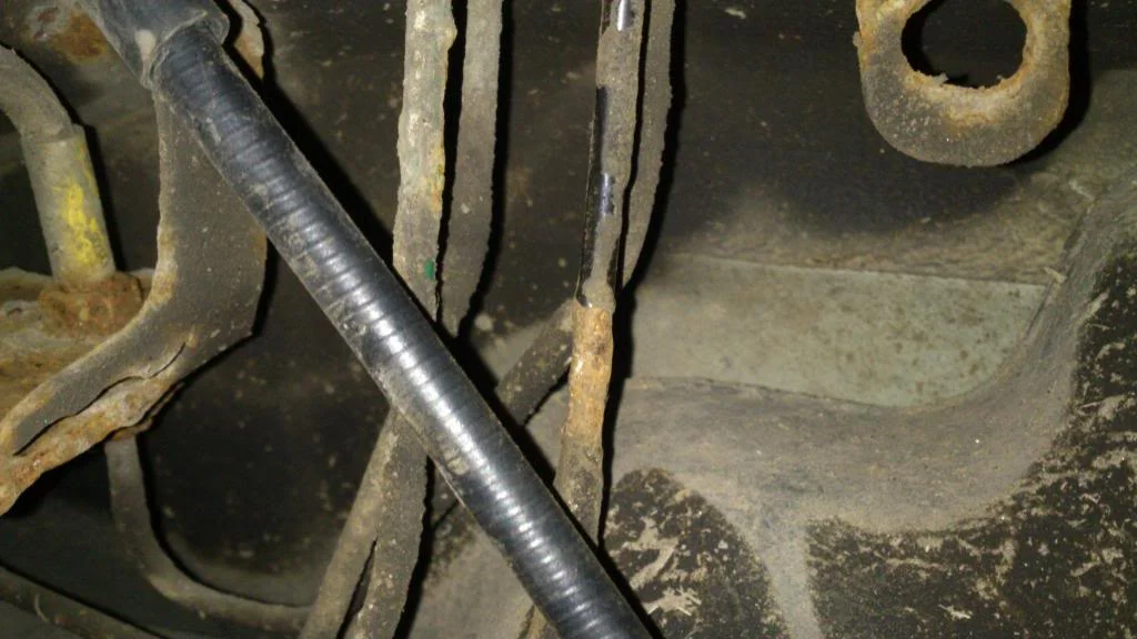

Mot fail for corroded brake pipe
Car  172 Rally Car
Checked the pipes and this is the only bit i can see... is this what its failed for? if so whats the best way to fix - cut it out and fit a replacement section or change the whole lot?
Yes probably, from what I see it's by the rear axle? That piece is small so easy fix. Replace don't cut and fix. Always clean mine up and put a bit of copper grease on before MOT
Its the pipe that goes from the join near the subframe into the compensator valve - the whole run of the car
Are the unions all metric?
Cheers Sam
Well if im honest i would have thought that would be an advisory but in not the expert.
Failed on : 001 (front to rear) Brake pipe excessively corroded [3.6.B.2c]
