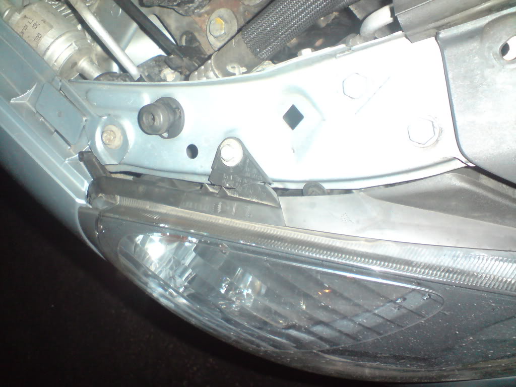

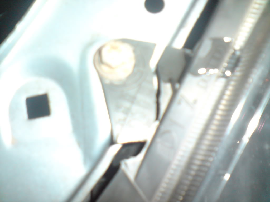

This is the worst one which wobbles ( i have pulled out the lamp as far as possible to show damage)

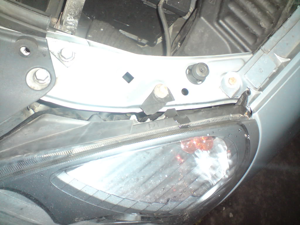

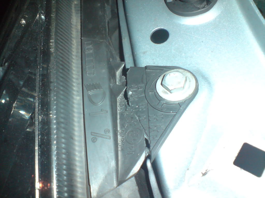

And this is the better of the 2
Would you not be able to use superglue wait for it to dry and then fuse the edges with a soldering iron? Obviously it would need to come off the car though
When I say fuse the edges I mean go over the crack and seal it
