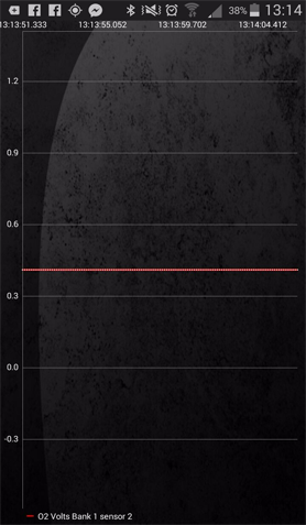

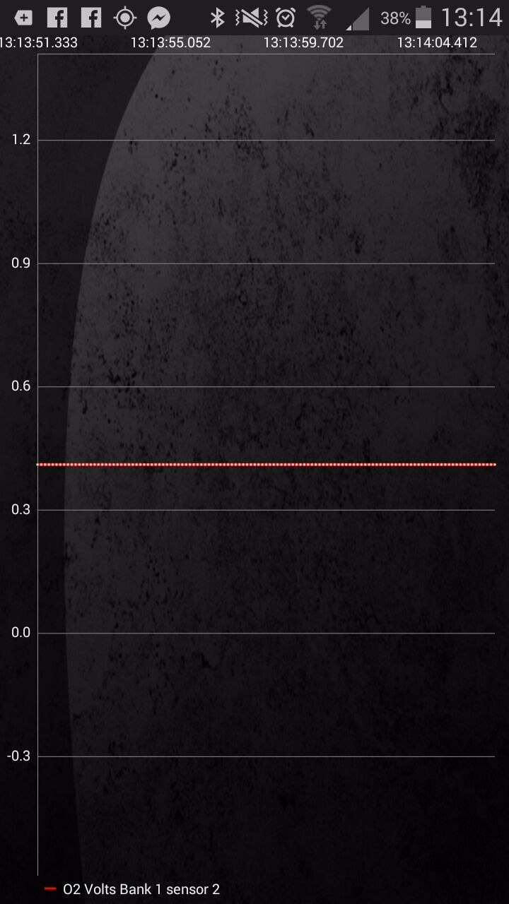

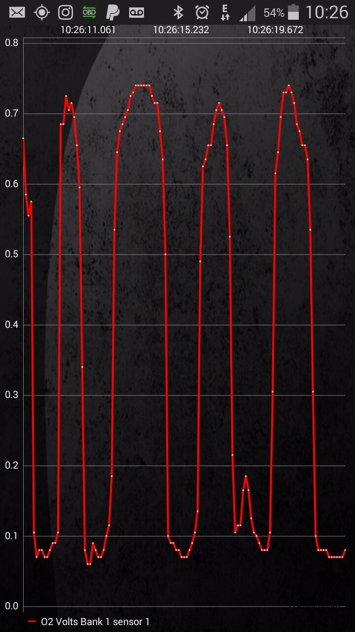

Had a look at the lambda readings too, precat seems fine, but is the postcat reading too high? I'll try switch them over and see what changes.
Should post cat be reading more like 420mv? Torque could be inaccurate though.

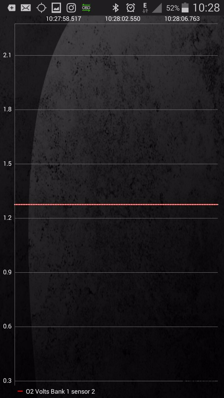

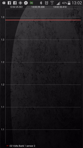

An update of sorts. From my 1.2 I had a genuine Bosch sensor lying around which i believed to be knackered. I fitted it onto the post cat and I got this constant reading, higher voltage still than the one i took off.

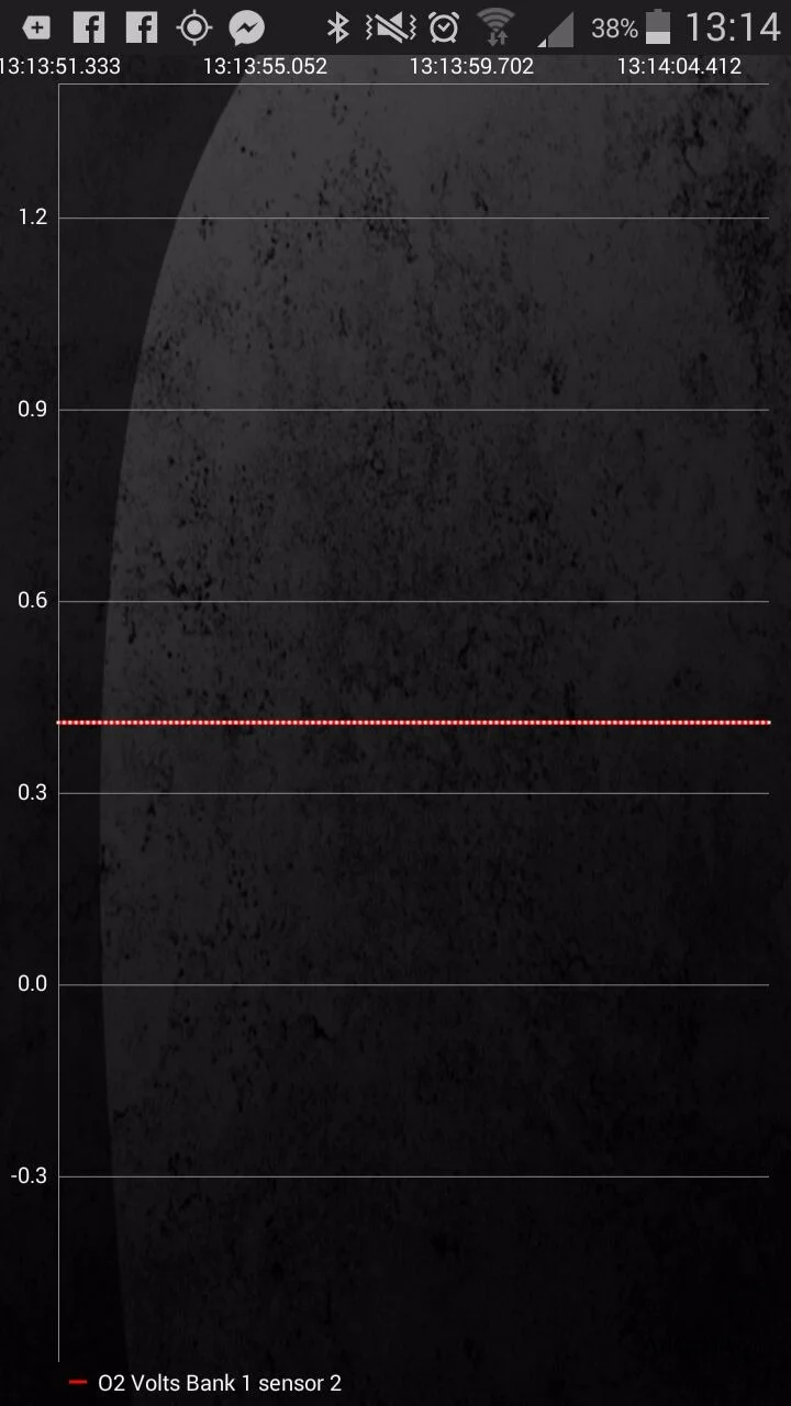

I then also had a real cheap brand new universal lambda lying around from my 1.2 too. I fitted this, and the constant reading seemed closer to what i thought it should be 420mv ish.
Soo, i believe my 2 bosch sensors are knackered hence the throwing of my EML. The thing is, how good are these universal ones? Will they just s**t themselves quickly or cause me any other problems with my car? I will probably refit my decat anyway after MOT time, so if I was to spend £45 on a new bosch lambda, it would kind of be pointless.
