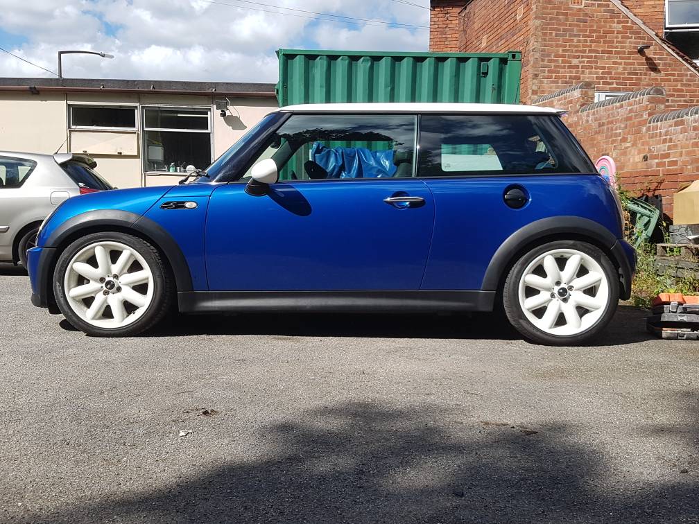

no side on pics to show you how it sits as i havnt taken any yet lol. but seen these wheels for sale n im tempted

Love the wheels, I'd be all over them if they were closer lol.
16's would be better though I reckon.

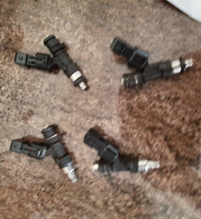

well my st225 injectors and the adapters have landed ready for install the weekend then i can load the jcw210 map looking forward to getting it on

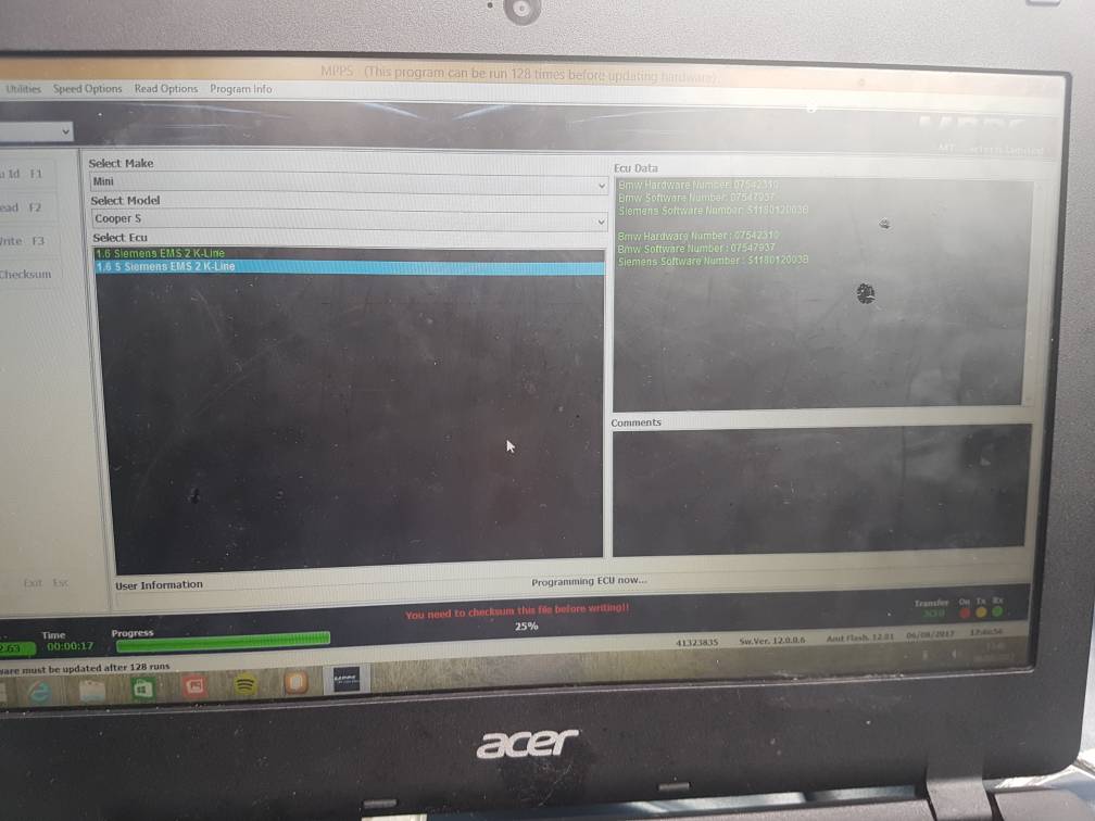

well ive fitted the st225 380cc injectors (same spec as JCW 380cc) car runs fine. tried to upload the jcw210 map and it errors on 99% upload so at this point write the std map bk on unplug and test the car starts it dont!. i write the file again after my bottom got a little loose and it works this time custom map it looks like. gutted it didnt work as the 210 file can run a decent spec

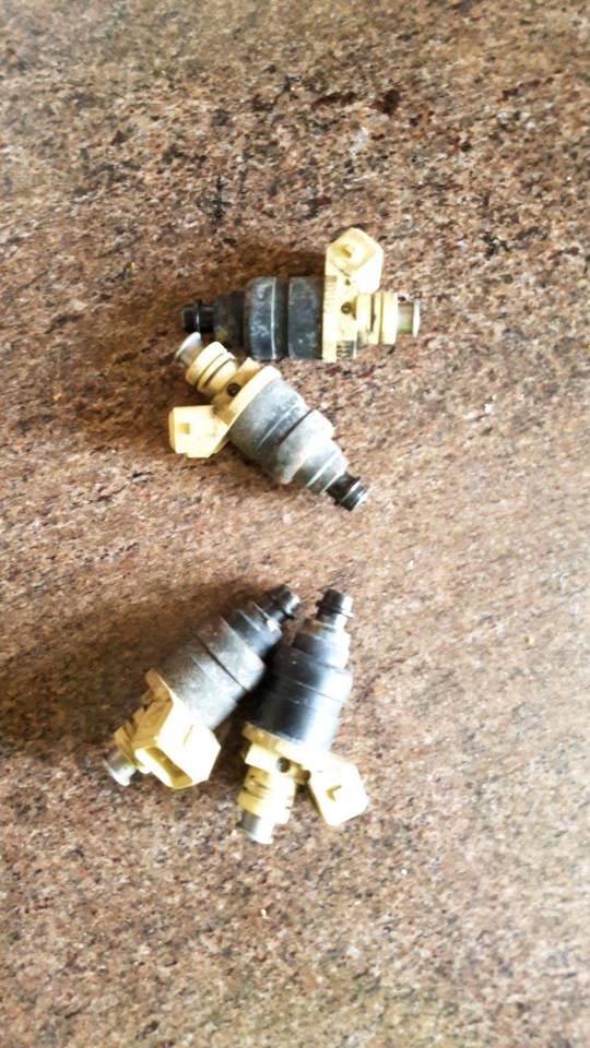

old 340cc injectors looked past it

well after chatting to a mapper on a mini page about the issue putting the jcw210 map on my car he asks me to fire over a copy of my map that i did also attached the 210 map in hope lol. A hour later he sends me a altered version of my standard map with the advance fueling and torque limit that the jcw210 has so i plug the car in and it goes on at starts great
. took out for a quick run well i can say it pulls in a difftent manner its harder im well happy with this guys help. he also has sent me a file that he has pushed alittle more when i asked whats he changed he juat said "try it" lol ill give that a try tomorrow may need to pop to a rolling road to get AFR looked at
