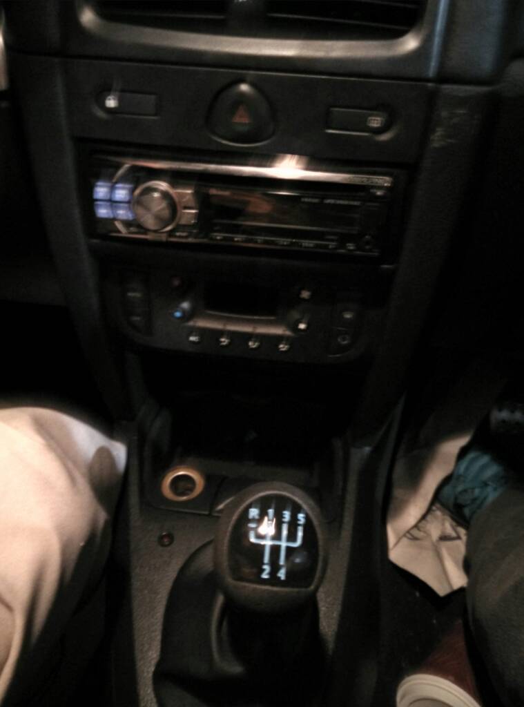

So swapped the stereo later that day

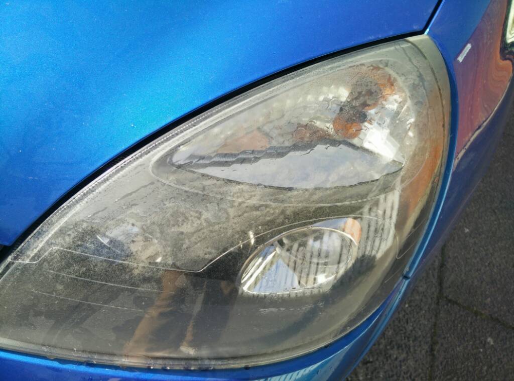

Then the headlights were looking sorry for themselves so gave them a bit of tlc

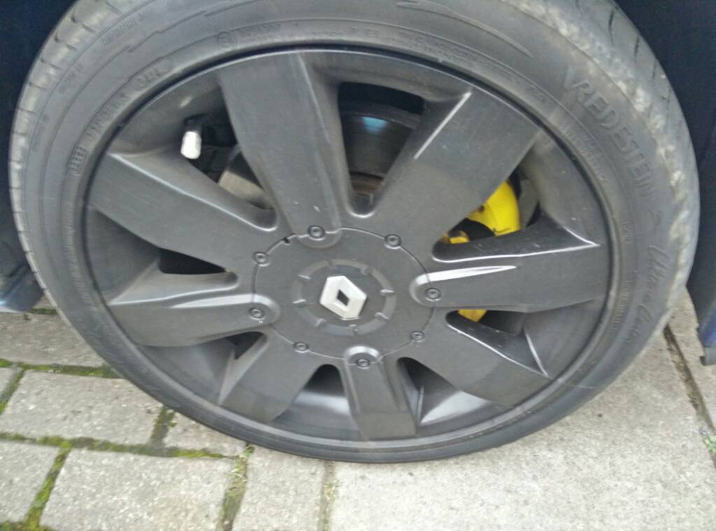

It got treated to hc front disks Renault rears n brembo pads all the way round the calipers were given a fresh lick of hammerite yellow while i was at it
Wouldn't normally go with yellow but they seem to be growing on me behind the black wheels

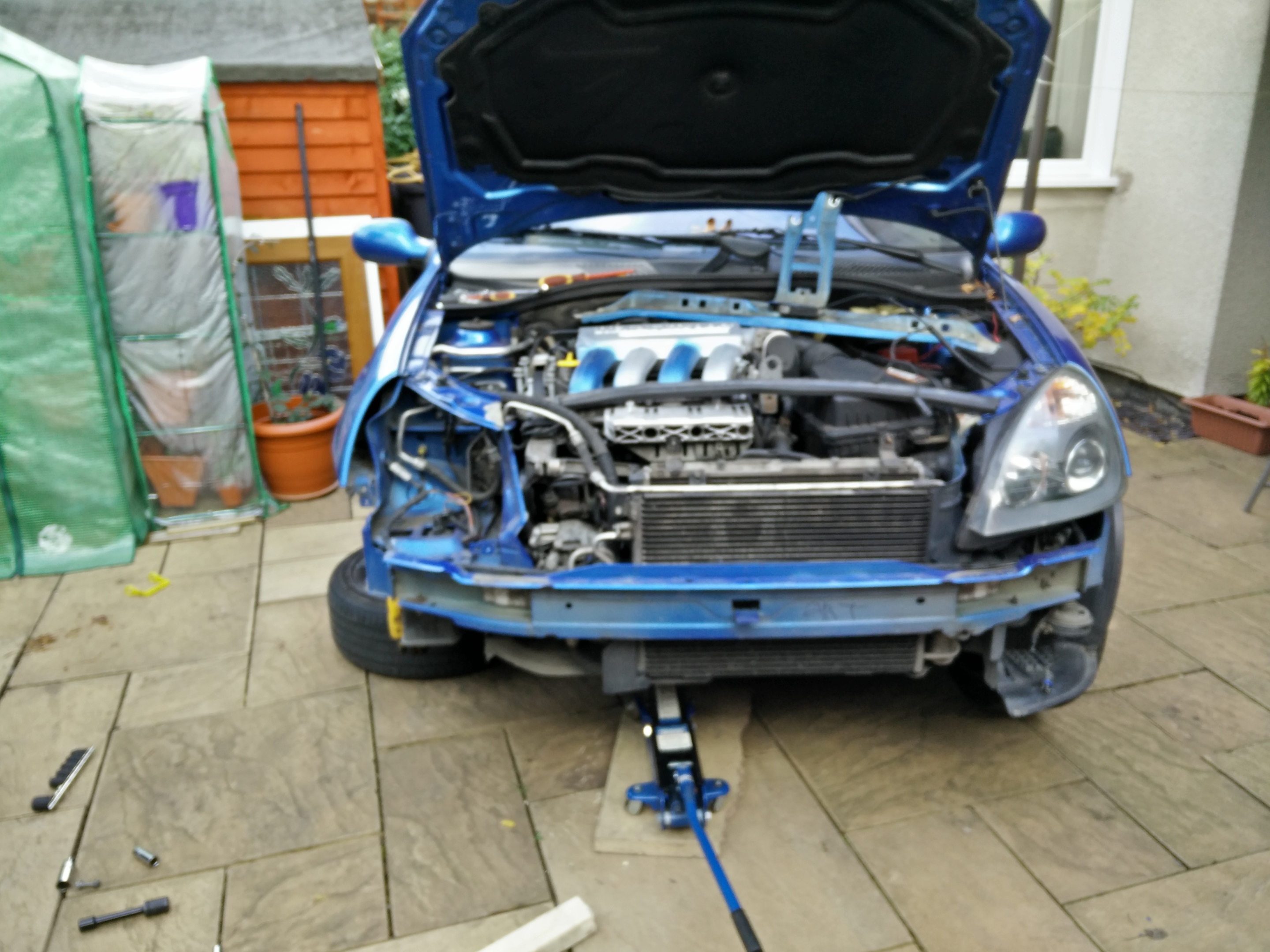

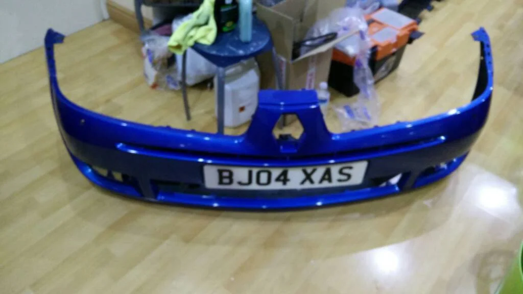

Took the bumper off to sort the grill...
While it was off i stripped it completely to find the washer piper was trapped between the grill, sorted that treated the plastics and gave the bumper a once over woth the rotary
By far one of the most stone chipped bumpers I've had but from afar it doesn't look too bad

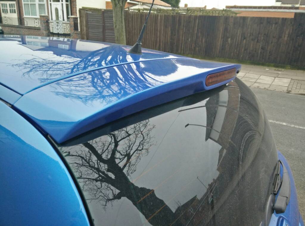

I fitted a c2 aerial as the old one was battered and falling to bits, inspired by Daniel's Arctic thread.

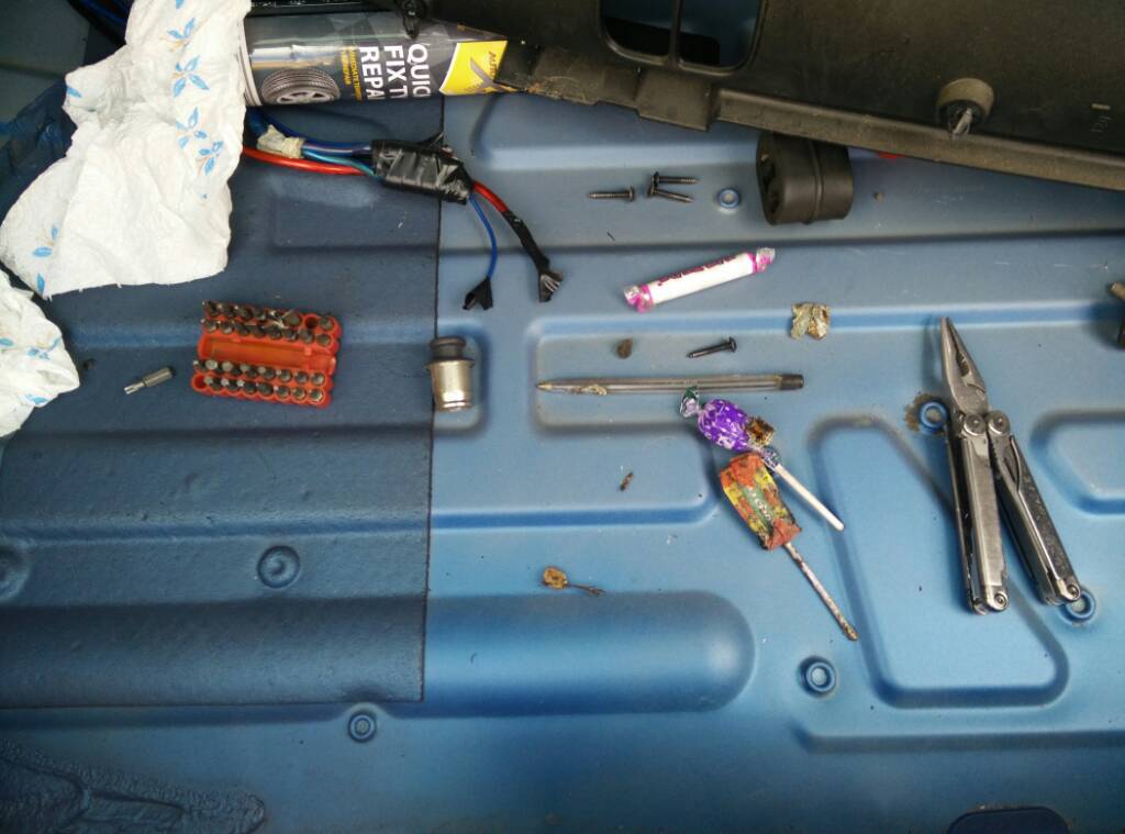

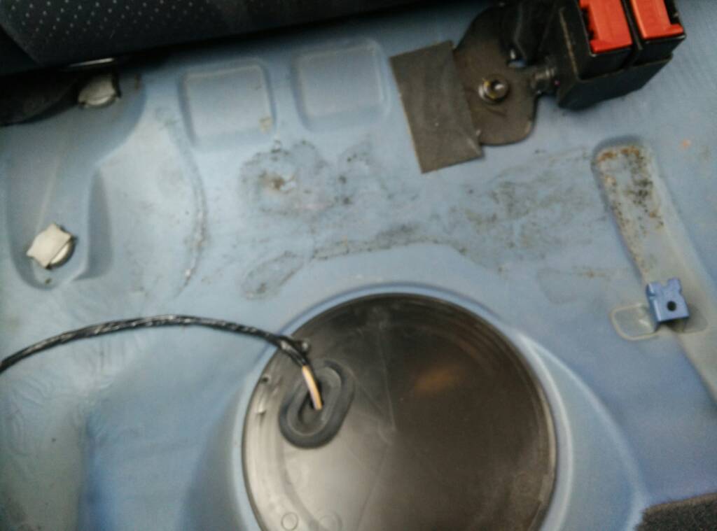

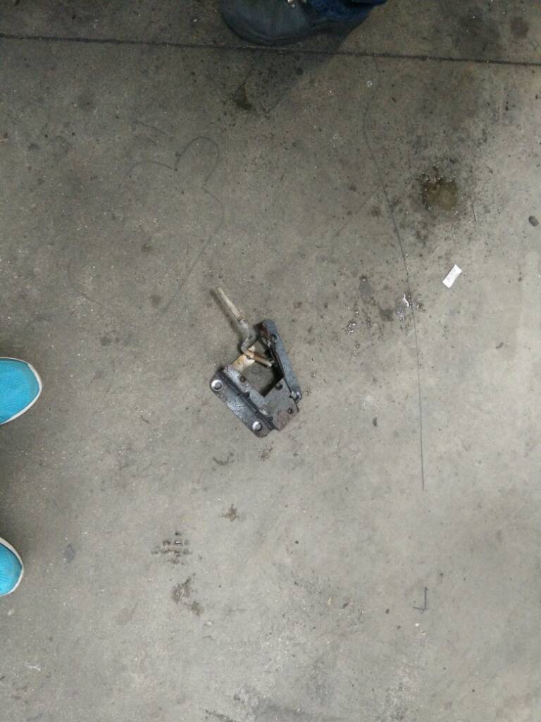

Washed the boot liner as it was stained, went to refit and found water in the boot
So to investigate i took off the rear boot plastic
Found all sorts of random crap, sweets n a cig lighter as well as some mouldy food?
Turns out the previous person to take the trim off didnt remember there were already holes for the screws
Anyway found the leak it was the stops for the boot lid so cleaned them up and sealed them

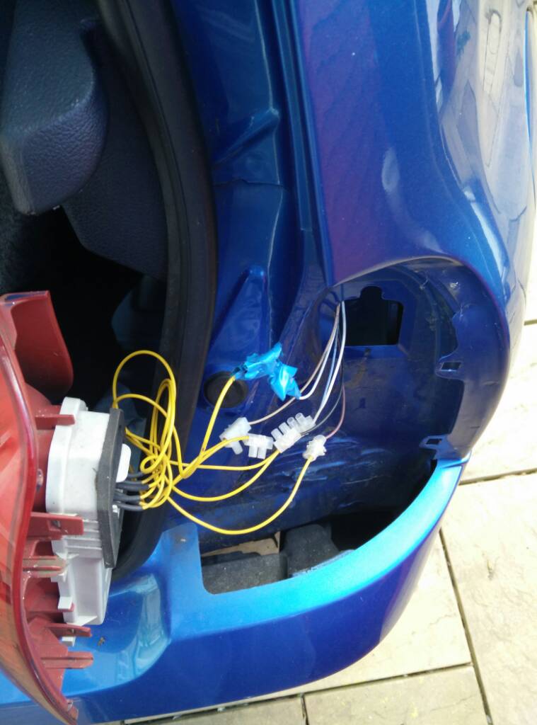

Also found this quality wiring, the person decided that renault connections werebt good enough so soldered the wired directly to the bulb holder melting it while they were in there... So need a new one

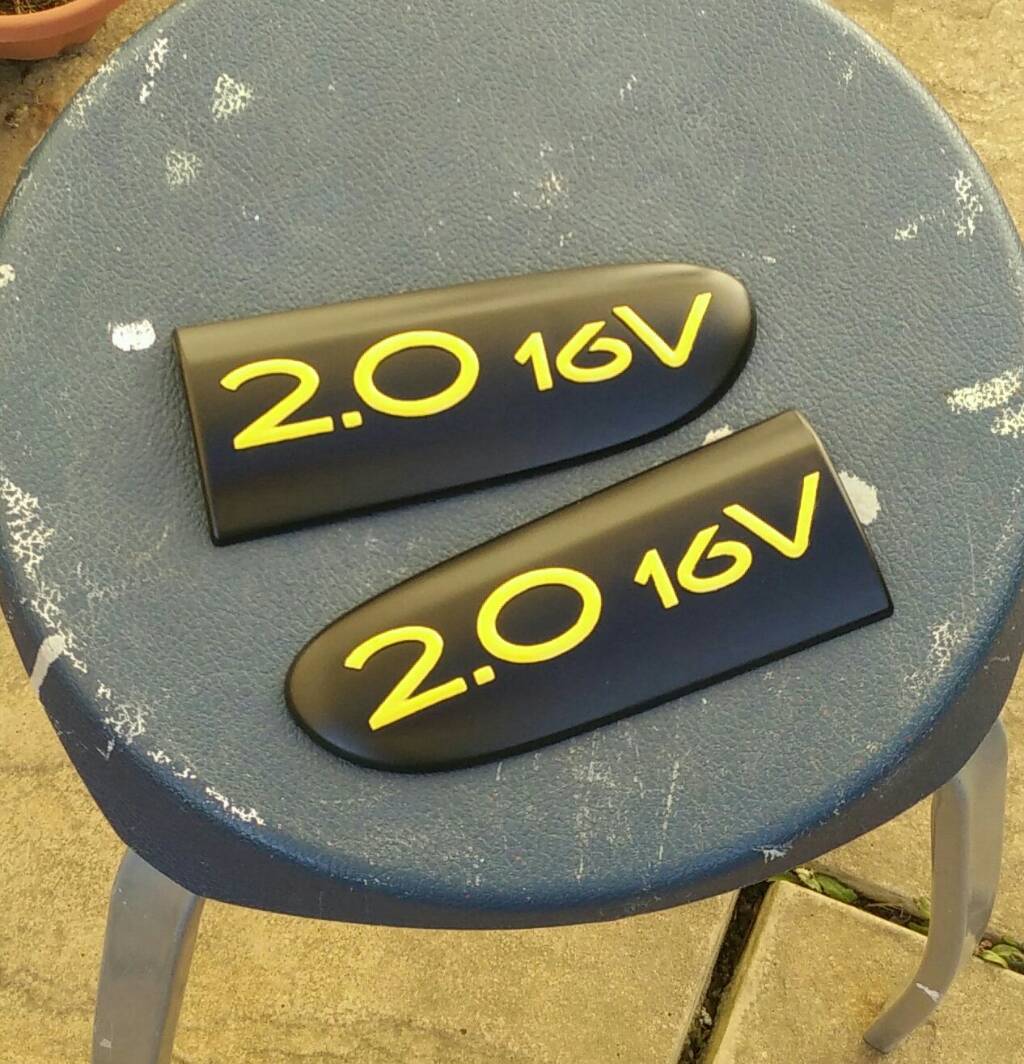

Decides to paint the bullets while i was at it

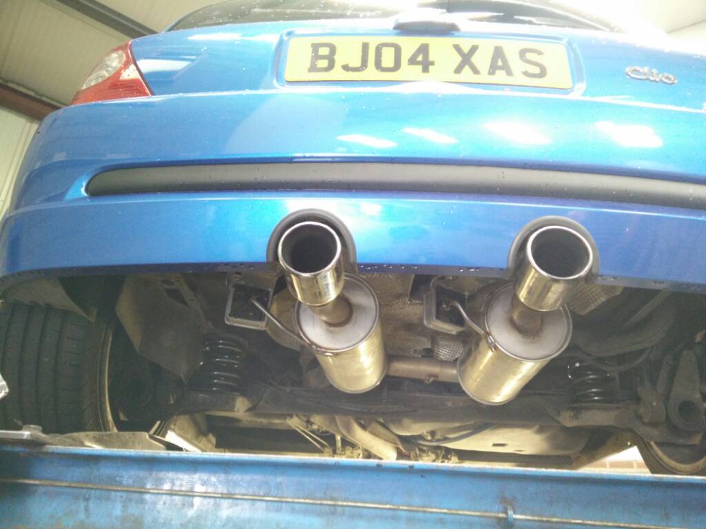

Today took it to custom chrome in Nuneaton to get the exhaust mounts sorted
Out with the old
In with the new

Had the cat / manifold gasket changed but its still noisy! Need help with that,any suggestions welcome.
On a more positive note Graham at custom chrome is a genuinely nice guy and knows what he's doing. Would recommend him if anyone needs exhaust work doing.
