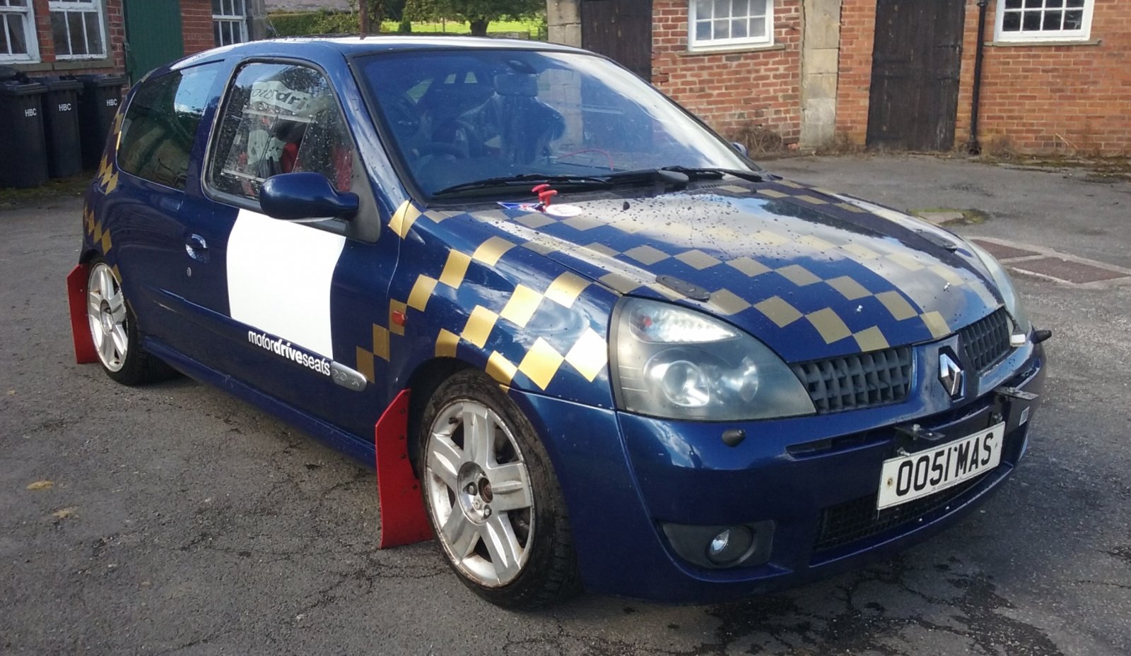

Some pics of my 172 for this year's Mull.

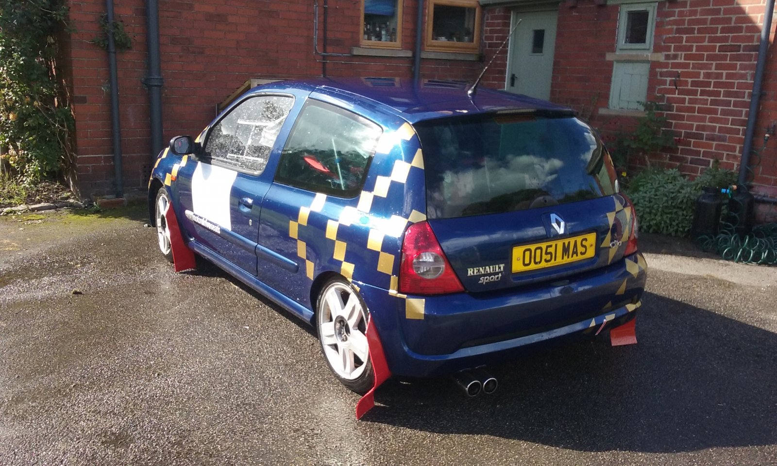

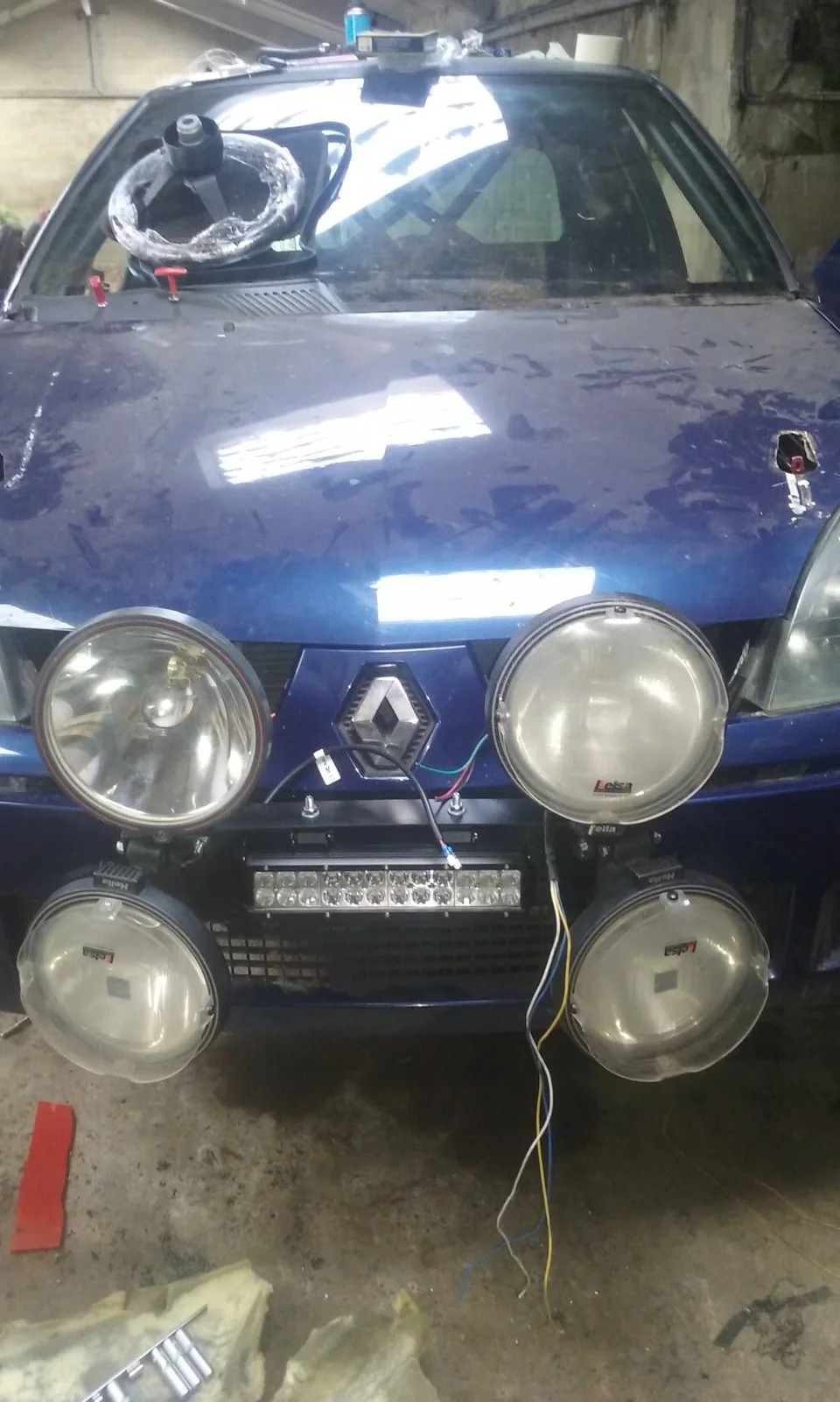

Some more pics of the car.

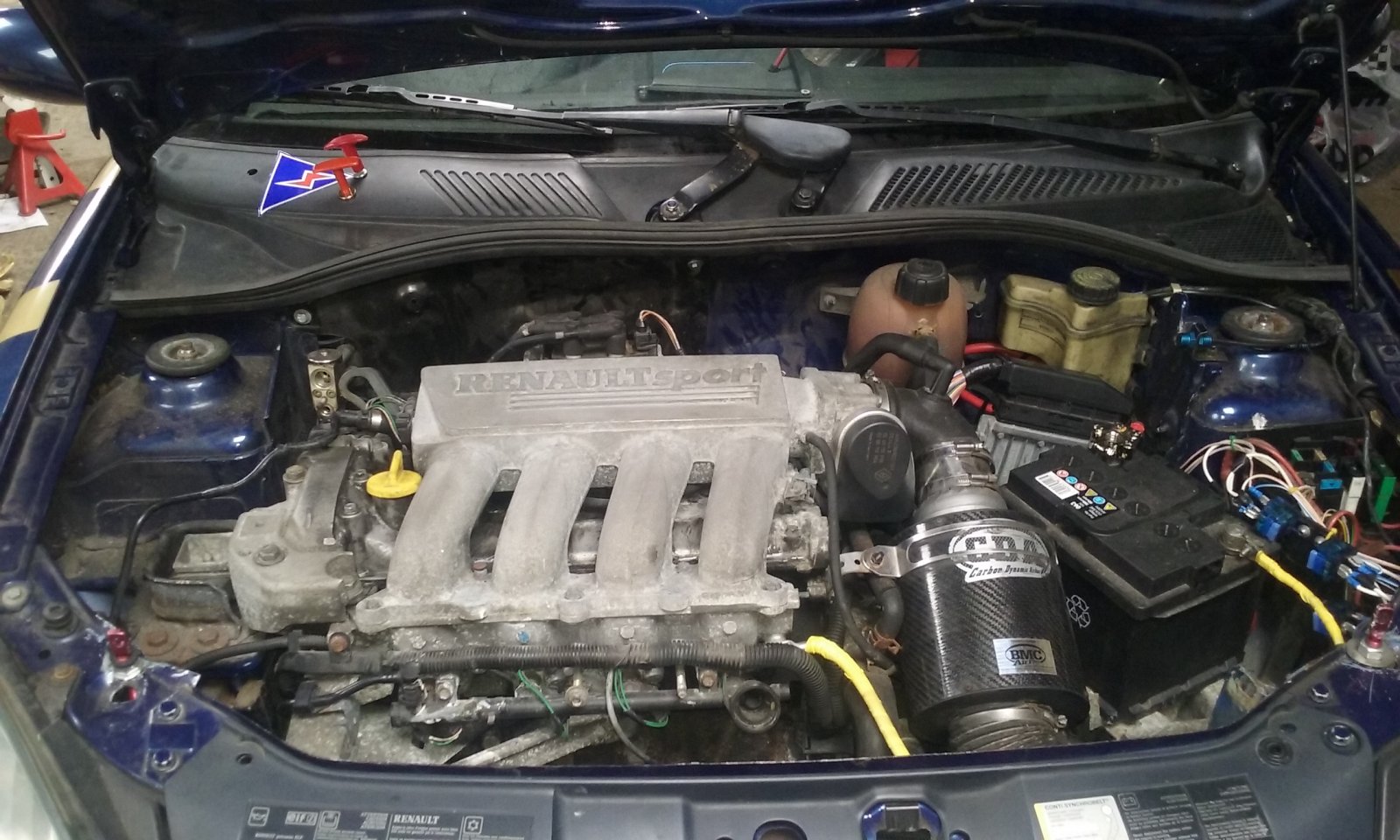

Standard engine and box at the moment. Money and time were against me. Improvements will have to wait until next year.

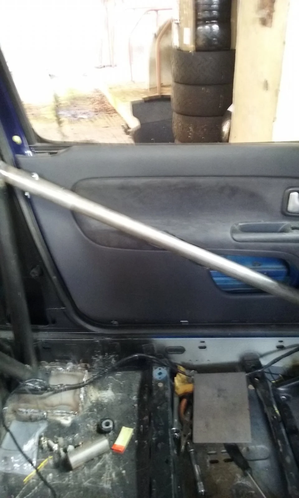

Spax adjustable suspension on Euro spec spring rates (circa 400lbs)
Sassa cage (walked through log book scroot's checks)
Motordrive Pro4 seats with head restraints
Kevlar sump Grd
The usual safety extinguishers etc.
The MOT and MSA log book done earlier this week.
Just the ride heights and camber to set. I will be running about 57cm front and 56cm rear from floor to top of wheel arch. Mull is bumpy so I want a little extra height.
1.5 neg camber and 10mins toe out.
The front anti roll bar has been removed to aid turn in.
The rears are standard geometry toe in and camber.

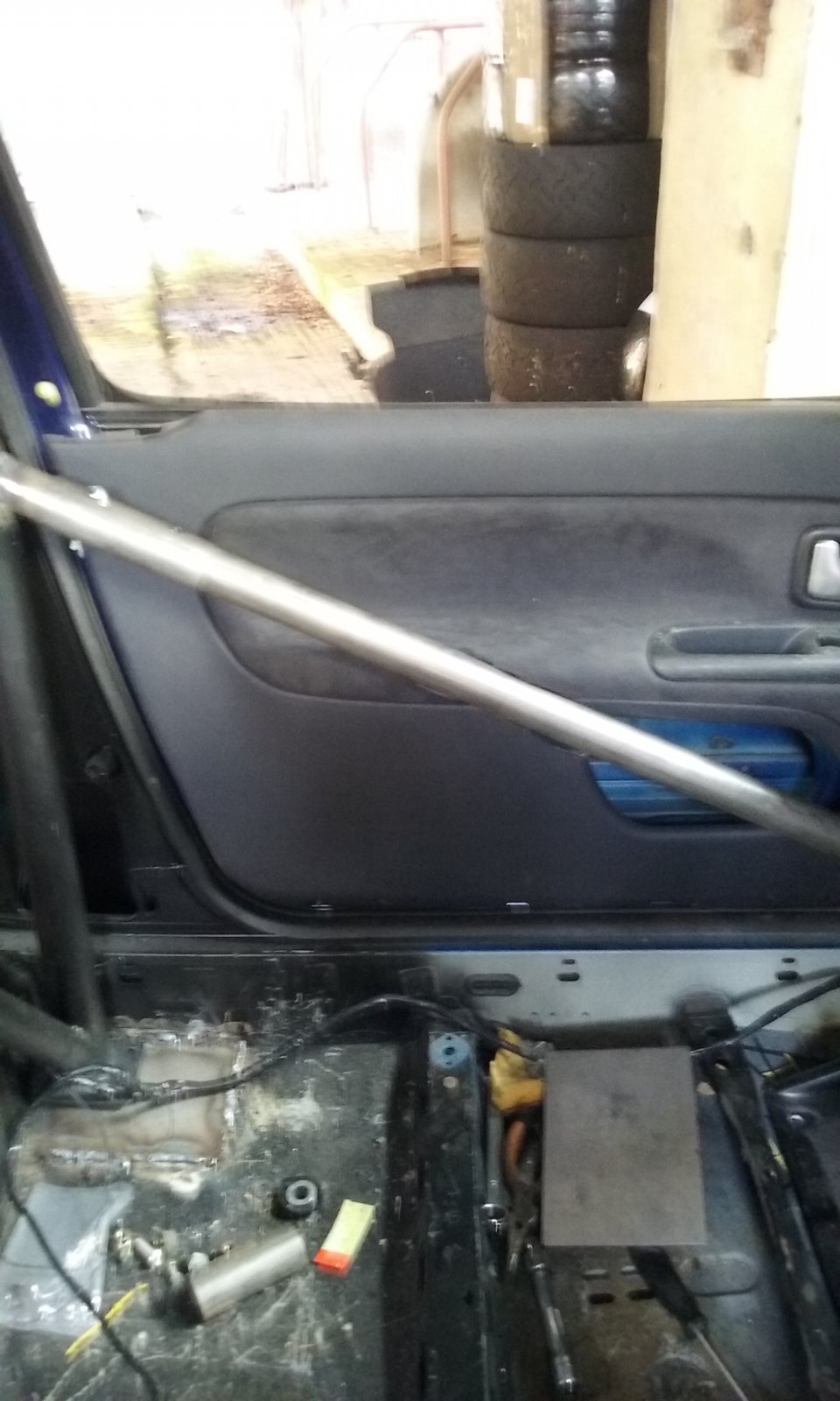

I stripped out everything including the dash and loom and put a bolt in cage, it is impressive none dash dodger and with twin diagonal. I changed the exhaust to a Janspeed system, suspension to Spax with European tarmac spec springs, polycarbon windows with sliders, new disks and Mintex 1155 pads and all the usual safety items needed. It took me months and having written it I wonder how it took so long but there are only so many hours in a Saturday afternoon. Anyway she looked good on her 16” rims and after I set the ride heights, front toe out (10 mins) and camber (1.5-neg) she was ready. I took her up the road and she seemed good.

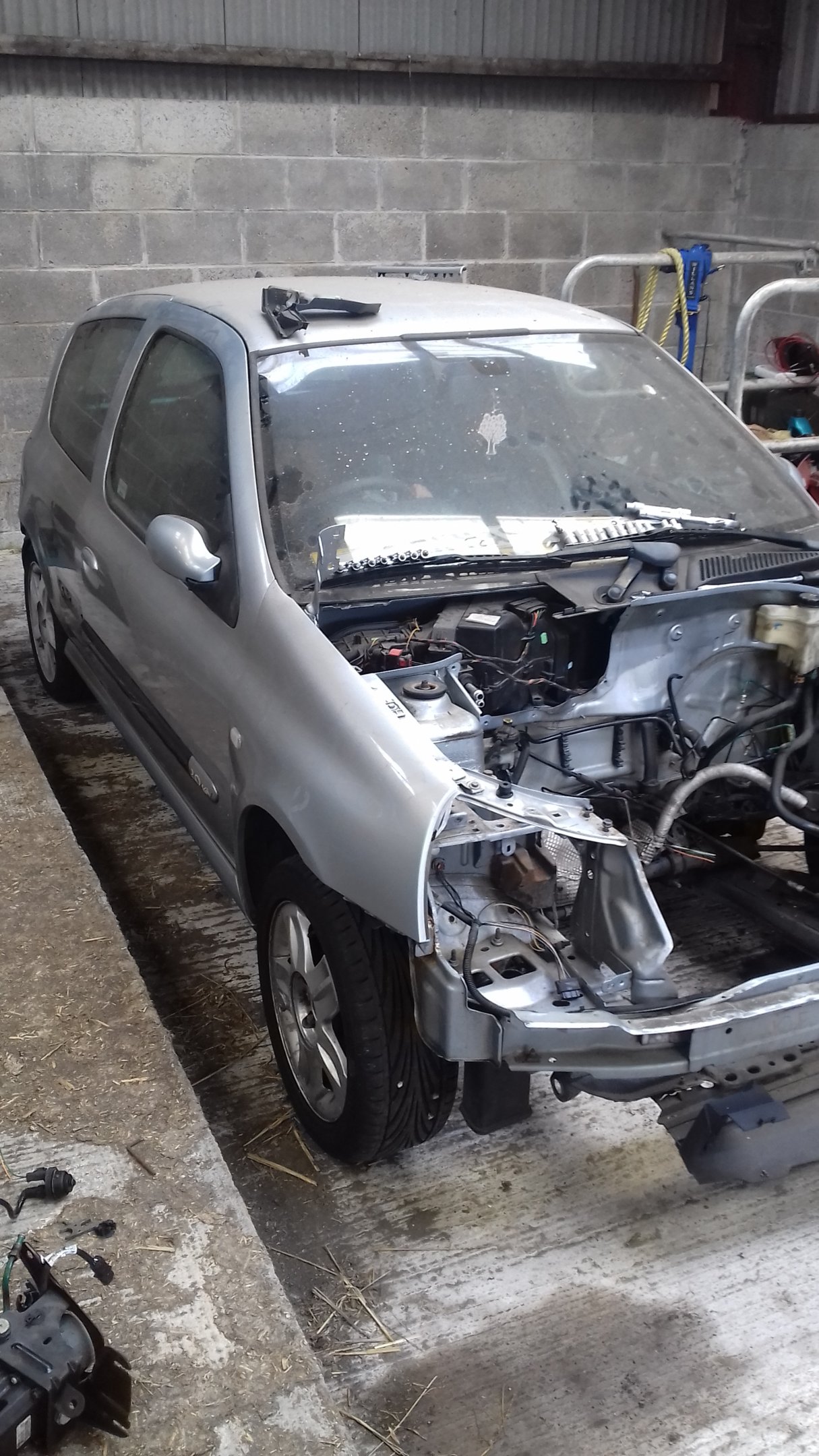

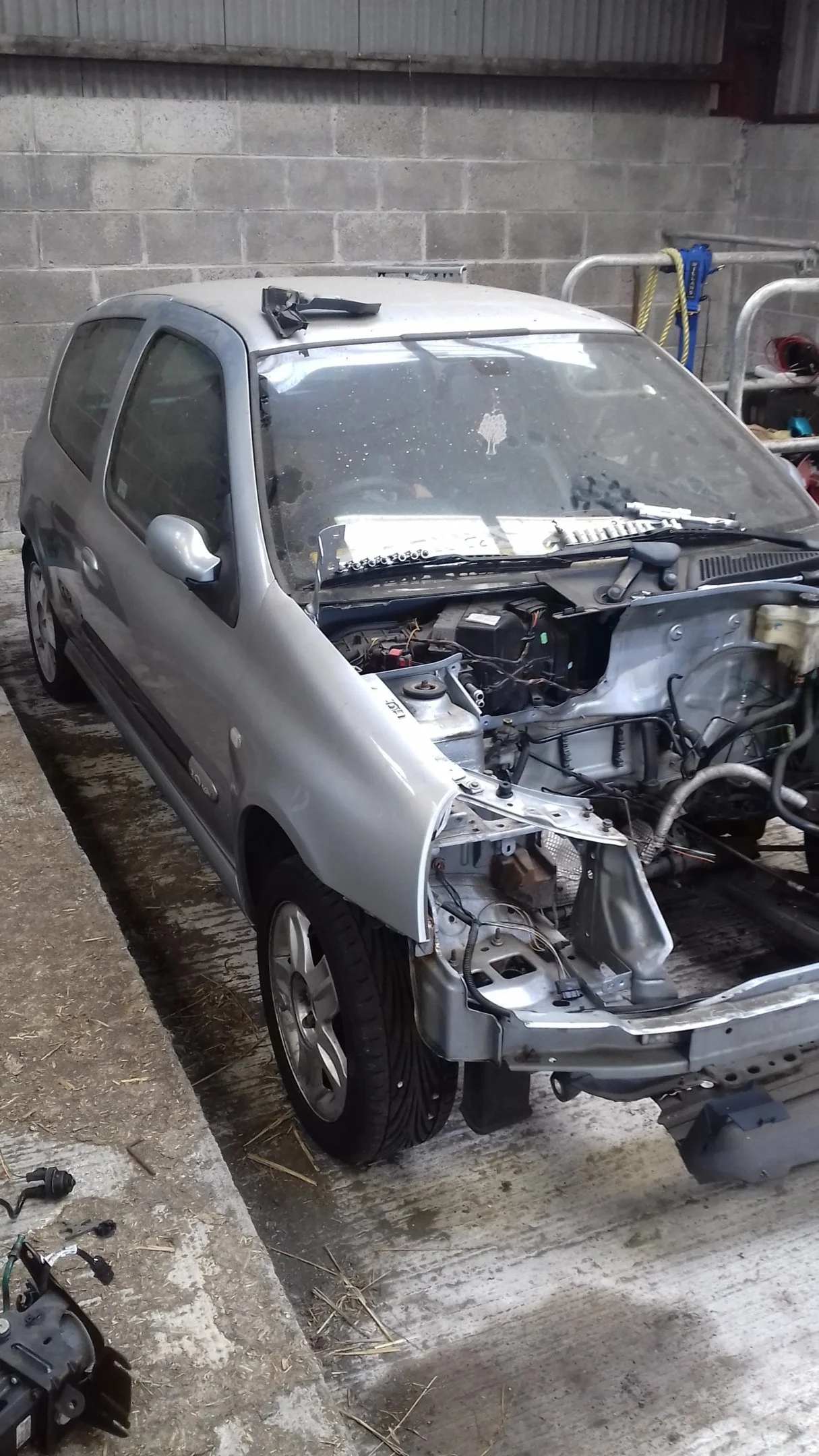

The re-shell has started. I am going to build a single venue car this time. Everything will be aimed at going quick around old airfields and chicane riddled racing circuits. All the old bits are ready to fit into the new Shell I just need to strip it and sort out the rear beam mounts.
