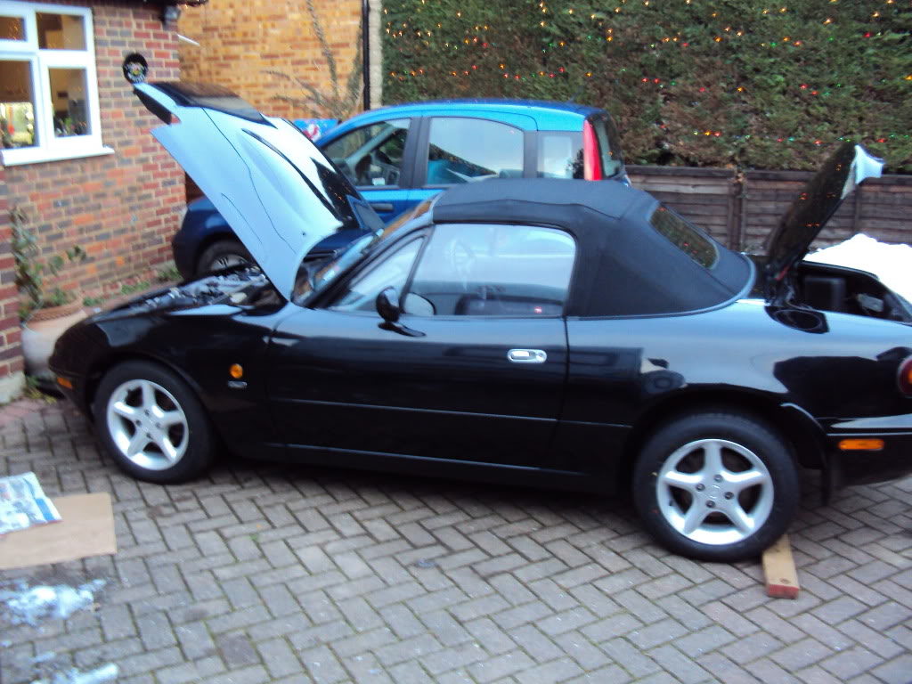

Managed to split the front lights to detango them and fit some LED side lights.

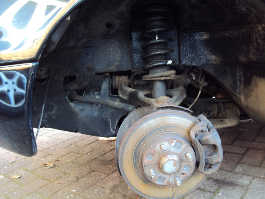

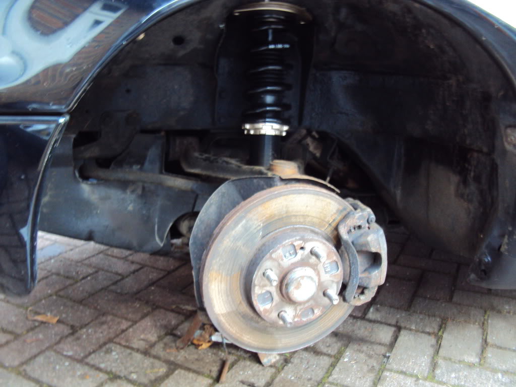

Well the snow had cleared from the ground and had nothing else to do this afternoon. Managed to fit the front coilovers. Didnt really have time to adjust the height but you can kind of see there is some initial drop. I'll be fitting the rears tomorrow and hopefully picking the wheels up this week. Did manage to spot that is has some goodridge braided hoses which was a bonus.

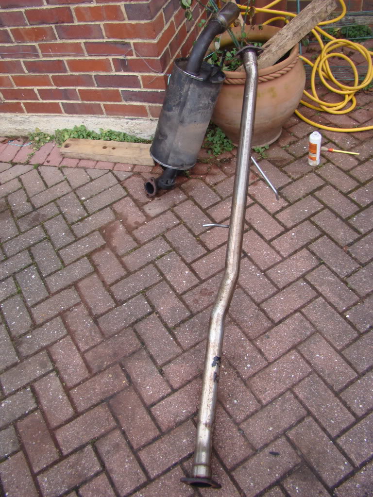

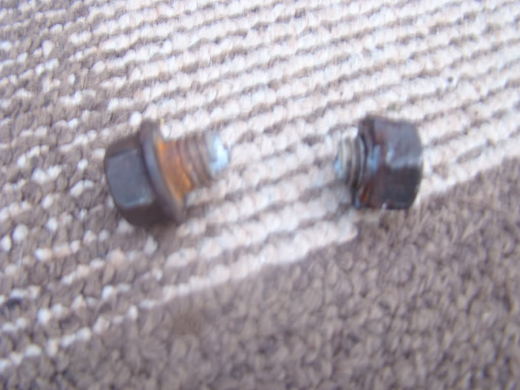

was a nightmare getting the stock exhaust off, resulting in this
although i can just a stick a new bolt through.

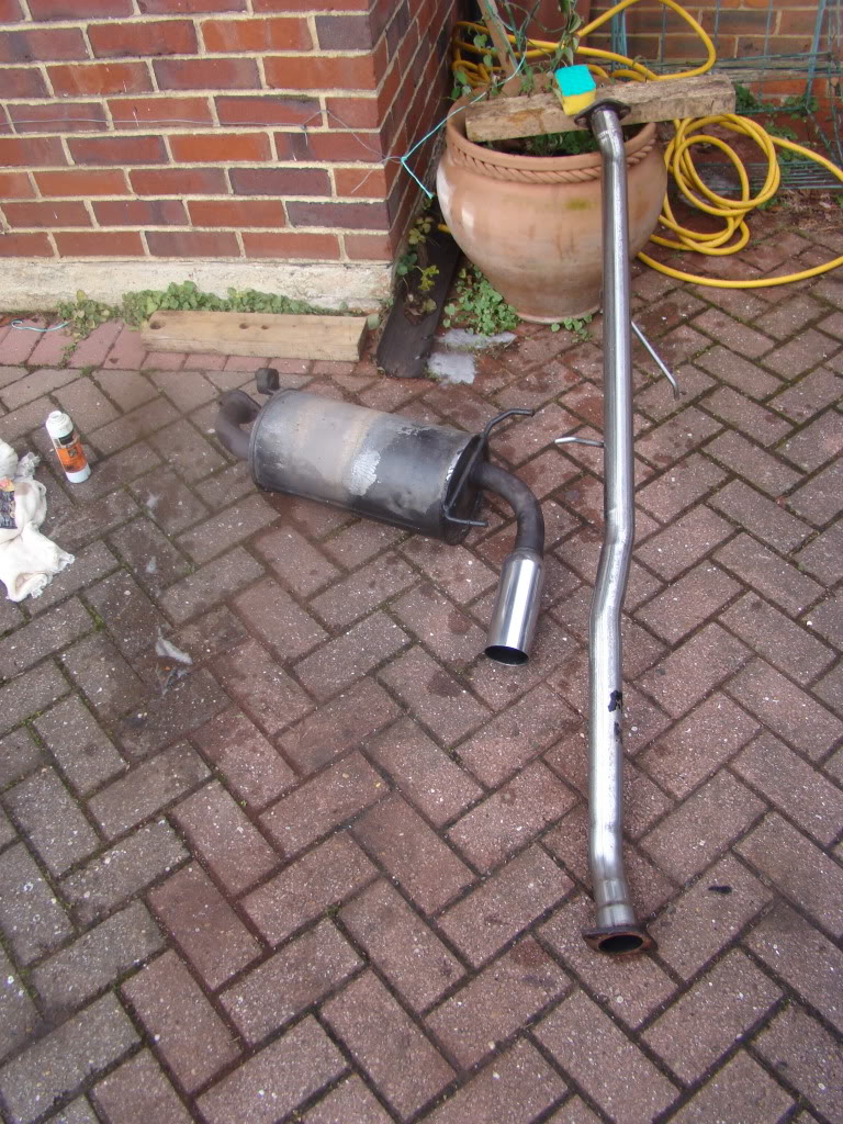

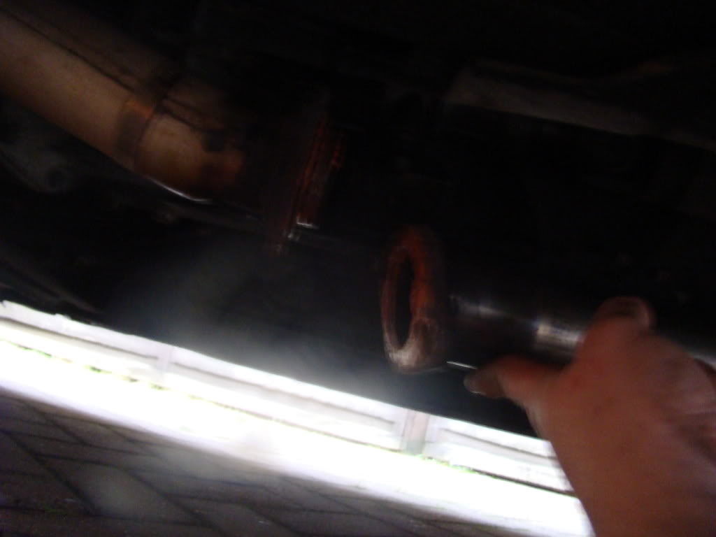

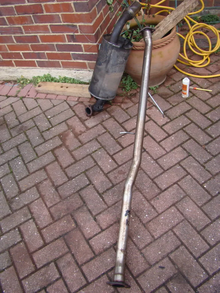

Biggest problem is this!
i knew the cat sizes were different but looks like the down pipe must be shorter too, or im doing something wrong!
Yeah i understand that, but as this is from the headers to the back box i assumed this wouldn't create a problem. I thought the header lengths would be the same.

Can you not just fit a bit of flexi pipe or take it to an exhaust place and lop the lug off the end and have a section welded in?
I'm sure all cat back exhausts are the same length.
The 1.8 cats are longer and the manifold and down pipe are shorter
Vice versa for the 1.6.
1996/97 have the long cat and manifold.
I could be talking out of my arse though!
yeah it does have the longer cat. i assumed the headers would be the same length but clearly not
Well all the cat back exhausts for the early MK1's seem to be the same length on mx5parts.co.uk. So the manifold must be shorter!
I know its Manifold back, but it looks like its from a 1.6.
With you having a 97 1.8 you're going to have a right job finding something to fit.
I'd get a custom straight through centre section made to mate up to a back box of your choice.

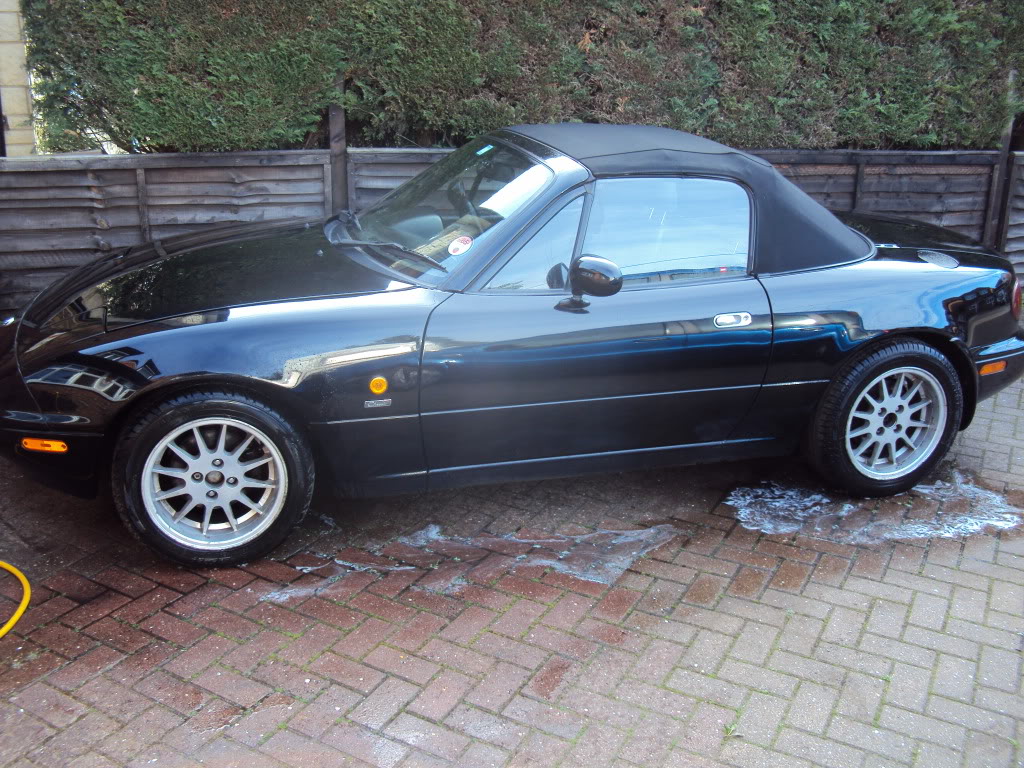

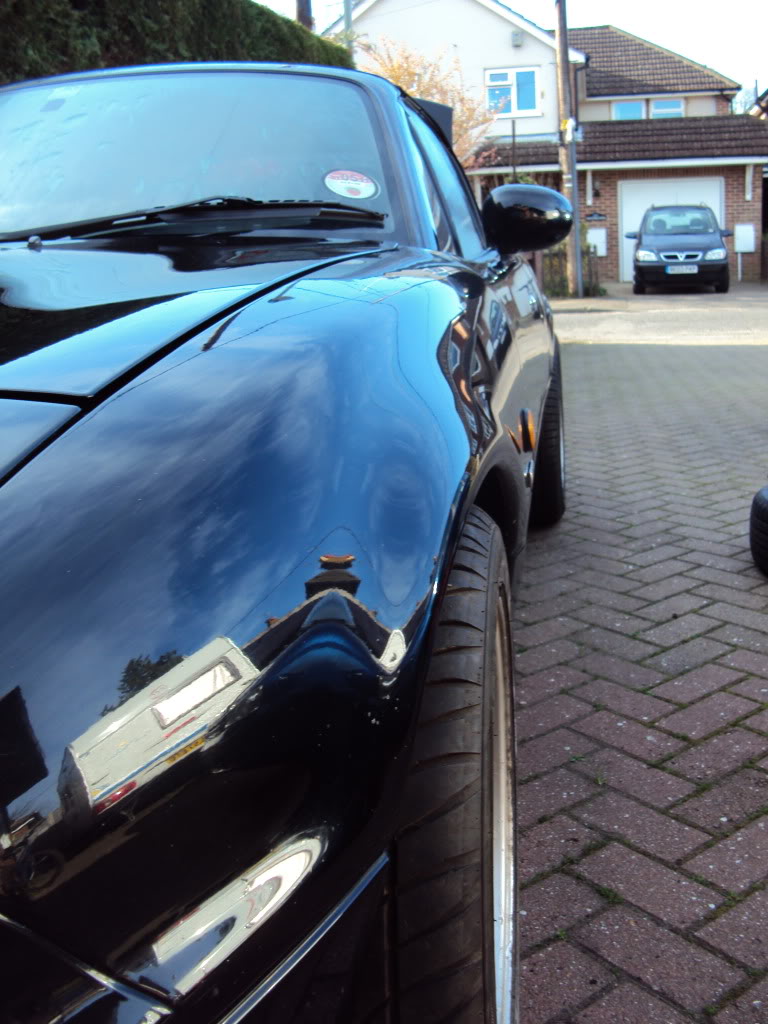

So i have managed to pick up some wheels..finally. Slow progress as i had to fork out insurance/mot for the buell.
Also got in on the group buy for an uprated supercharger coupler and some fresh oil to give it a service.
So have 15x7's with a healthy offset of 13

Need to have a play around with the coilovers etc and they also need spraying.
any ideas of colours?
I saw those on wheel whores! Nice and cheep, apparently have no brand. Will look good with some stance... y0.
