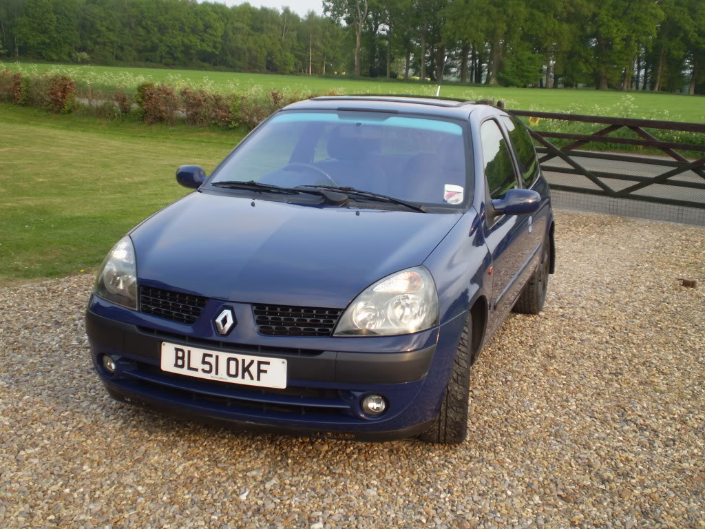

Right here goes...

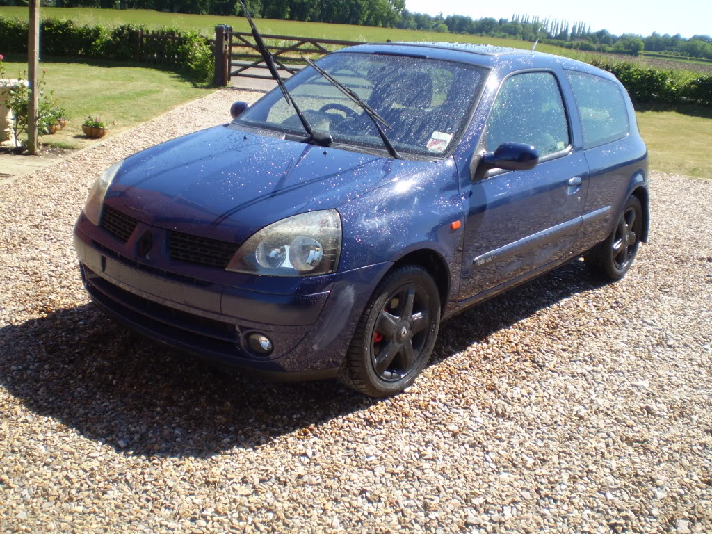

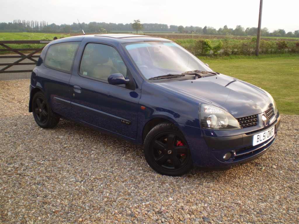

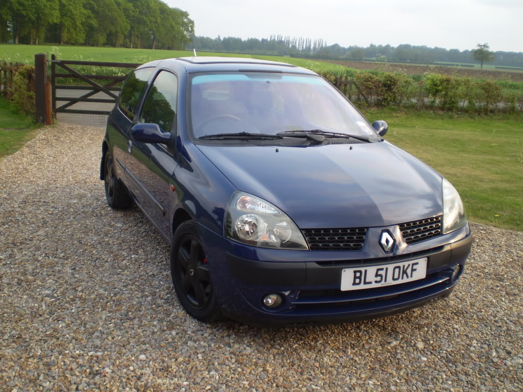

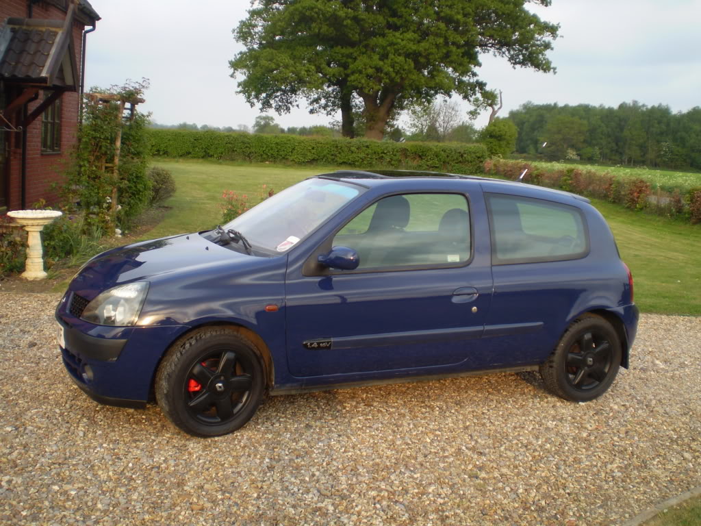

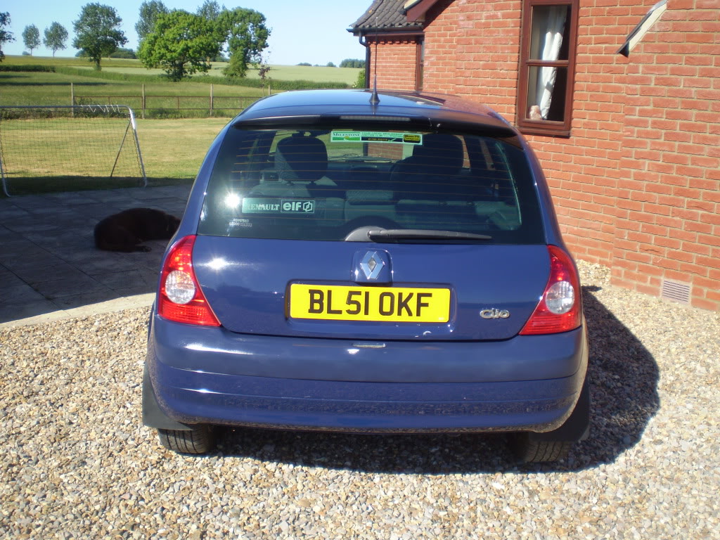

In February, i bought myself a Renault Clio 1.4 Dynamique 16v+ for £800 at the auction
It was completely bog standard but was in very good nic, few scratches here and there but nothing to worry about.
Mechanically, it's not perfect, i've fitted new ignition coils, spark plugs and a new rear passenger side shock. Still a few things needed to be done, the engine judders on tick-over which could be the cambelt timing out by a notch (new cambelt fitted 2000 miles ago, so could be the case) It also struggles to start when the engine is warm, again any suggestions?
So onto the modifying, i'm still in 6th form, so my funds are limited so i haven't done anything too major yet, but i think it looks decent.
What i've done so far:

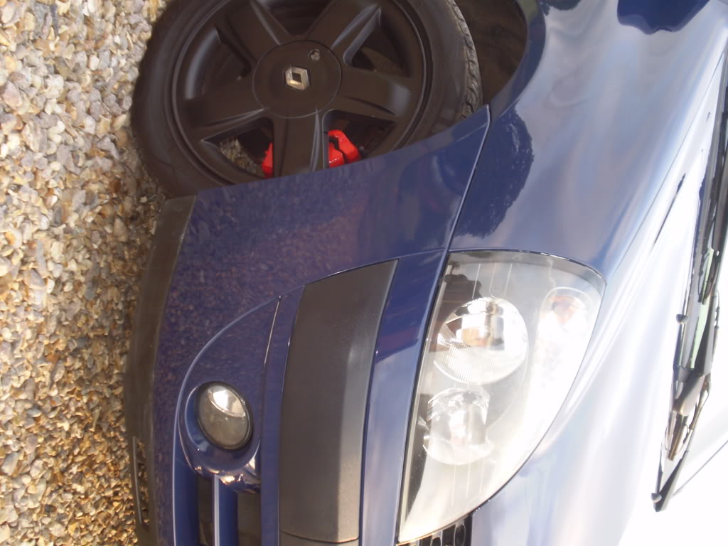

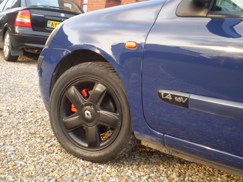

Sprayed my dynamique alloys matte black
Painted alloys bright red
Blue fade in sun strip
started colour coding
Mud Flaps (rear)

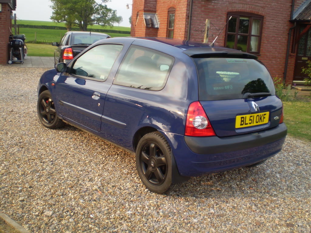

Is it possible to fit a new bigger exhaust without taking a hole out of the rear bumper, i wouldn't mind doing this but when it comes to selling it a large pipe may decrease the value, as might a hole in the rear bumper

I like that minus some minor little bits. As for exhaust id go for a stealth if it was me.
As for lowering that would depend on what springs you buy eibach sportlines are meant to improve handling but still keep the ride comfy.
Id get rid of the strip across the window, aerial and mud flaps but it's your car so do what you think looks good. Id also get some silvervision indicators and clear side repeaters and flat blade wipers.
Like i said only minor little bits.
  Astra GSI, 172, Golf
looks nice and tidy, nott keen on the r mudgaurds tbh... but other than that its bang on. i would have a cack at colour coding the spoiler to would look alot better.. then a few of your mods listed would fionish it of nicely

Lower it, lose the flaps, and clear side repeaters or smoked and leave it at that.

Looks tidy, I got the same model and lowered it on k tec -35mm springs and it looks ok not to low that its not practical but low enough and the ride isnt to hard it is comfy, and got a k tec stealth exhaust that you dont see from the back so no cutting needed. I had the same problem with mine not starting when its hot and it was the tdc censor, a comon problem on thease, renault will charge around £60 for this but gsf do one for £20, hope this helps you

Looks decent enough, the sunstrip looks abit odd though as its light blue, mudflaps dont look too bad and they might actually serve you a purpose seeing as you live in the countryside if your roads are as bad as mine with farmers leaving trails of s**t everywhere when they go from field to field.
Id colour code it first, clear side repeaters, new aerial, lower slightly then work on the ICE :)

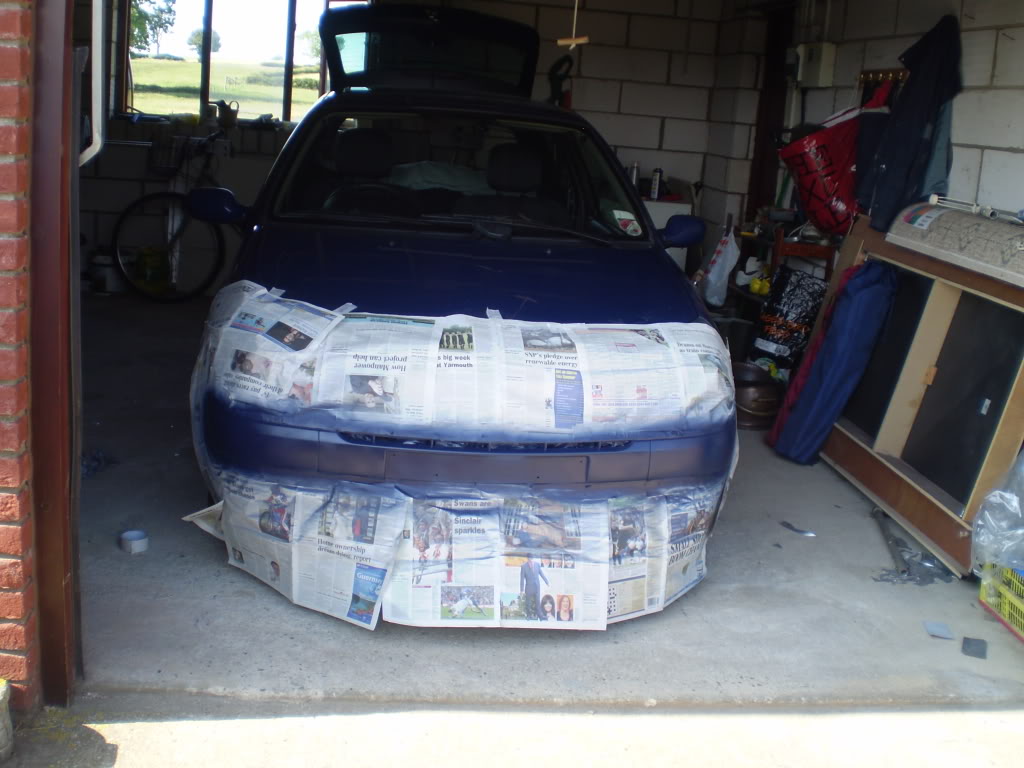

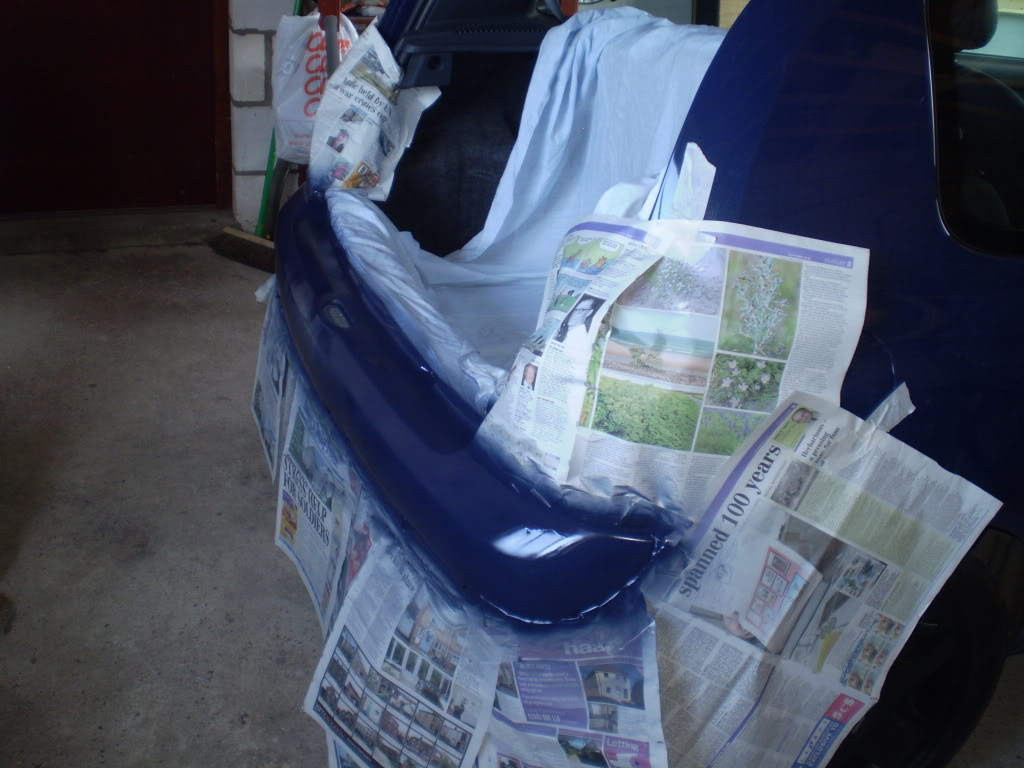

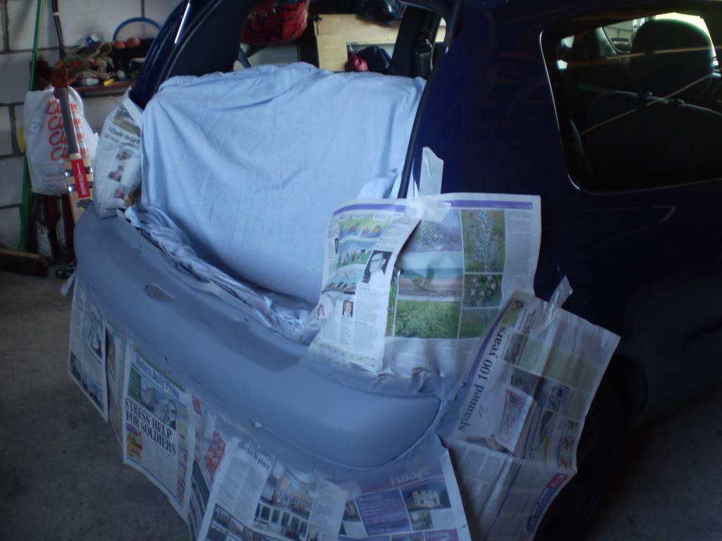

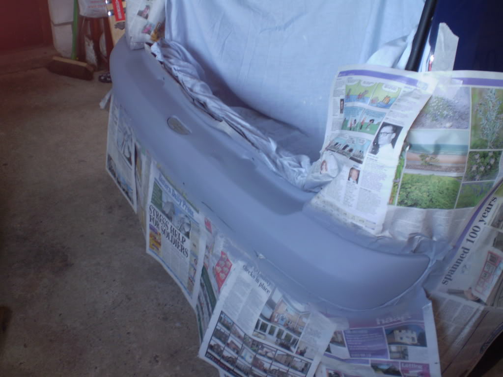

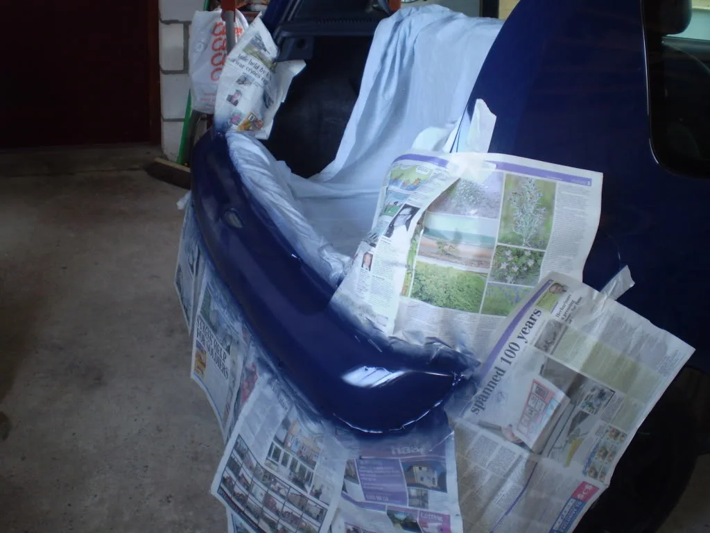

First of all, apologies for the lack of updrates...largely due to a lack of time and funds due to bloody A Level exams.

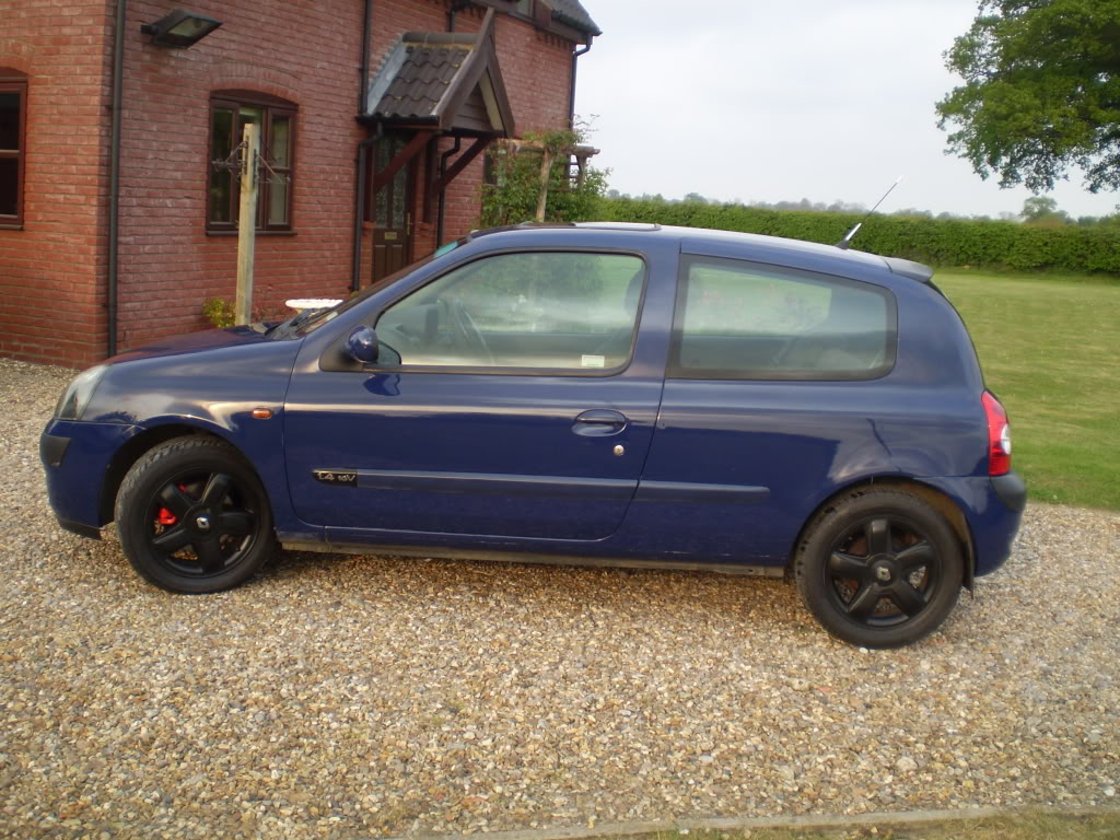

But, i'm back...and with a sizely change. I've finally finished colour coding my front and rear bumpers, and i reckon they look pretty good.
In terms of short term objectives, i will be blackening my badges, spraying the interior dash strips, and new front lights. Long term objectives are lovering which is a MUST.
Here are some pictures of the process. If anyone wants a guide i am happy to write one on this thread.

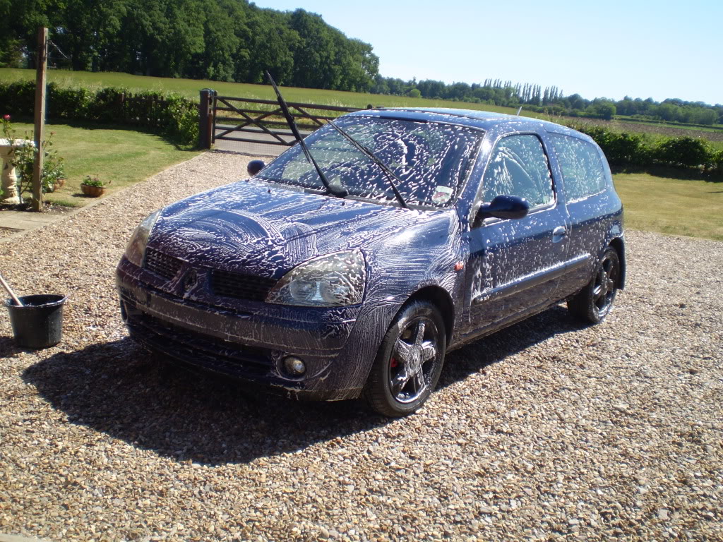

Then it was time for a clean to remove all the dirt from the tape, dust, and some patches of overspray.
Thats it so far, hopefully another update will follow shortly after i've done a few more bits and bobs

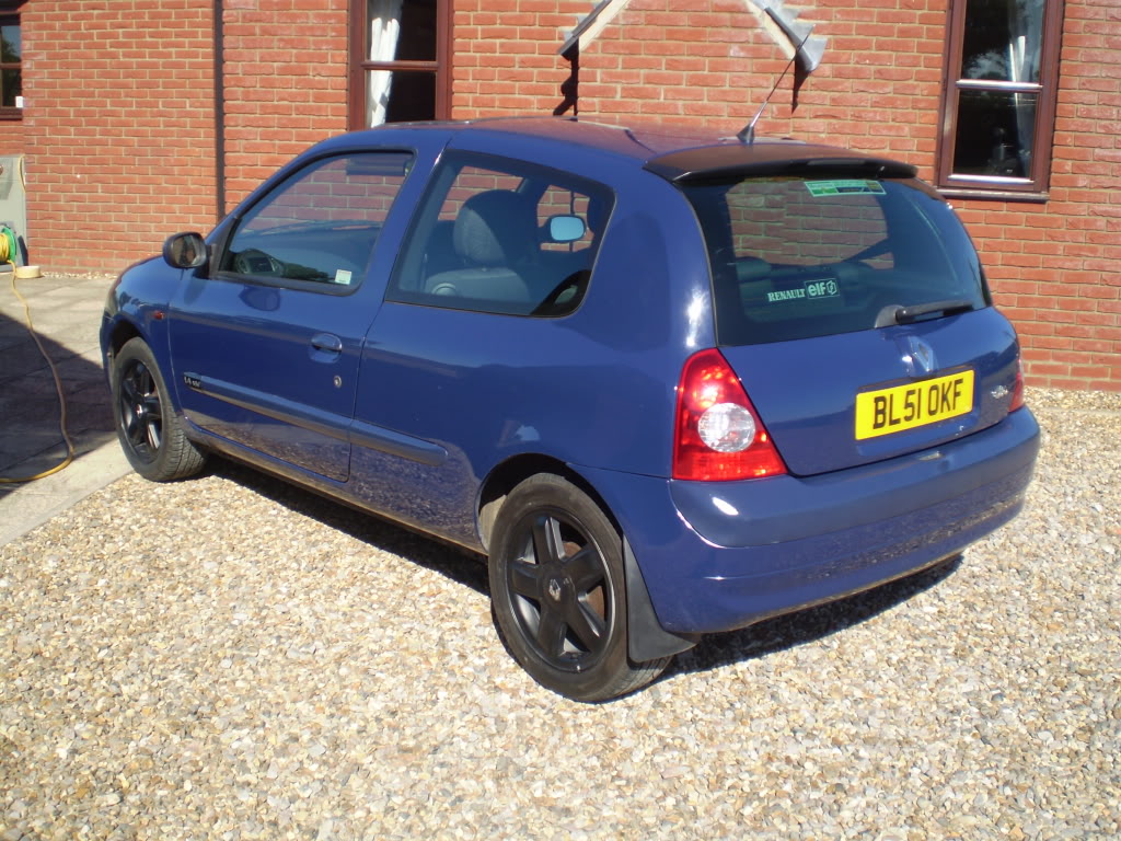

I done that with the door strips but i couldn't find a way to remove the front or rear bumper strip, so i just decided to save myself time and hassle, but i' am very pleased with how they've come out
  Renault Clio 1.4
Yeh i've binned the sun strip...and yes i sanded them down before the whole process and after priming them. Obviously they won't have the same texture being painted on plastic rather than metal
  Renault Clio 1.4
I'm personally really chuffed with how they look...i do agree though that the spoiler looks a bit rank, i was debating carbon wrapping it but i'm not sure if that would make it look chavvy?
  MK3 GTI golf 16v
colour code it else it will look naff tbh. howcome the paint came out slightly off ? looks alright though

What did you use to clean the car? I can see some sort of stick in the black bucket...

In reply to woody, i went to the East Anglian motor auction in Wymondham, and yeh my uncle came with me who's a car dealer and a bit of an expert. Matt-Yes it's a car washing brush with a half snapped handle. And J45- i'm definately considering clear side repeaters, i can see where you're coming from with the amber ones. Your megane splitter does look very nice...really finishes your car off mate-looks really good.
