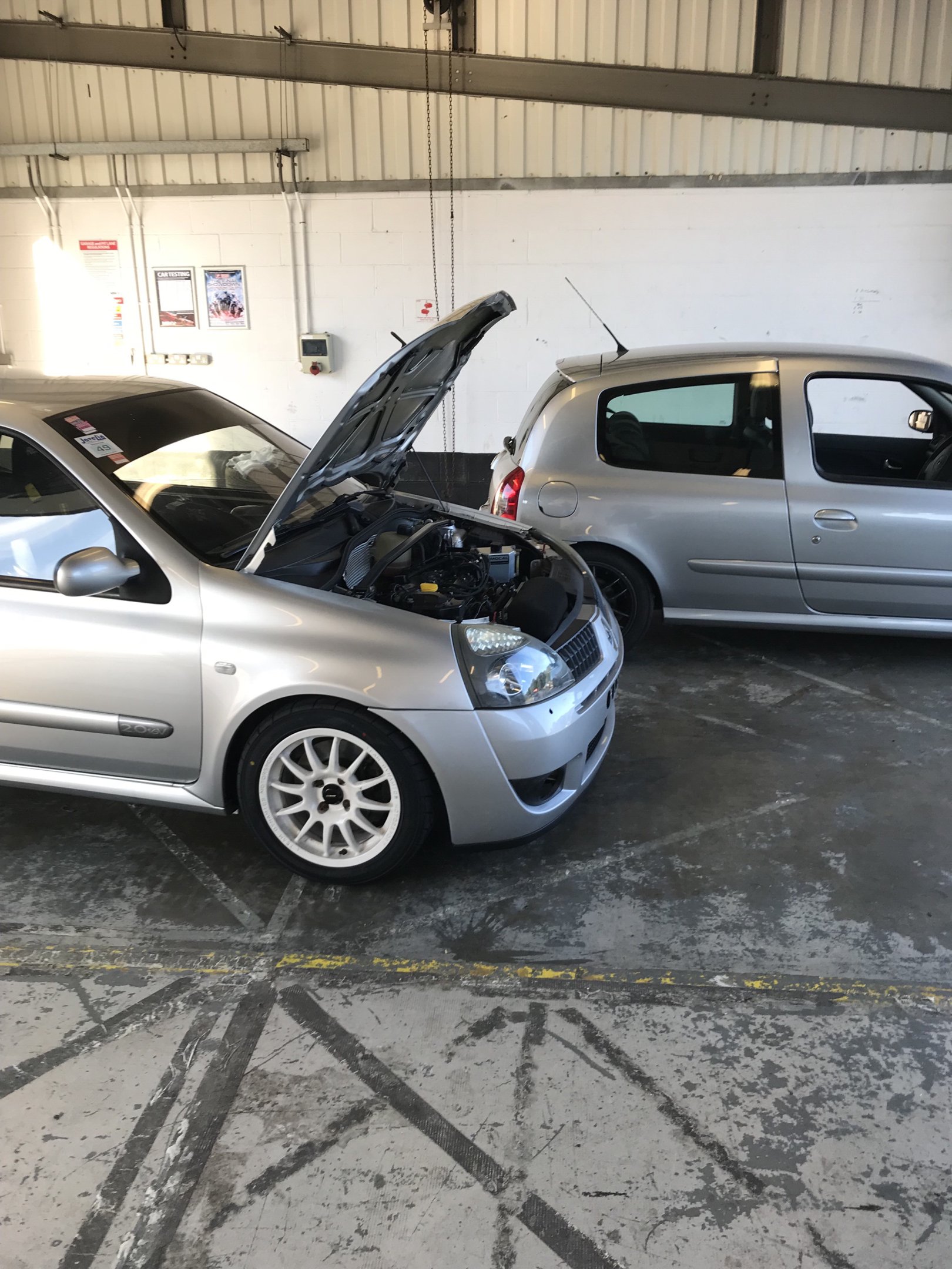

So today it happened, started. breaking AD52BHP and fitting the trick bits to the turbo and the cheaper bits to the Cup
Only got the rear done today
Hadn't considered how long it would take as doubling up each job!

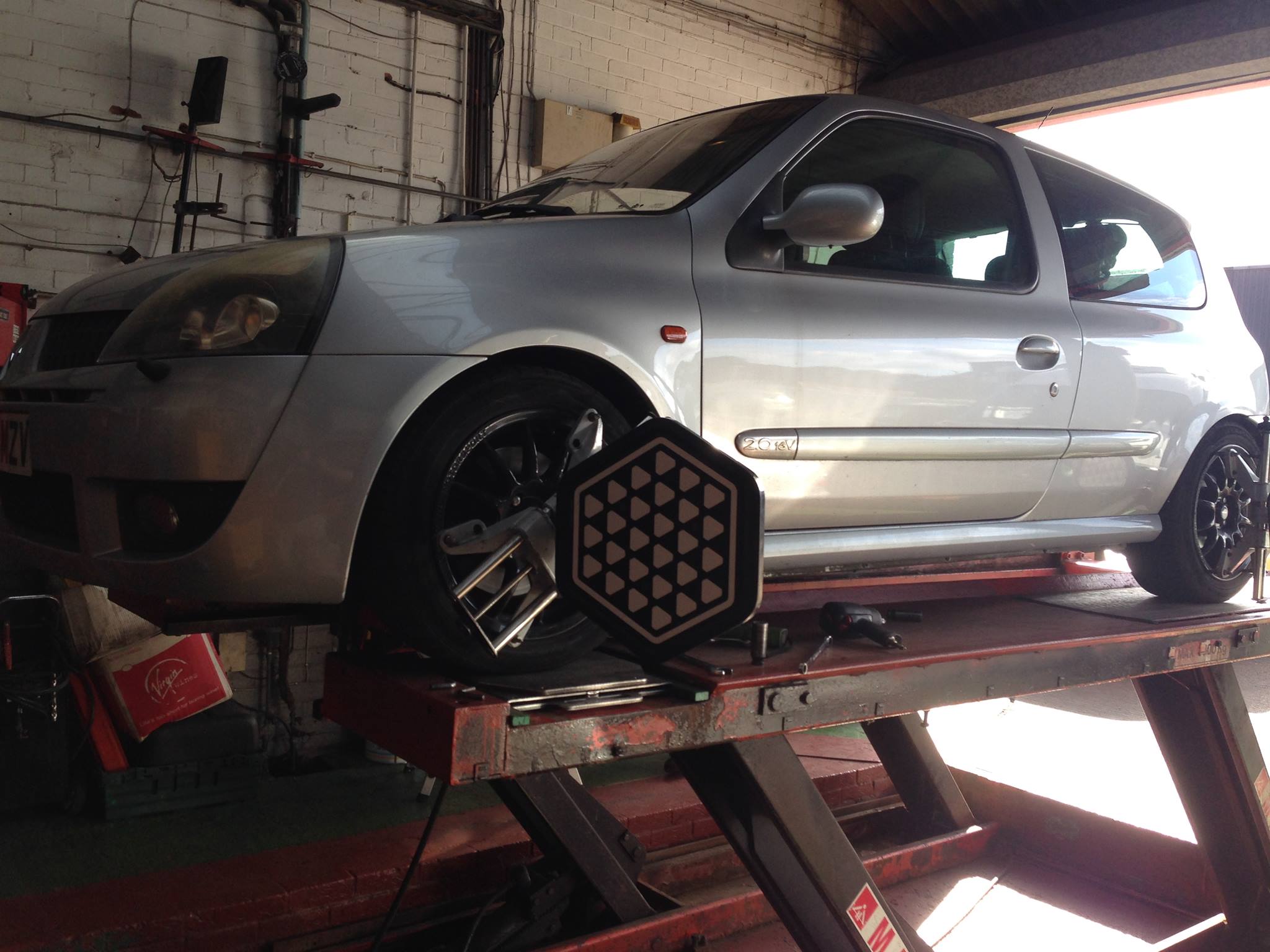

Rare trip out today to finally get the car aligned properly, went for STS in Bedford.
Car goes really well now and is a lot of fun. Hoping to squeeze in a another trip up to Oulton before xmas

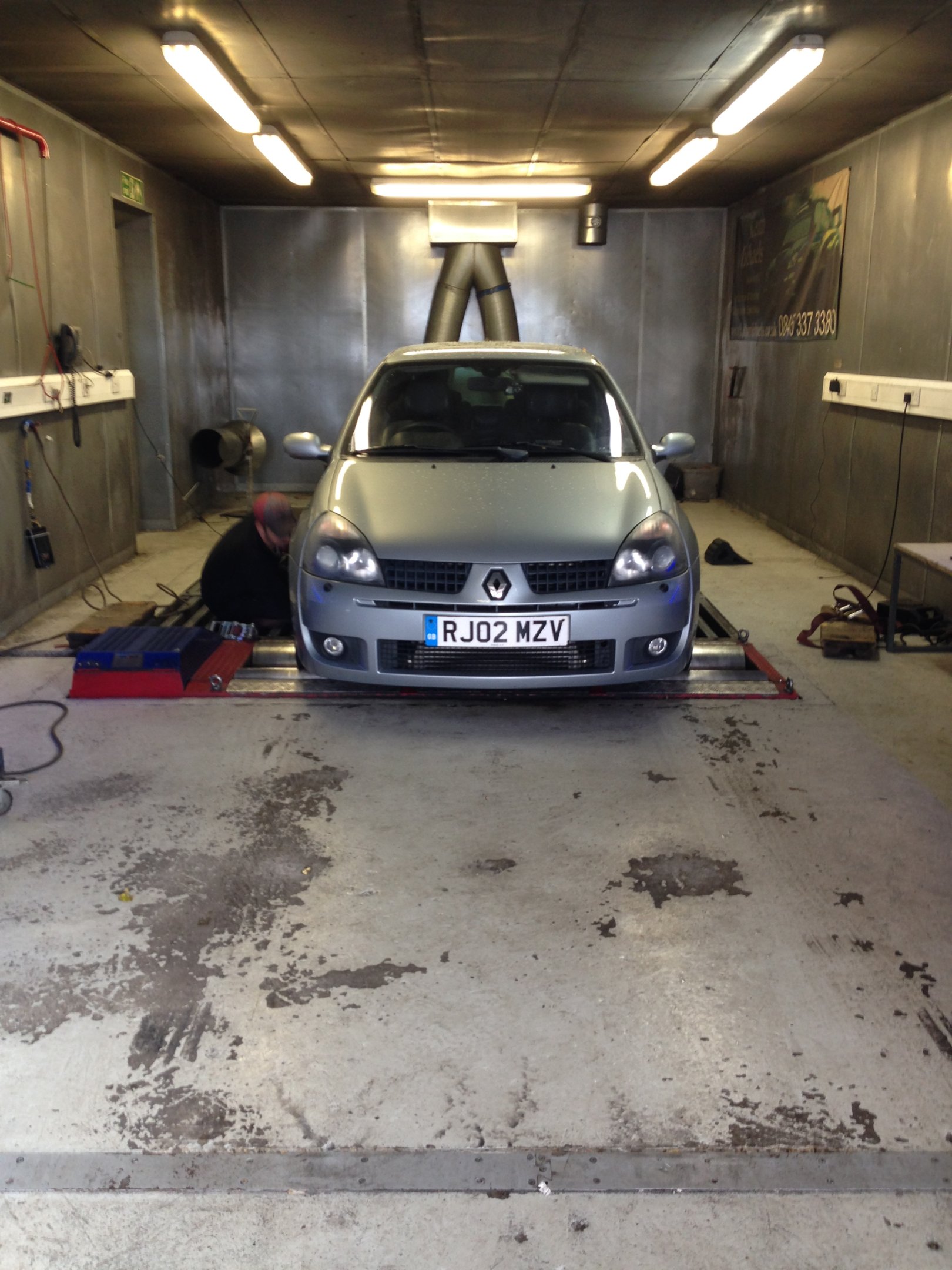

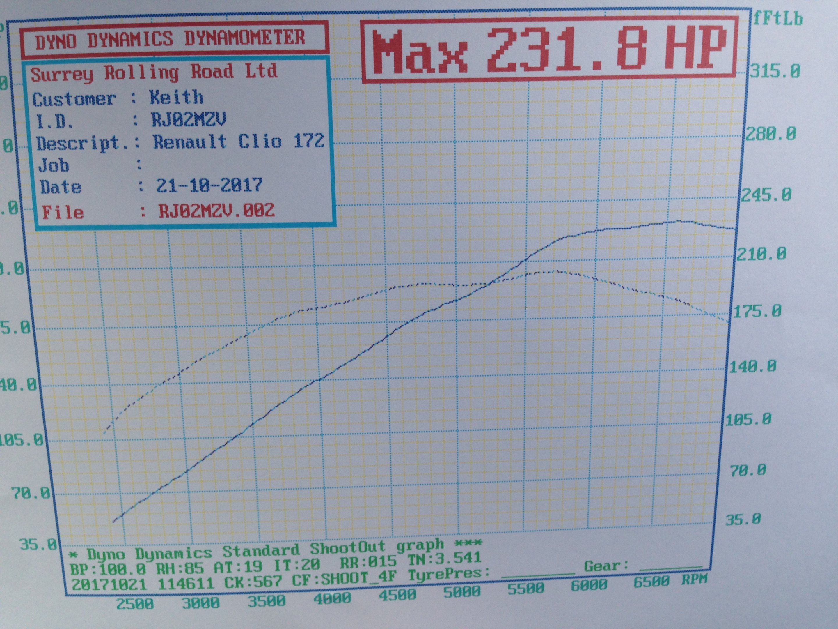

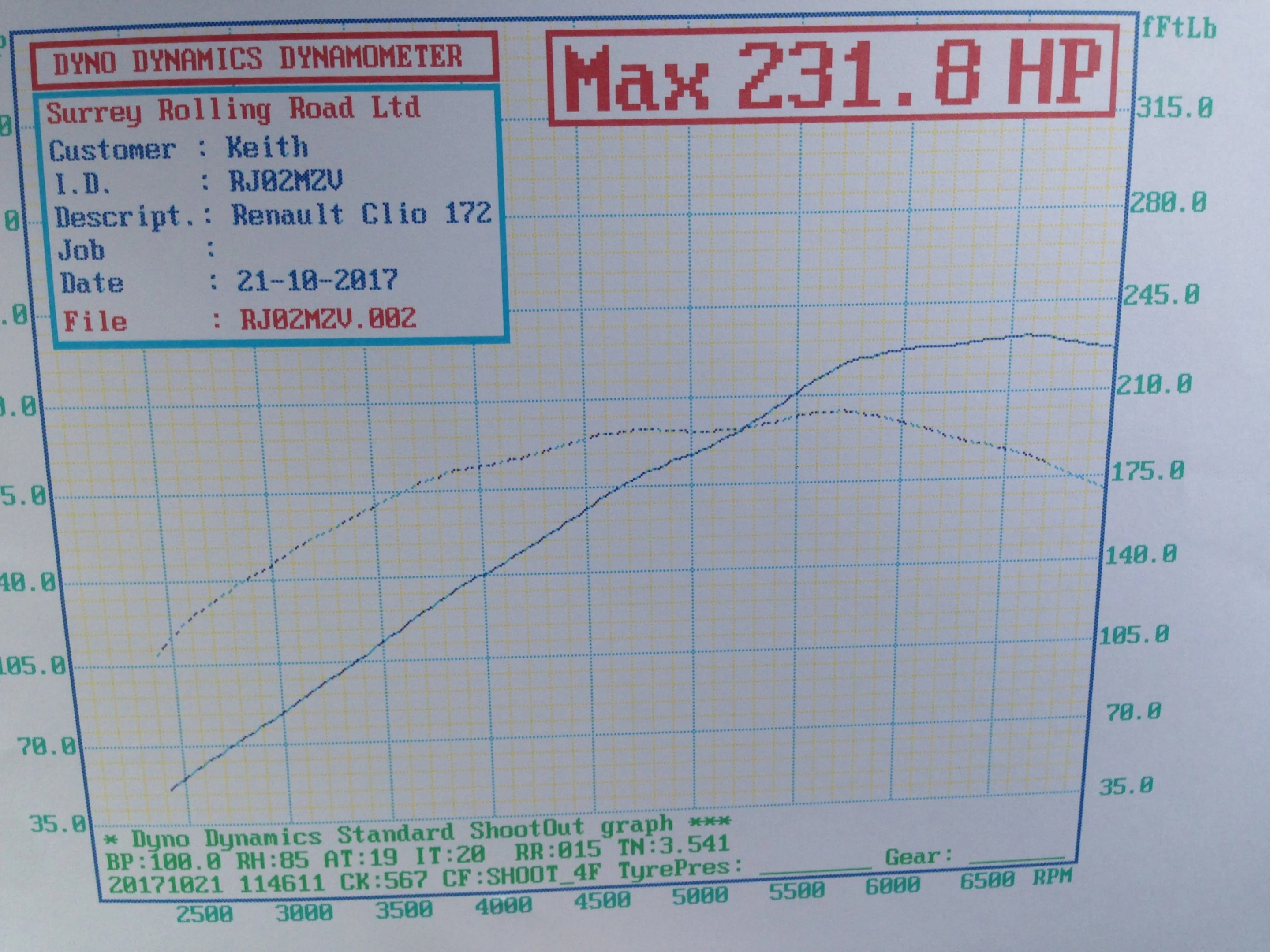

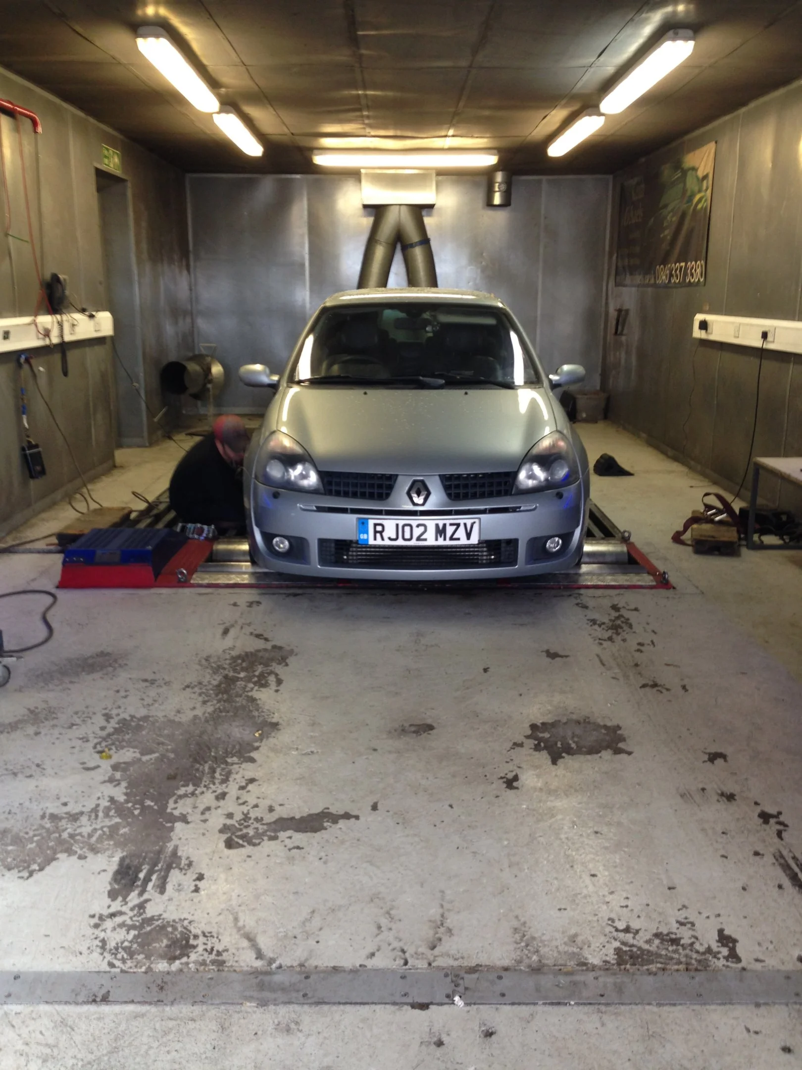

Took a trip over to Surrey Rolling Road for the morning kindly organised by @TimR26
Car ran just under the power it ran when it was mapped at Engine Dynamics so good to see all is still well with the conversion.

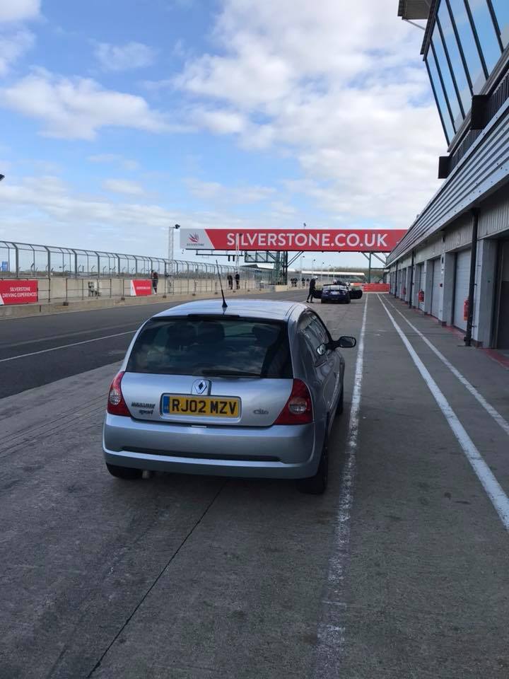

A video of a terribly slow lap at Silverstone, booked late track time and didn't have a chance to swap from road pads & tyres. But lots of turbo noise for your enjoyment.

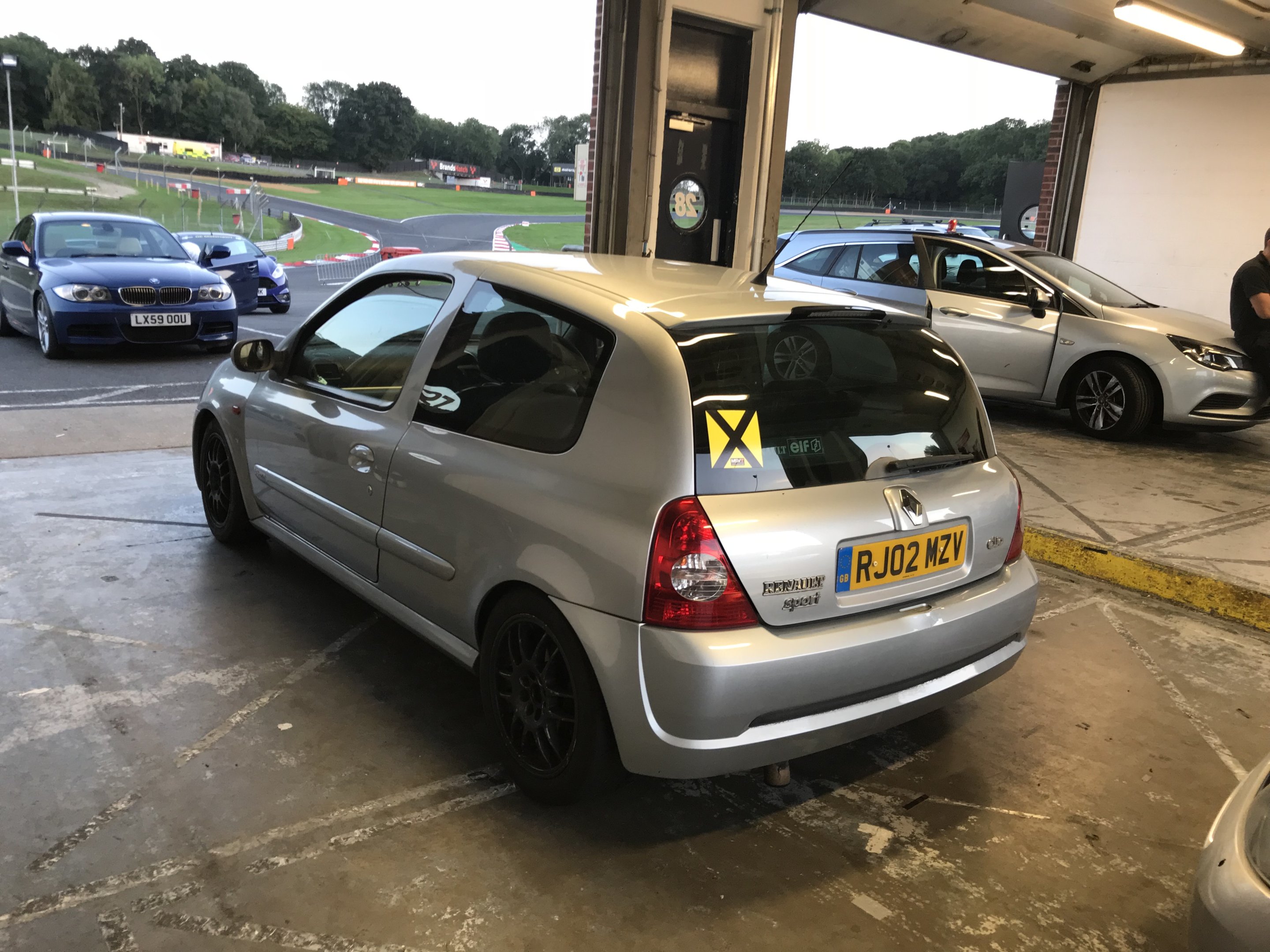

Then @Martin. messaged along the lines of "Still got the turbo? Fancy Brands?" At first it looked fully booked, then at 1.20 on Saturday morning I'm sat in the nursery with our baby and decide to look and there's space.
Martin's epic 182 in the foreground.
The car performance is still way above my talents and whilst it was for sale I got fed up of hearing that people were "looking for a track car" when they posted on Facebook that they were looking to spend £5k on a track car. As it's obviously not a track car as I've not ruined it by ripping out the interior and bolting some cheap harnesses to a random point in the back or fitted a stupid wing on the back.
However, here it is clearly being used as a track car, with the very helpful @GrahamS providing tips

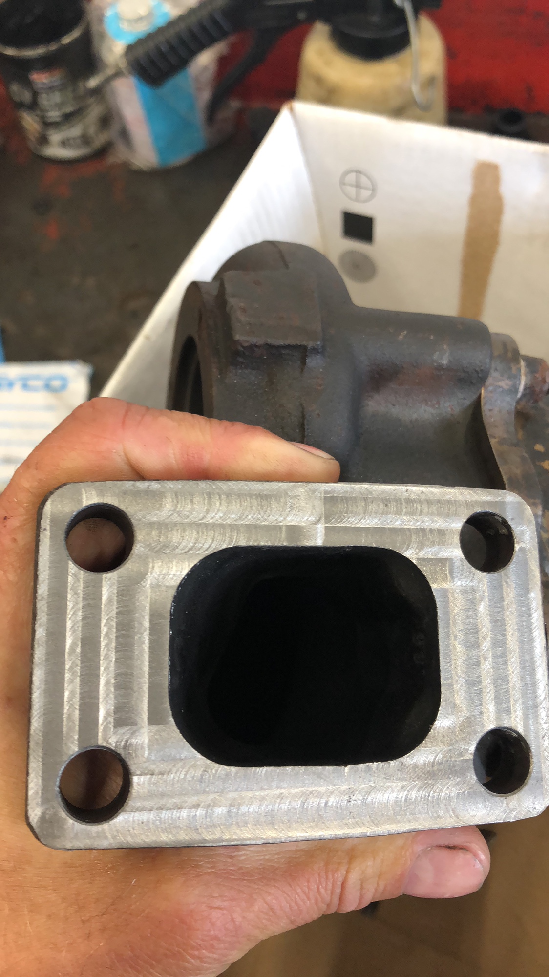

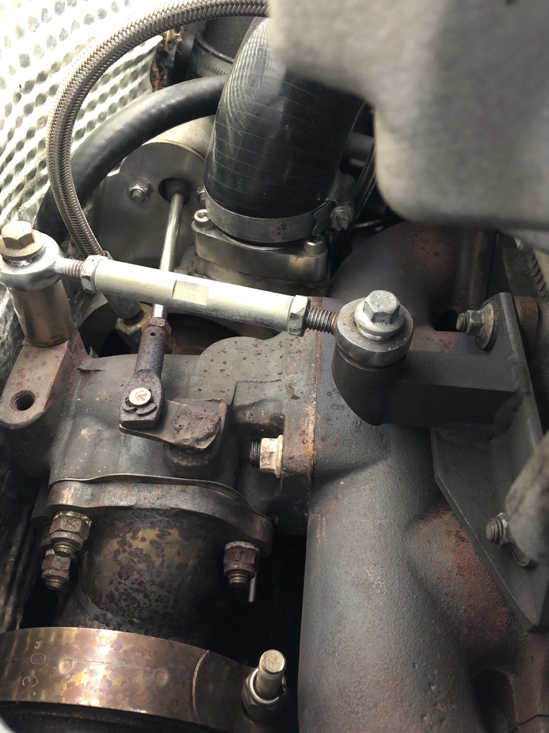

Well, it had to happen. It's finally broken! Could smell exhaust fumes a few weeks ago with the a/c on and after Brands it's developed a huge blow from the manifold to turbo gasket. A nasty job and one I'm going to leave to Alex White, sadly he's booked up until May. So it will be off the road a few weeks.
@incy-spider in that it should be the opposite way?
Yeah! That’s what I mean [emoji23][emoji23]

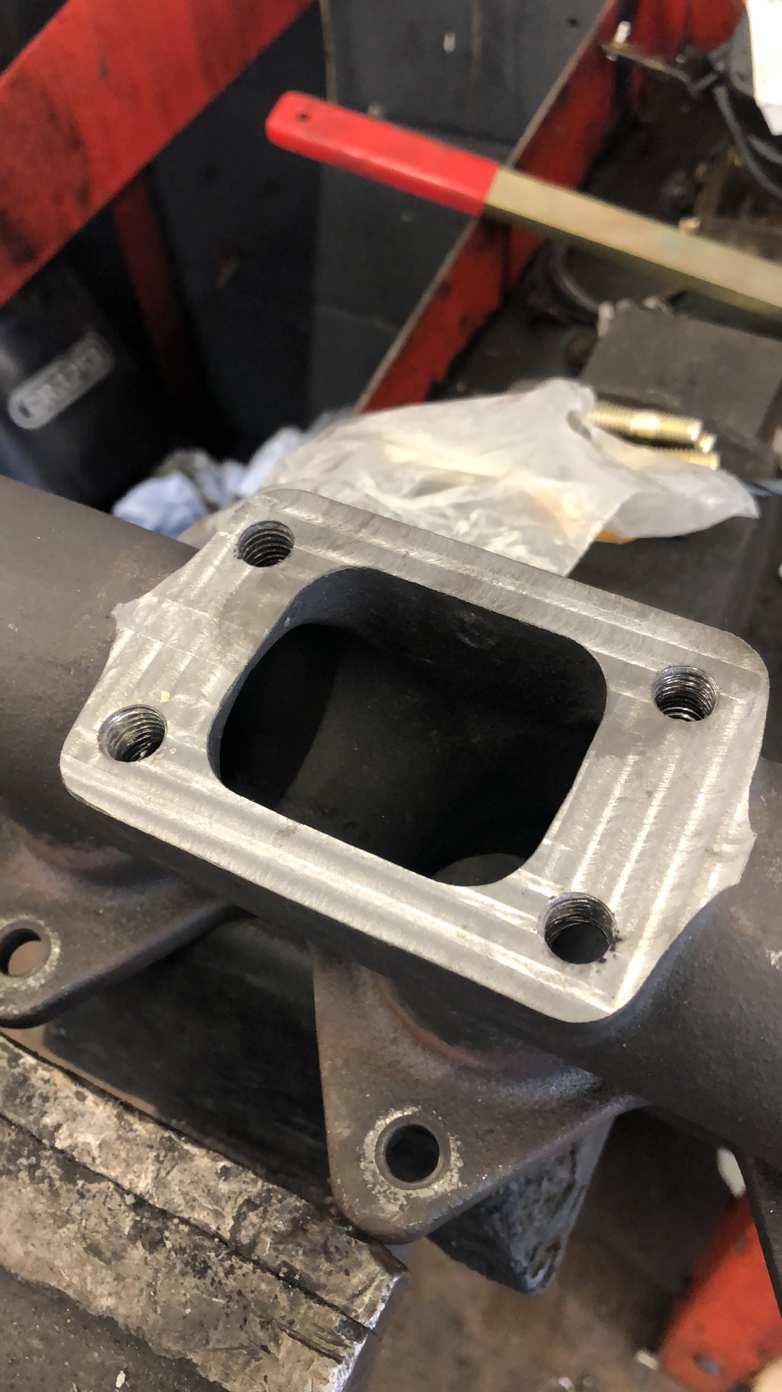

Lovely job, get the manifold and turbo surfaces machined flat if you can and dump the gasket...

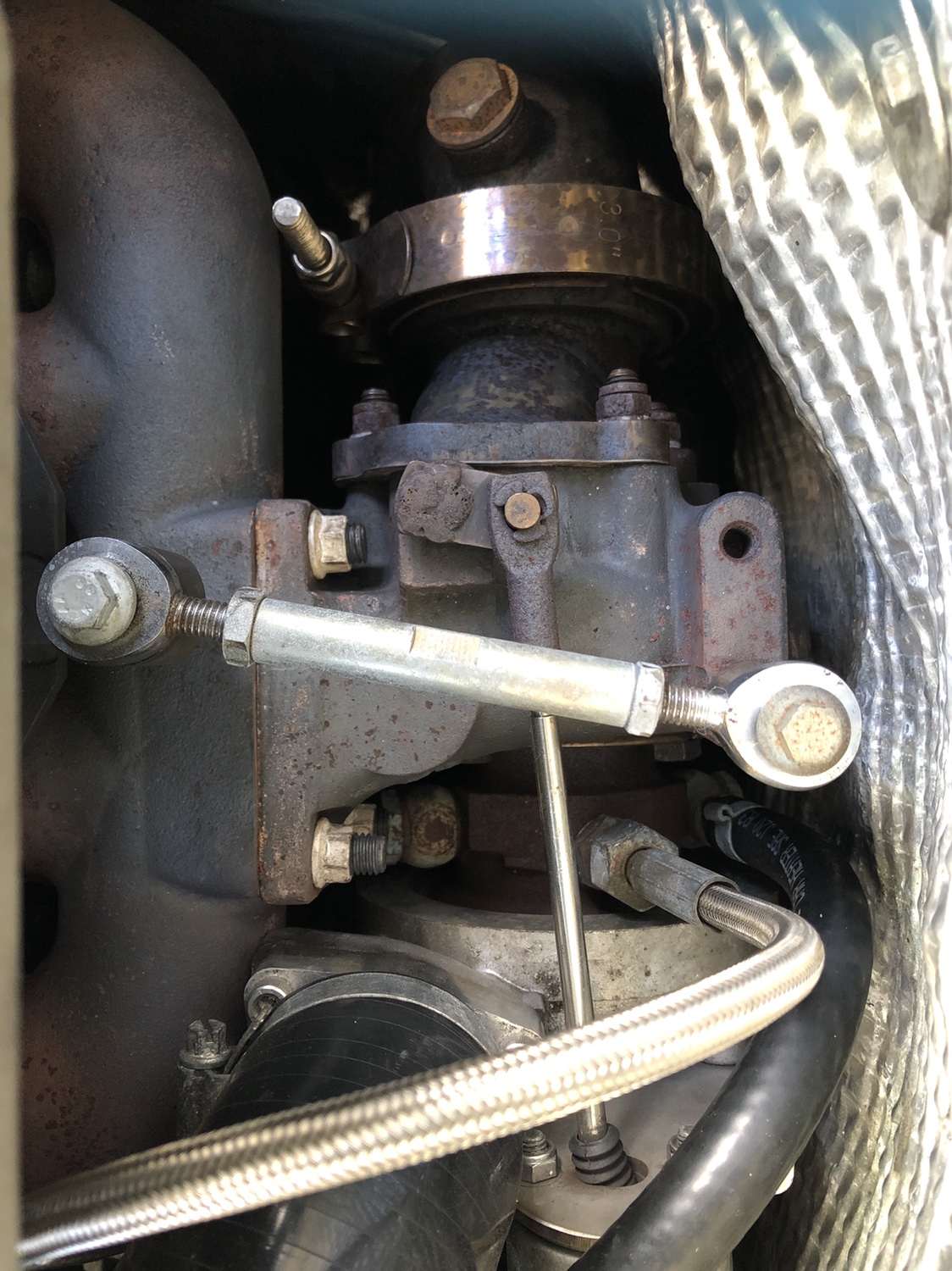

I’ve also made a turbo damper from the manifold mounts to the head to the top of the turbo, can send you pics of it tomorrow if interested.. it’s worked so far on mine, not come loose again and it’s done spa and Nür.
I’m a little sad, this was the only one I knew of that hadn’t had problems.
Not really a deal breaker is it?
This is the only issue I’ve had with mine in the past also, not the best design having a heavy lump of cast iron hanging off of 4 bolts that are subjected to stupid heat and engine vibrations while having an exhaust system hanging off of that![emoji23]
Hence my need to make a brace/damper which so far has proved very good!
Lovely job, get the manifold and turbo surfaces machined flat if you can and dump the gasket...View attachment 1408804View attachment 1408805
Here you go mate, ‘k nuts’ are very good too by the way.
