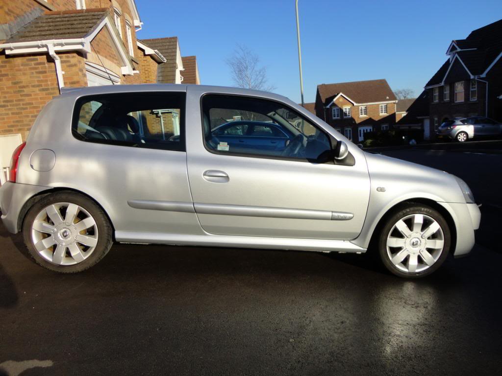

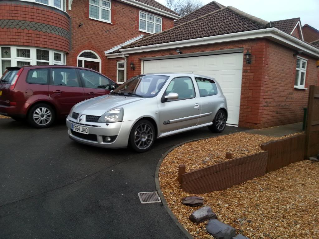

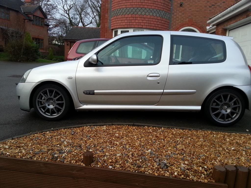

My 182. It's the little things that count.
So I thought it was time I put my lovely little Clio on here.
This might come in handy for me when selling the car one day too so I can point potential buyers at this thread so they know how much I care about the machine.
This might be a bit of a read but I hope I can make it an interesting one. Hopefully this thread will show that the little things matter to me when I take something on. :)
During my university years I’d had to forgo having my own car due to the piss poor financial situation that comes with being a filthy student and I decided that once I had the money to buy a car, I was going to do it properly.
I graduated 2 years ago now and back in February 2013 while browsing for cars I spotted that a guy in my estate was selling a 182. Knew very little about them beyond what my friend (who has owned two) had told me about them. They require very understanding owners and that two litres in a fag packet equals a lot of frantic fun.
Day I bought it
Had 50k on the clock, 4 questionable tyres, wonky exhausts, misty lights, but I brought my friend who knows everything if it has an engine and unsurprisingly he knew all the cars previous owners including the seller (he's good like that) and told me the car had, thus far led a very easy life.
Seller was pretty honest and told me he didn’t believe the car had ever had a belt change.
Went for a quick spin and decided I needed to risk it. :rasp:
£2400 later (got him down from £3k after he told me about the belts situation) I had a 182 on the drive.

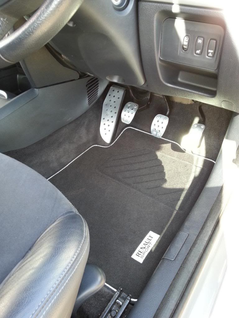

Unleashed the carpet cleaner on the car and replaced the awful poundland mats with some RenaultSport ones and added an aluminium footrest. There’s 8bhp in that footrest and 32 in the mats.

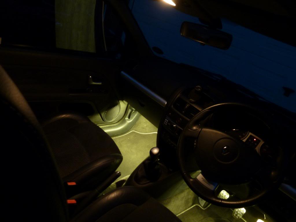

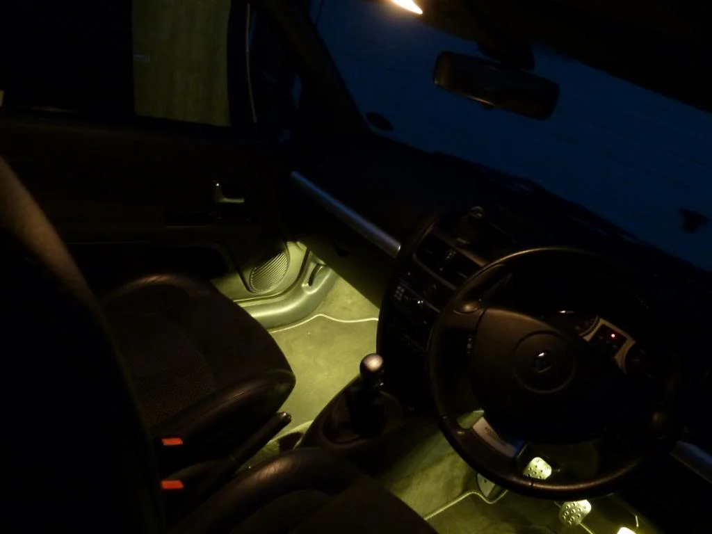

Next came some footwell LEDs with a bit of help from Tom Brentall and his easy to follow guide.
I know they’re not everybodys cup of tea but I think in the right colour they add to the car and I’ve managed to hide all the cabling perfectly. I’m all about OEM+

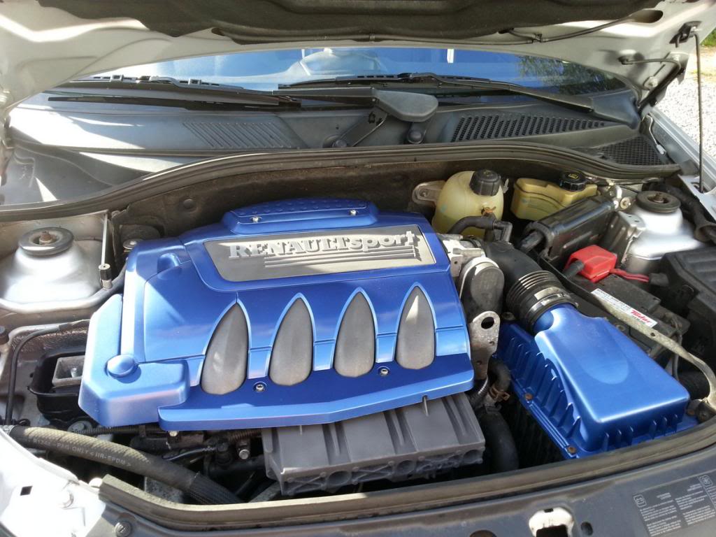

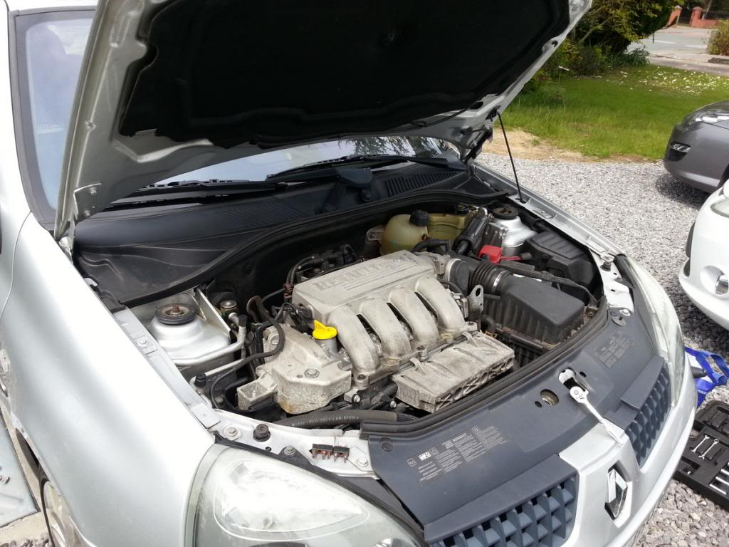

Tidying up the engine bay started to play on my mind a bit so one quiet afternoon the bay went from this:
To this:

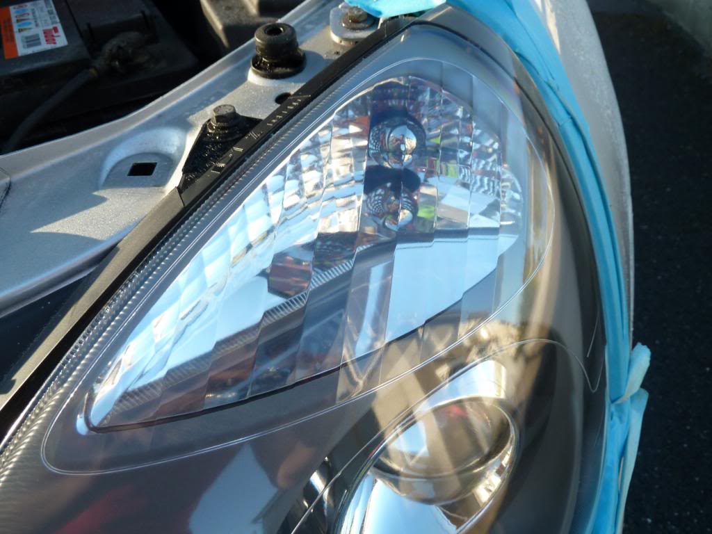

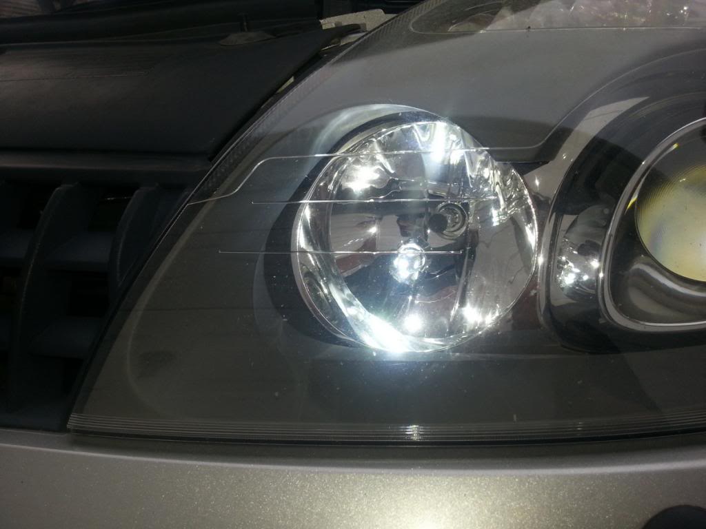

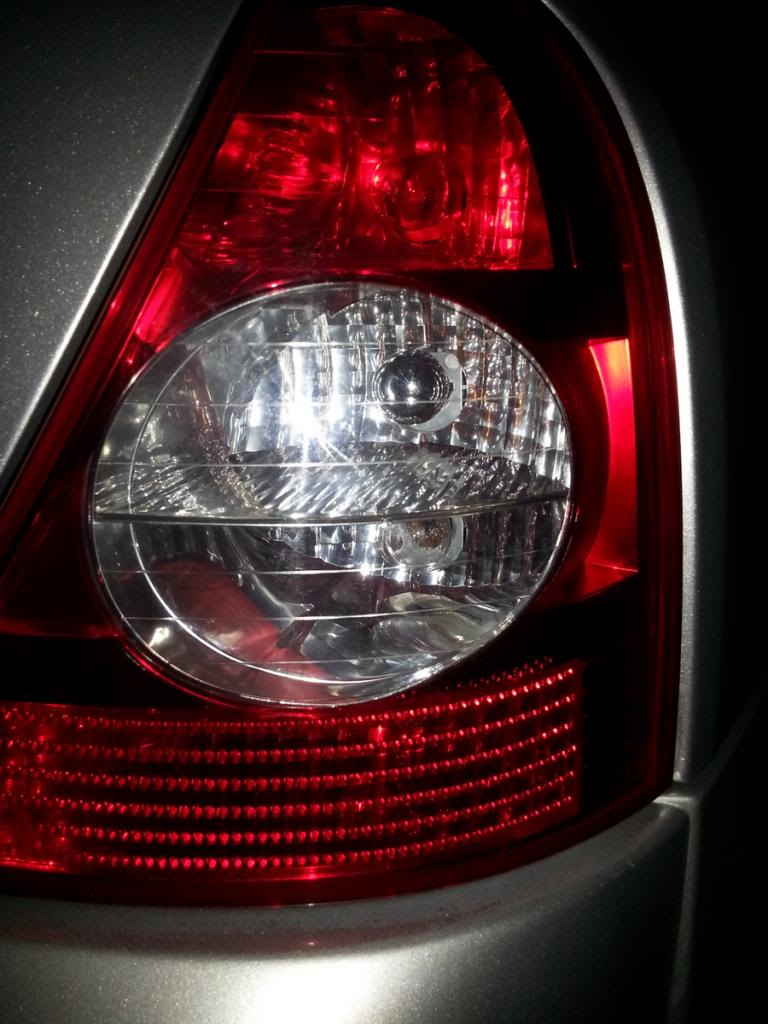

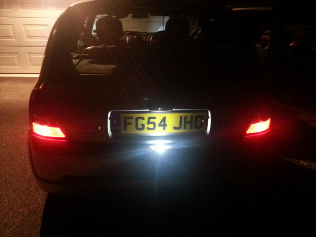

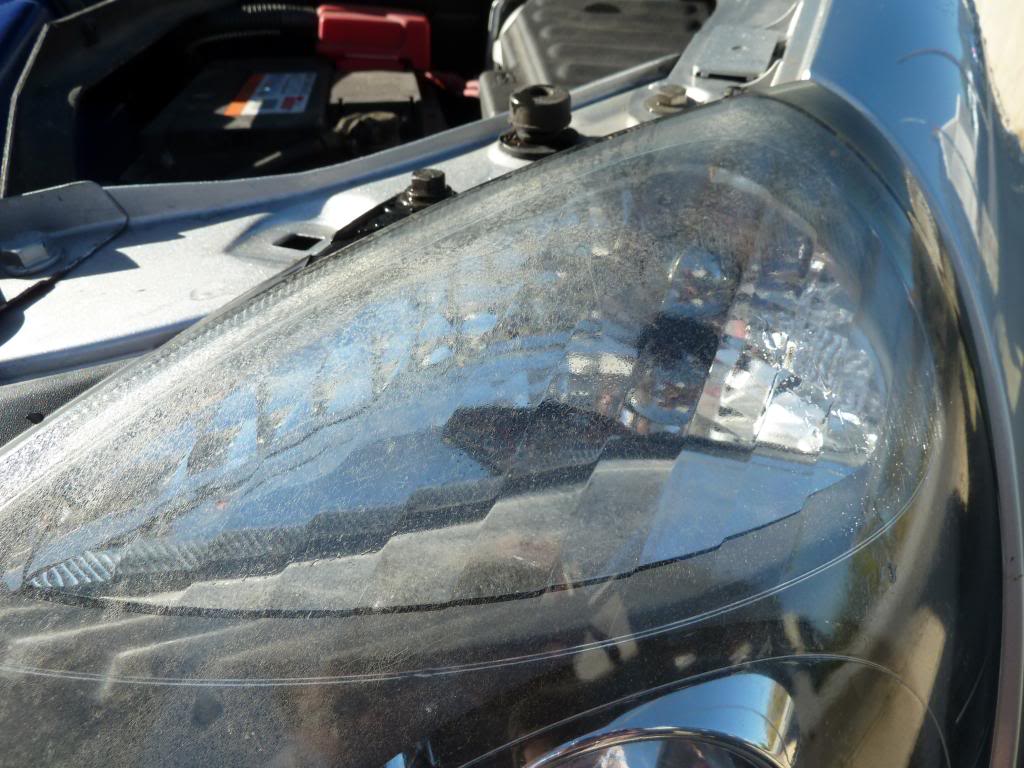

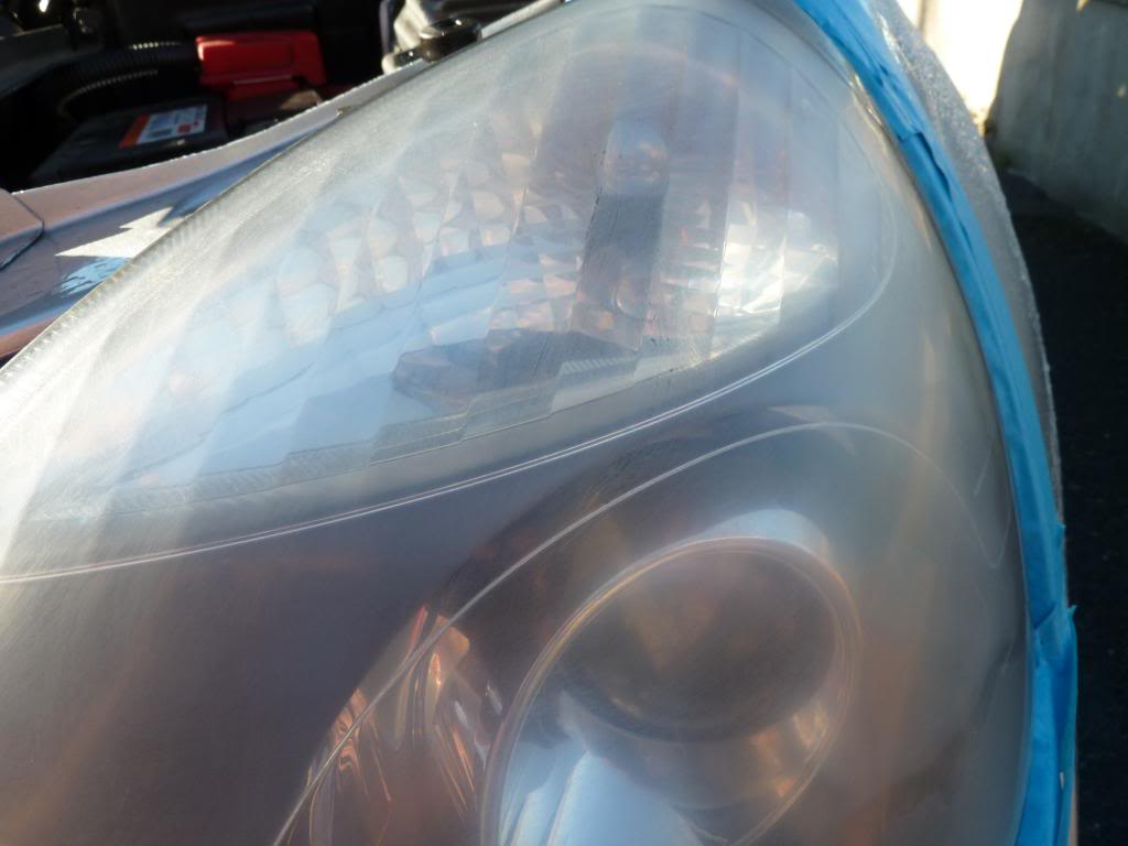

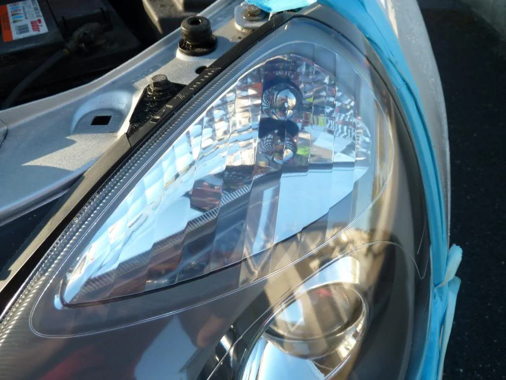

Added the usual silvatec bulbs, LED sidelights and rear plate light and refurbished my lights one sunny Sunday too.

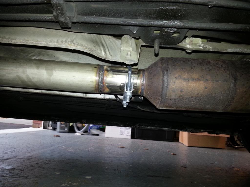

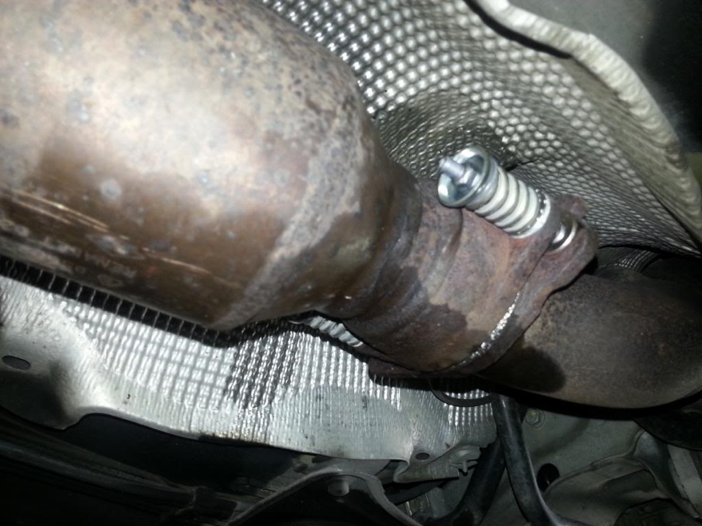

Went for a drive to Brecon one day and noticed under low revs the exhaust made a new rattling sound. After some bad language I figured the downpipe seal had finally given up seeing as one of the bolts was pointing downwards - so it got replaced. Didn’t enjoy working on the exhaust. While on the job I replaced the exhaust clamp too as it looked like it had spent a decade under the sea. Yes in this picture the caps are on backwards. It was dark. :/ I’ve since fixed the mistake.

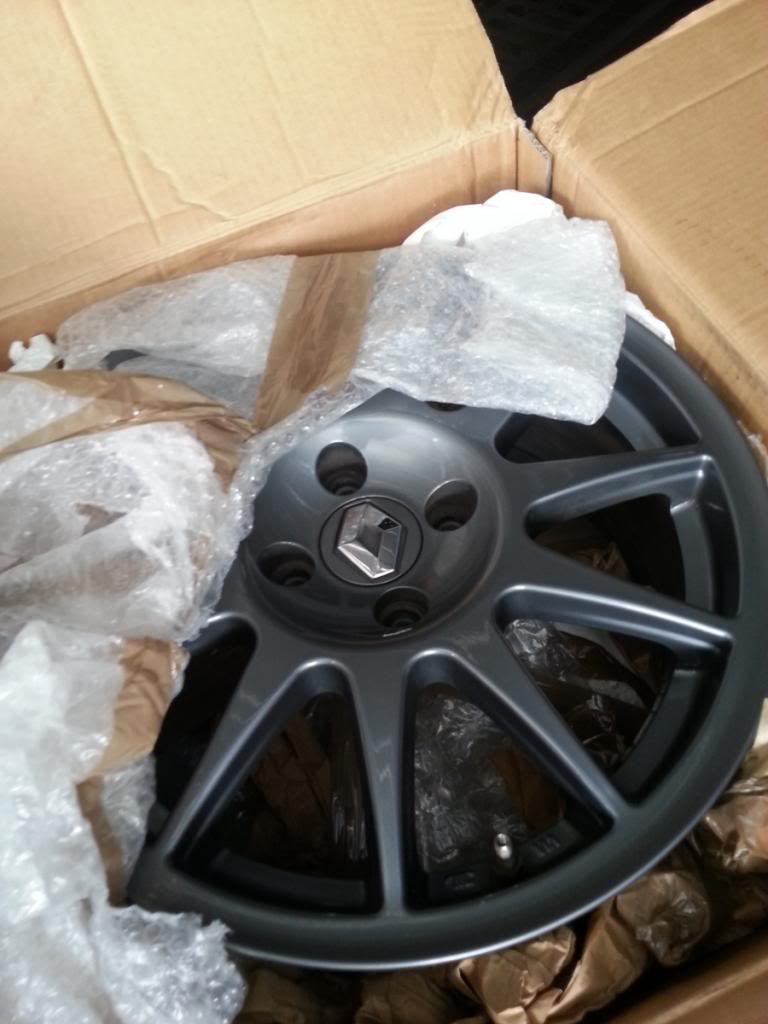

I then started looking into refurbishing my wheels as the previous owner(s) had left me with a few kerb marks but when a set of mint Turinis came up on here for £300 I didn’t haggle. Bought them straight away and sold the original alloys.

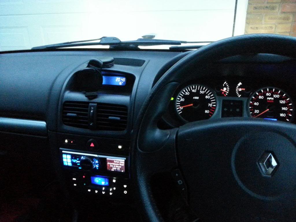

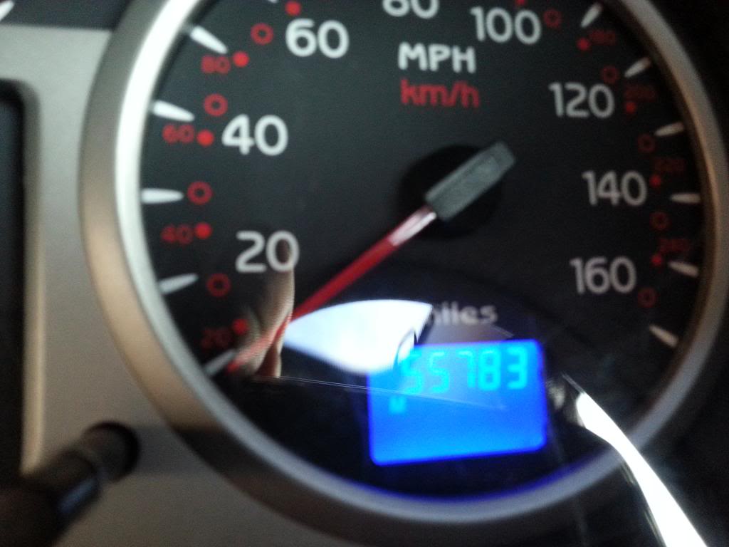

I started to grow bored with the orange dash and after having seen a few LED conversions done on the forum, I thought I’d have a bash at my own and I personally feel it worked out quite nicely.

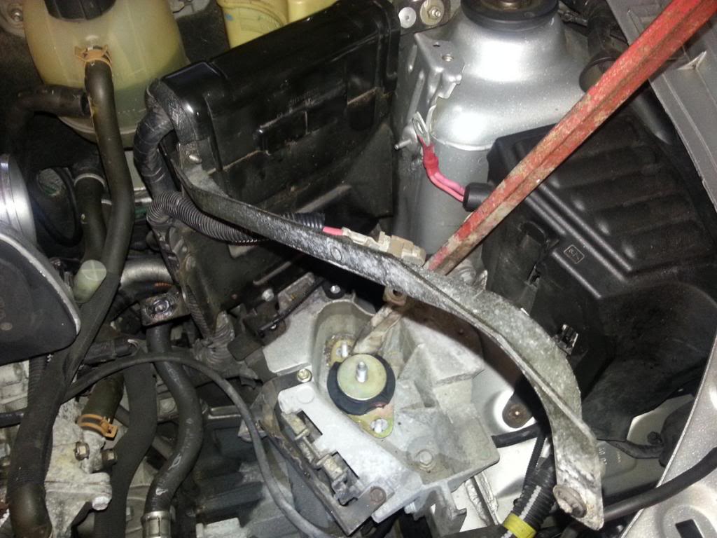

About a month ago I noticed the engine was shuddering more than normal under acceleration and when I eased off the throttle so in went some new gearbox oil, a new Renault standard upper gearbox mount and I polybushed the dogbone. Thanks to the guides on here I set aside 5 hours to get the job done and was done in 3.
Ever seen a crowbar in an engine bay?
Getting those bushes out of the dogbone required some… creative hammering. Anyone who’s done it will understand what I’m talking about.

my mate had a go at correcting my front lights but they seem to have misted up again, how did you go about doing yours? And what did you use to protect them?

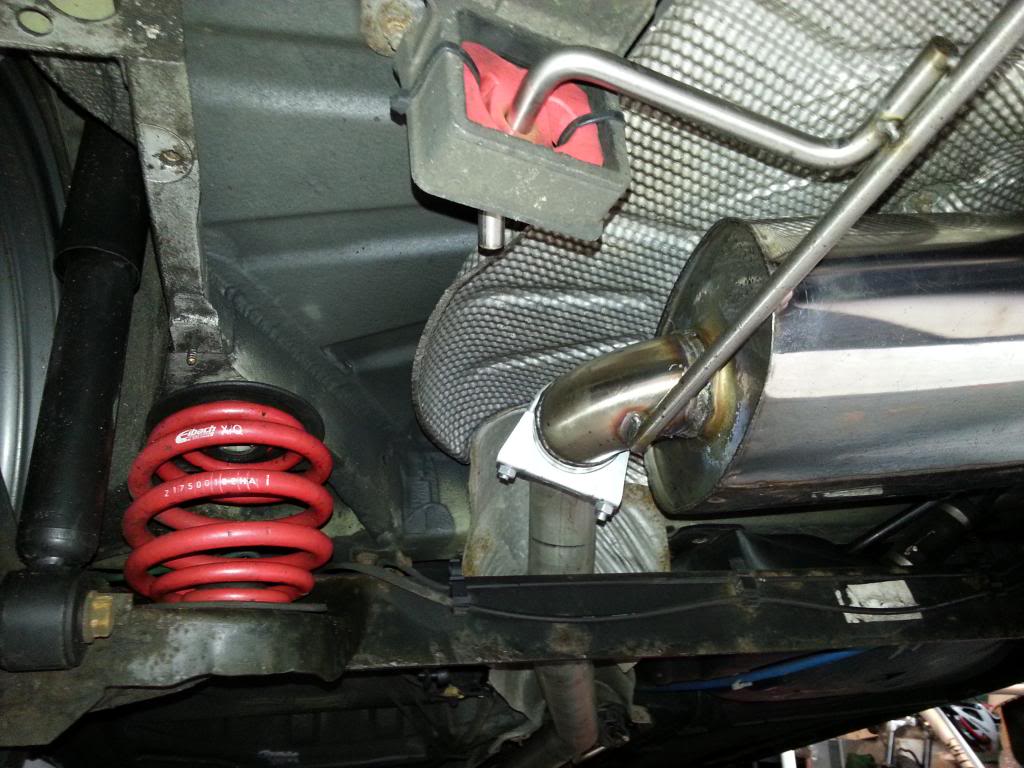

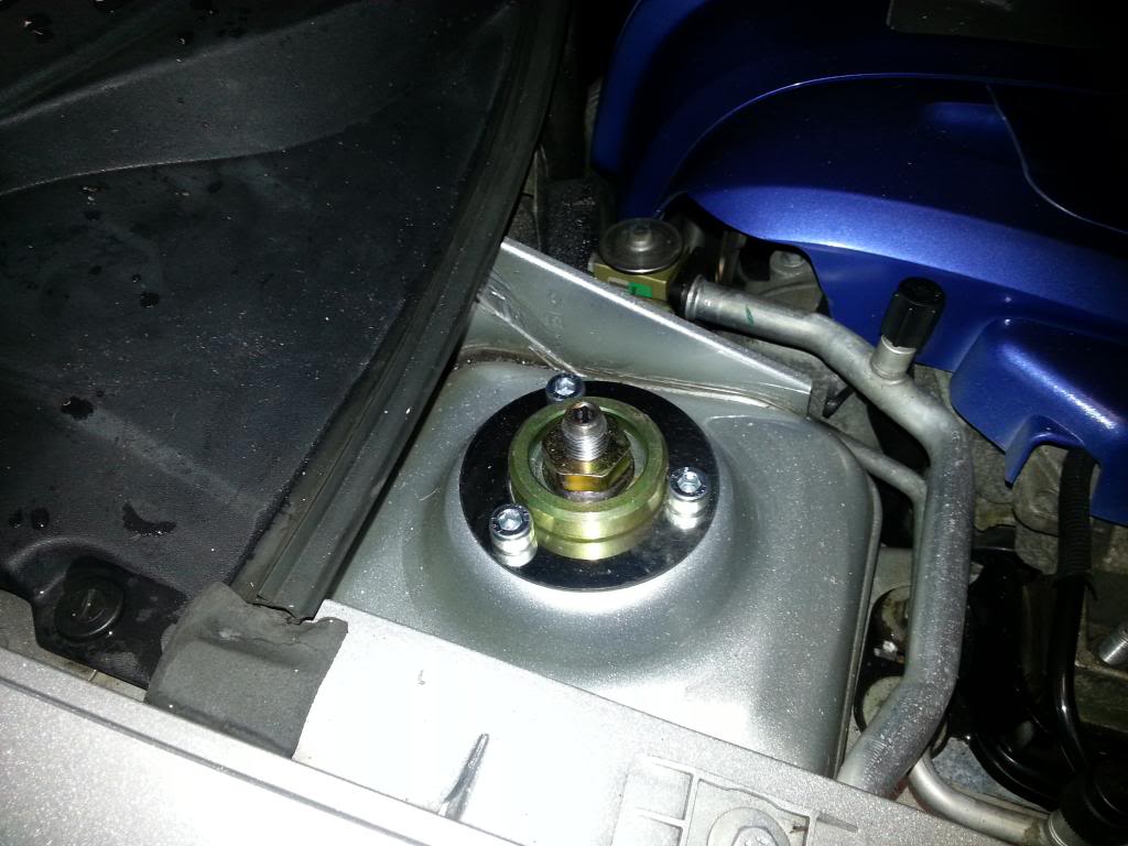

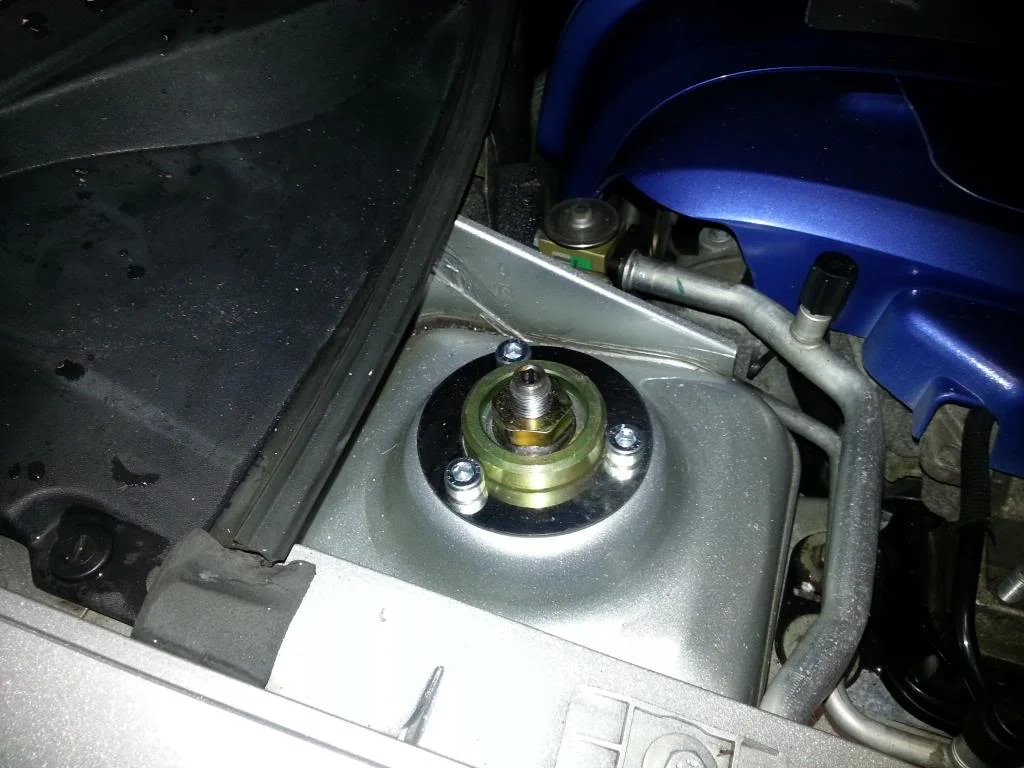

Oh and the cup washer has been fitted the wrong way around, it should go over the top of the spring.
Cracking work there, just needs to sit a bit lower now. :)
He mentioned that after posting the photo.

Polybushing the dog mount was the best and worst thing I ever did. There's a fair bit of vibration but my god it's responsive. Gear changes are also much smoother.
Getting the original bushes out was much harder than getting the new ones in, or yeah I guess you could just buy a direct replacement from Ktec.
The dash mod is not too difficult to do. I still need to do my cruise buttons and window switches. Maybe I'll do them tomorrow! If anyone lives in Wales and needs a hand then if you supply the lights I'll fit them for you for a little bit of beer money. :)

Love the led dash really fresh look I want it !
If you have a bit of time it's a mod well worth doing. Tidies up the inside no end. Like I said if anybody lives in/near South Wales and supplies the lights, I'll fit them for a wee bit of beer money.

South Wales is a bit far for me but cheers for the offer. Any chance of writing a guide? It could get put in the guides section.
I'd love to be able to take the credit for the idea but there's already a couple of brilliant guides on here which proved to be really handy.
It was written back in 2006 but it's still applicable for both Ph1 and Ph2s.
I personally couldn't be bothered with selecting individual SMDs and LEDs so I just bought a pack online. They give you a few extras incase you balls it up. :)
http://www.crazyleds.co.uk/Clio-MK2-Full-SMD-LED-dash-conversion-kit..html
Guide for Dash & Other Bits:
http://www.cliosport.net/forum/showthread.php?175675-How-to-convert-your-dash
Guide for Climate Control
http://www.cliosport.net/forum/showthread.php?448765-LED-Dash-Information&highlight=led

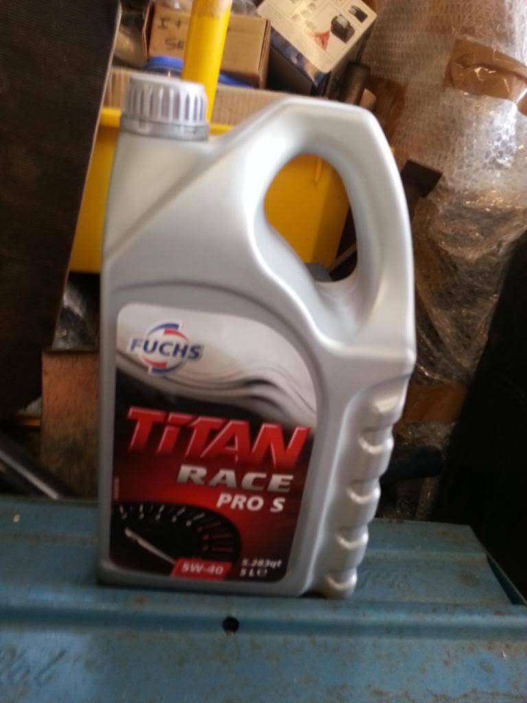

Oil:

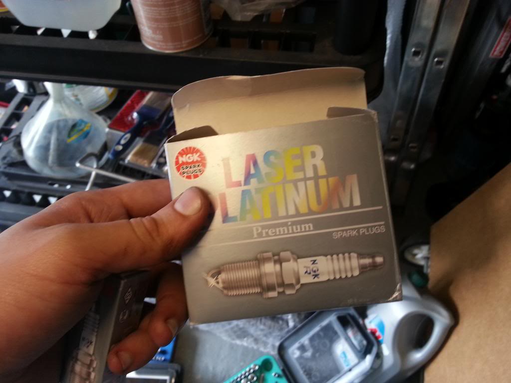

Decided the Clio had earned a decent oil change so I splashed out a little for the Fuchs Pro S. Was contemplating the Nano Drive stuff but settled on the Fuchs.
Plugs:
Just the usual stuff here that the entire forum recommends. :)

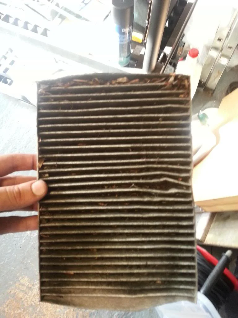

Cabin Filter:
Ever seen a cabin filter with its own ecosystem? Couldn't believe how easy it was to change on this car. Seriously a 5 minute job for anyone who's done it before.

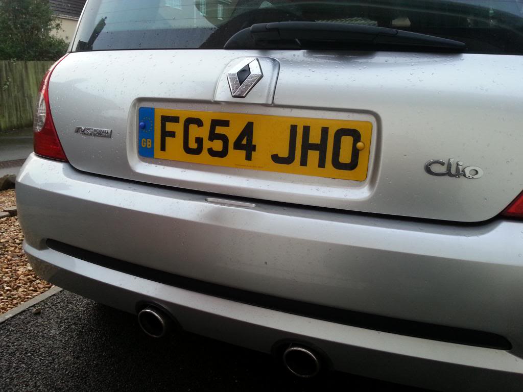

I neutered the poor thing and gave it a stubby aerial. It's tidied it up no end if anyone is looking for a really simple mod.

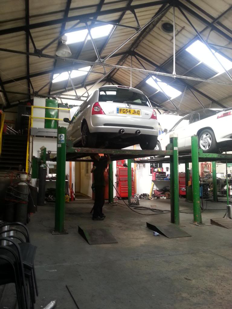

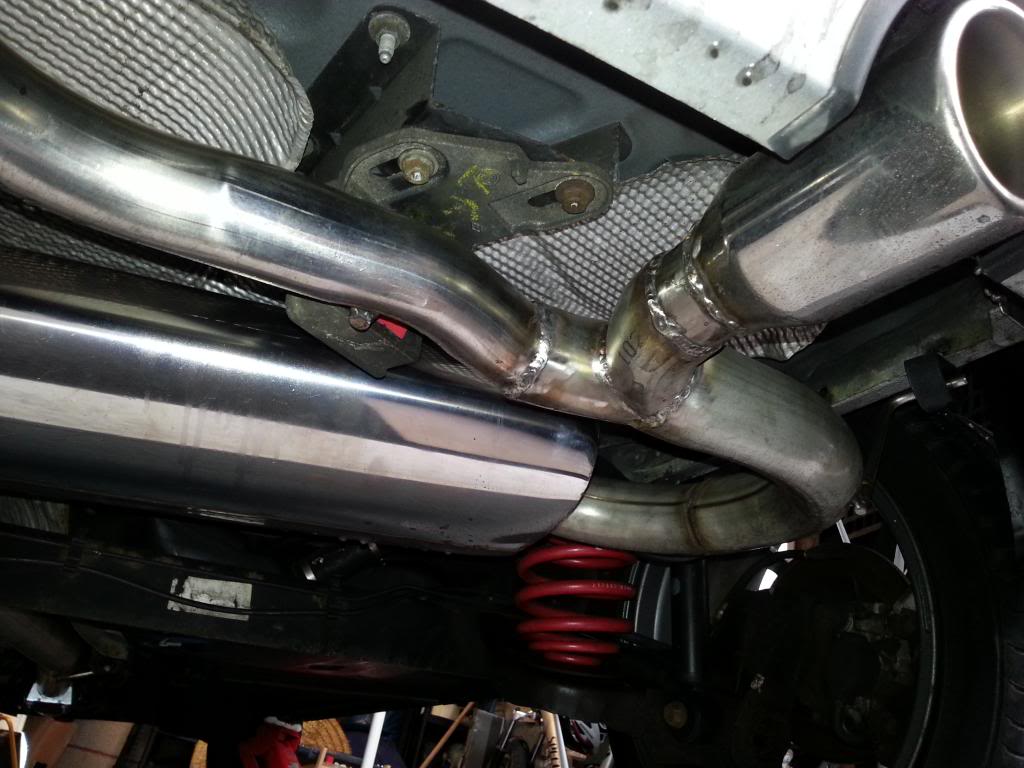

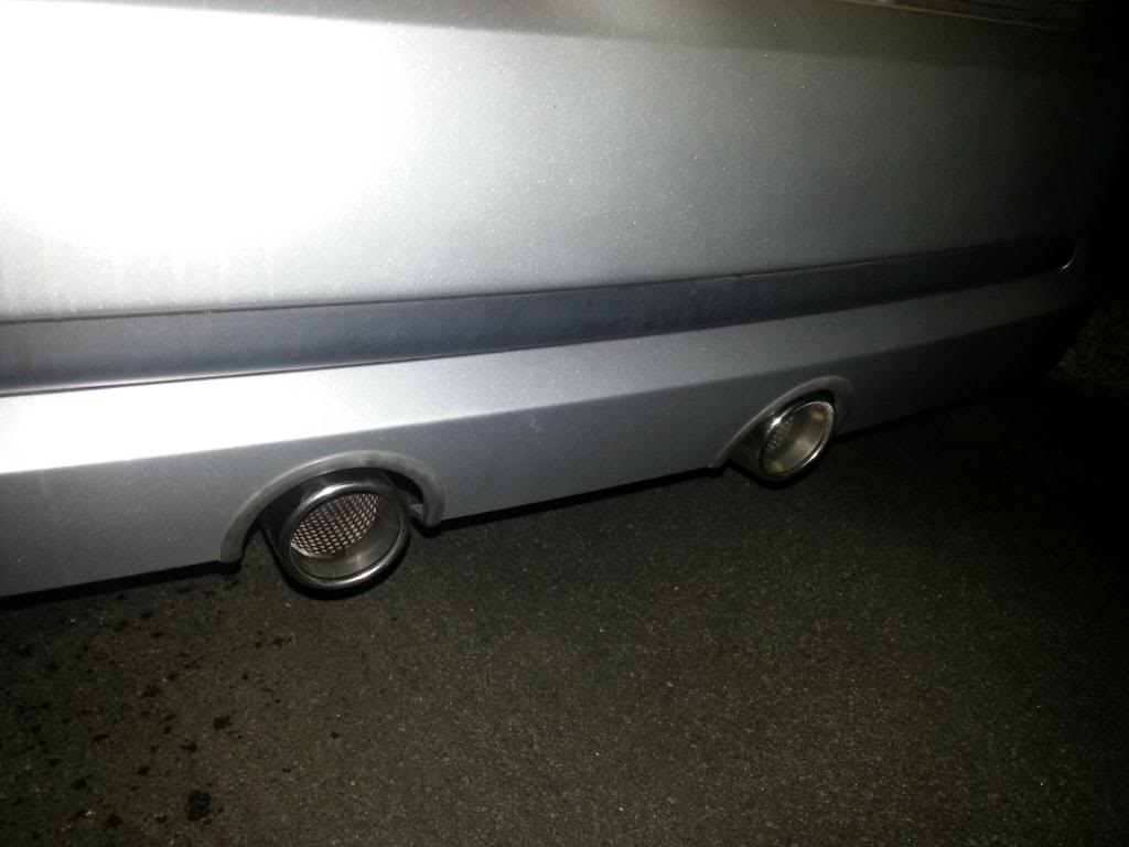

Popped in to see the boys at Pro Speed today. (10-09-2013)
Decided I didn't want my centre silencer anymore. :rasp:
Somehow after it it's gained a meatier, "Don't f**k with me" rumble but it's quieter at 60+ mph. I don't understand this dark magic but I'm very pleased with the result.
Seriously contemplating one of their full systems in the new year as I've heard the results and it just tidies everything up nicely.
On a side note, the lads down at Pro Speed are brilliant. Very chatty, very helpful and a good laugh. Charlie knows his stuff.

Where did you source your mats from (Just Matz?)

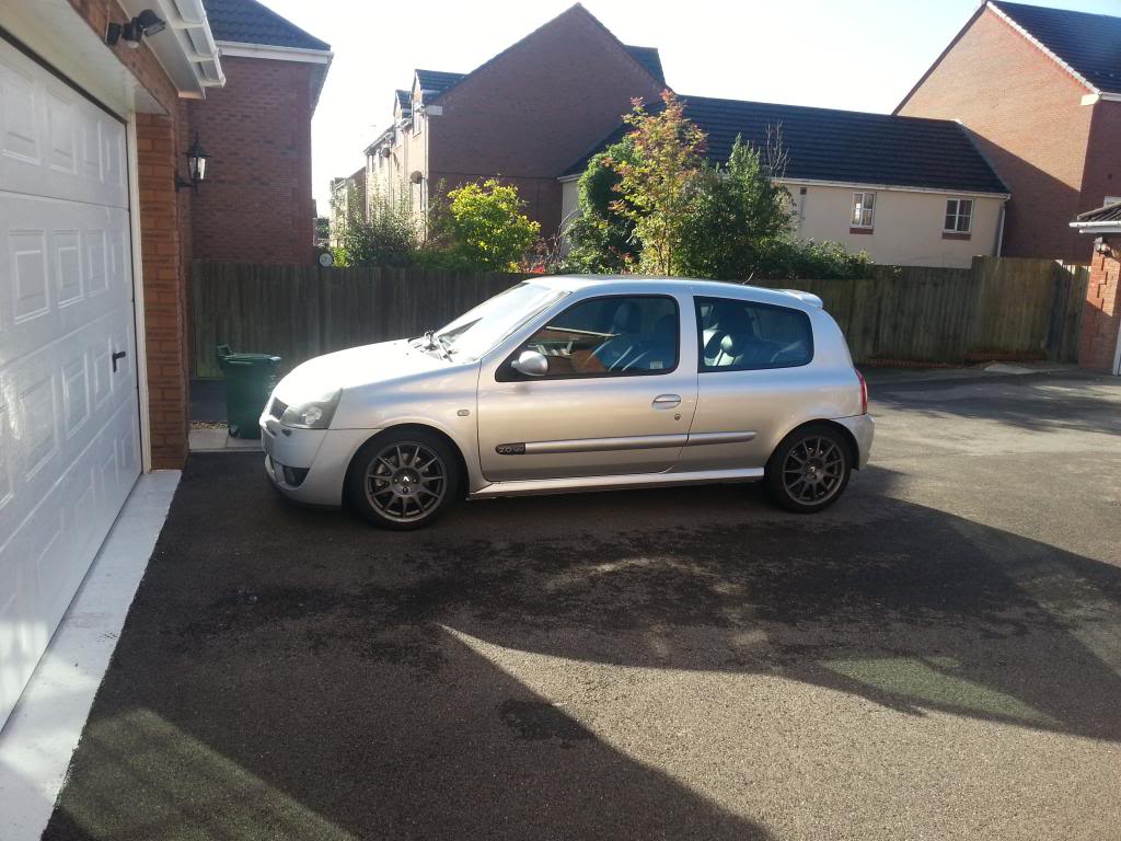

Thought it's time for an update. :)
I gotten around to the suspension refresh finally.

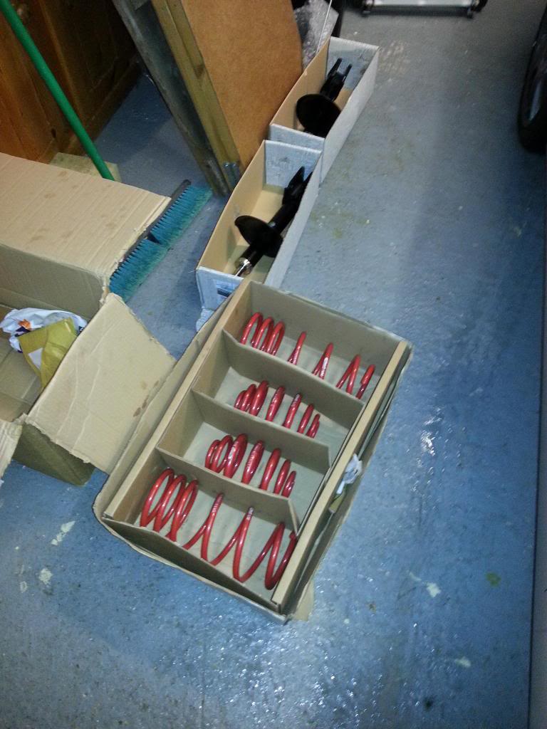

Over the course of last week I was buying up new parts for the 182 and spend a chunk of my afternoon today bolting new parts on.
Today (27-10-2013) the Clio gained -
  • Pure Motorsport Top Mounts
  • 4x new OE shocks
  • 4x Eibach Sportlines
Got up bright and early to meet Vinnie182 and purchase his Eibach springs. He was kind enough to meet me early on the official lie-in day so I had the rest of the day to play. :approve: Big thumbs up to the guy.
I've still got to do the outer ARB bushes but that's a job for another day when I have time (or when I can be arsed)
Oooo. Shiny!

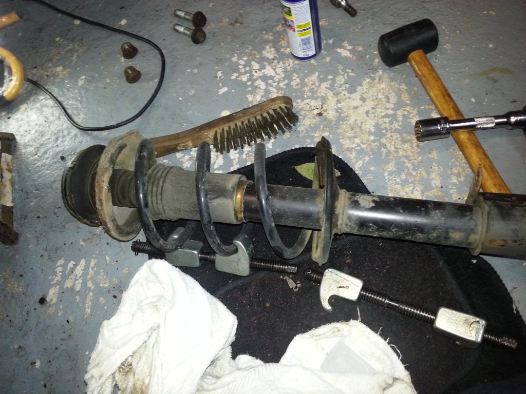

Off comes one of the old springs and shocks.
All in place!
The old top mounts actually looked fine but the old springs (especially the rears) looked like they'd spend a decade under the sea.
I've yet to take any shots of the car outside courtesy of the sideways rain, but suffice to say it now looks poised and angry!
I've had a drive. Car feels a lot more responsive and the steering feels more direct than it did previously. There is no added noise from the solid top mounts however that is probably overshadowed by the polybushed dog mount. I currently have the black mount on there which will be coming off soon and it's a bit too intense.

I decided it was time to splash out on making the Clio a little angrier so I left the car with Charlie down at Pro Speed and he built me a custom pipe.
I decided to leave the cat in for noise purposes and for the sake of an easier MOT. I know I could just give the MOT man an extra bit of paper or add and remove the cat each time but I just didn't fancy it. Charlie also cut back into the cat to remove the 2 1/4" restriction normally present.
Charlie was kind enough to lend me one of his courtesy cars for the day too, a Nissan Almera. Was nice to be able to hear the radio for once while driving. :rasp:
I did a quick sound test on the day as well. Apologies the video quality is so poor.
The noise has gradually gotten a bit deeper with use over the last few weeks.
Also after having seen "that thread" about grubby induction cones and the mess they leave I decided to remove mine for the winter. The hose was surprisingly clean, as was the cone but I'm back on the stock airbox with a washable Pipercross filter. It doesn't quite have that roar the K-Tec kit used to. Bit gutted I didn't take any of the engine bay. Oh well, another day perhaps.

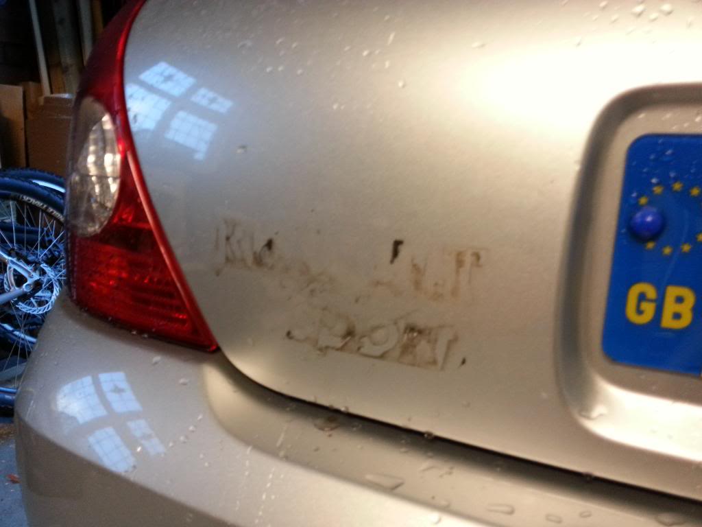

Last but not least I put my hands on an updated badge which I fitted on 28-12-2013.

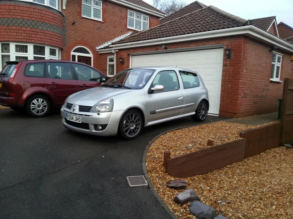

I only cleaned the bloody thing yesterday, and it's filthy again. I hate this time of year.

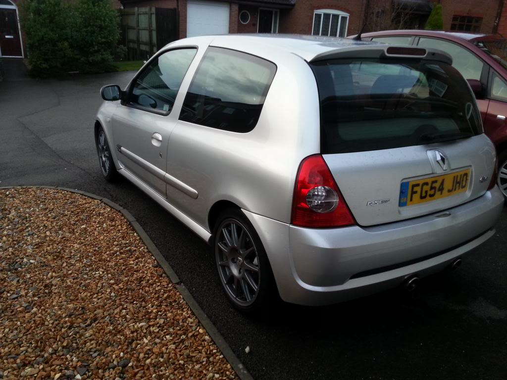

And so this was the car today.
It's dropped further since I put those springs on to a point where it's now difficult to get the jack under there. :rasp:
Still a few bits to do in the new year.
