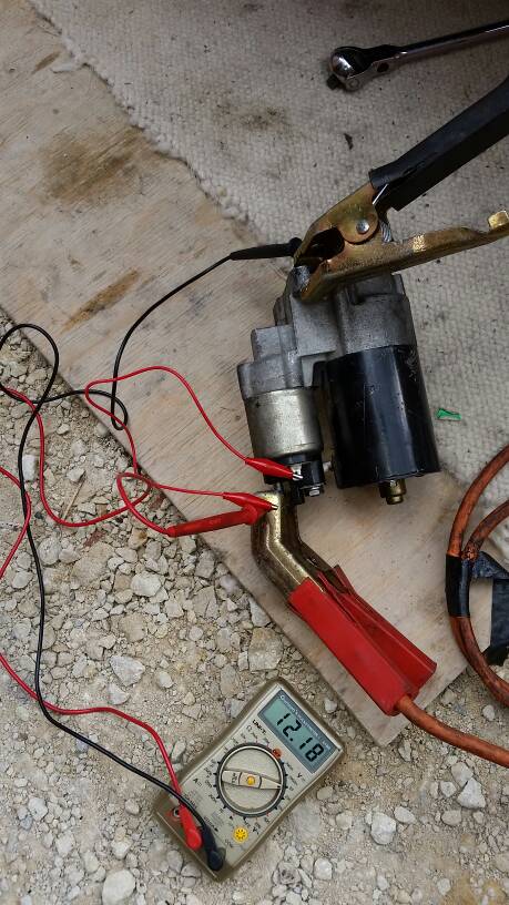

my 182 wont turnover after gearbox replaced
Right so bench tested it... or floor tested it, and the starter is gone!
Which is annoying but good to know, what starter motor do people use and where to buy?!
But yeah thanks for all the help anyway, it's hard to diagnose it when youre receiving info from me, and not there in person! Cheers guys!
Right just to update you all,
Fitted the new starter motor today thanks to Budgie
The car is now running fine, and the gearbox and clutch feel mint, very happy!
Thanks to everyone that inputted and helped!
