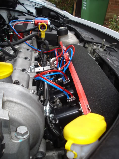

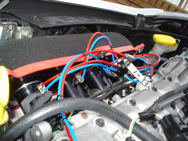

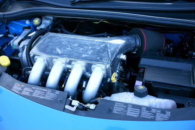

AT Power ITBs.
EC1 Standalone ECU.

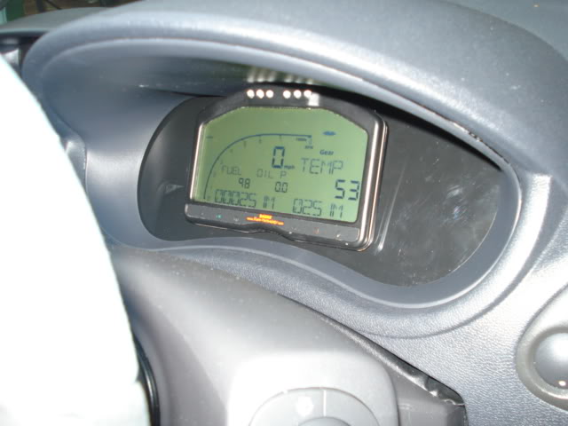

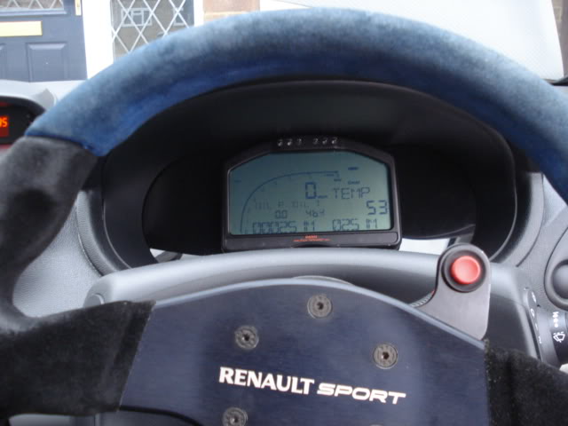

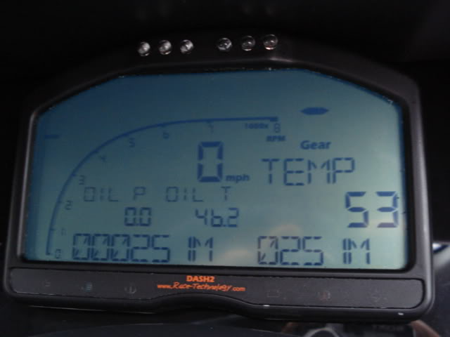

Race Technology Pro Race 2 Dash.

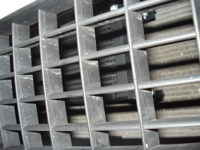

19 Row oil cooler with sensor take off.
ARP con rod bolts, raising limiter to 7800rpm.

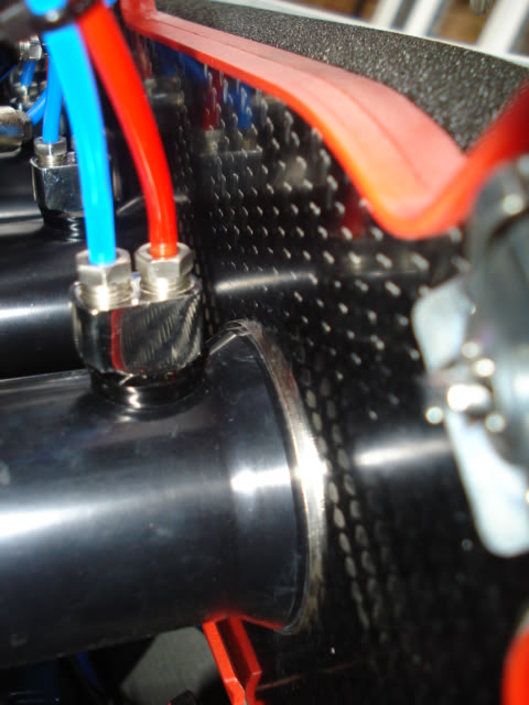

Carbon Fibre filter backing plate.

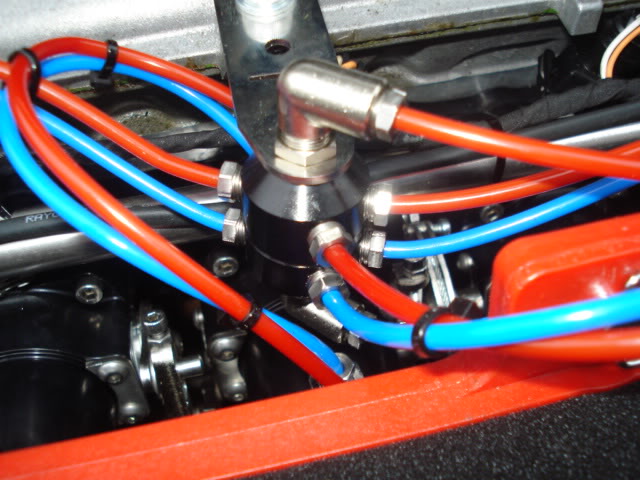

Nitrous converted to direct port, one injector per trumpet.

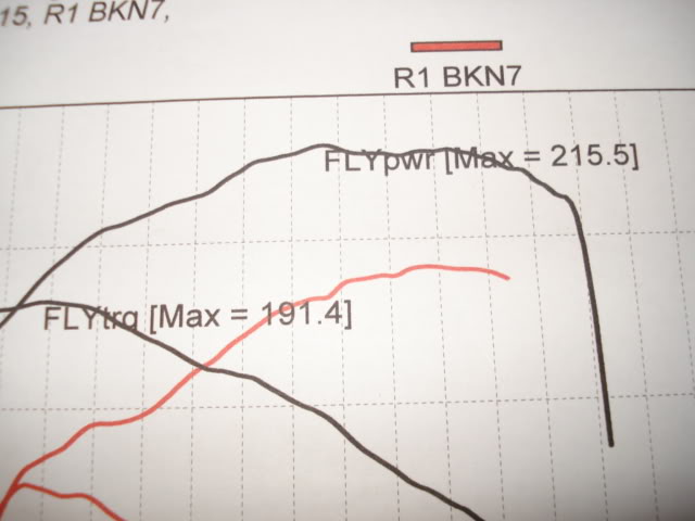

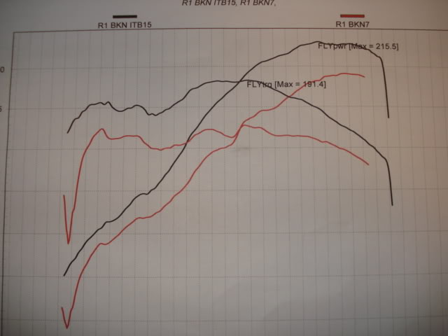

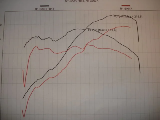

Dyno'd pre work at 196bhp, increased to 215bhp with ITBS with a 20+ lb/ft torque increase across the entire rev range. Pulls much harder mid range most noticable along with neck snapping throttle response. Dash shift lights like an F1 car, very helpful and fun :p
As far as im aware this is the 1st ROAD car to adopt the traditional ITB setup in the Uk and only the 2nd to run ITBS, following GDIs 'up and over' design.

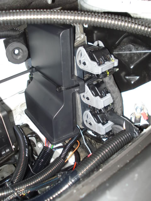

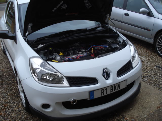

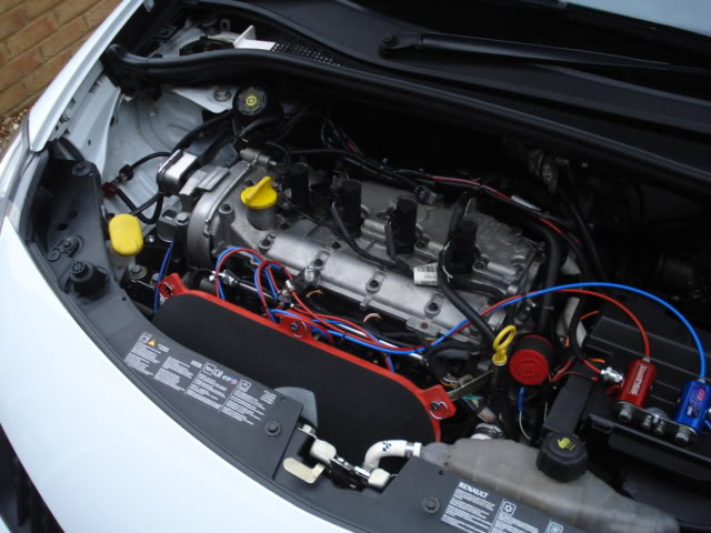

EC1 ecu fits into OEM cover:
Space is restricted at slam panel lol:

Damn good job. Bet it sounds nice. Also a very tidy engine bay. Not something that I have seen much with ITB'd bays ;)

Quick shots of the dyno chart, super smooth power delivery :) I'll scan the whole graph at work so its abit clearer. Red is pre work and Black with ITBs. Take particular notice of the old flatspot lol.
Very nice car mate, would that dash be a solution to the new MOT laws? I.e. no warning light's, my omex + changing the steering wheel's got my dash lit up like a Christmas tree lol
All that effort for race spec dash's, ITB's e.t.c ... to have your ECU cable tied to the car :/
Nice none the less!
Nice none the less!
Cup racers are built with cable ties!
its just the plastic cover, the actual unit and metal cover are bolted on like the oem.
Hi Ben, Your car looks awesome I have seen it in the flesh quite a few times when I have been at TDF checking on progress with my car! I love the choice of mod's you have gone for and the Dash 2 is a great bit of kit isn't it! It's such a neat install that they have done on the car. I hope you enjoy it :)
Lewis, Yes the Dash 2 is MOT compliant as it has all the telltale's on that you need for MOT such as indicators, rear fog, lights and Main beam

I'm sure you'll all get a chance to see it over the show season, planning on a little more work on the car before then so hopefully it'll look that little better. Race dash is fully Mot compliant yes and it's one way of getting around the new MIL lamps rule. It's very road friendly and the shift lights are very handy.
