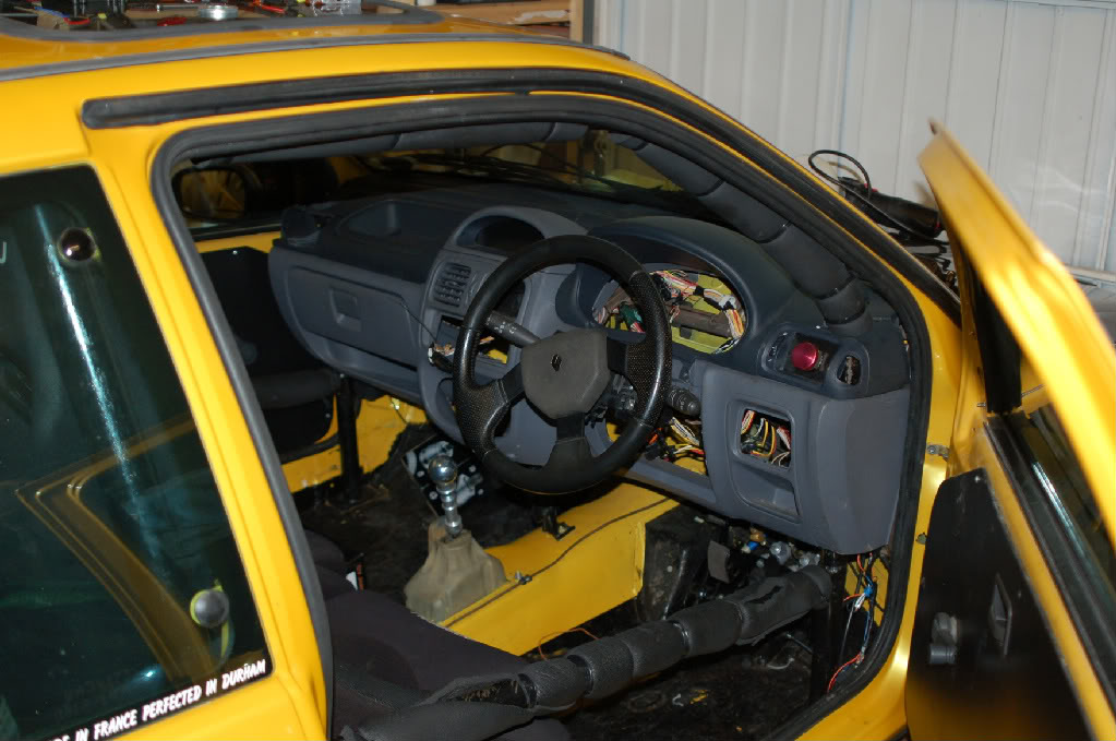

I'm sure you'll all get a chance to see it over the show season, planning on a little more work on the car before then so hopefully it'll look that little better. Race dash is fully Mot compliant yes and it's one way of getting around the new MIL lamps rule. It's very road friendly and the shift lights are very handy.
Nice car, I've got the same dash for my mk1 clio project :)
also have the very same dash ready for my ph1 172, so annoying the project is taking so long, i had the dash over a year back....

i am running a mark 1 dash top and that is it.... anything else would weight too much
Its the dash top that we'll both be mounting it in though?
And it weighs only a couple of kg for the whole setup in mine minus the heater etc:
