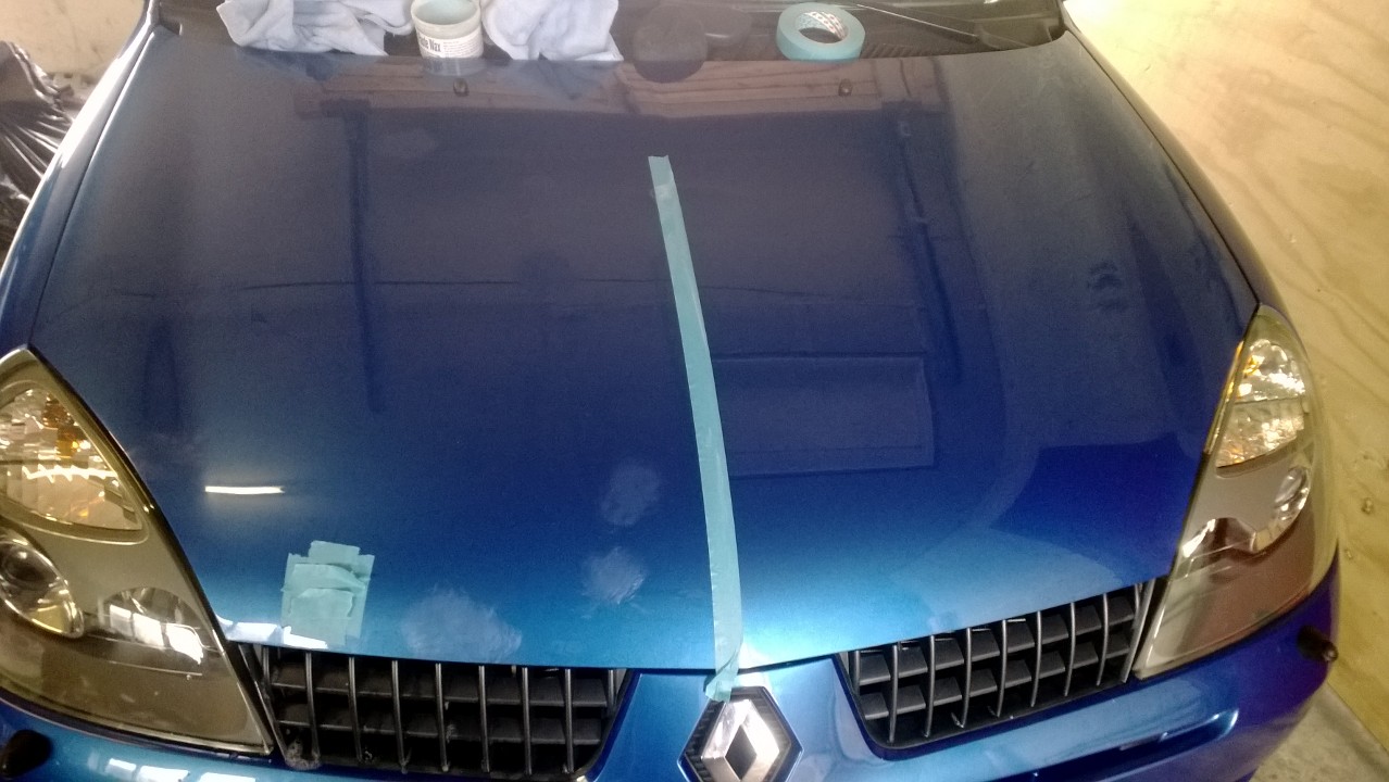

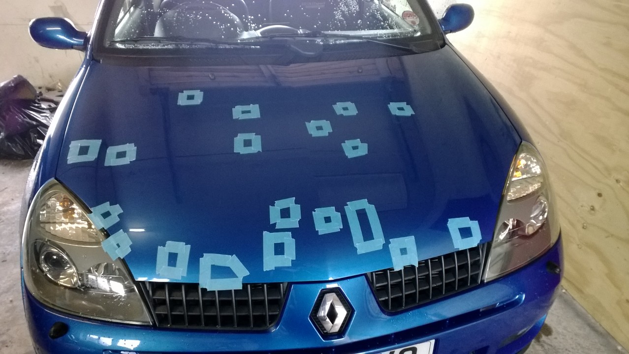

So today I decided to fix the bonnet chips on the car.

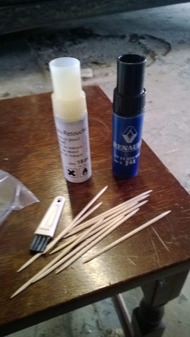

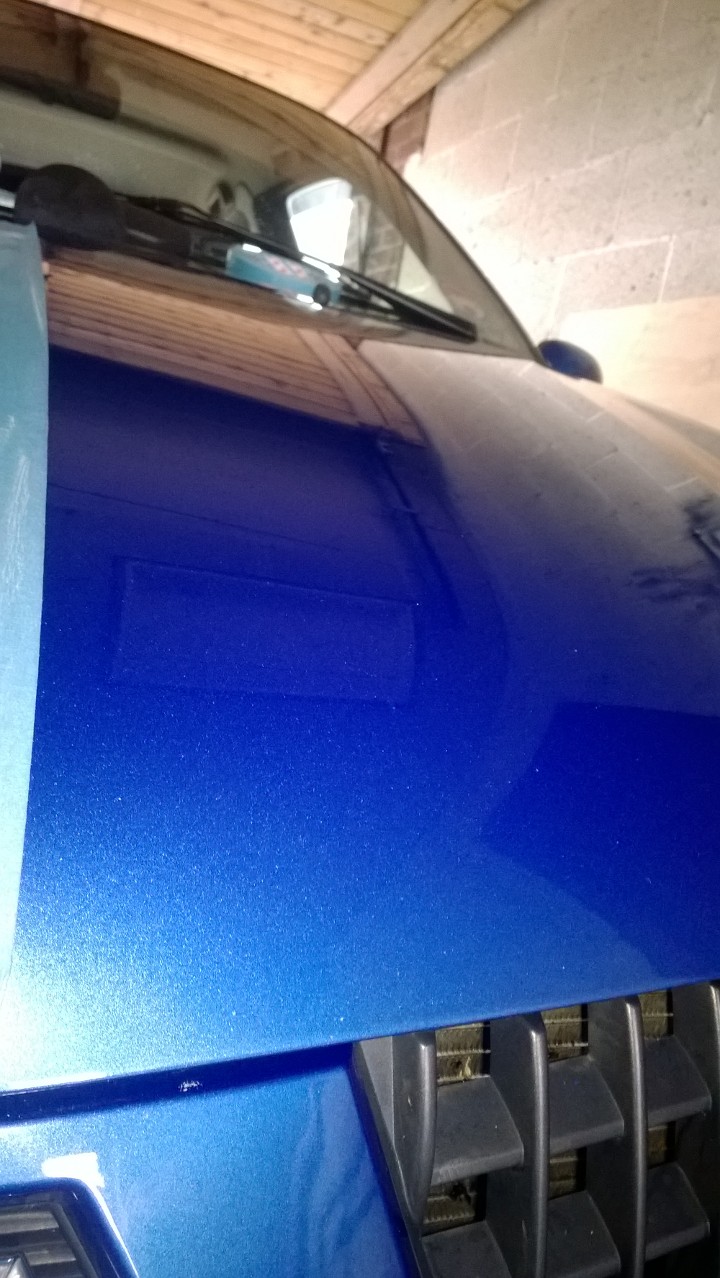

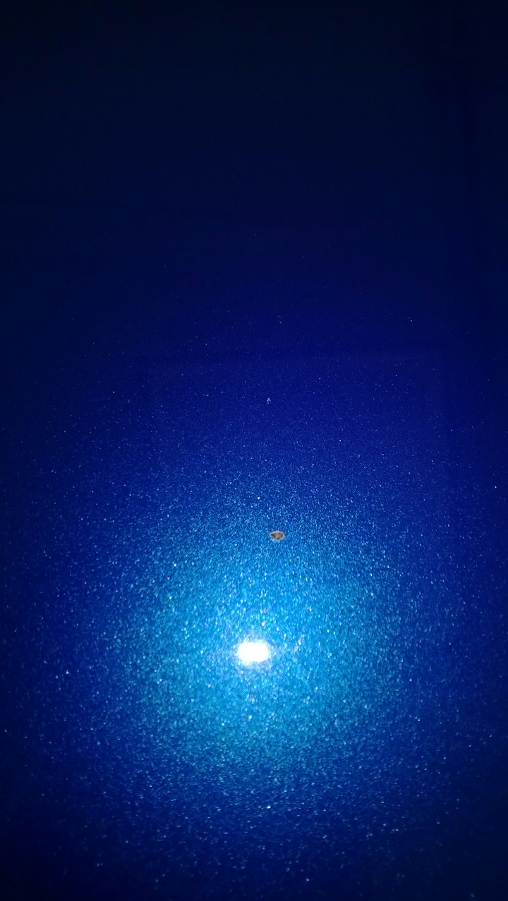

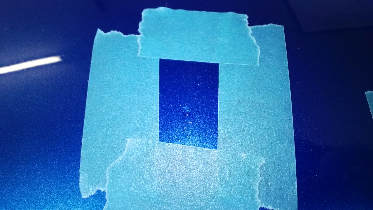

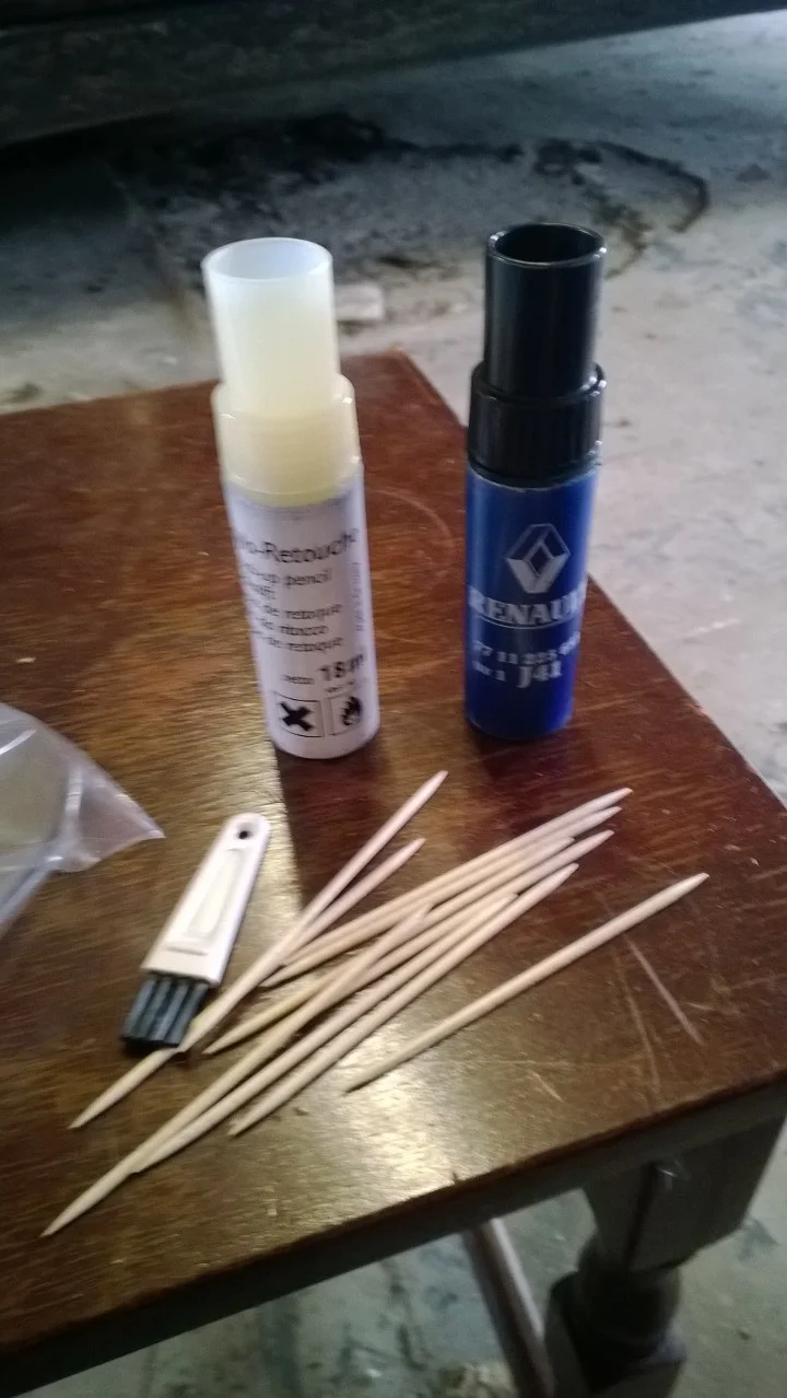

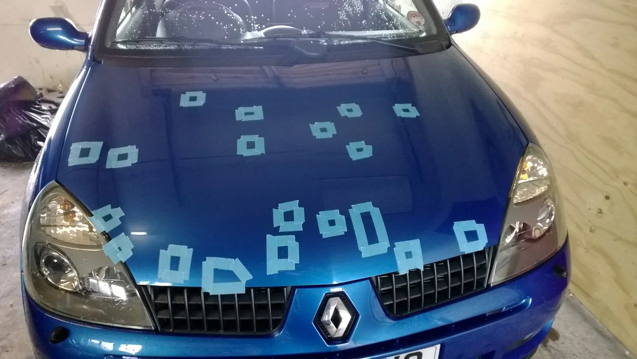

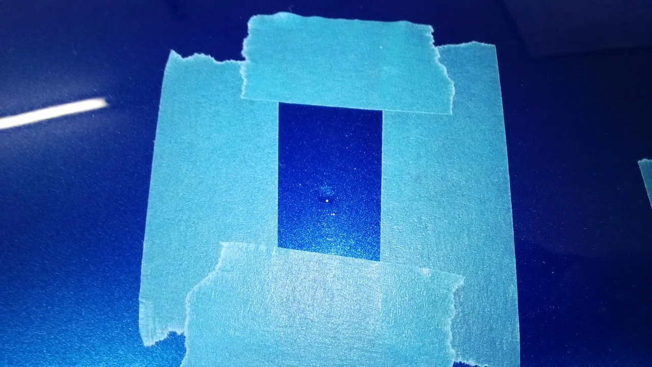

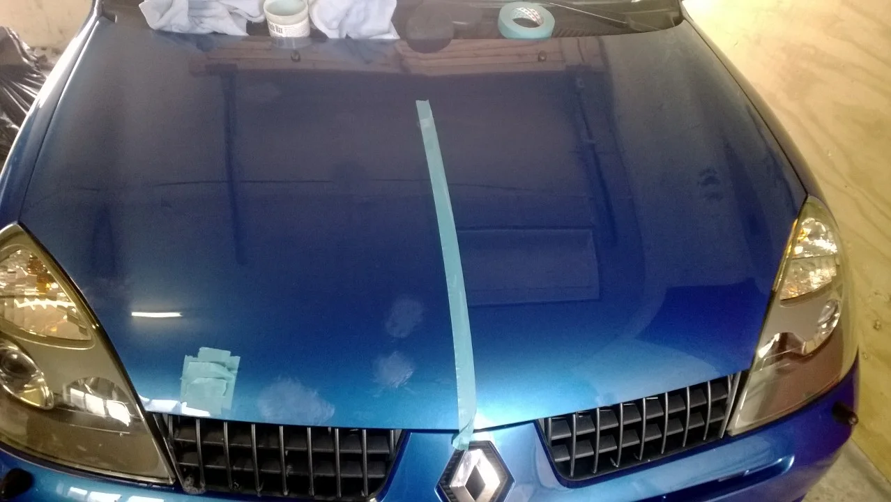

Started with a snow foam wash then used some Autofinesse obliterate to strip the bonnet of wax then cleaned the chips with some vodka then a final rinse. Masking taped around the chips just so I can remember where they are, then set about filling each with paint using the toothpicks. Two hours later I applied the clear coat, sanding down and results tomorrow.
Some pics
