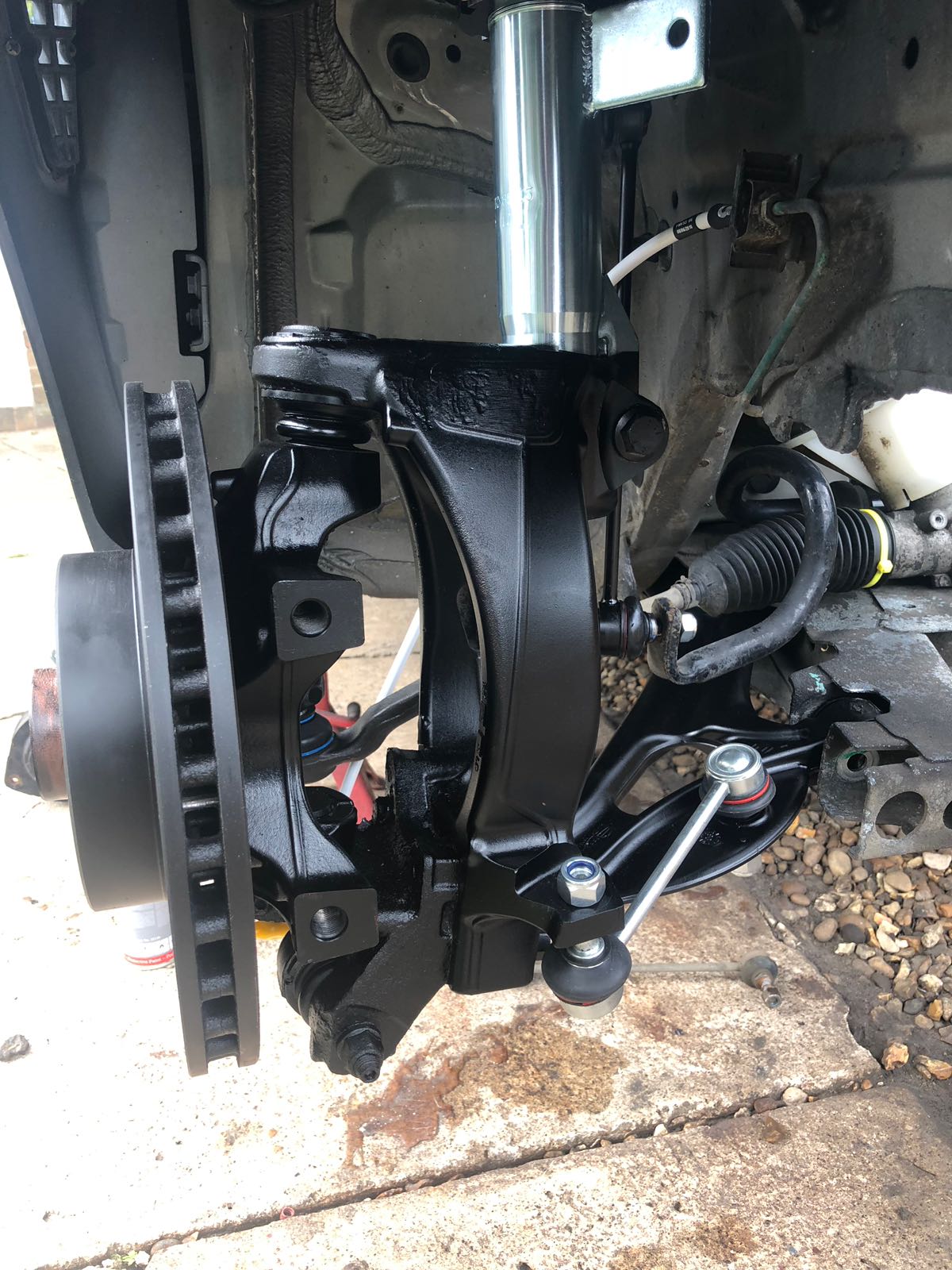

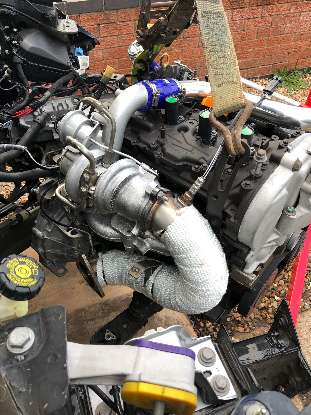

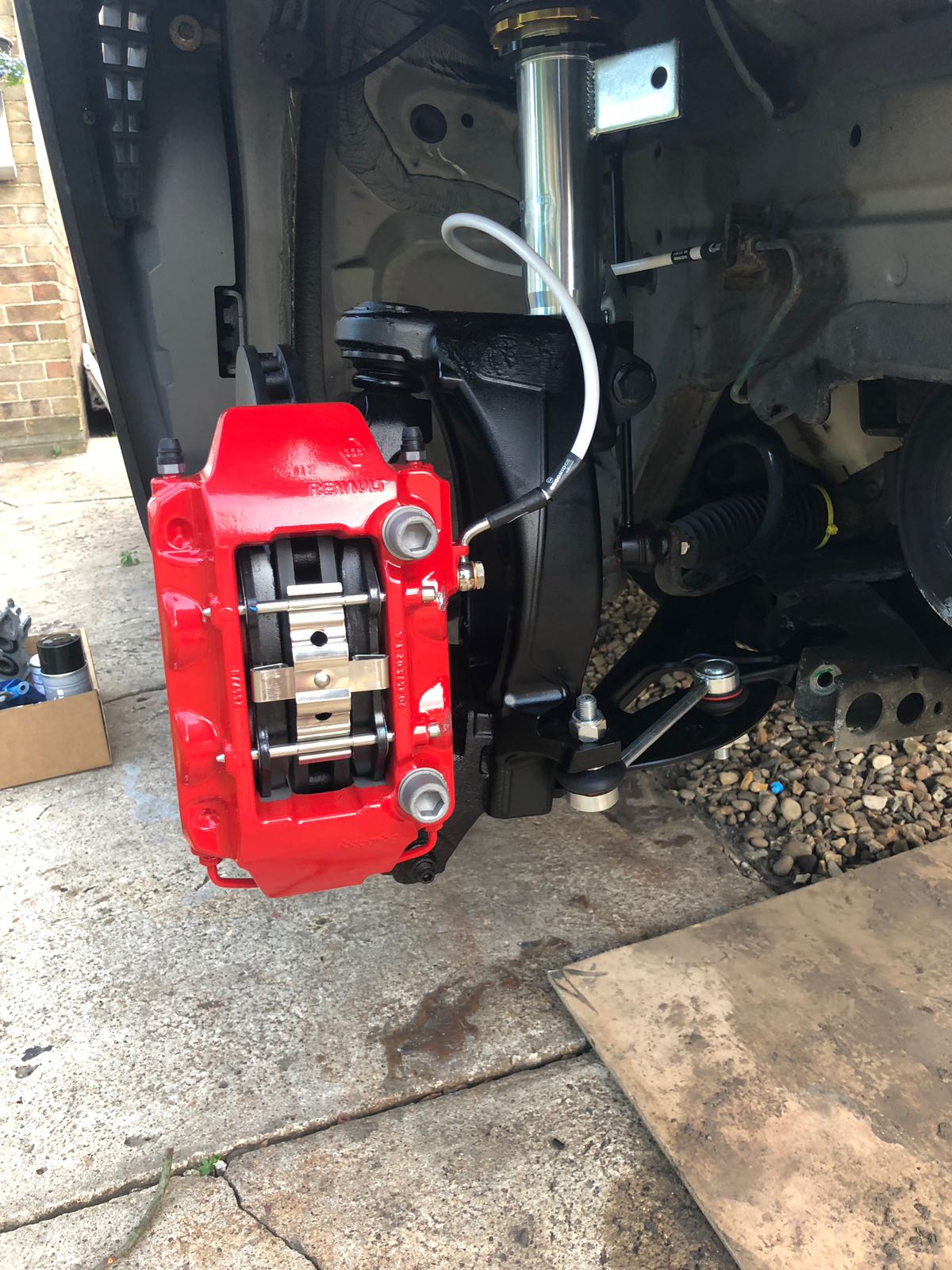

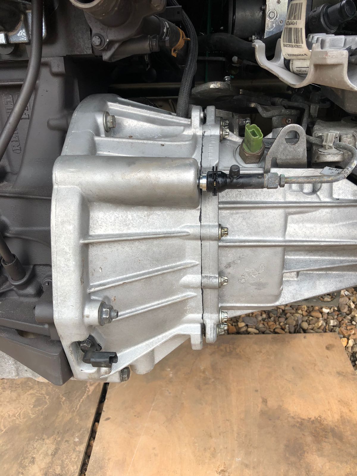

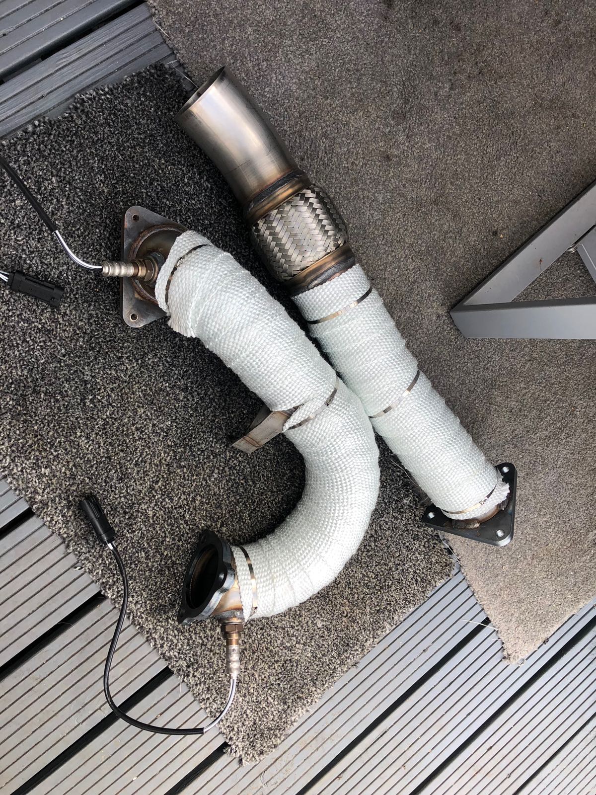

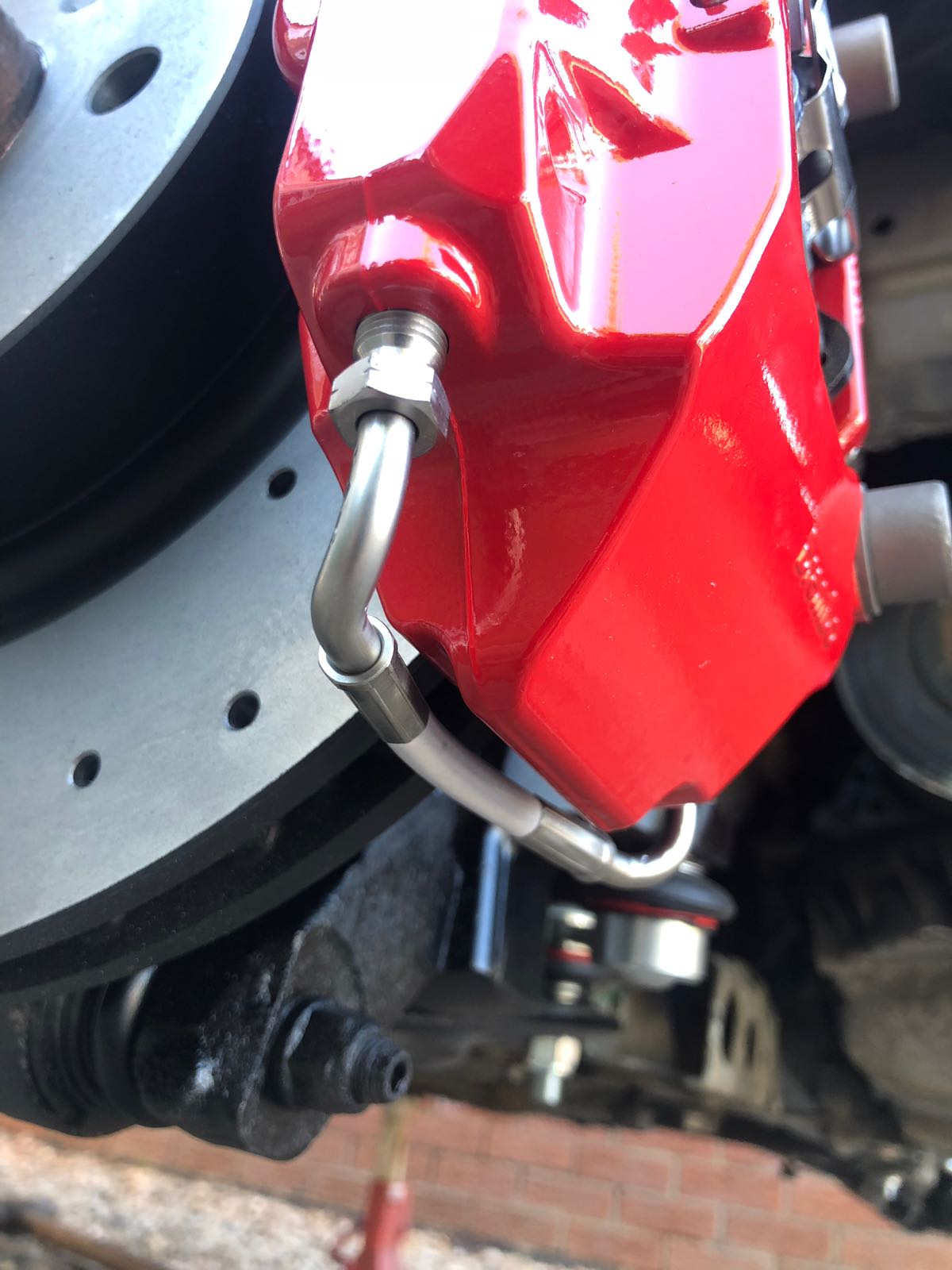

Well ill keep this post for my updates after just buying this. Still needs few things doing and no doubt ill add bits as time goes on.
Few more pics

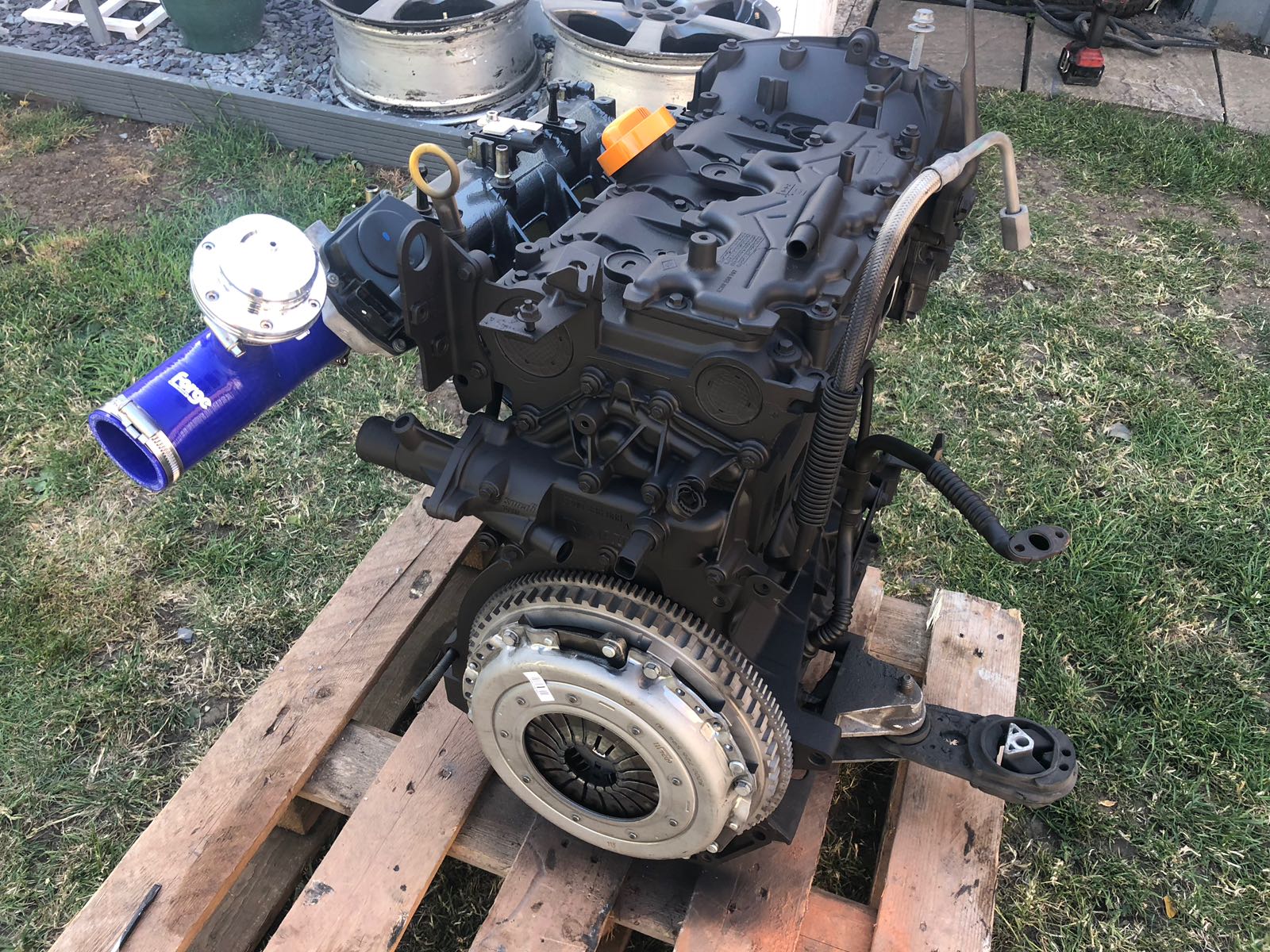

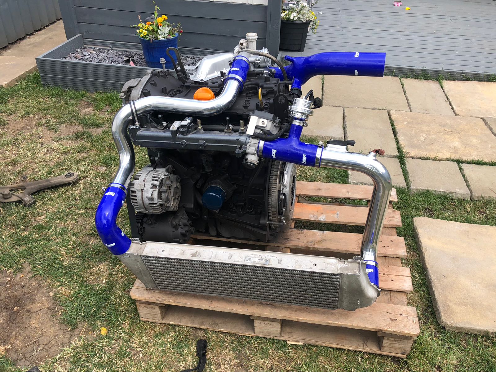

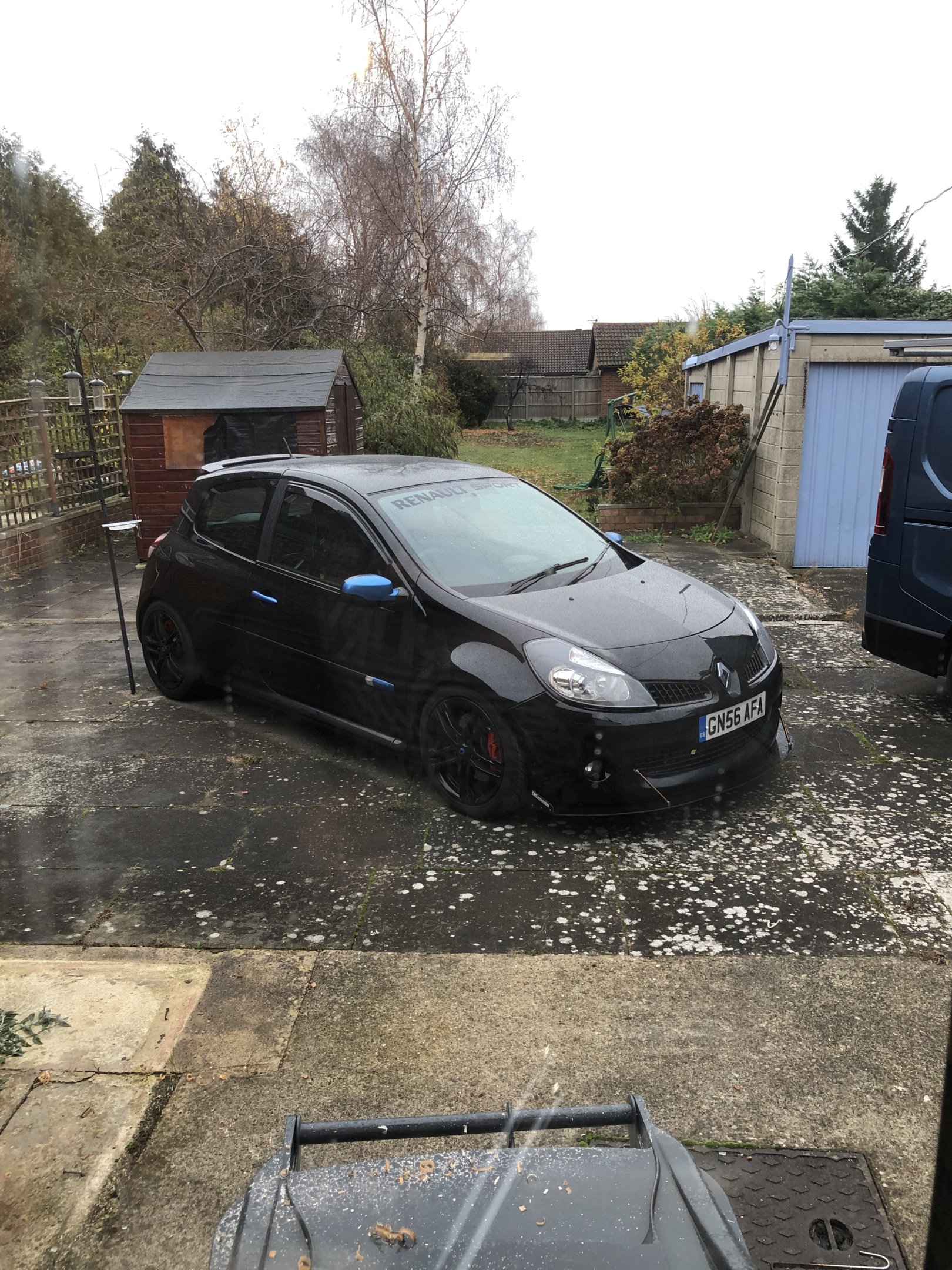

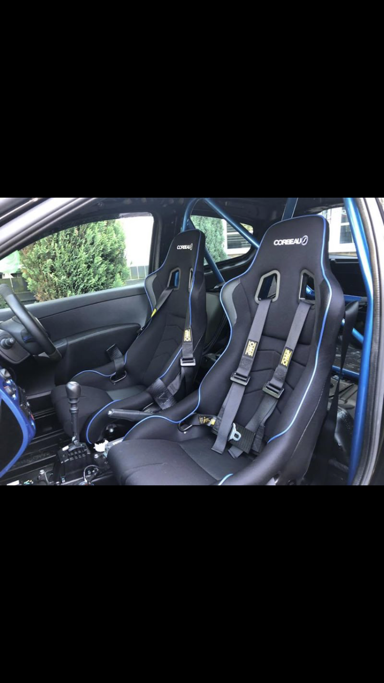

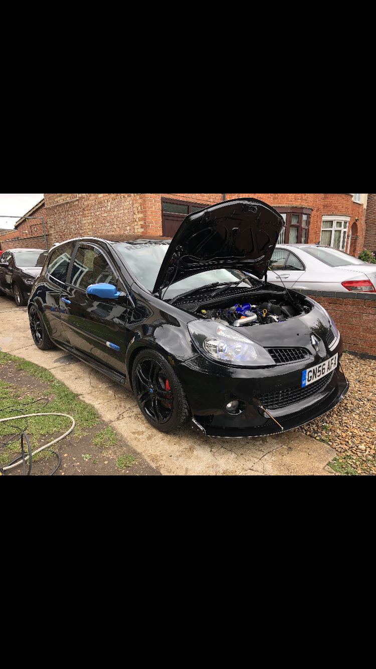

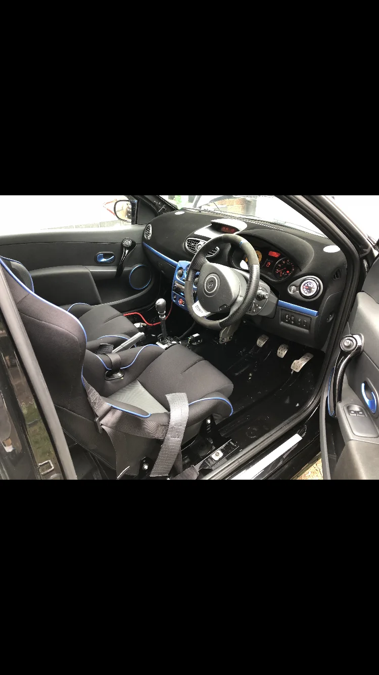

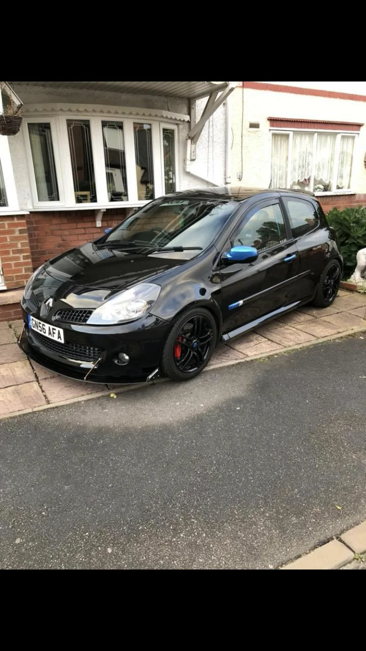

FULL SPEC!!
Everything that has been fitted or changed is either new or has been blasted/painted. The build was started in June 2018 so everything is practically new! Car has only seen about 50 miles!
Wheels, tyres, brakes, everythig are brand new and pristeen condition!

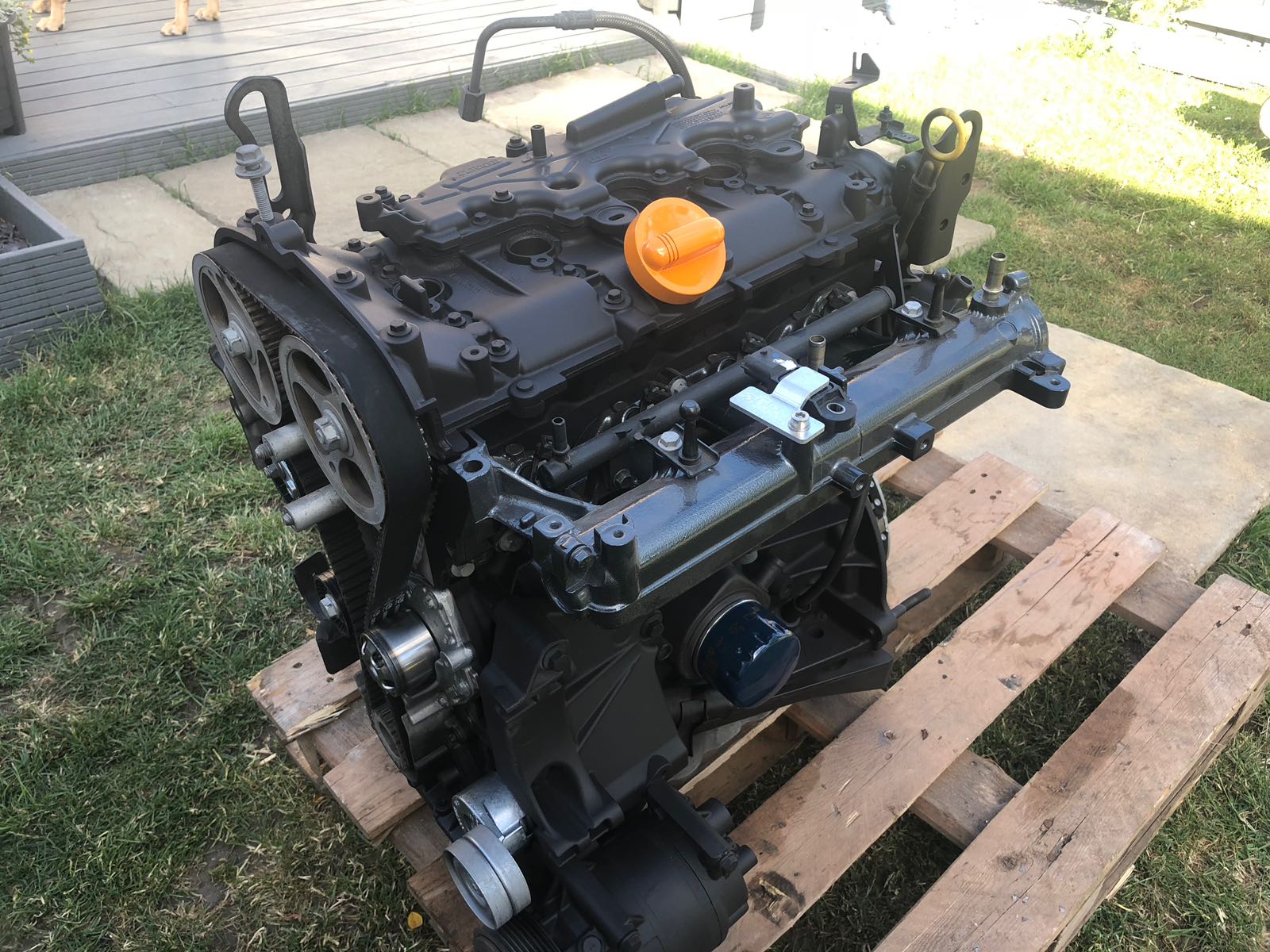

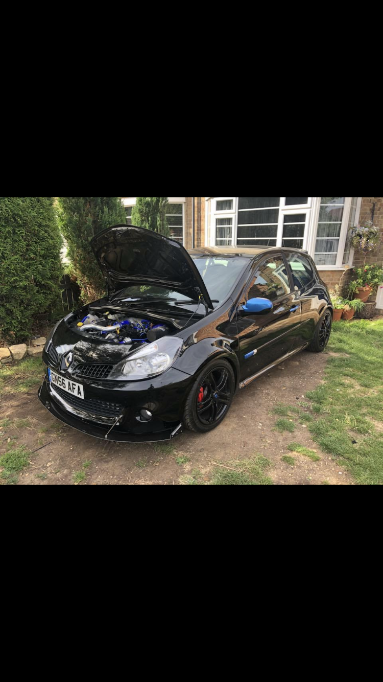

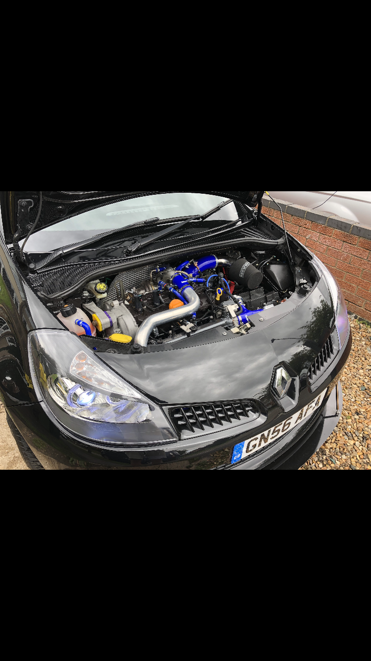

Engine
Megane 225 Turbo engine from a 2006 F1 model at 80k
Block been stripped, blasted and painted black matt high temperature.
Full OEM cambelt kit
Full OEM AUX belt kit and tensioner
Refurbished sump and new gasket
Forge Alloy intercooler hard pipe kit
Forge BOV kit
Forge inlet hose secure plates
Forge Silicone Induction Hose
GT Performance coolant hose kit
GT Performance AUX hose kit
Powerflex upper Torque Bush
Vibra Technics 3 peice mount kit (engine, gearbox and dogbone)
4 brand new coilpacks
4 Iridium NGK spark plugs
Ram Air induction filter kit with hard pipe
Both Lamda Sensors brand new
Wiring Loom adaption done and re-wrapped with cloth tape
Genuine Renault oil filter with Millers XF Longlife 5w 40 fully synthetic Premium oil
Full 3” turbo-back Pure Motorsport stainless steel twin exit exhaust system with heat wrapped downpipe and link pipe
Pure Motorsport Billet Air Con Delete Kit
Battery Relocation to boot with 0 gauge wiring, gold plates terminals and purpose built XT Rally battery tray
Rs Tuning reconditioned Gearbox designed for turbo conversions
Single Mass flywheel (rather than dual mass which comes with the 225 normally)
LUK Clutch 3 peice kit
Clio 197 thermostat and seal replaced
Coolant temp sensor replaced
Uprated double thickness alloy intercooler
Megane converted radiator and cooling fan

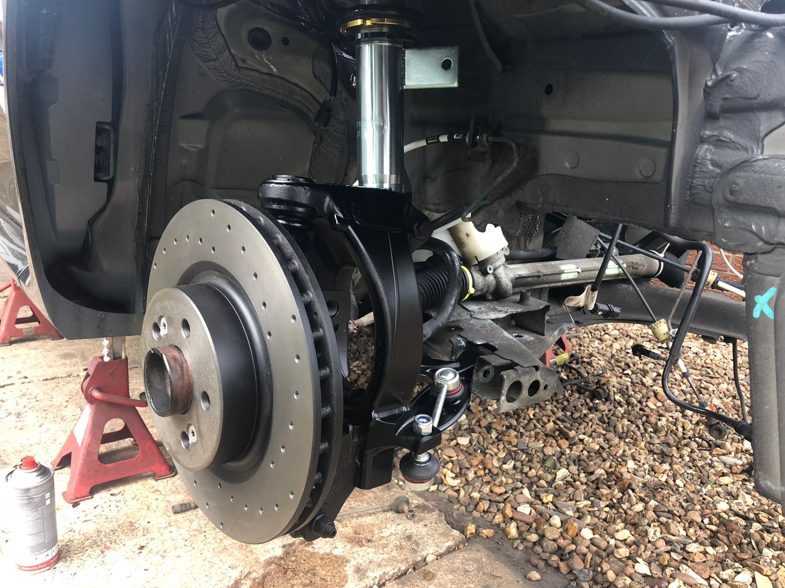

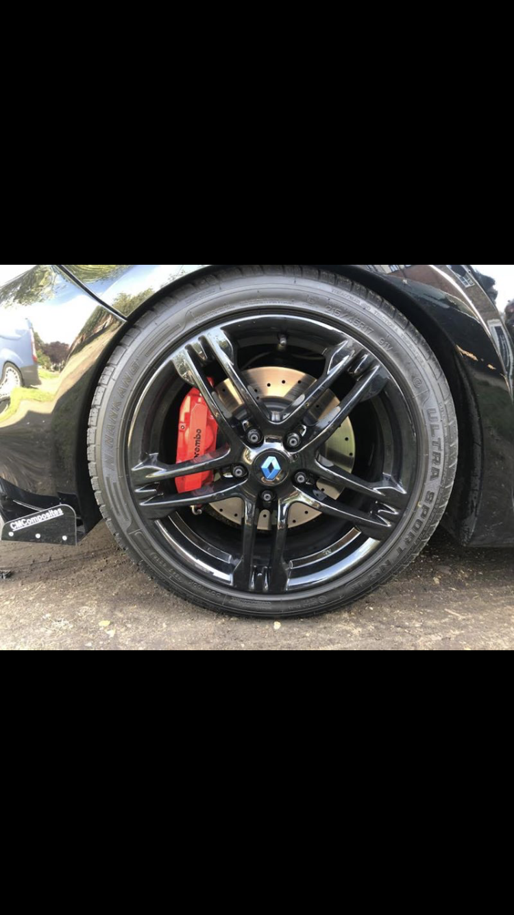

Braking
Brand new brembo genuine Calipers all round powdercoated red
Brembo drilled discs with brembo pads all round
Genuine pad fitting kit installed
Goodridge braided brake lines all round
ProLine Braided link pipe hoses for both front calipers
Dot 5.1 fluid throughout
New ABS Sensors all round
Both new complete rear handbrake cables
Wheels and tyres and suspention
KTEC coilovers with new genuine top mounts
Shot Blasted arms, painted black
New track rod ends, drop links, torque links
Tracking test completed after conversion
Stock Sport 200 alloys refurbished in gloss black completely by Ace Refinishing in Godmanchester with black centre caps and blue colour coded diamonds badges
Wrapped in brand new Nangkang 215/45/17 Ultra Sport NS2’s barely done 50 miles!
Mounted onto 21mm Pure Motorsport CNC billet hubcentric spacers secured by Pure Motorsports Stud and Nut conversion kit

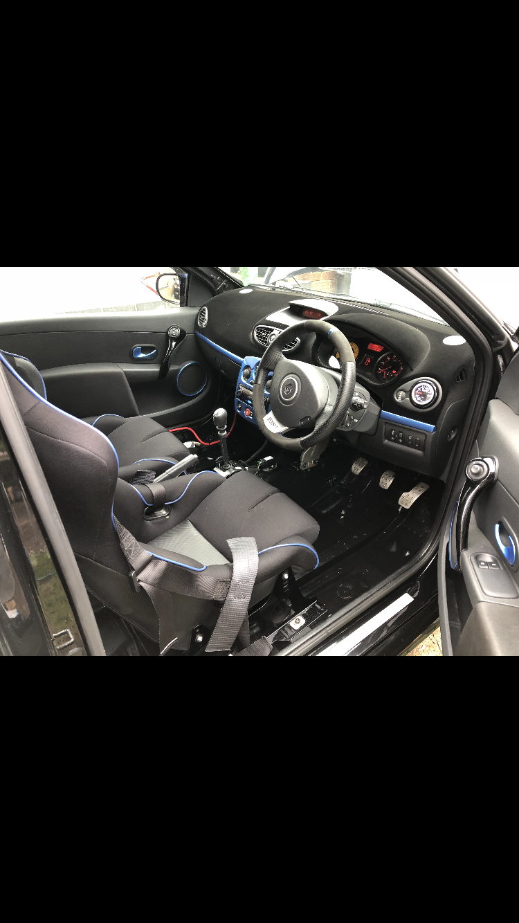

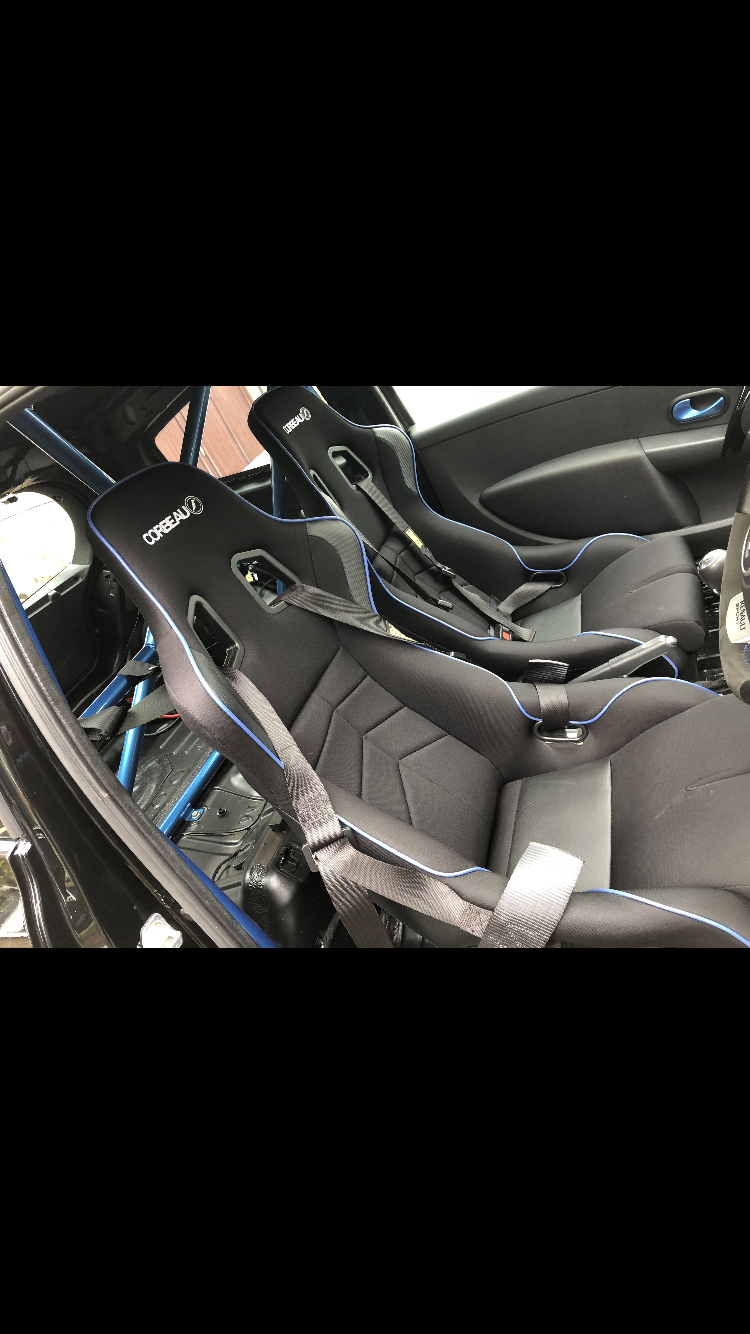

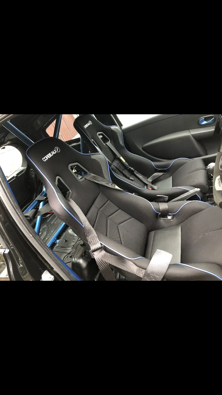

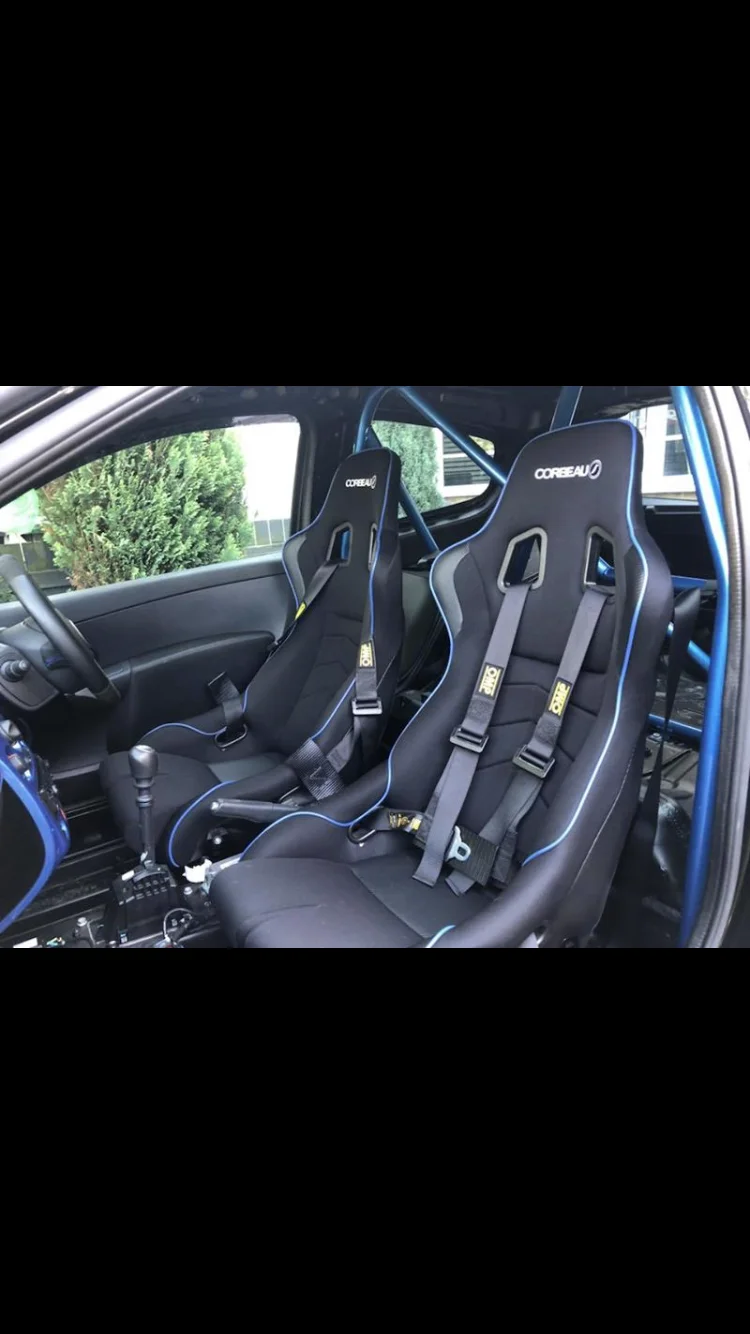

Interior
Fully stripped interior bar dash and front door cards.
Dash is flocked in black suede
Centre console trims painted AMG Blue
Royal Steering Wheels retrimmed steering wheel (suede, perforated leather with blue stitching)
Loom has been simplified and rewrapped with cloth tape
Rentune bucket seat single peice mounting set with matching pristeen Corbeau DFX bucket seats, secured with OMP 3 point harness’.
Sony Bluetooth/DAB single din stereo installed with stock front door speakers
No faults on dash (airbags deleted from ECU apart from steering wheel which is still functioning)
Rear half Roll cage custom fabricated and bolted in, painted matching AMG blue

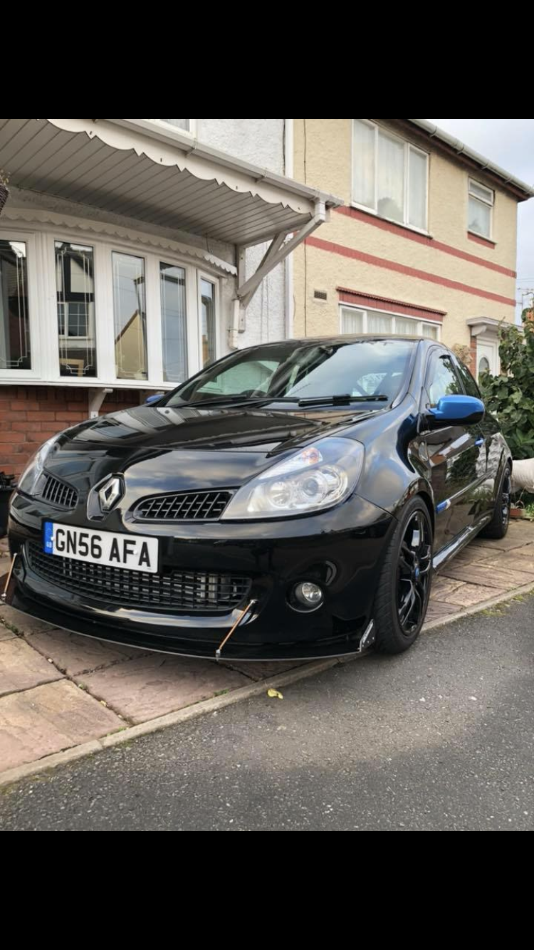

Exterior
Body is 100% legitiment, has the odd slight ding/ripple but no filler or bad damage repairs throughout! Slight scuff to NSR bumper corner will be solved will have full machine polish upon sale
Colour coded (GNA) rear diffuser
CM Composites front splitter with tie rods
Colour coded wing mirror units with AMG painted mirror covers
AMG Painted door bullets and door handles
Team Heko Wind deflectors
Sprint Spoiler painted body colour
LED rear light units installed with brighter LED brake light bulbs.
Xenon numberplate light units fitted
Rear de-wiper, and motor removed. Hose has been completly removed from washer pump at the front.
Short Ariel Antenna Carbon style
Body colour painted front bumper upper grills
Depo Projector headlights with blue Halo conversion, with 8000k xenon kit installed.
Bonnet has been painted completely inside out.
Aero windscreen wiper conversion
Colour coded scuttle panel
TEAM RS rear window decal fitted
