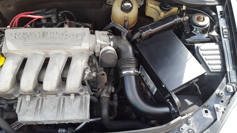

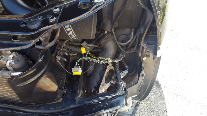

The intake bend finally arrived today, and so did the rain! The (no) mods are going well[emoji38]. A glut of overtime has lowered my willpower too, I'm considering lowering springs and new exhaust as my centre section sounds like its made of Swiss cheese.
Clio_fool
Fatty fitted last weekend and is a lot quieter than I expected! Although the last sponge cone I ran was on a 5GTT and the turbo sucked like a 2 bit whore through it!

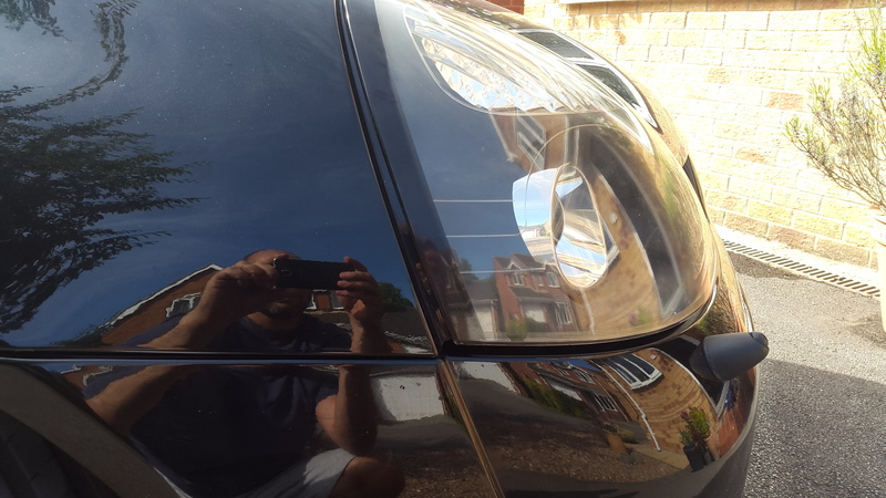

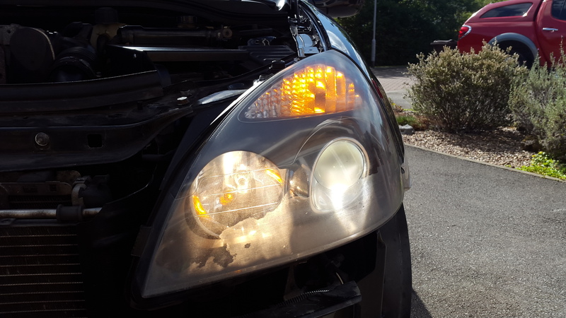

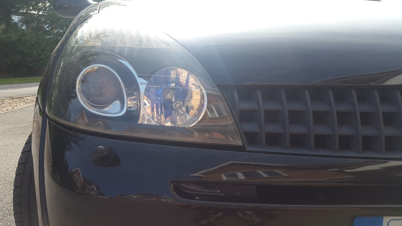

When I got the car the passenger headlamp was a bit misty and sun dried at the top. You could hardly see the indicator bulb and the drivers side was clear as a clear clio headlamp. After reading all guides on here I decided to set about it with some wet and dry and scratch X. It's a hard job to do by hand and not enough elbow grease was used that day. It was better, turned out there was an indicator bulb in there but it was still worse than the other side. Not to be beaten, off I went to halfords to buy a resto kit. A month or so after buying the kit while washing the car I thought it was time to have another go at that light. Closer inspection however showed that the light seemed to be degraded on the inside. I've read that it's UV light that causes the lenses to yellow over and as that bulb is a different colour to the drivers side I reckon thats whats caused the inside to go. I still have the resto kit. Unopened. This is what it looks like:
And this is the offending headlamp :laughing::
You can see the haze a couple of inches up. I did try rub it extra hard and it never changed so it's definately on the inside.
Plan B then: new headlamps. A couple of missed opportunities before I took a punt on a set @bashracing was selling. I only wanted the passenger one but as these were 172 units that would look a bit odd, one black inside and one grey so I left with one really nice one (passenger) and one with a broken adjuster and water marks inside the lens cover (drivers). Have I really just swapped my good one for a shitter and my shitter for a good one?? Should we quickly move onto plan C? A half arsed effort to aquire another drivers side headlamp at very little cost was fruitless so onto plan B.2.0:Crack the bugger open.
I have had a go at opening clio headlamps before with 50% success. Those lamps still work and adorn the black sheep which belongs to @Sj1782 . So with nothing to lose in the oven it goes for 15 mins. I'm now at 75% success and the inside was polished up nicely. Adjuster replaced it just needs putting back together. I'd bought some sealer for this job before and it worked a treat. This however is where I dropped a bollok this time. I did'nt remove enough of the old sealer, which before someone says just reheat it and press together I'll say that s**t does'nt actually melt. it just sort of goe's soft and rips apart when you pull, hard. Anyhow light reassembled and left to set with the family bible sat on top. 4 days later I remember about it and when I have a look the bottom edge of the lens cover is'nt sat right. Bugger. Plan B.2.1.0:Fit the t**t anyway and replace it next year.

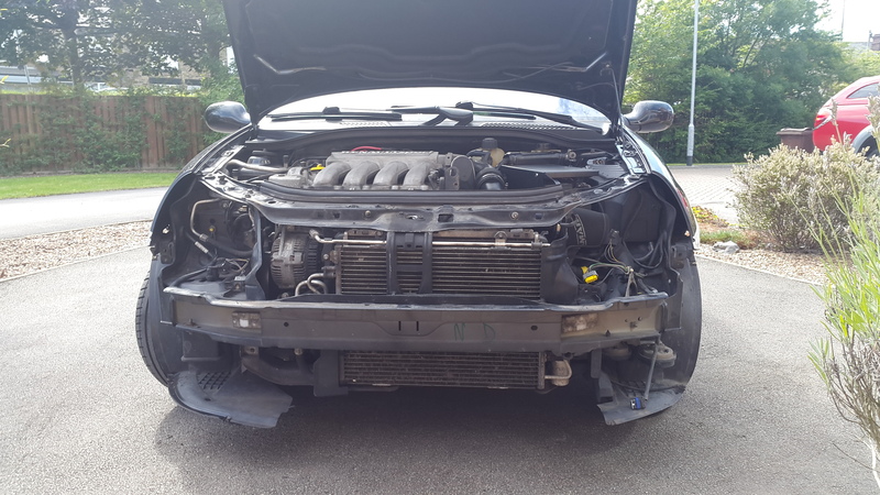

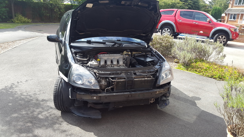

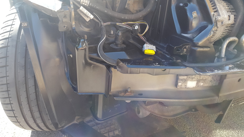

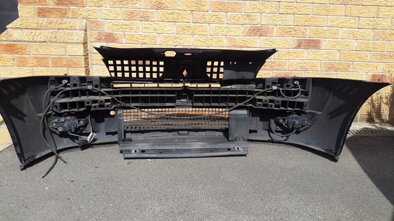

In a massive skive from todays expected decorating duties it's off with the front bumper and swap lights time. Guide followed all screws located. F me every one is rusted to buggery and just getting the driver in is a test of swear vocabulary. 4 screws removed, 4 bolts reman. Passenger side just spins and isnt actually holding the bumper on. Drivers side is missing. Drivers side underneath comes out easily. Passenger side underneath shears off after 2 turns. Just the sides to unclip and its off. That little crack near the top edge of the bumper, yep right between the clips. Will it just split and I'll be stood there holding a bumper corner, It certainly looked like it so I stuck my arm in behind the clip and pushed the last one out. Ouch.

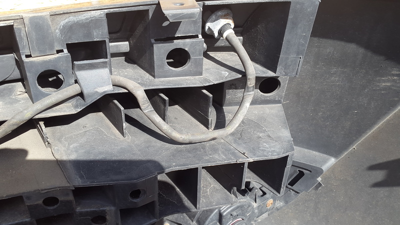

Bumper off and lights removed, time for a quick nosy around.

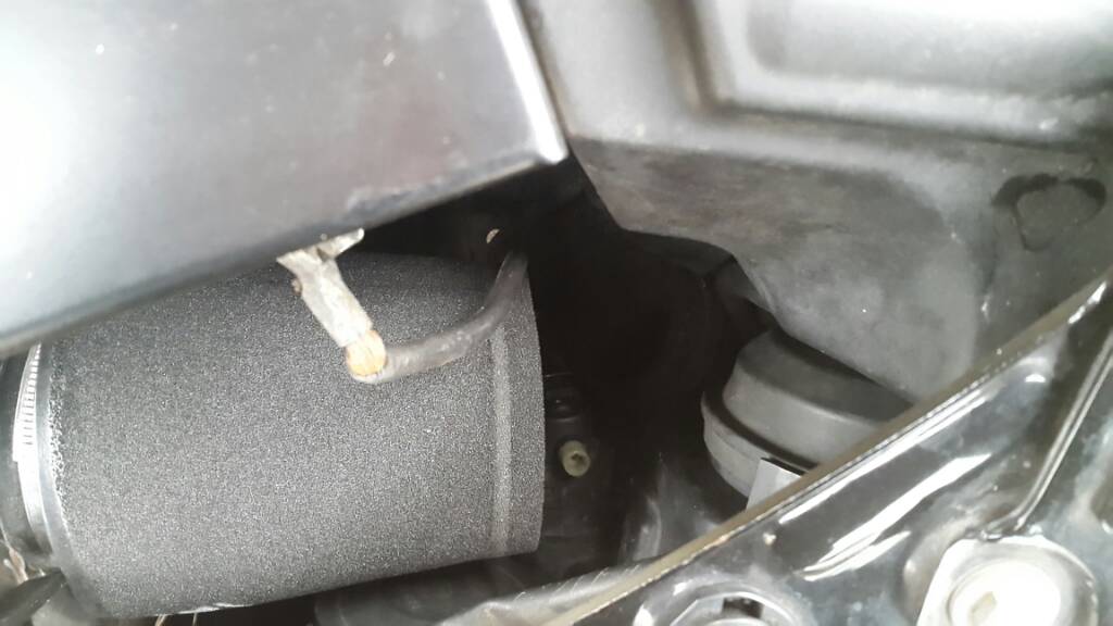

Acoustic valve still present?
And is this the carbon cannister I keep hearing about?
Yeah I did a bit of cleaning while I was there! Am I right in saying the centre section can be removed? It had a couple of naked bits so could do with a paint.
Lights swapped over and all working, but yeah I did f**k it up on reassembly and there's gaps along the bottom and where it meets the wing. it will do until I replace it next year.
It looks ok from 10 paces, much like the rest of the car really:laughing:

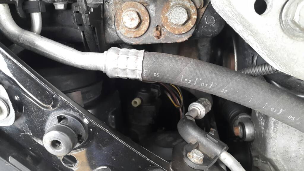

While the bumper was off it would be silly to not look at the headlamp washers. Pulling the pipes apart saw some water dripping from them but testing with the bumper off had no water squirting from the pipes. I hoped the reason they did'nt work was the routing of the pipe on the bumper:
The pipes had more kinks than a fold up hose pipe. Washer blanks on order the pipework was fixed easily. I had the washer bottle out the other week too to trim the rubber thingy as my windscreen jets had stopped working!

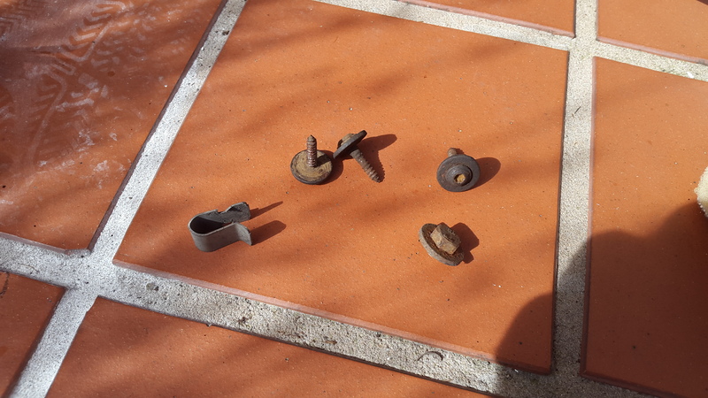

Bumper replaced I need to replace a few rusty screws. A clip of some sort fell off the drivers side too, any ideas where from?
All back together just a quick polish required to get them to their best.

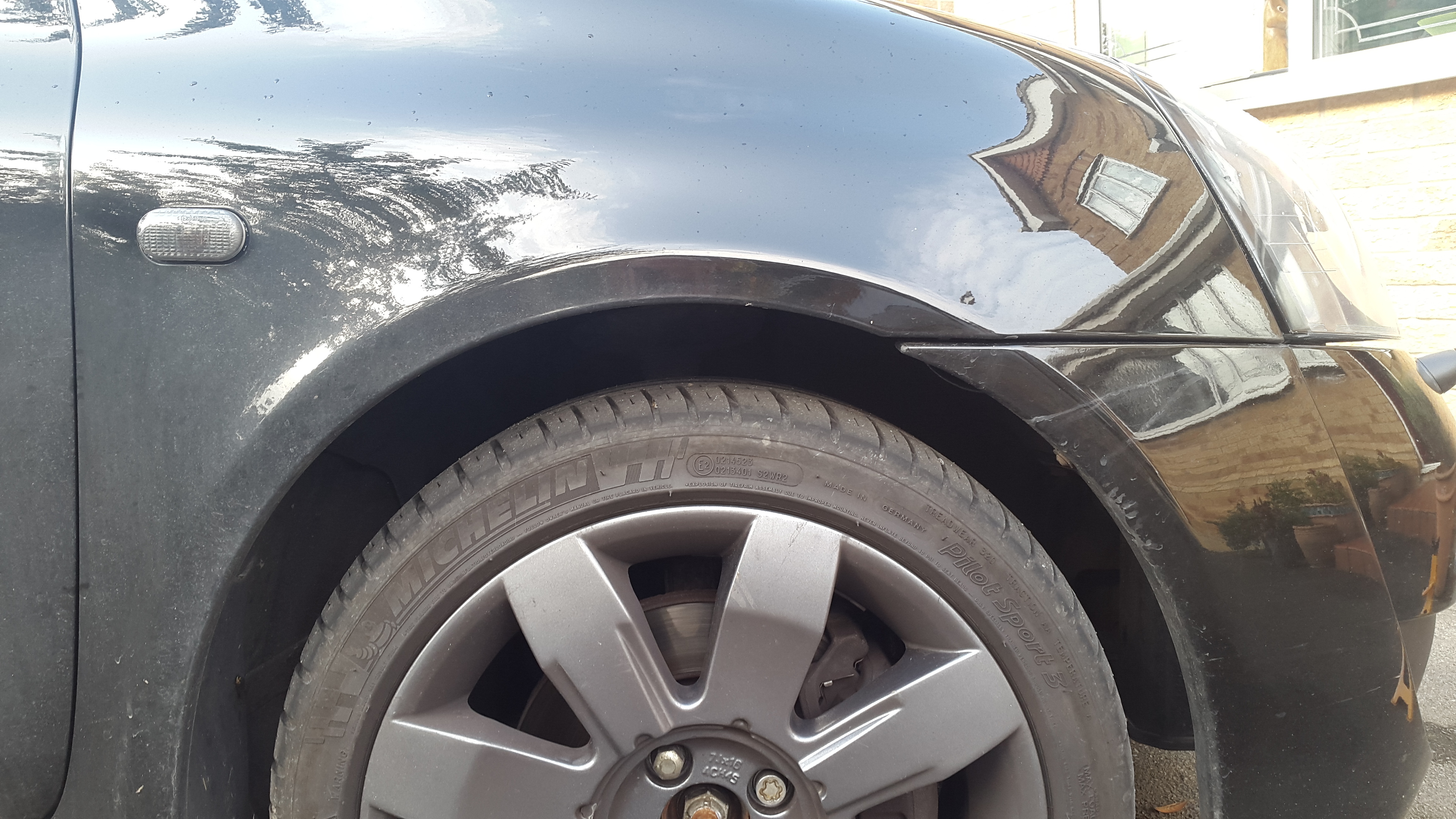

Mini update as not much has happened. Drivers side arch liner fell off. Luckily it waited until I got home and went over a speed bump rather that coming off on the 40 miles I'd just done on the M1. Going to need another one as the front edge of it has rubbed away and is about 20mm short!

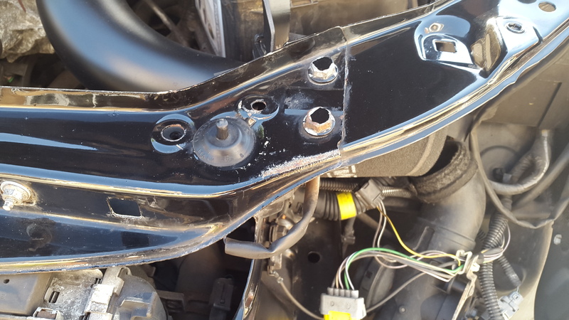

The other weekend I set about the suspension. Didn't get very far as the top mounts are ether very very tight or welded on. I gave up when my 6mm allen key resembled a drill bit cos it's twisted so much. Last week I found an impact gun at work that still works (f**king miracle I'll tell you!) but couldn't find a socket deep enough. I've ordered a socket so next weekend is d day for the suspension.

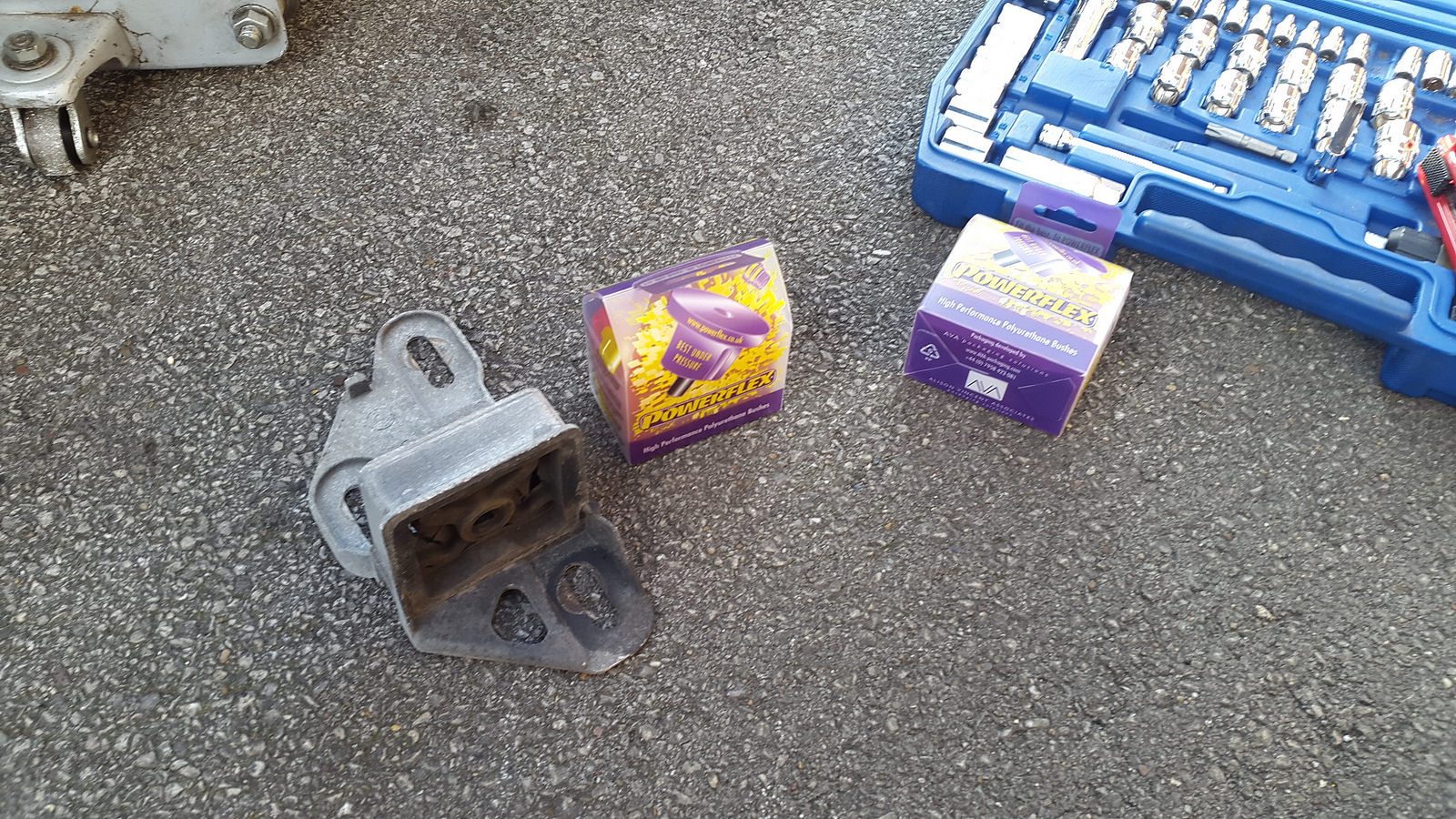

Exhaust is still on the piss. Logic says fit the powerflex bushes while the cars jacked up for the suspension, so yeah didn't get that far

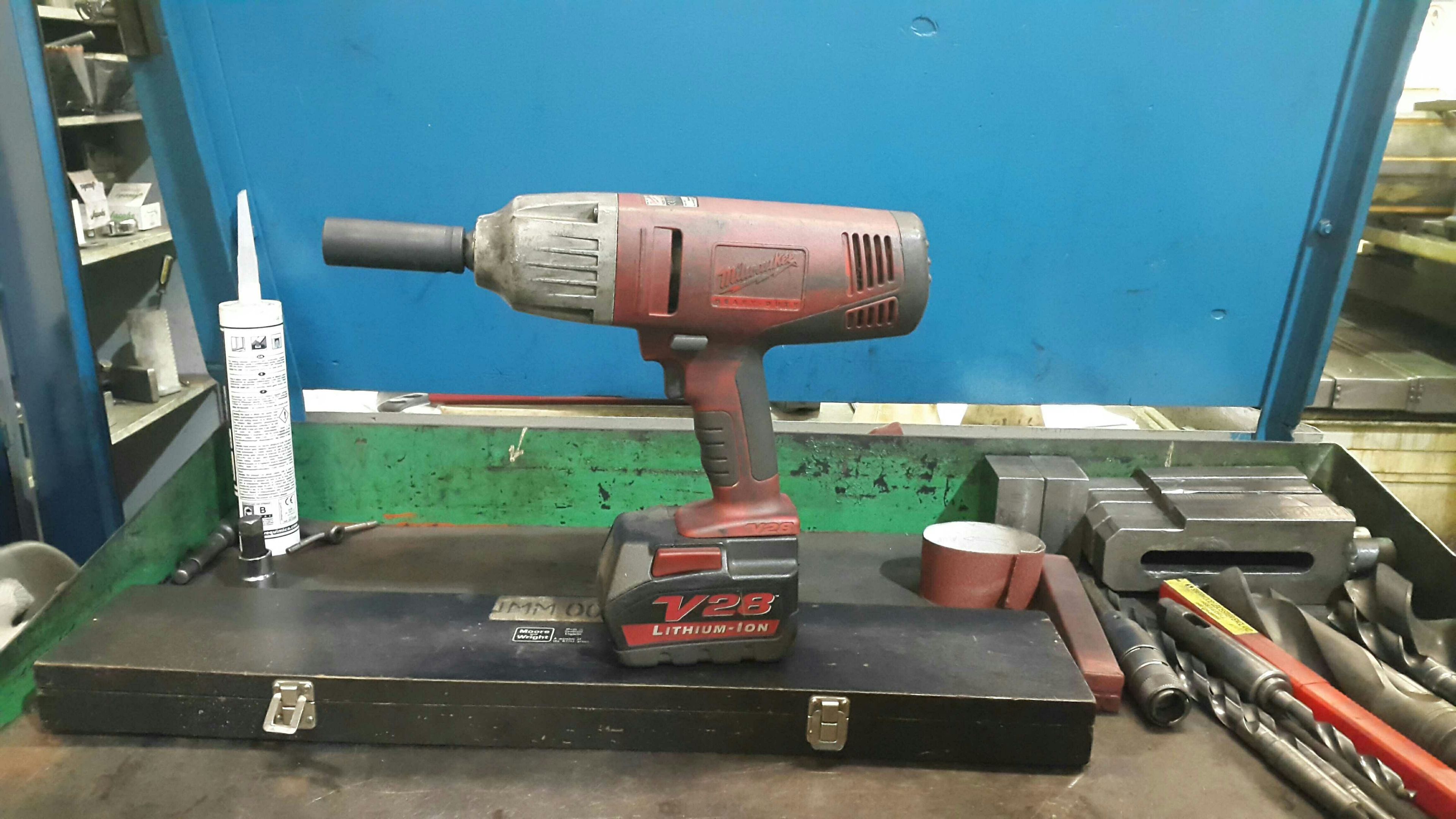

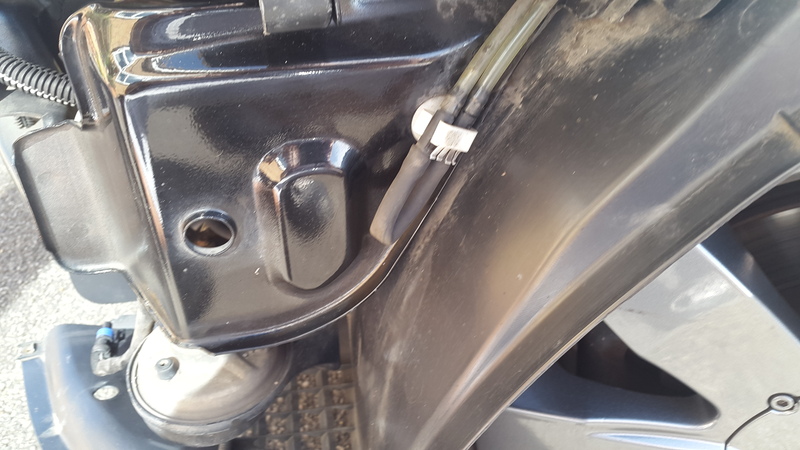

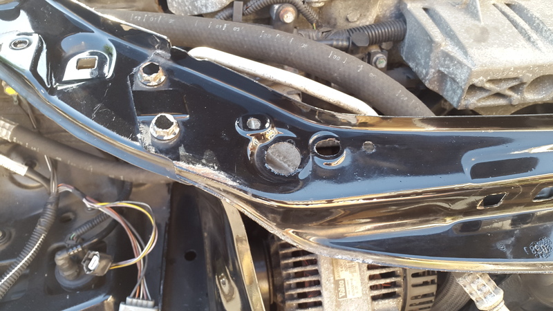

Armed and dangerous, to mounts are now removable by normal means. Tomorrow will be interesting.

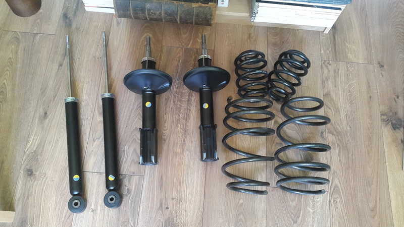

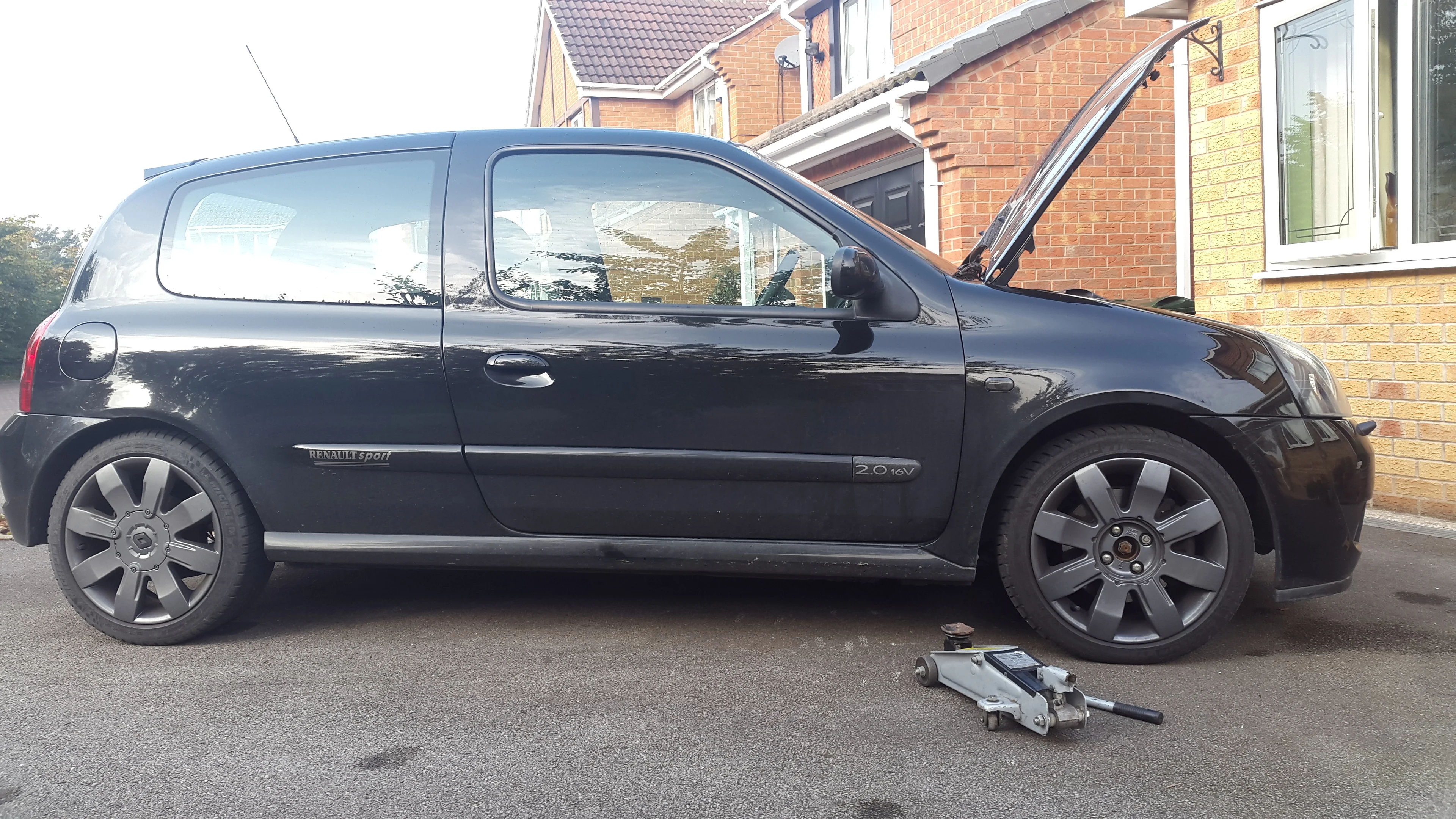

I have an update of substance this time! Had these lying around the house for too long now and with a break in decorating/gardening/anybloodythingelse duties I jumped at the chance to get them fitted.
OK, I say jumped but I did'nt start untill 11-o-clock. :laughing: I even manged to take a few pics along the way.
Before I got to it a quick snap for comparison purposes.
A new low for the clio. by Paul Dent, on Flickr

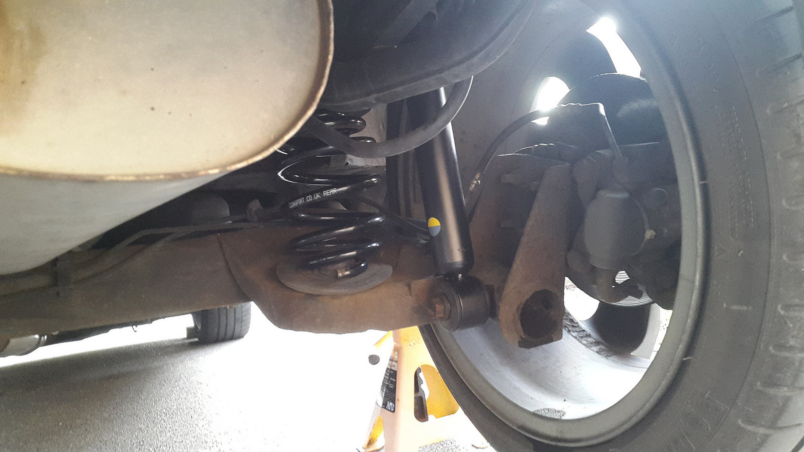

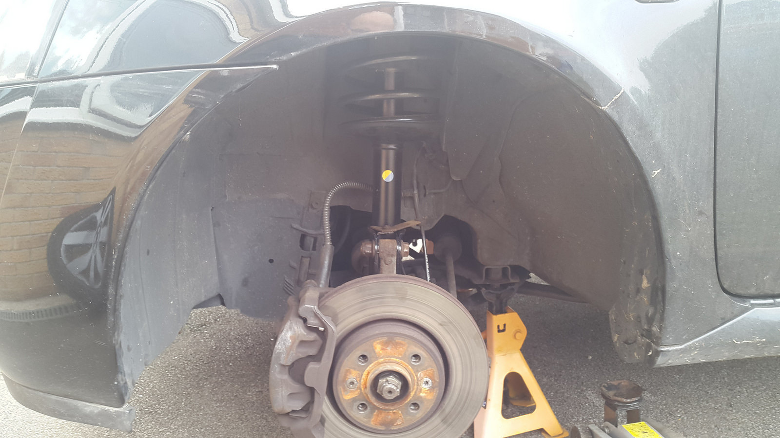

I had attempted this job the other week but found the top nounts to be reeeeeeely tight. @bloke said impoact gun them so a search at work found the gun but no socket:weary:. Ebay to the rescue and during a break at work the top mounts broke loose. Nipped up for the drive home all I had to do was get my arse out of bed early Friday to do some house chores to leave Saturday free to spend under the car. That nearly went to plan, I got obviousley got to spend Saturday on my back anyway.:wink:
Having studied the Cliosport guides many times I was confident I would be successful. That was until I'd removed the first front shock and was trying to fit the new one. It's strange how identical parts come out one way but never fit back in the same way. After a few blue words and a little panic I pressed on and finally got it in. The second one did'nt go any easier though!
It's at this point I'd like to say a big thanks to my dad, a mechanic for 30 odd years, for all the work he did on my cars over the years while I watched or went to the pub! So thanks dad:up:
The back end is a lot easier and was much more calming to do.
While she had her arse in the air there was one other thing worth doing:
My rubber mounts were'nt too bad but the exhaust did bang on either the bumper or the underside of the car, fitting stiffer springs could'nt have helped that so in with the poly bushes. My exhaust is still on the piss, it is a scorpion after all but it does'nt move now.
About 4 hours all in and the car was in one piece with none left over and all looked good. :smile:
A dry afternoon on Sunday gave the opportunity for a quick wash and a test drive. There's a couple of speed bumps in our estate and a twangy spring noise was not what I wanted to hear driving over the first one. A quick look at each corner and nothing looked out of place but the scary noise repeated over the next bump. I worked out what it was this time though, I'd put the old suspension parts in the boot and locked up for my Dinner! I've not chucked her about beacuse of the boot full but the springs don't feel that much harsher at normal pace over our bumpy roads, but the ride does have an extra firmness.

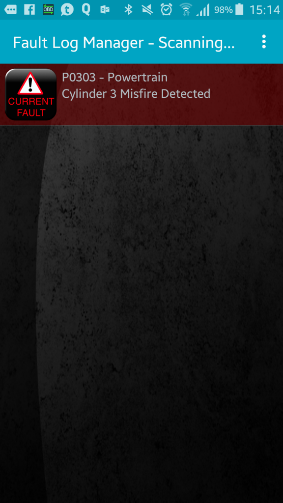

Had flashing eml light briefly last night while sat in traffic. Code scan today and have this:
Now I'll have to look into new injectors.

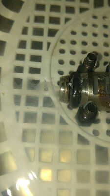

Injectorsremoved today ready for @dann2707 to perform his cleaning process on. Hopefully this will prevent the misfire happening again. A worthwile preventitive measure and great value compared to replacement injectors.

So injectors were cleaned and re fitted within 5 days. An excellent turnaround by @dann2707. Car fired up straight away and ran lovely, as it had before to be honest but that 1 off misfire shouldn't be a problem again hopefully. The misfire one spat a load if s**t out.
