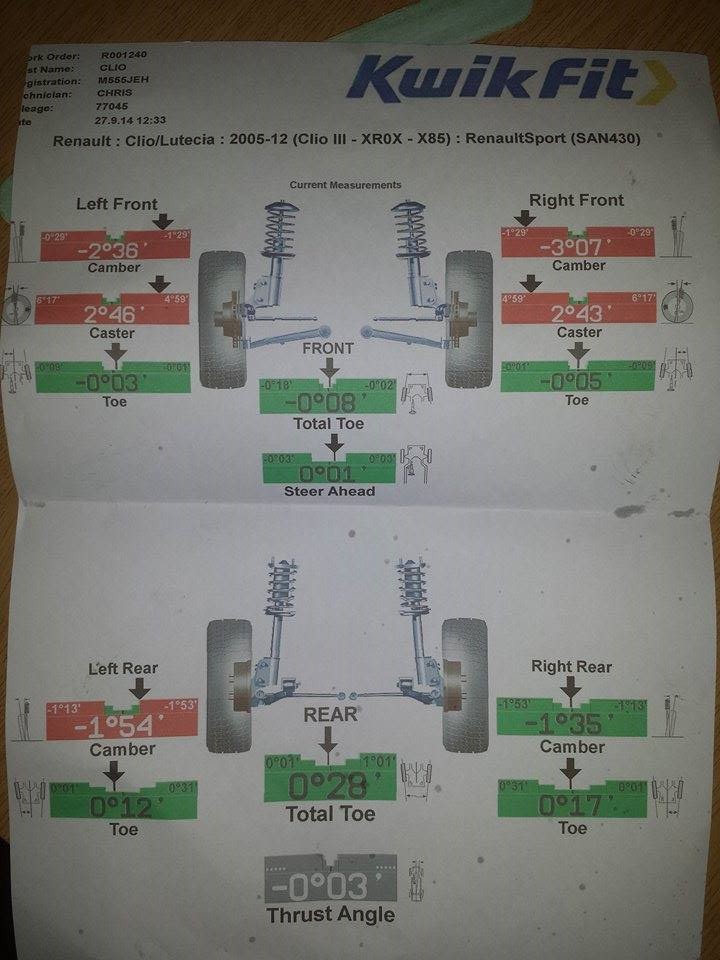

Hi, so as the title suggests, there is something really not right with the front end of my car... It's always felt very heavy when turning and sometimes it will knock when going over bumps, dropping off kerbs and when turning. Anyway the camber is well out (-2.5 ^ -3.0) which I will be getting rectified asap. It's just had x2 new front tires and things have gone from bad to worse... Now when I am turning the steering will all of a sudden pull into the turn more than I was expecting! I will be on a slow corner and all of a sudden without turning the wheel anymore the car just decides to turn even sharper and then just now coming home I was in a similar scenario and the car pulled pretty quickly and had in a cycle lane and almost up on the kerb. Needless to say I am not driving it until this is sorted... It's as if the wheels are in a ditch and guiding themselves:anguished:

This is a shot of the alignment check, I think they chose the wrong reference model but I don't think it affects the readouts, just the reference figures.
