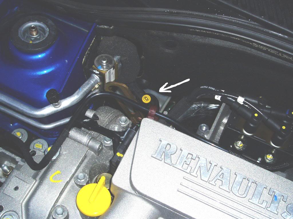

2. ive been down the same bit of road 3 time know and in the same spot every time the STOP! and the handbrake light blink's on for a sec then go's off its only happend on this road. its just after a tight left could that have anything to do with it?

welcome to clio world. the same happened to me just after i got mine,just check the fluid levels first,even a if its down a little bit the lights will come on usually at high revs
If the lights coming on at the same place each time , i'd say your brake fluid level is slightly low , top it up , its a pretty common thing . If you have an engine cover on you'll have to remove it to access the brake fluid reservoir , put some rags round the top so you don't spill brake fluid on to the exhaust manifold .
Heres a pic of the brake fluid reservoir :
