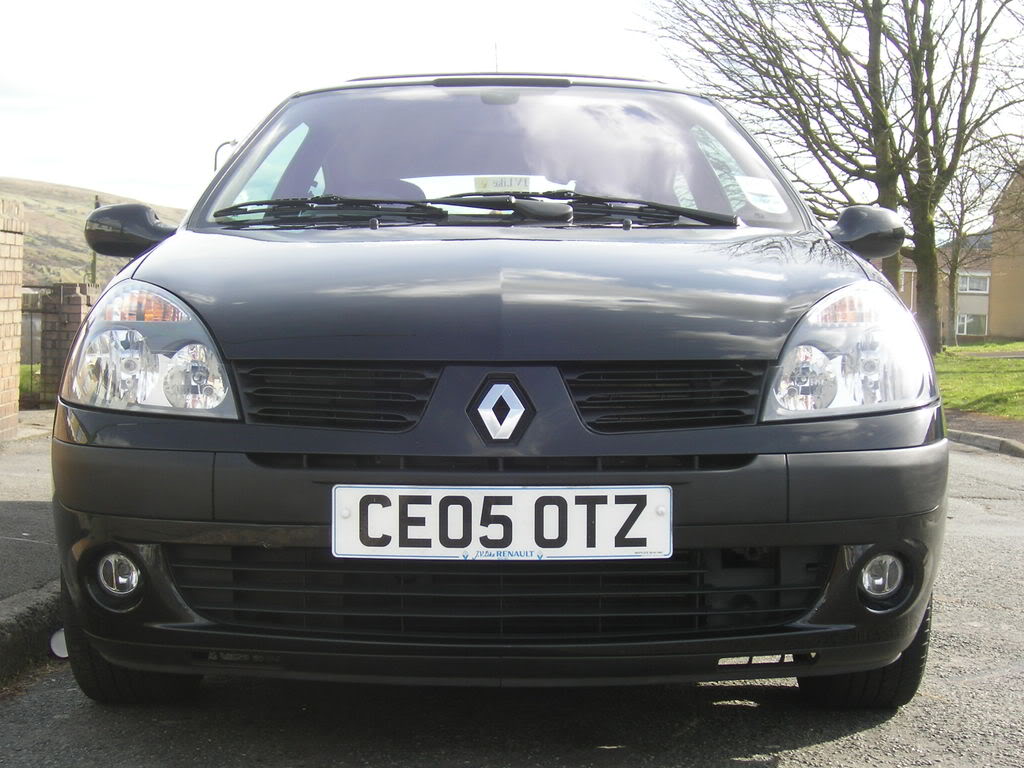

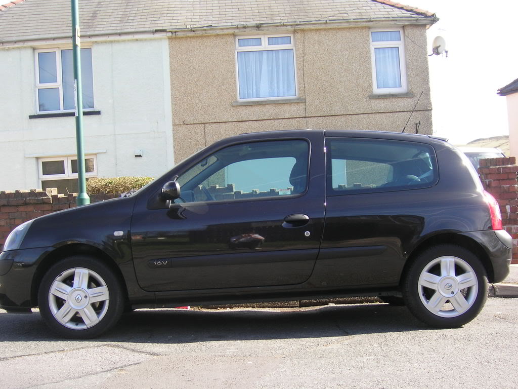

so heres a pic of my car as of when i baught it about 7 months ago from renault

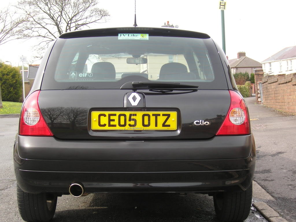

anyway , my first modification was my prospeed stainless steel cat back ehauast system
its a 3.5 inch slash cut rolled tip . lifetime warranty (i love it)lol

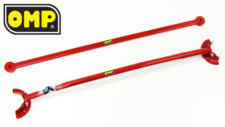

my next mod i purchased would be OMP front and rear strut braces in red

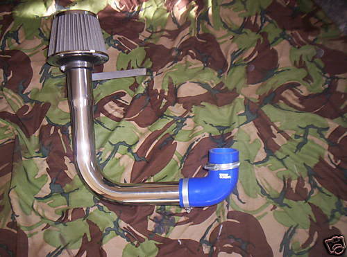

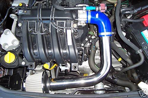

anyway i then got myself a k-tec induction kit and relocation pipe, but as im now turboing the car im using the relocation pipe as the first parts of my boost piping :D
oh and thats not my bed sheet :p ^^^^

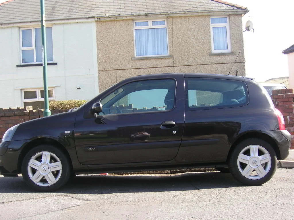

and on the car

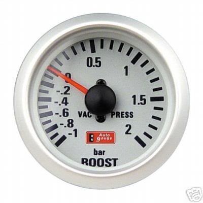

anyway, just had a parcel this morning :D
my auto gauges boost gauge (i know theyr cheap but i had one in my astra an it was fine for years)

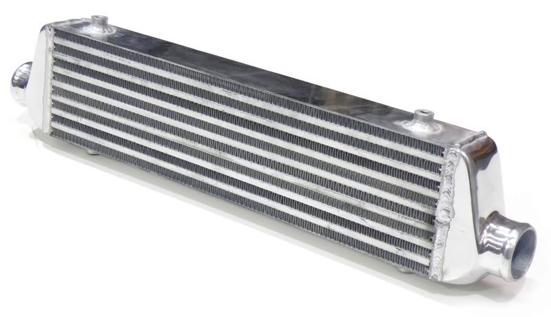

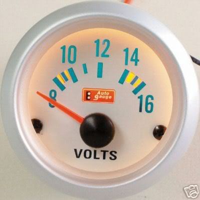

and as i write this im ordering my next two parts ..............
my front mount
and my volt gauge

will be loosing torque with that relocation pipe.

hiya guys,my front mount intercooler arrived this mornin, :D il start gathering the materials to mock up the boost pipes at the start of next month , thanks for the comments guys, can anyone recomend a few standalone ecu's and piggy back ecu's ?
