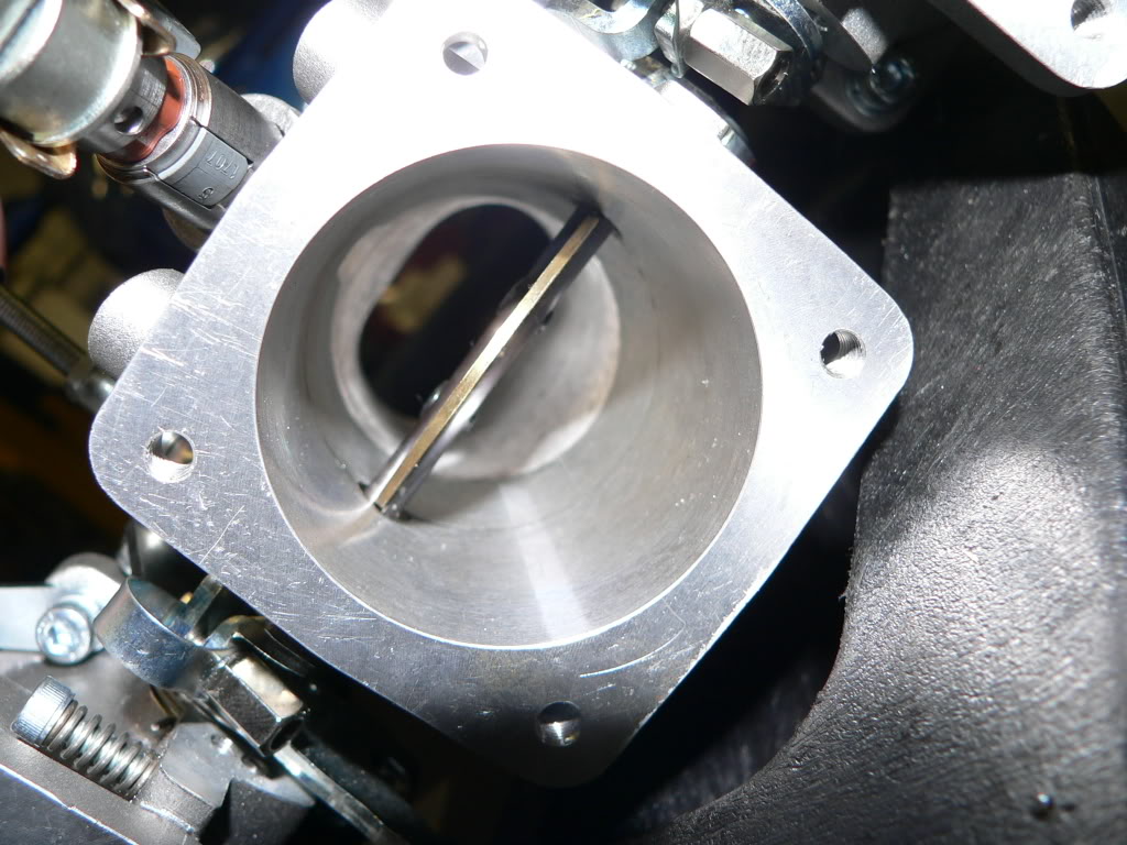

this is just to wet your appitite for now as im shockin on computers, and brother is helpin me before he goes out. :)
gearbox will cope aslong as i dont miss gears and grind it..... touch wood, and fingers crossed lol
i would have thought you should have bough a coil pack first!:rasp: , looks mint! i need some in my life, just checking the lottery!:cool:
  GDI 227bhp ITB`d 172 cup
lmfao, its got a coil pack now obviously lol :rasp:, looks mint,sounds amazing n like s**t of a shovel ;)

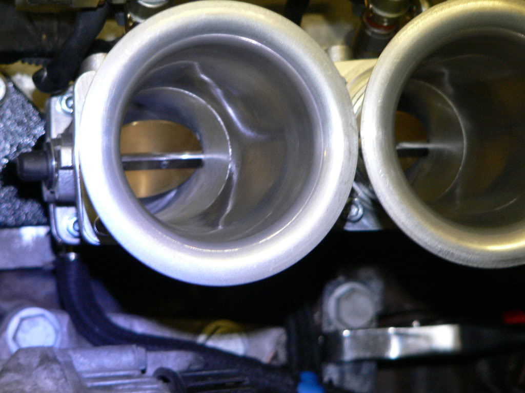

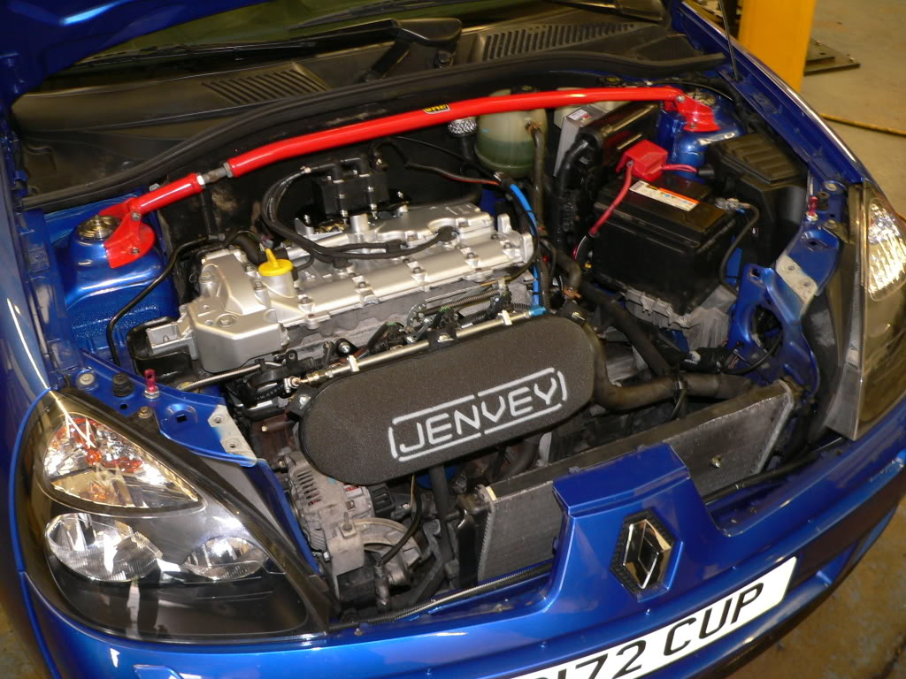

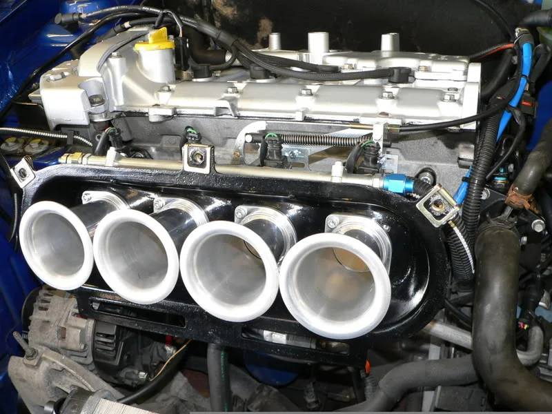

the ali rad helps when you see if from the front as the std one even like this does obscure the air to the right two trumpets, also if its in its std position it is worse.
with the air filter on the slam panel cant be used to lock the bonnet, as its too flexible once the panel is cut and could lead to either not being able to open the bonnet or the bonnet not holding shut... you could leave it in modified and have pins, but even then it gets in the way and is thus pointless imo

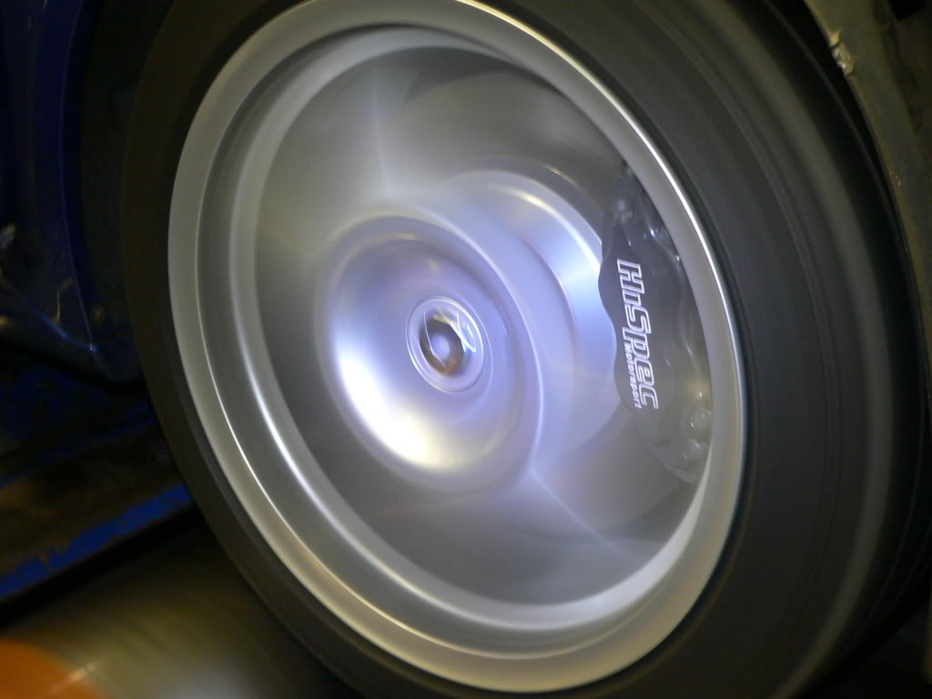

no your correct... the load is being reduced on the rollers to set the fuel level for each load site at that particular RPM
  clio 200 F4Rt
i would of thought u would map it with the air filter on etc, so it was closer to real world setup? and a more accurate map?
  clio 200 F4Rt
ah right!
fair enough!
might be in contact at some point andy, to discuss ITB possibilities! :D
mine was on a different RR near me that imo over reads, but I think mine still makes more peak power, but speaking to Andy and Stu's power band and torque is a fair bit better than mine, as his is still making power at 7500rpm, where mine tails off quite a bit due to the cams... not to worry though, mine's being dropped off soon for more toys ;)

why do throttle bodies give such a good increase?
i know there are cams aswell and the other stuff done, is it just the smoother airflow into the engine combined with all the other work that gives the big increase?
M
mini-valver
As standard you use a single throttle body and plenum set-up which has a long inlet tract. Removing the long tract and using 4 individual throttles and bigger injectors means you get a lot more air and fuel into the engine faster, thus more power.
